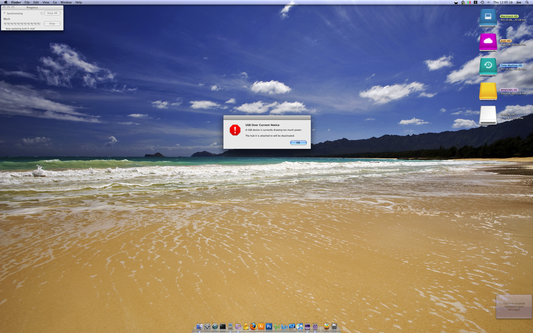

(XS)s0lid Posted May 15, 2009 Share Posted May 15, 2009 oh and (xs)solid, the pcb works brilliantly for the switch and led, but usb wont work... and neither will firewire. I was expecting that one but i would like usb. ill have a couple more plays! EDIT: Please see attached screen grab! i have tried the usb header both ways on the pcb.... That's interesting, either theres a short circuit on pcb or something like that since it gives over current error... If you can take good picture from pcbs backside i could check is there problem with my soldering. Tho if you know somebody who works with electronics, ask him to check for bad solders. I've tested USB, led, button and audio and those worked, but haven't tested FW since lack of time. Will look foward for that at this weekend... Link to comment https://www.insanelymac.com/forum/topic/4525-discussion-fit-a-pc-in-a-g5-powermac-enclosure/page/35/#findComment-1157375 Share on other sites More sharing options...
wlazara Posted May 15, 2009 Share Posted May 15, 2009 That's interesting, either theres a short circuit on pcb or something like that since it gives over current error... If you can take good picture from pcbs backside i could check is there problem with my soldering. Tho if you know somebody who works with electronics, ask him to check for bad solders. I've tested USB, led, button and audio and those worked, but haven't tested FW since lack of time. Will look foward for that at this weekend... so using your pcb, the firewire isn't necessary for power ground? Link to comment https://www.insanelymac.com/forum/topic/4525-discussion-fit-a-pc-in-a-g5-powermac-enclosure/page/35/#findComment-1157383 Share on other sites More sharing options...

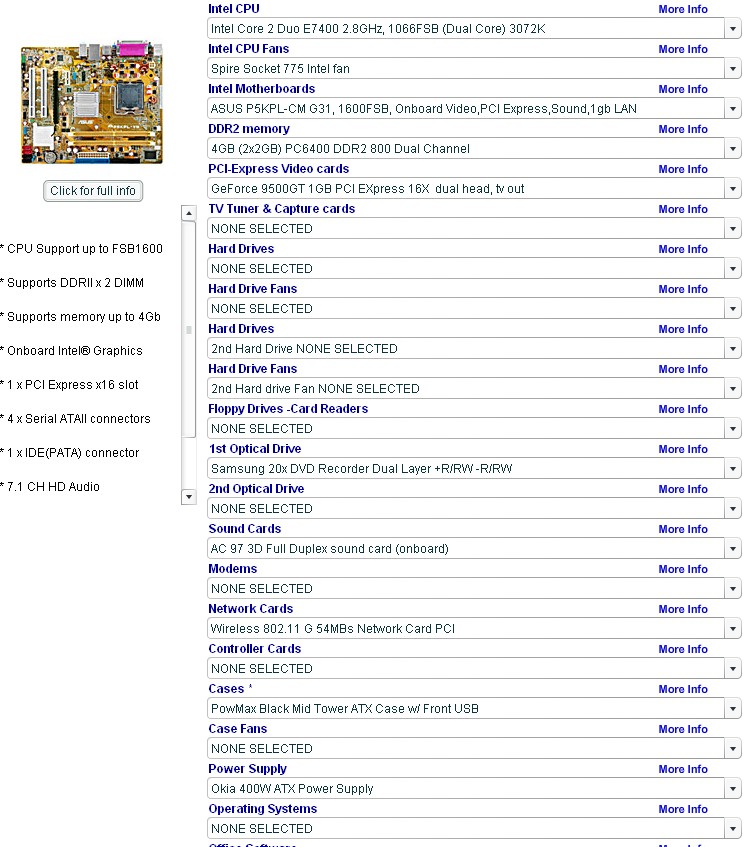

Living745 Posted May 15, 2009 Share Posted May 15, 2009 Hi, i´m new and like to start with a modd, just got the case.... My budget is about $500 - 600 and i like to modd it as a PC (sorry i know...) but for more i have no money... I like to know if i can use this Motherbard and how you guy`s thinking about this?! ASUS P5KPL-CM G31 1600FSB I also looking that i buy a like custom made PC over ebay and installit then in the new Case. What you are thinking about? I listet all parts in the picture, is this ok for $450? And what would you recomment? Thanks - and you guy`s made a really good job! Link to comment https://www.insanelymac.com/forum/topic/4525-discussion-fit-a-pc-in-a-g5-powermac-enclosure/page/35/#findComment-1157711 Share on other sites More sharing options...
