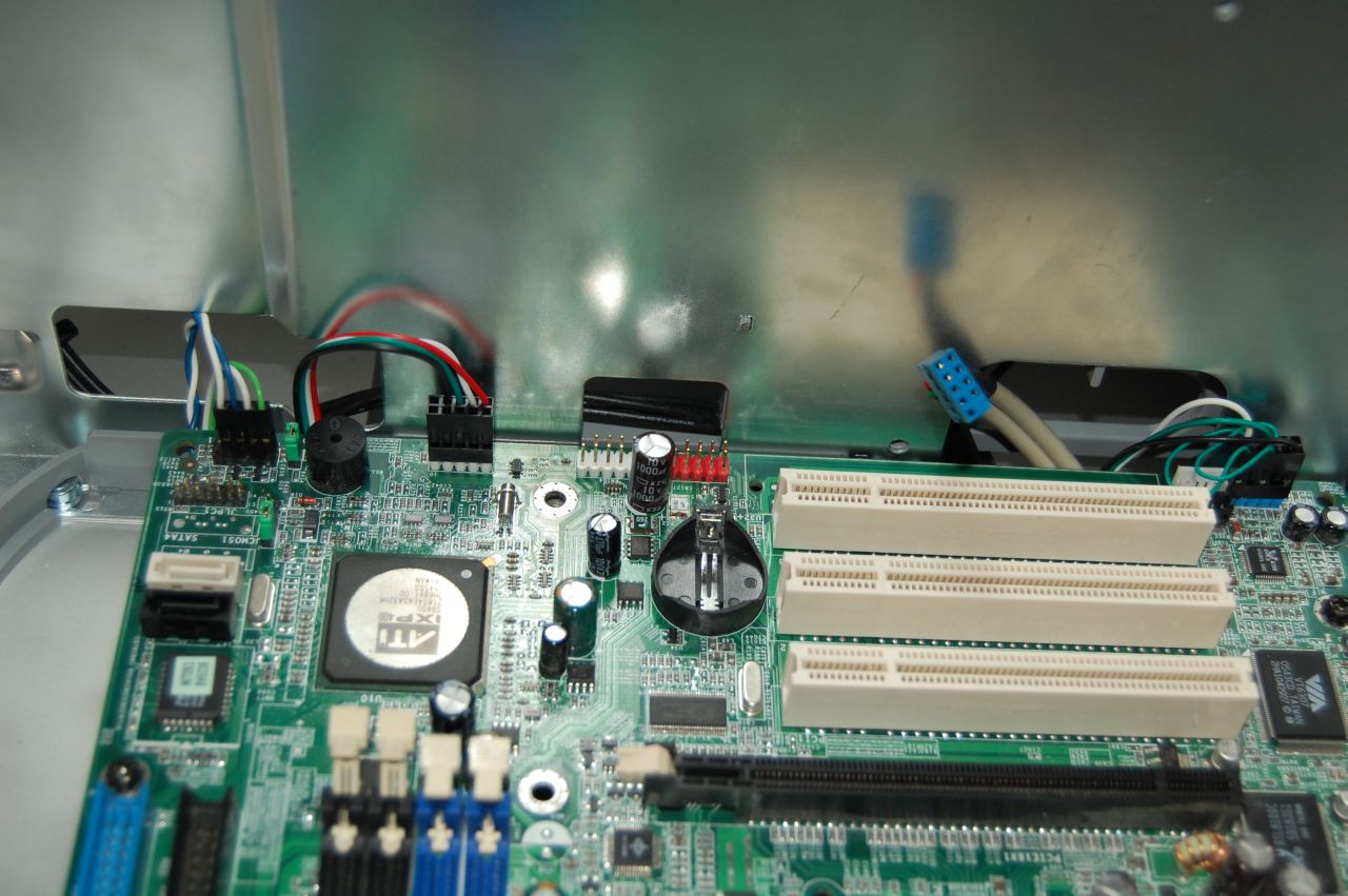

ѕӎѳѳ₮ңӌ Posted March 17, 2009 Share Posted March 17, 2009 doh the DFI mATX x58 board doesn't have firewire... I don't really care that much about having firewire in my system, I'm just concerned about the front panel grounding... do I need firewire for that? no, as far as im aware just wire the firewire ground to a spare usb ground or power switch ground. Link to comment https://www.insanelymac.com/forum/topic/4525-discussion-fit-a-pc-in-a-g5-powermac-enclosure/page/32/#findComment-1108982 Share on other sites More sharing options...

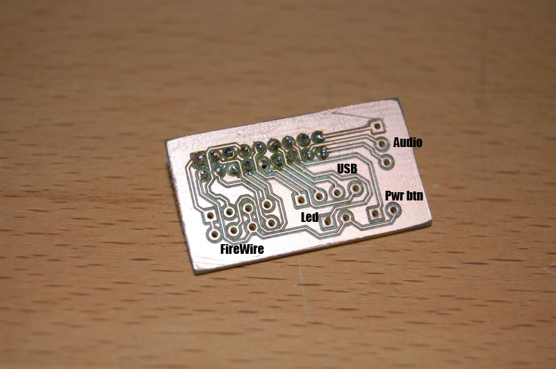

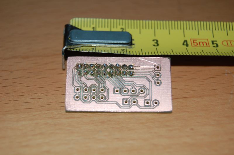

ѕӎѳѳ₮ңӌ Posted March 18, 2009 Share Posted March 18, 2009 You're welcome Oh well doesn't matter anymore, were just too suspicius that those stand-offs would have been more deeper Btw if someone is interested, i can make adapters for frontpanels 18pin connector I bought the components recommended by nervouschimp, so im not in need of PCB. however somebody else might! Link to comment https://www.insanelymac.com/forum/topic/4525-discussion-fit-a-pc-in-a-g5-powermac-enclosure/page/32/#findComment-1110078 Share on other sites More sharing options...

(XS)s0lid Posted March 25, 2009 Share Posted March 25, 2009 Xsolid, I would be interested in an adapter for my front panel - I have the stock g5 apple front panel cable. Let me know! thanks, Wes About ~6-8$ + shippings for the board + cable connectors Like in this picture And with 70cm long cables ~12-15$ + shippings. Just pics: Yea i know i did the audio cable too short, tho this is for my own build... Link to comment https://www.insanelymac.com/forum/topic/4525-discussion-fit-a-pc-in-a-g5-powermac-enclosure/page/32/#findComment-1115358 Share on other sites More sharing options...

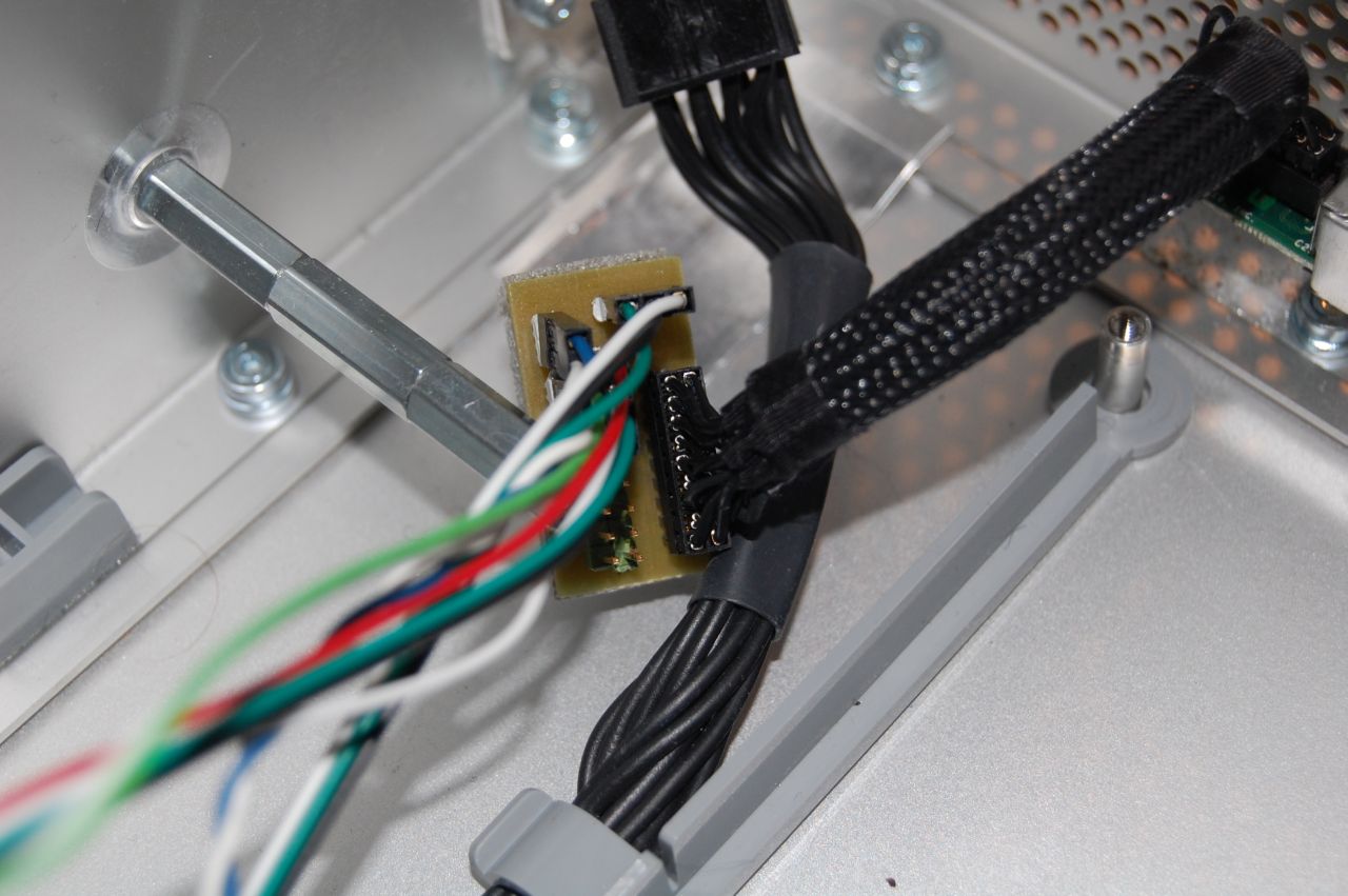

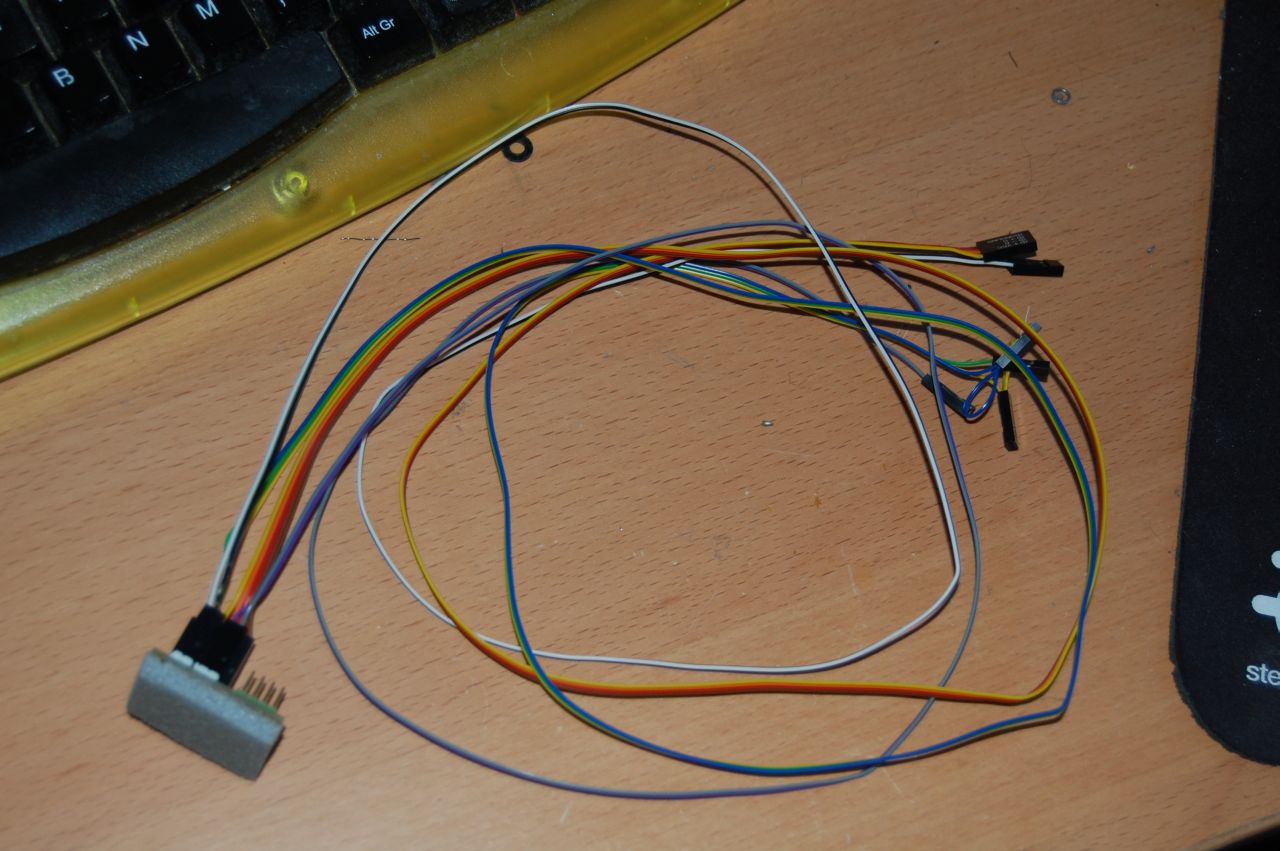

(XS)s0lid Posted March 26, 2009 Share Posted March 26, 2009 Got one cable set almoust done, then i ran out of pins for those connector, need to go get more tomorrow. FW cabling left to do for this one. calbes are 73cm long so those shouldn't get too short. The color scheme is what it's, there weren't any other colorcoded cables.. If possible i'd rather not take more orders, well until i get this series done and shipped. Link to comment https://www.insanelymac.com/forum/topic/4525-discussion-fit-a-pc-in-a-g5-powermac-enclosure/page/32/#findComment-1116247 Share on other sites More sharing options...

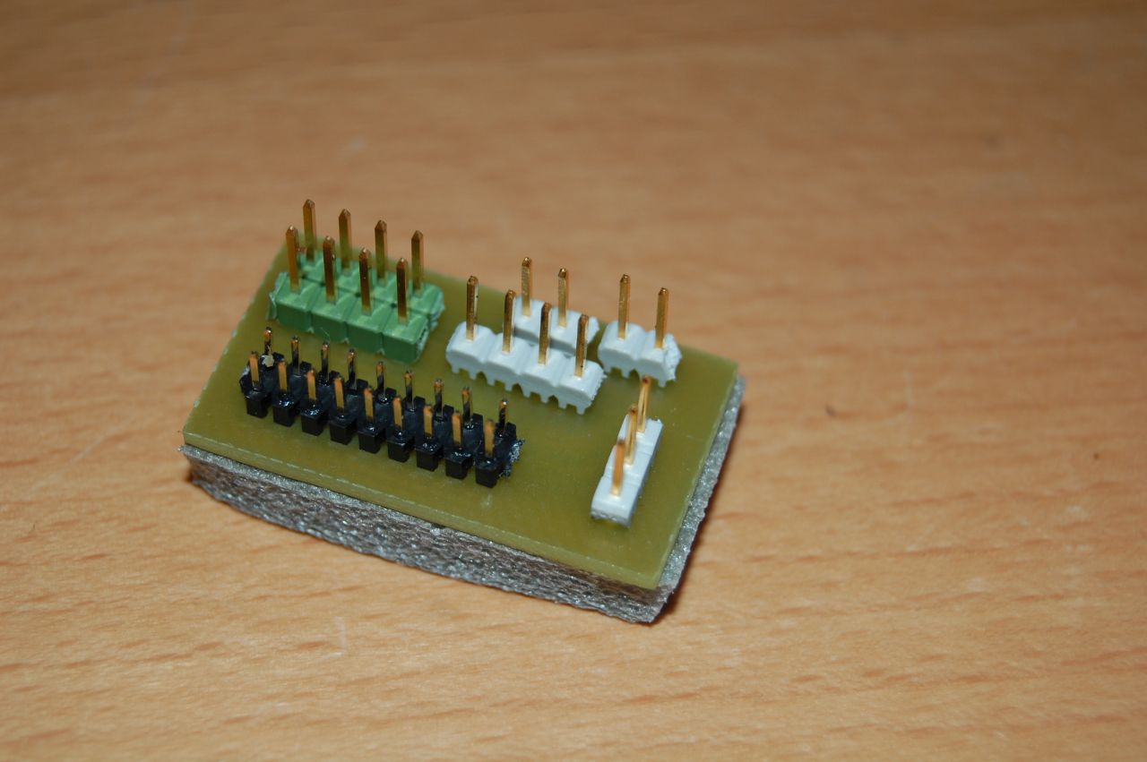

(XS)s0lid Posted March 30, 2009 Share Posted March 30, 2009 2 Boards soldered, need to get more connectors... Link to comment https://www.insanelymac.com/forum/topic/4525-discussion-fit-a-pc-in-a-g5-powermac-enclosure/page/32/#findComment-1119651 Share on other sites More sharing options...
