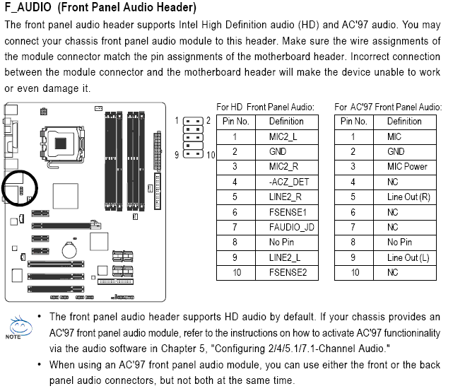

But my problem is the Audio connector. (see attachment for my MOBO audio connector pin out)
According earlier posts the G5 front audio pin out is as follows:
15 audio sense
16 audio com
17 audio right
18 audio left
The first problem that occurs is which layout to choose? HD Audio or AC'97?
When looking to my MOBO audio pinout for HD Audio, I was thinking the following:
pin 5 (LINE2_R) goes to G5 front pin 17 (AUDIO RIGHT)
pin 9 (LINE2_L) goes to G5 front pin 18 (AUDIO LEFT)
pin ?? goes to G5 front pin 15 (AUDIO SENSE) (I got FSENSE1 and FSENSE2 in the diagram, which one?)
pin ?? goes to G5 front pin 16 (AUDIO COM)
When looking to my MOBO audio pinout for AC'97, I was thinking the following:
pin 5 (Line out R) goes to G5 front pin 17 (AUDIO RIGHT)
pin 9 (Line out L) goes to G5 front pin 18 (AUDIO LEFT)
pin ?? goes to G5 front pin 15 (AUDIO SENSE) (Is there more to choose from?)
pin ?? goes to G5 front pin 16 (AUDIO COM) (Is there more to choose from?)
Conclusion is that in both cases I can already solder pin 5 en pin 9 from the audio connector to pin 17 and pin 18 of the G5 Front connector. But what to solder onto G5 front pin 15 and 16? Plese help me out! Thanks!
Another question, I have nothing to solder to pin 5 (CHASSIS GND FW s-ground) and pin 6 (CHASSIS GND USB s-ground) of the G5 connector? Am I right?

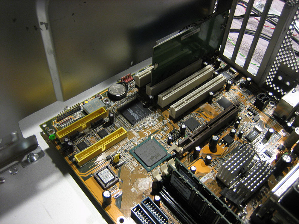

Add another G5 case to the list. My mod is underway!
I only wish I had bought a motherboard that was mATX, but thanks to all the modders that have gone before me, I've seen it can be done with a full ATX.
I'm still undecided on the "to cut (the back panel) or not to cut" debate. I'm going to work on adapting the front panel connections in the meantime.
Thanks again to everyone who has made this an invaluable resource to modding these cases!
Even if the dremel-in-box photo above wasn't a dead giveaway, this is the first type of project I've ever attempted. I'm glad I didn't totally hack the drive floor to bits! :(

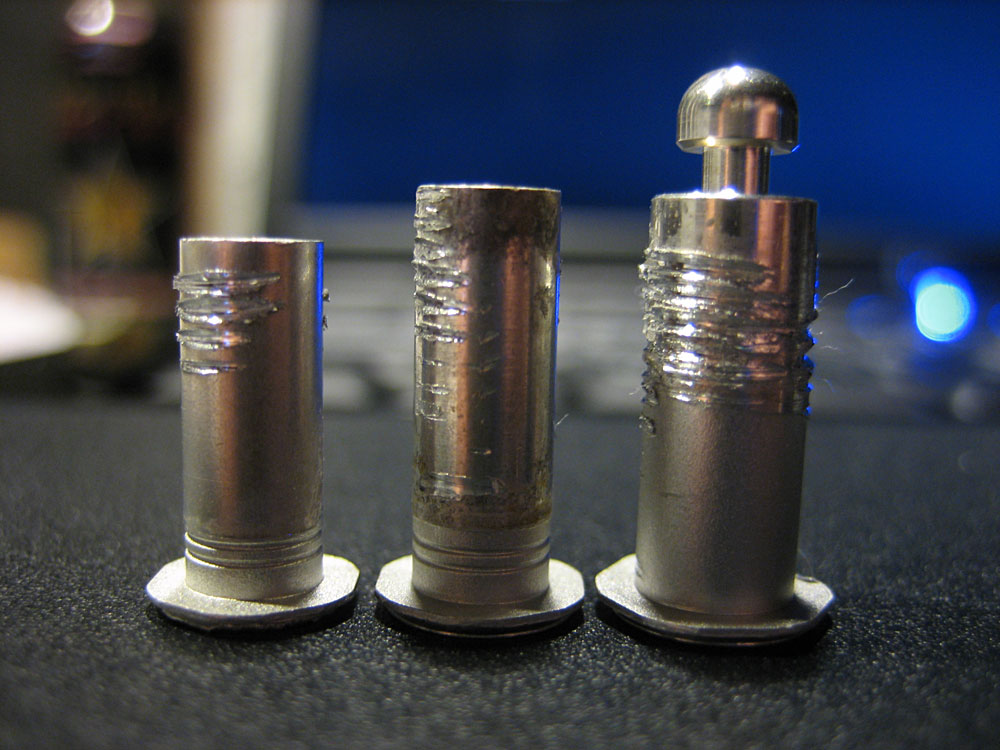

Also, I thought it was interesting that there are actually three different kinds of standoffs inside the G5 case. I tried to get a "standard" motherboard mounting screw into either of the standoffs that will accept screws, but it seems like the thread pattern might be a little more compact in the G5 standoffs. I could probaby force it to screw in, but I'd rather not have it bind up on me later. Can anyone give some input as to which screw will fit the G5 standoffs correctly?

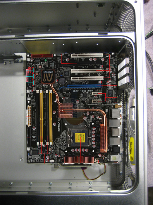

I'm mocking up my Asus P5K Deluxe wifi/ap board right now with a trusty "stuntman" from olden days just to see how my clearance will be. I Photoshopped the Deluxe board in there over the top of the old ATX board for fun. Thanks for the photo newegg!

I have my new standoffs made (I'll post the pics when I get home later on). I modified some standoffs that were too long that I picked up at RadioShack, set them into 1 inch squares of clear plexi, and bonded them down to the case with metal epoxy from Home Depot. After the first 24hrs, I'm happy with about 6 out of the 9 total being completely solid. The remaining 3 that were loose needed to be re-applied (I think they were set on parts of the epoxy that weren't a good 50-50 mix to bond/harden correctly)

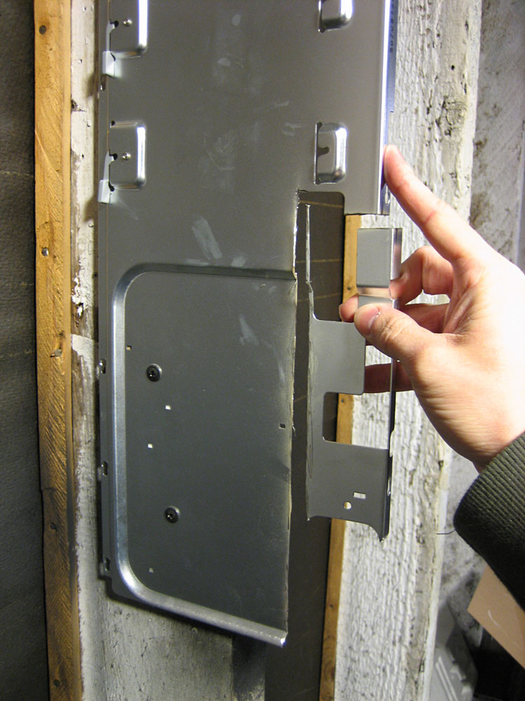

with my parts on the way, it was time to figure out a solution for the new power supply.
the PSU will actually exhaust out the bottom of the case. there is plenty of clearance, thanks to the G5 feet. a 90 degree power jumper will run back into the case through the bottom, and back to the rear of the G5.
that is my cut. a little filing and i'll be done.
there i have the psu plate installed using 1/8" rivets. just to the right of the psu plate is the power return hole. i have installed a radio shack rubber grommet into the through-hole.
there is the psu plate from the inside. looks nice and neat IMO. i will be installing exhaust fans there, as they will help prevent warm air from building up under the G5, and help get the CPU heat out.
that's an old PSU serving as a stunt double to demonstrate the arrangement since i don't have the real PSU yet.
well the bottom isn't going to be seen at all, where as the back will be sen at points even all the time depending on the positioning of the case. plus if you dont do the back right it can take away the integrity of the case.
