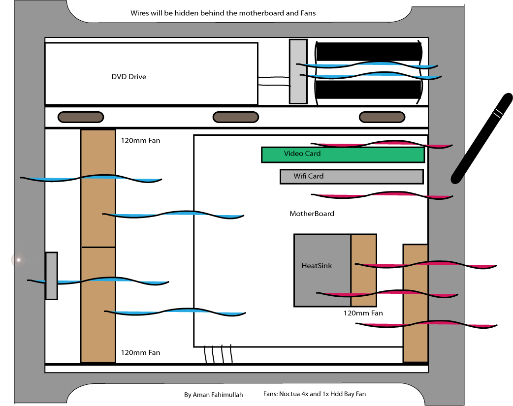

Ok dont get a Motherboard tray for this if you wanna redirect cables to the back. Just Mount with on the G5 lined up with the PCI ports and get a M-ATX and use your PSU Cover open up your psu stick it down their. Then get some Noctua fans stick them on the side. Get a good Heatsink for your north and south bridge, and CPU, Get 2 good hdd's. A nice M-ATX Gigabyte Board. Then Wire up your front panel and put one more noctua fan in the back. I made a little print of how mine is going to look.
Dont rush it take your time as I made that mistake. :P
