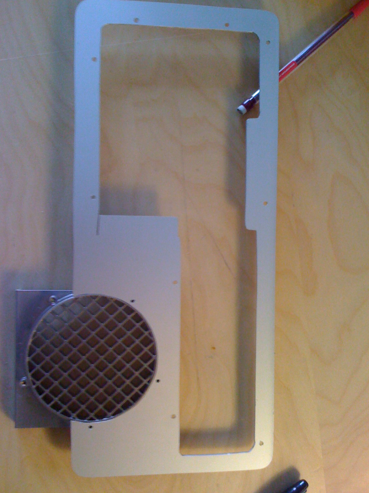

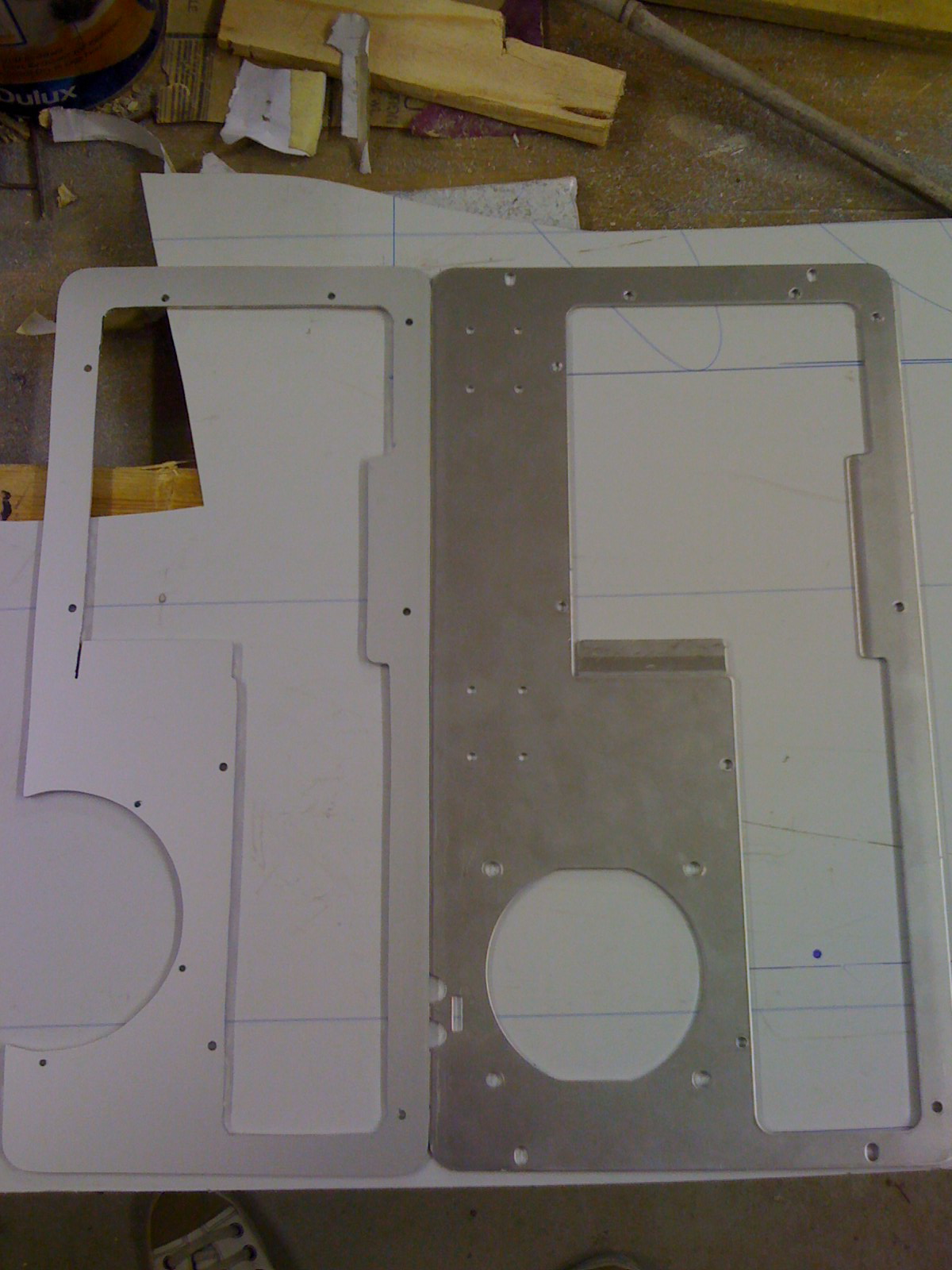

ѕӎѳѳ₮ңӌ Posted April 13, 2008 Share Posted April 13, 2008 Over the weekend i managed to make the replacement I/O back panel. I won't use this one as i will mill out the finished one when i get back to school, but this is the basic design. Excuse the {censored} iphone camera! Link to comment https://www.insanelymac.com/forum/topic/4525-discussion-fit-a-pc-in-a-g5-powermac-enclosure/page/20/#findComment-707195 Share on other sites More sharing options...
tazevedo317 Posted April 13, 2008 Share Posted April 13, 2008 does that cover up the entire back of the G5 enclosure? Link to comment https://www.insanelymac.com/forum/topic/4525-discussion-fit-a-pc-in-a-g5-powermac-enclosure/page/20/#findComment-707364 Share on other sites More sharing options...
ѕӎѳѳ₮ңӌ Posted April 13, 2008 Share Posted April 13, 2008 does that cover up the entire back of the G5 enclosure? No, i will make a cut out on the back of the case to the exact size of the I/O plate. I will fasten it to the case from behind with some aluminium strips. Doing it this way it will appear flush with the existing G5 rear. I'm gonna 'perforate' this test back plate to see how it looks and how strong it is. Could look quite good. I'll post some pics when i'm done, but im not gonna cut the case until i have made the final backpanel otherwise there will end up being gaps which i dont want! Link to comment https://www.insanelymac.com/forum/topic/4525-discussion-fit-a-pc-in-a-g5-powermac-enclosure/page/20/#findComment-707389 Share on other sites More sharing options...
nervouschimp Posted April 13, 2008 Share Posted April 13, 2008 olinboy1: thanks for that diagram, good work.... I never bothered with the audio, so thanks for the contribution! smoothy boothy, looks cool.... but.... if you wanna perforate, and you have access to a machine shop, why not go for the gold, and cut out the entire back mesh section from where it meets the solid top and bottom planes, make a whole replacement perforated back piece, bend it to match the rounded corners, and have tabs that match up with the internal fasteners that run around the sides? That would be awesome. Link to comment https://www.insanelymac.com/forum/topic/4525-discussion-fit-a-pc-in-a-g5-powermac-enclosure/page/20/#findComment-707446 Share on other sites More sharing options...
