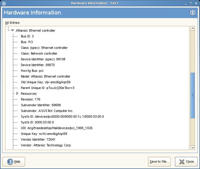

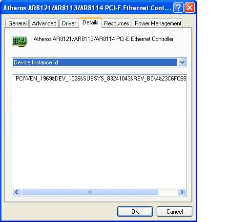

Jordan2Delta Posted August 28, 2008 Share Posted August 28, 2008 I changed the IOCPIMatch entry, like FFB73 to card ID: 1026 in the plist of the kext. Now at least the card will be recognized in the System Preferences! Using DHCP a self assigned IP Address is also there, but I tried file sharing between a Macbook or getting to the the internet through Ethernet. Nothing happens. I can't connect to any of it. Usually Internet and file sharing do well with other computers, so... What could I try next? I got a ASUS P5Q Pro motherboard. As for the driver the Atheros L1e on Windows is used. Oh, on Windows it just works by the way. The LSPCI Scan says for vendor etc.: Ethernet controller [0200]: Attansic Technology Corp. Unknown device [1969:1026] (rev b2) Link to comment https://www.insanelymac.com/forum/topic/40851-attansic-l1-driver-project/page/18/#findComment-871382 Share on other sites More sharing options...

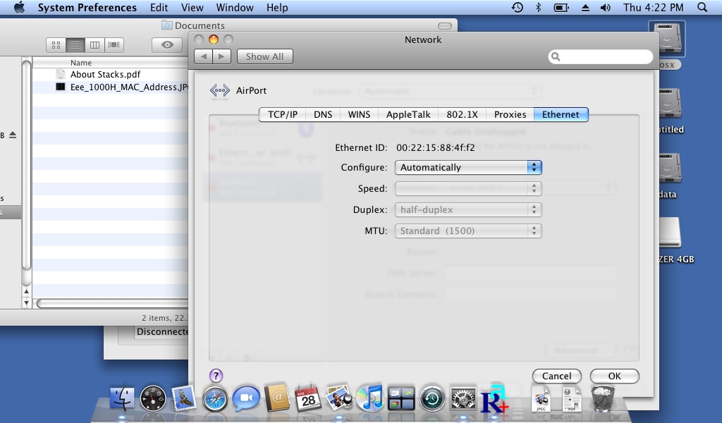

pdx_shark Posted August 29, 2008 Share Posted August 29, 2008 Hi, Attansic has been acquired by Atheros, so you may try using the driver, try adding the vendor id to the Info.plist more info here http://www.atheros.com/news/attansic_cmpt.html Hello, I have an Asus Eee 1000H with an Atheros LAN. So I tried this experiment and it almost worked I think because I see the correct MAC address inside Leopard. The strange thing in that the Atheros LAN card shows up in the 'Airport' entry which is not correct because that's for WLAN. (See attached pic1) Here what I did. From "P5KFamily.zip" I extracted the 'AttansicL1Ethernet.kext" folder then edited the Vendor and Device Id in the "Info.plist" to match what Windows XP says about the Atheros Lan card: Vendor(1969) Device(1026) XP's device manage say: "Atheros AR8121/AR8113/AR8114 PCI-E Ethernet Controller" (See attached pic3) Suse's Hardware Information says: "Attansic Ethernet controller" (See attached pic2) Perhaps DamonEs et al could take it look and get a working LAN driver for the Eee 1000H also. Many 1000H ownners could really benefit from this effort. I'd really appreciate it !!! Link to comment https://www.insanelymac.com/forum/topic/40851-attansic-l1-driver-project/page/18/#findComment-873282 Share on other sites More sharing options...
pdx_shark Posted August 30, 2008 Share Posted August 30, 2008 With a little more digging, I stumble upon the linux patch anouncement for the Atheros L1E inside the Eee 1000H. http://www.gossamer-threads.com/lists/linu...h_string=atl1e; So I gathered that Atheros L1 and Atheros L1E are different enough devices. This would explain why my hack with an L1 kext almost worked. Does anyone have a working kext for an Atheros L1E? Link to comment https://www.insanelymac.com/forum/topic/40851-attansic-l1-driver-project/page/18/#findComment-874192 Share on other sites More sharing options...
barnum Posted September 1, 2008 Share Posted September 1, 2008 With a little more digging, I stumble upon the linux patch anouncement for the Atheros L1E inside the Eee 1000H. http://www.gossamer-threads.com/lists/linu...h_string=atl1e; So I gathered that Atheros L1 and Atheros L1E are different enough devices. This would explain why my hack with an L1 kext almost worked. Does anyone have a working kext for an Atheros L1E? Hi, I have an ASUS P5Q PRO who came with an Atheros L1E card I modify the Info.plist file from <string>0x10481969 0x816810ec</string> to <string>0x10261969 0x816810ec</string> So now the card is detected but still don't work I have this log during the boot : [AttansicL1Ethernet] Error: Mac address through SPI is invalid Should I have to modify something else to make the card working ? Vincent Link to comment https://www.insanelymac.com/forum/topic/40851-attansic-l1-driver-project/page/18/#findComment-875774 Share on other sites More sharing options...
