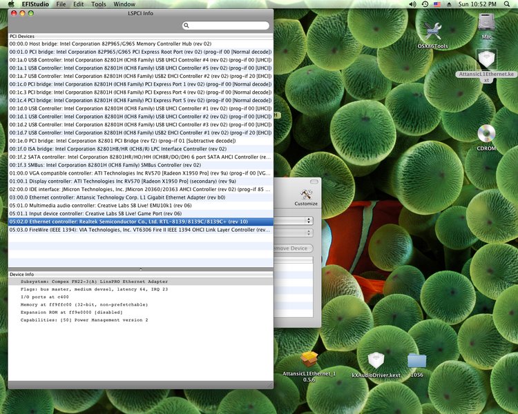

I got Acer Aspire 6920G notebook with Atheros Attansic ethernet card:
code from lcpi.txt:
02:00.0 Ethernet controller [0200]: Attansic Technology Corp. L1 Gigabit Ethernet Adapter [1969:1026] (rev b0)

You have a ATL1E [1969:1026] that is not the same device of this thread, and there is no kext for 1969:1026 device.
Check your Attansic device ID with DPCIManager.
