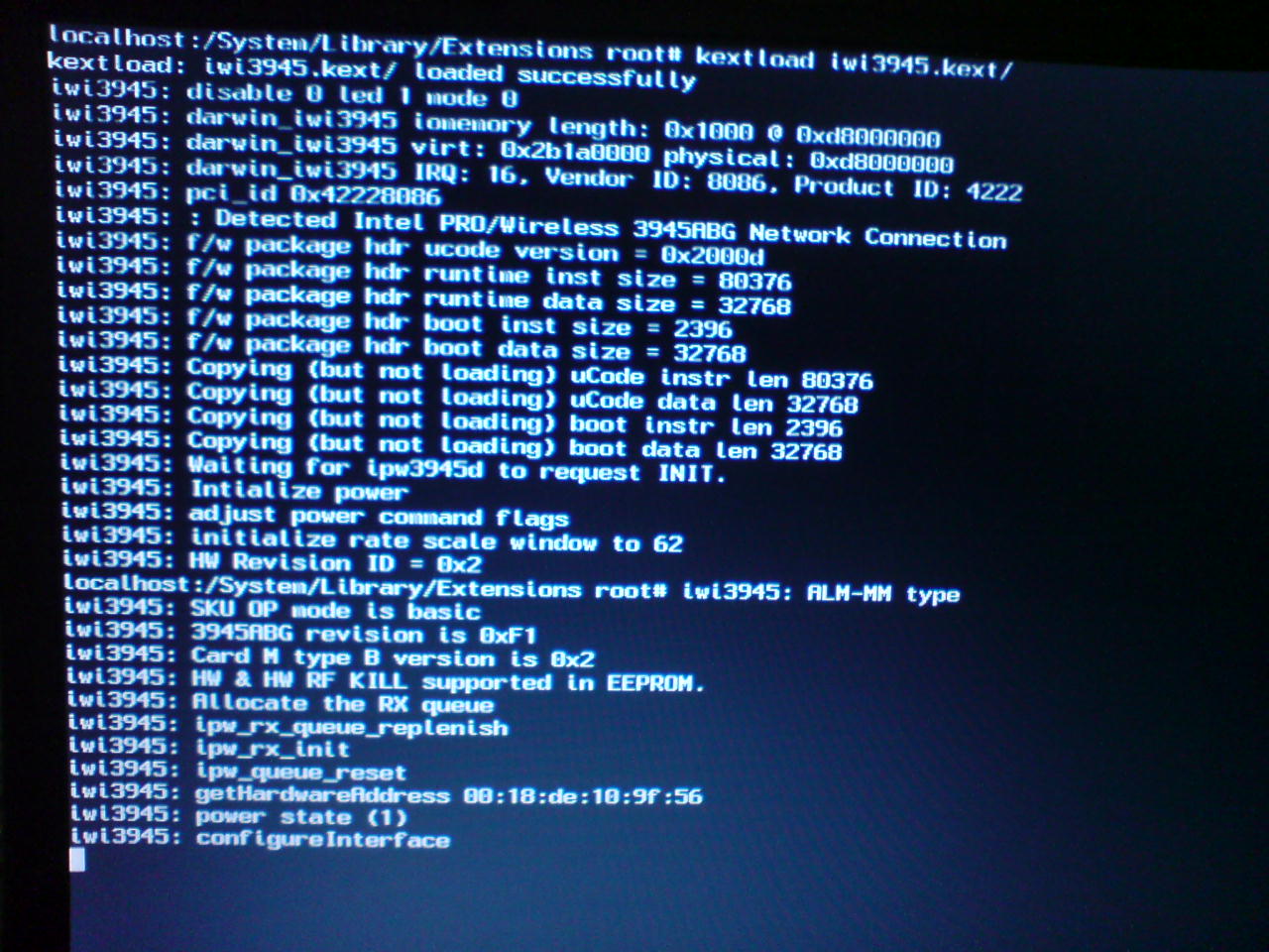

xhemp Posted April 16, 2007 Share Posted April 16, 2007 hello jalavoui, iwi3945 last version when mac os is booting, screen gets black and it doesn't go to the main os screen. here is the snapshot when I booted with -s switch. Link to comment https://www.insanelymac.com/forum/topic/36976-intel-wireless-driver/page/70/#findComment-348101 Share on other sites More sharing options...

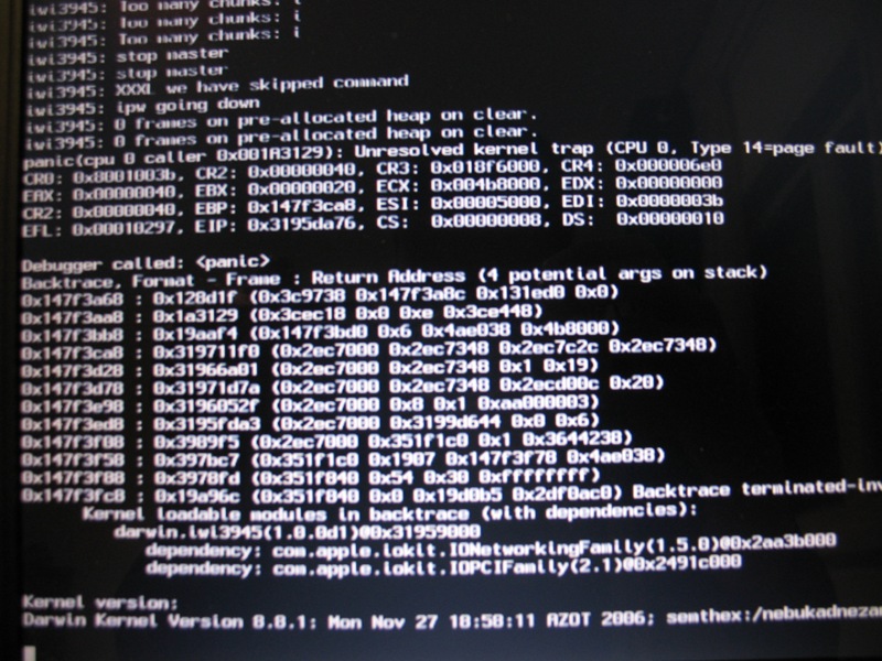

evis Posted April 16, 2007 Share Posted April 16, 2007 Hi iwi3945 - kernel panic see the pic. Link to comment https://www.insanelymac.com/forum/topic/36976-intel-wireless-driver/page/70/#findComment-348164 Share on other sites More sharing options...

xhemp Posted April 16, 2007 Share Posted April 16, 2007 more versions to test iwi2100 rev 344 iwi3945 rev 345 http://code.google.com/p/iwidarwin/ Hello Jalavoui, Same problem that the older one, screen gets black on boot. Got a snapshot with -s in boot. tks. Link to comment https://www.insanelymac.com/forum/topic/36976-intel-wireless-driver/page/70/#findComment-348305 Share on other sites More sharing options...

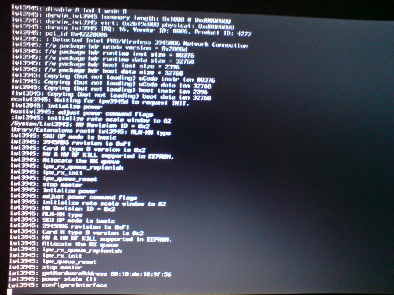

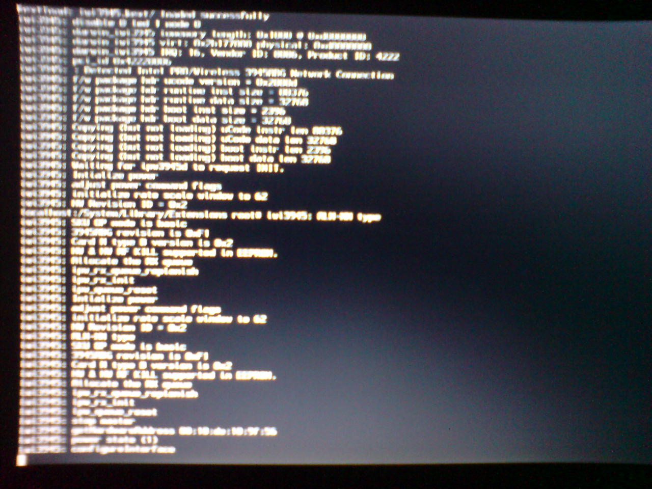

xhemp Posted April 16, 2007 Share Posted April 16, 2007 hi jalavoui, iw3945 rev 349, screen gets blank on boot like rev 346 and 347 here is the snapshot. tks Link to comment https://www.insanelymac.com/forum/topic/36976-intel-wireless-driver/page/70/#findComment-348375 Share on other sites More sharing options...
jalavoui Posted April 16, 2007 Author Share Posted April 16, 2007 iwi3945 rev 350 these logs are comming slow - just kidding i hope this release don't panic xhemp, can you check if you mac os x is ok? - you're the only one who still gets kernel panics i'll go back and use rev 348 - if it worked for you. i need to understand where it fails Link to comment https://www.insanelymac.com/forum/topic/36976-intel-wireless-driver/page/70/#findComment-348376 Share on other sites More sharing options...

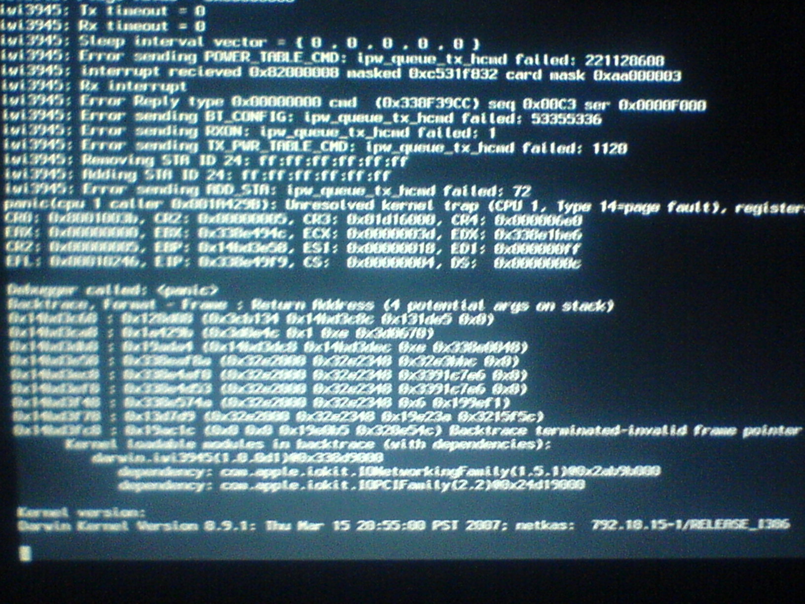

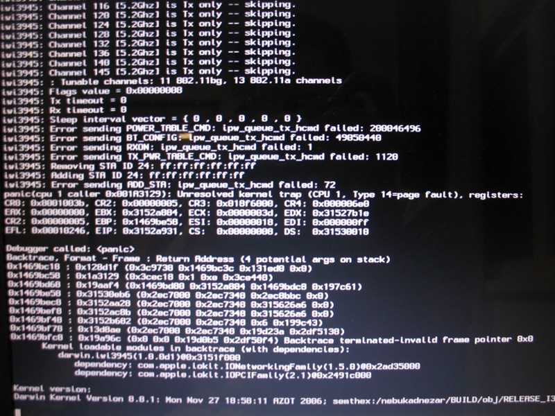

evis Posted April 16, 2007 Share Posted April 16, 2007 Ok I have Kernel Panic too - in rev 349... here is the pic now trying 350 *** maybe becuase I have the 80211 frameork and kext of OS X 10.4.7? Link to comment https://www.insanelymac.com/forum/topic/36976-intel-wireless-driver/page/70/#findComment-348384 Share on other sites More sharing options...
