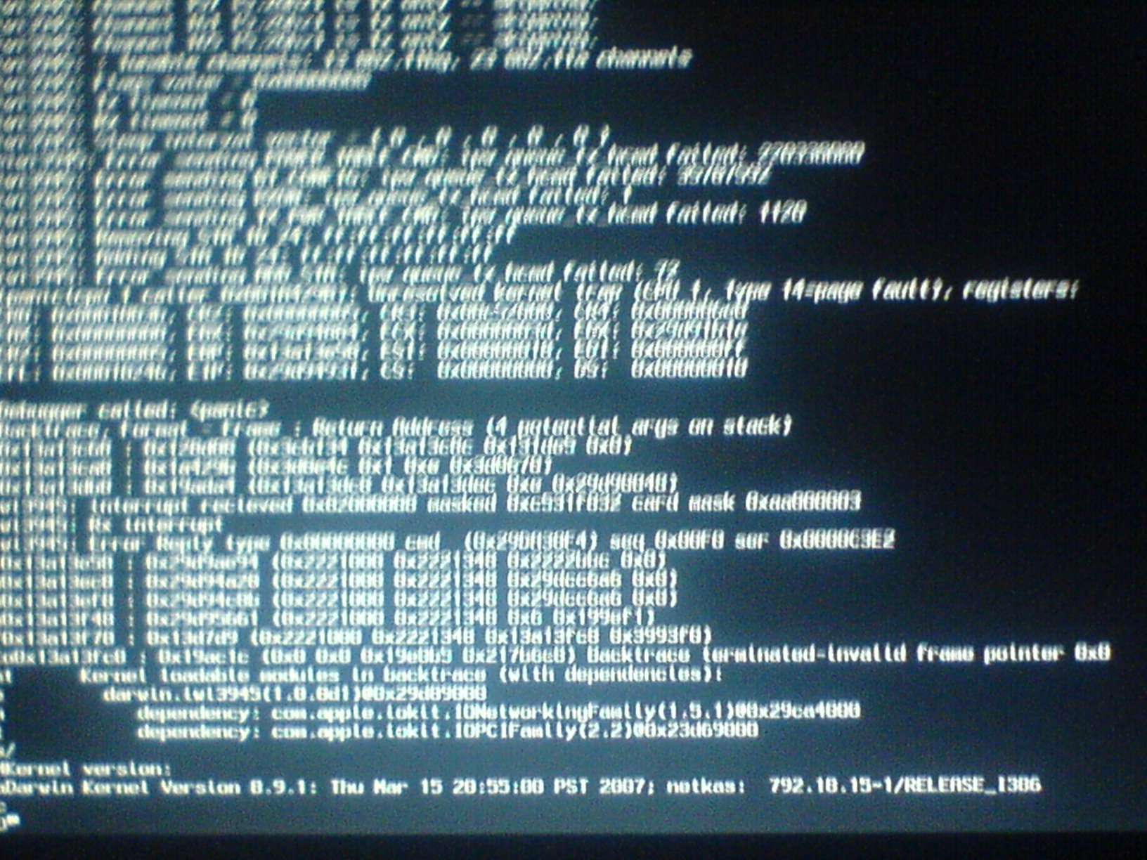

jalavoui Posted April 14, 2007 Author Share Posted April 14, 2007 I can safe boot, but don't think the logs will help, because the iwi kext isn't loaded in safe boot. read previous post - i explain how to do it for iwi2100... iwi2200 rev 340 changes for mbuf cluster bug please check if the bug still occurs can someone write an howto in iwidarwin for boot with -s and get log messages? if you get kernel panics boot with -s check the disc with fsck -fs if you get errors that fsck can't fix you'll have to format and reinstall mac os. can try diskwarrior to fix it if fsck fails from time to time i have to do this - really sucks Link to comment https://www.insanelymac.com/forum/topic/36976-intel-wireless-driver/page/68/#findComment-346945 Share on other sites More sharing options...
WaldMeister Posted April 14, 2007 Share Posted April 14, 2007 Well, i'll install the new kext, after deactivating all the protocols, if it helps, i'll post the logs Thanks in advance Edit: Sorry, my hand isn't that steady No log, but a photo about the kernel panic. It's about the IONetworkingFamily and IOPCIFamily. The last line are readable, i hope it's enough. And if not, someone should explain to me, how to get the log of that. can someone write an howto in iwidarwin for boot with -s and get log messages? I'll do that tomorrow, i'm off now. About the log messages, it's already in the FAQ Link to comment https://www.insanelymac.com/forum/topic/36976-intel-wireless-driver/page/68/#findComment-346948 Share on other sites More sharing options...
