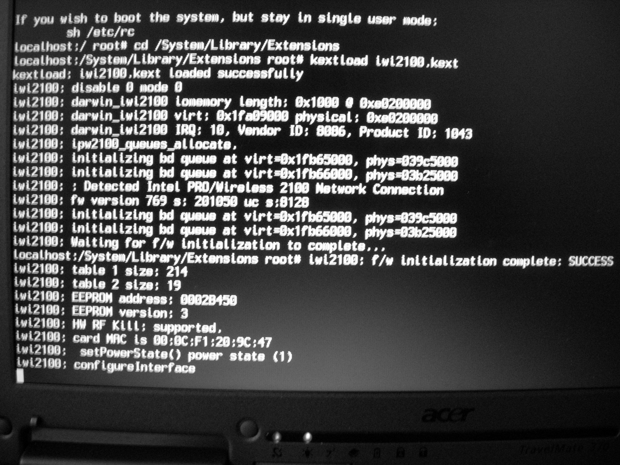

jalavoui Posted April 13, 2007 Author Share Posted April 13, 2007 iwi2100 since last version as all the code needed to make the driver work, now is time to find where the driver crashes. boot with -s option, then type cd /System/Library/Extensions kextload iwi2100.kext send me a picture,log of what happens so i can fix and make the driver work - it's about time iw2200 i still haven't find a way to fix the mem leak bug - it's killing me iwi3945 need to write missing rx functions all iwi drivers please check you system.log file before sending - checkm if the file as all the log from drive start - end otherwise i don't understand the logs ciper, i like you idea about the options stuff - can you try to write some code for that? where's moses? he's the guy who started networkselector about the mem leek bug who can explain me this? Macx86:~ root# netstat -m 599 mbufs in use: 595 mbufs allocated to data 3 mbufs allocated to socket names and addresses 1 mbufs allocated to Appletalk data blocks 238/544 mbuf clusters in use 0/16 mbuf 4KB clusters in use 1301 Kbytes allocated to network (48% in use) 0 requests for memory denied 0 requests for memory delayed 0 calls to protocol drain routines Link to comment https://www.insanelymac.com/forum/topic/36976-intel-wireless-driver/page/67/#findComment-346190 Share on other sites More sharing options...
eclau Posted April 13, 2007 Share Posted April 13, 2007 Hi jalavoui, iwi2100 rev 334 JaS 10.4.8 sse2 Here is the screenshot in single user mode. Link to comment https://www.insanelymac.com/forum/topic/36976-intel-wireless-driver/page/67/#findComment-346254 Share on other sites More sharing options...
