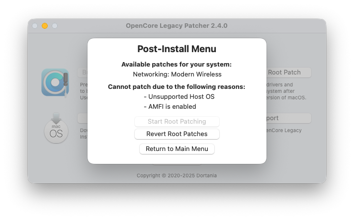

SavageAUS Posted June 25, 2025 Share Posted June 25, 2025 [mention=1390874]Anto65[/mention] Is it possible to apply root patch from actual OCLP version (for modern wireless) despite Tahoe version is not yet there. Sorry for my bad English.I have tried without luck as that is all my AMD rig needs (wifi). Sent from my iPhone using Tapatalk 1 Link to comment https://www.insanelymac.com/forum/topic/361162-pre-release-macos-tahoe/page/61/#findComment-2834965 Share on other sites More sharing options...

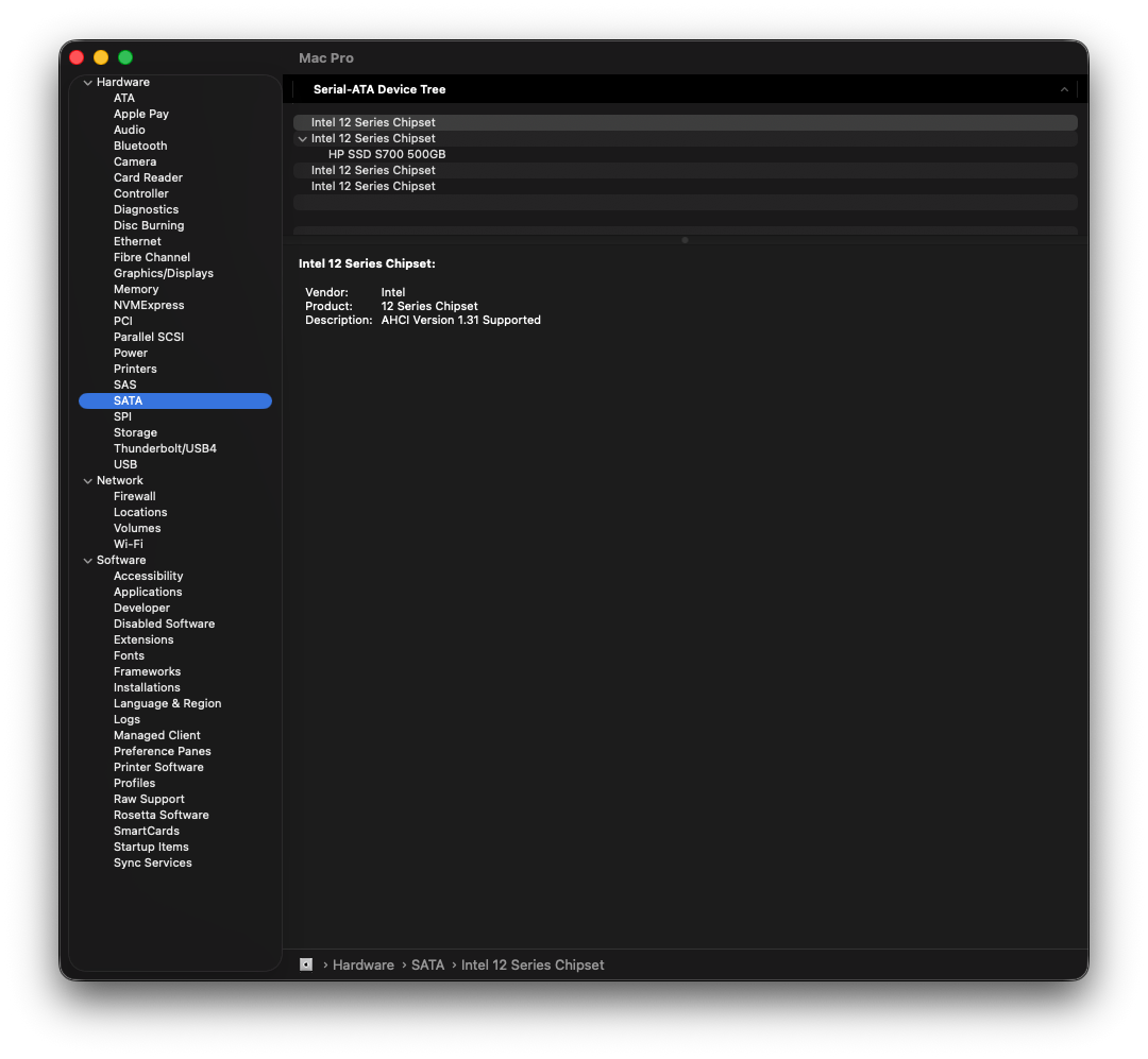

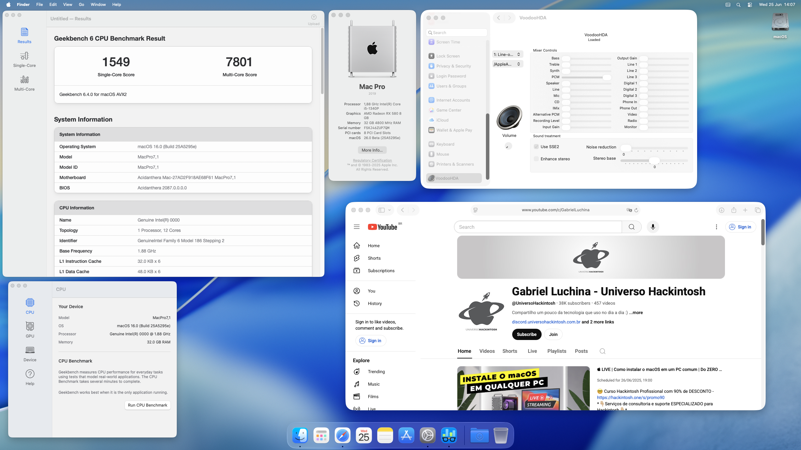

Luchina Posted June 25, 2025 Share Posted June 25, 2025 A rather peculiar setup, but it worked well with Beta 2. Erying M-ATX, i5 1340P (13th gen) (ES CPU/Engineer Sample) Radeon RX 580 8Gb Asus (via PCIe adapter, because this setup does not have a PCIe 16x slot because it is an engineering CPU). WiFi/BT BCM94360NG (not working in Tahoe) NVME Kingston NV2 1TB - Without WiFi (BCM) only. - Clean installation, with full installer (Tested also with online recovery and success). - Whatevergreen enabled for get a 120Hz with RX 5580. - Opencore and kexts updated to the latest commits available in Dortania Builds 6 Link to comment https://www.insanelymac.com/forum/topic/361162-pre-release-macos-tahoe/page/61/#findComment-2834971 Share on other sites More sharing options...

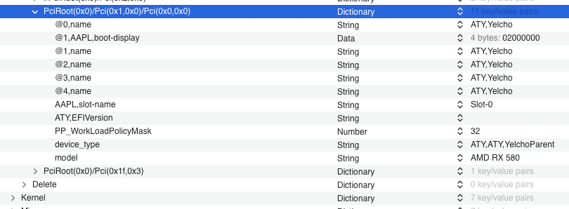

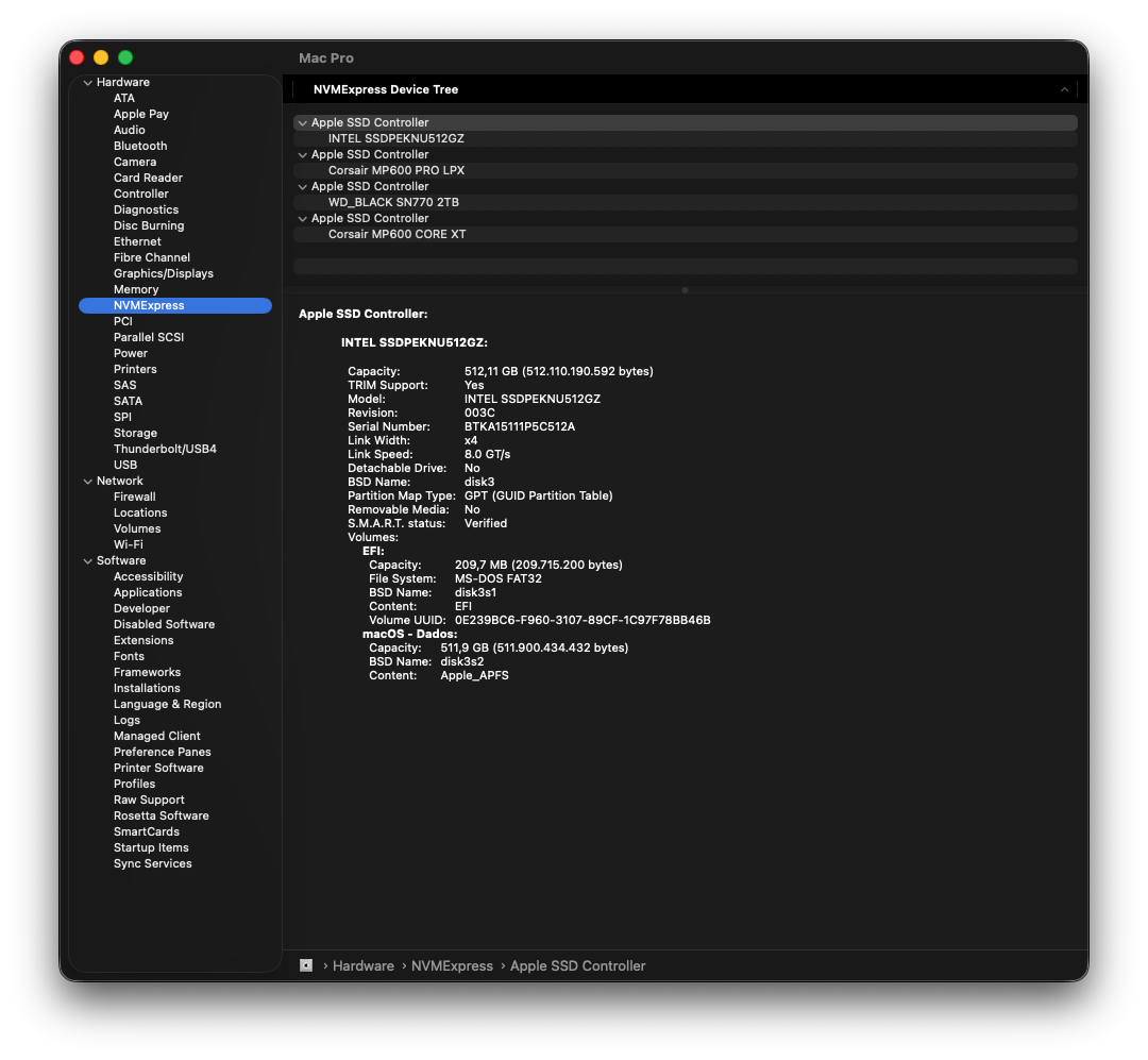

MaLd0n Posted June 25, 2025 Share Posted June 25, 2025 3 hours ago, MorenoAv said: @MaLd0n can I share it here? All is free and have topic here too with these folders 9 hours ago, surenmunoo said: So that will report SSD as AppleSSD like below screenshot? U can add a simple patch in Device Properties for NVME Quote <key>PciRoot(0x0)/Pci(0x6,0x0)/Pci(0x0,0x0)</key> <dict> <key>device-id</key> <data>BqgAAA==</data> <key>vendor-id</key> <data>TRQAAA==</data> <key>built-in</key> <data>AQAAAA==</data> </dict> For SATA serie 12 Quote <key>PciRoot(0x0)/Pci(0x17,0x0)</key> <dict> <key>compatible</key> <string>pci8086,a182</string> </dict> 11 6 Link to comment https://www.insanelymac.com/forum/topic/361162-pre-release-macos-tahoe/page/61/#findComment-2834972 Share on other sites More sharing options...

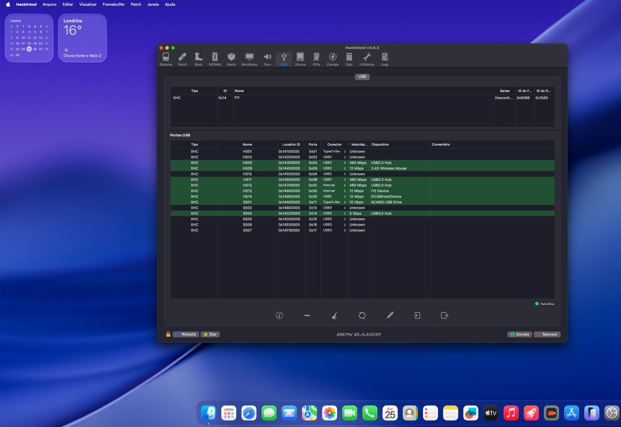

Max.1974 Posted June 25, 2025 Share Posted June 25, 2025 Hi Guys, Hackintosh and Beyond Team get new USBmap and USBport configuration to working fine in macOs Tahoe 26 Beta 2 Coming soon today on Youtube channel !!! Thanks to @CorpNewt Team 2 hours ago, mick3lson said: I finally managed clean install, I had to disable WhateverGreen.kext and replace it with NootRX.kext to boot with pendrive. All peripherals work except obviously wifi, the system is very stable and fast, in the next few days I will try to install other software to better test it. Thanks @Max.1974 for your EFI. Hi @mick3lson now I wish class about how get NootRX.kext working with my Clover, because I compile new kexts from RehabMan project and works on Tahoe, just black screen is the problem 8 Link to comment https://www.insanelymac.com/forum/topic/361162-pre-release-macos-tahoe/page/61/#findComment-2834990 Share on other sites More sharing options...
