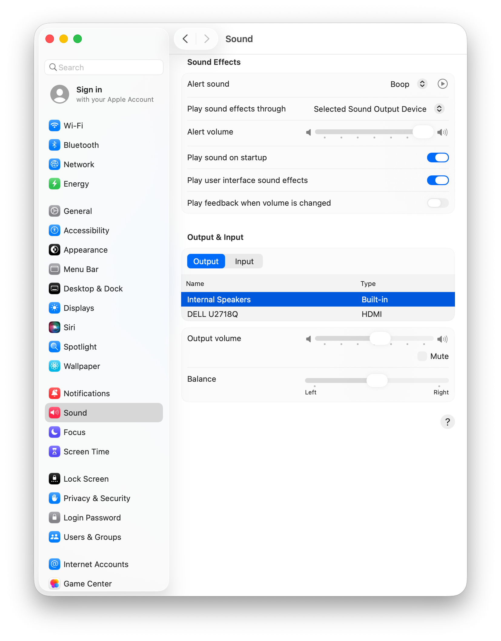

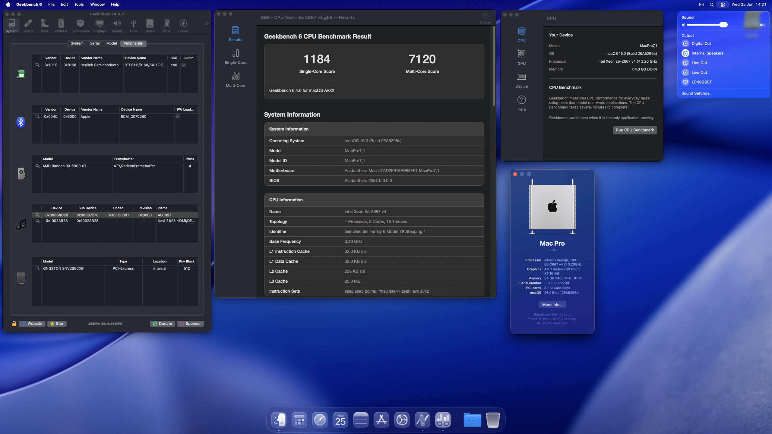

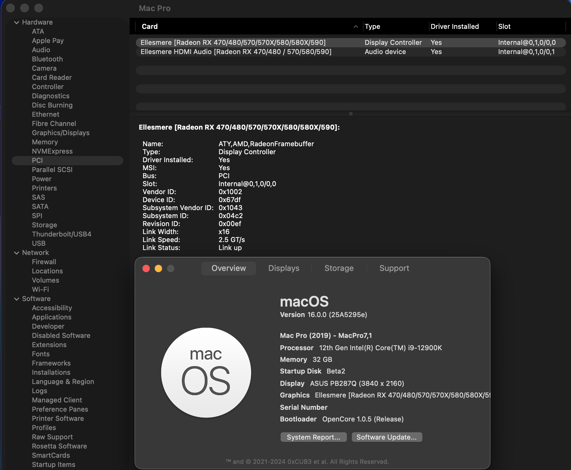

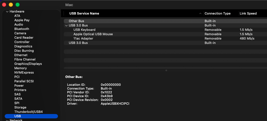

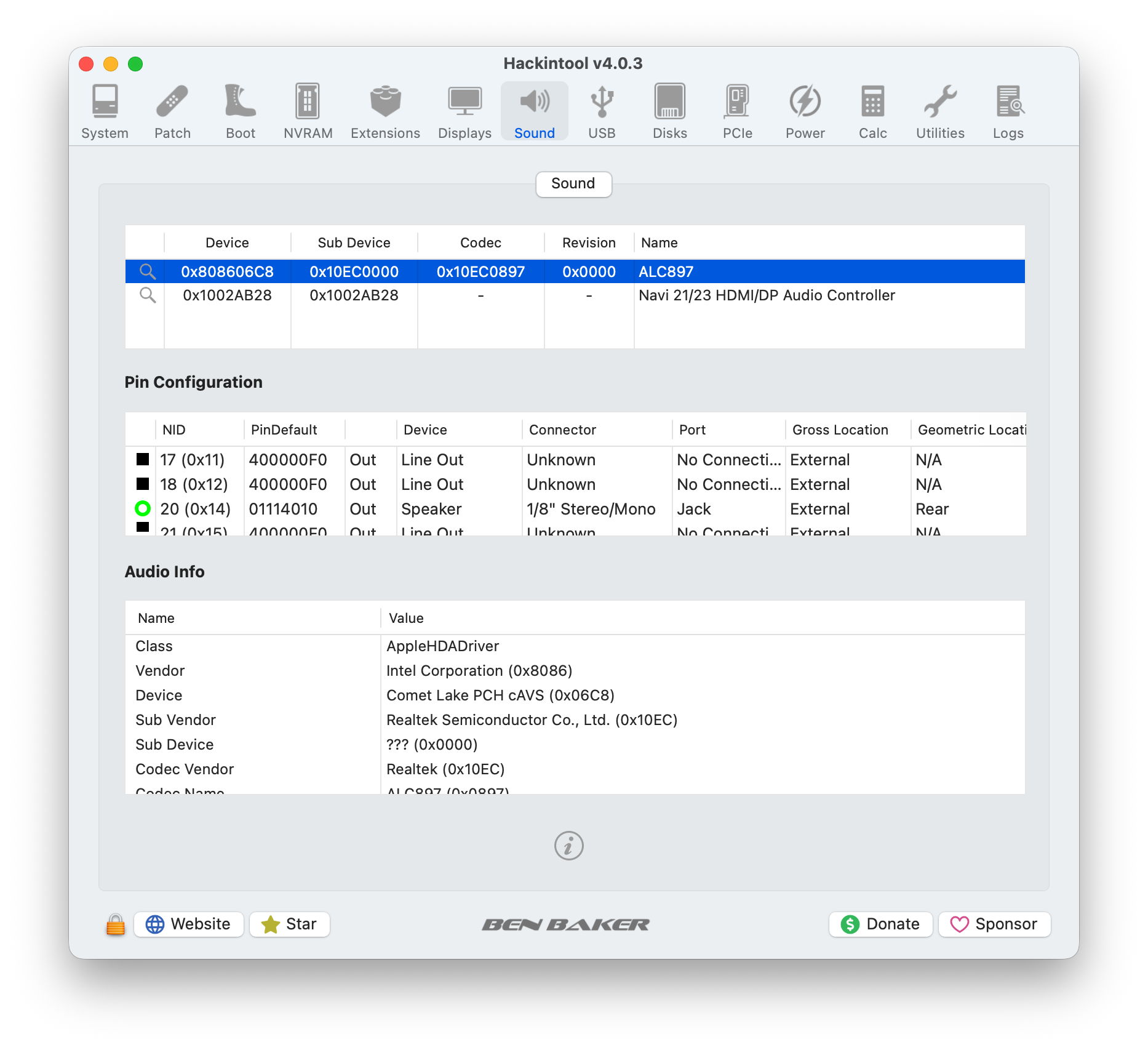

Luchina Posted June 25, 2025 Share Posted June 25, 2025 Another configuration with Beta 2. Qiyida X99 H9S C612 Intel Xeon E5 2667 V4 4x 16Gb DDR4 ECC AMD Radeon RX 6900 XT Sapphire Realtek ALC897 NVME Kingson NV2 500Gb Audio working with AppleALC/AppleHDA 🚀 USBs all OK, converted in less than 30 seconds with the new USBMap that came out a few days ago. The only thing that doesn't work is the WiFi, but that's nothing new, the rest is OK! 3 Link to comment https://www.insanelymac.com/forum/topic/361162-pre-release-macos-tahoe/page/62/#findComment-2834999 Share on other sites More sharing options...

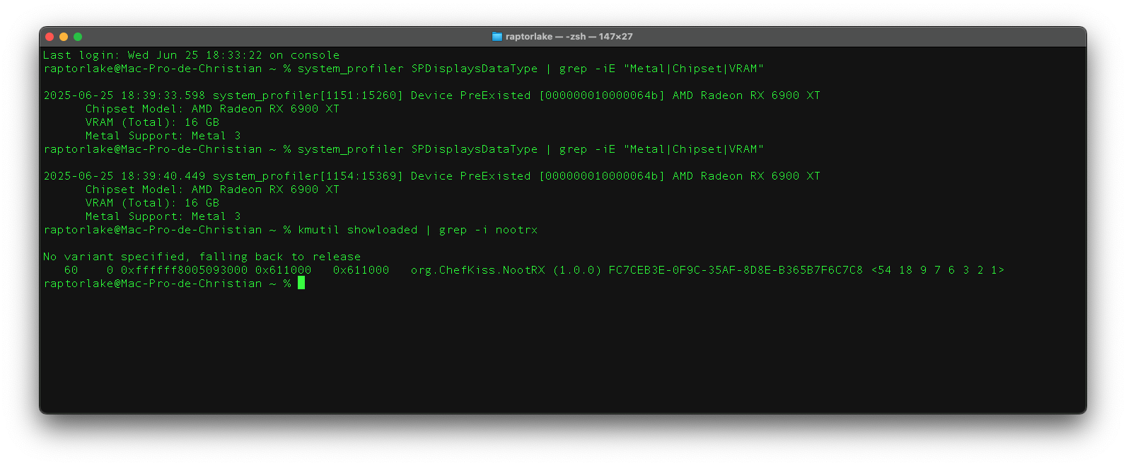

Max.1974 Posted June 25, 2025 Share Posted June 25, 2025 Guys with NootRX kext star from installer 😆 I have no idea how to works bit now fix it like @mick3lson said. Need use agdpmod=pikera, remove WEG and remove all Device Properties about your AMD Radeon EFI OC 105 NootRX AMD RX 6900 XT Aorus Z790 Elite AX Tahoe B2 FULL.zip. Thanks to @ChefKiss developer !!! https://chefkissinc.github.io/applehax/nootrx/ 5 1 Link to comment https://www.insanelymac.com/forum/topic/361162-pre-release-macos-tahoe/page/62/#findComment-2835001 Share on other sites More sharing options...

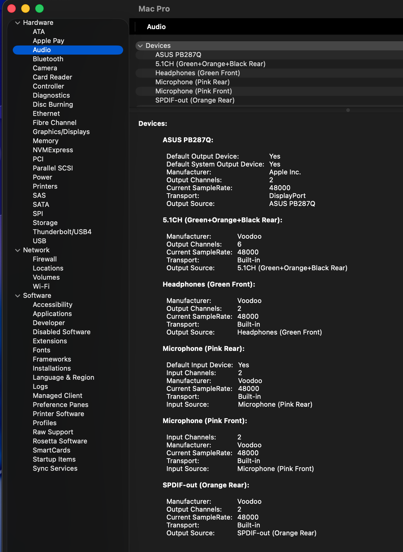

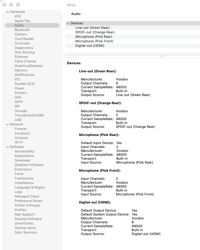

jsl Posted June 26, 2025 Share Posted June 26, 2025 8 hours ago, Luchina said: For those who want, the recoveries of the Tahoe Beta 1 and 2 https://hackintosh.one/s/recovery-tahoe-beta-1 https://hackintosh.one/s/recovery-tahoe-beta-2 It is ideal for those who want to create a new EFI, from Windows or Linux, and want to install macOS directly from Apple's servers. Thanks for this method which installed Tahoe beta 2 smoothly in my Z370 hackintosh. VoodooHDA fixed its audio successfully too ! 2 Link to comment https://www.insanelymac.com/forum/topic/361162-pre-release-macos-tahoe/page/62/#findComment-2835010 Share on other sites More sharing options...

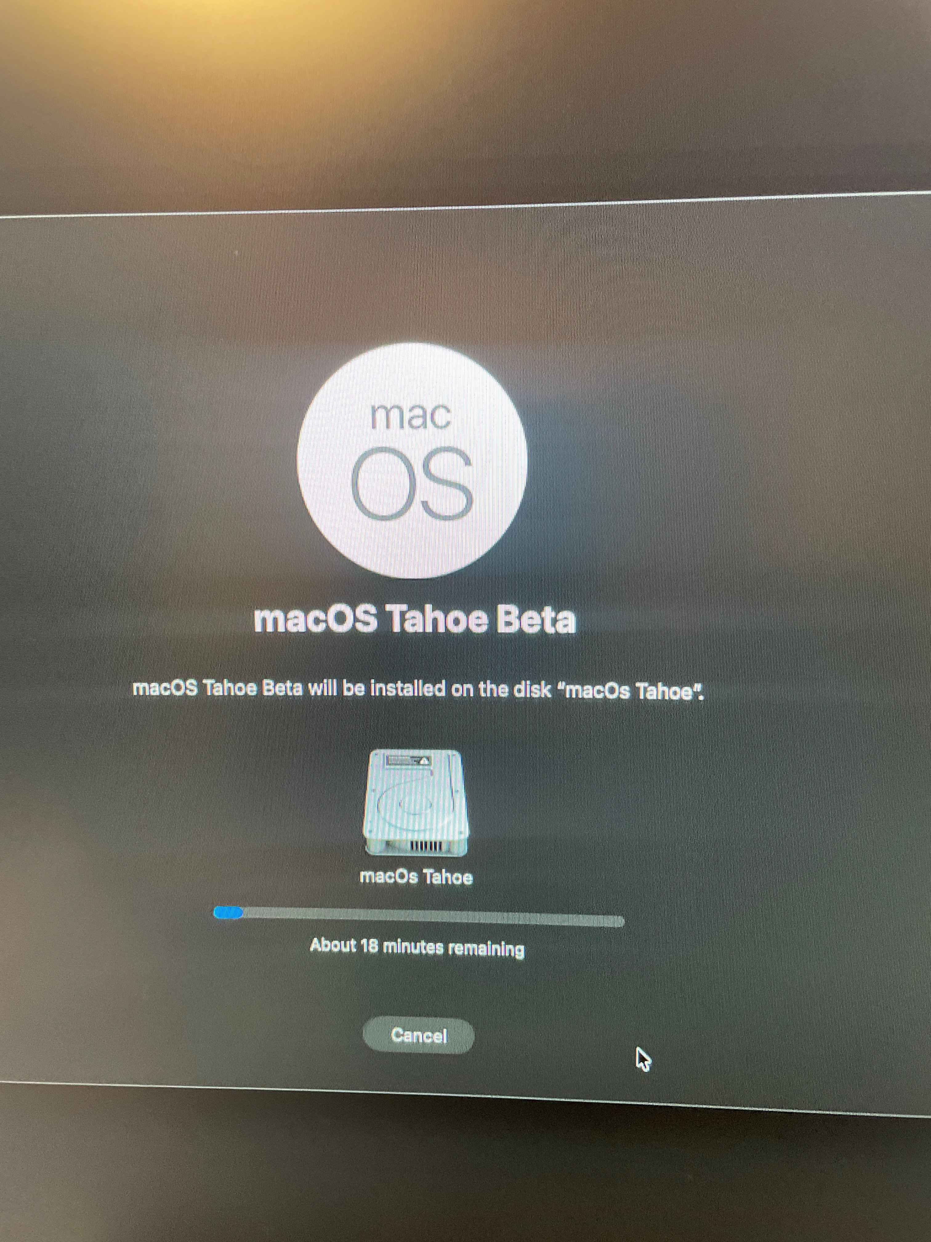

Joshua60 Posted June 26, 2025 Share Posted June 26, 2025 Try fresh install with USB Tahoe beta 2. No go! Hangs 17 minutes before end of installation. Link to comment https://www.insanelymac.com/forum/topic/361162-pre-release-macos-tahoe/page/62/#findComment-2835017 Share on other sites More sharing options...

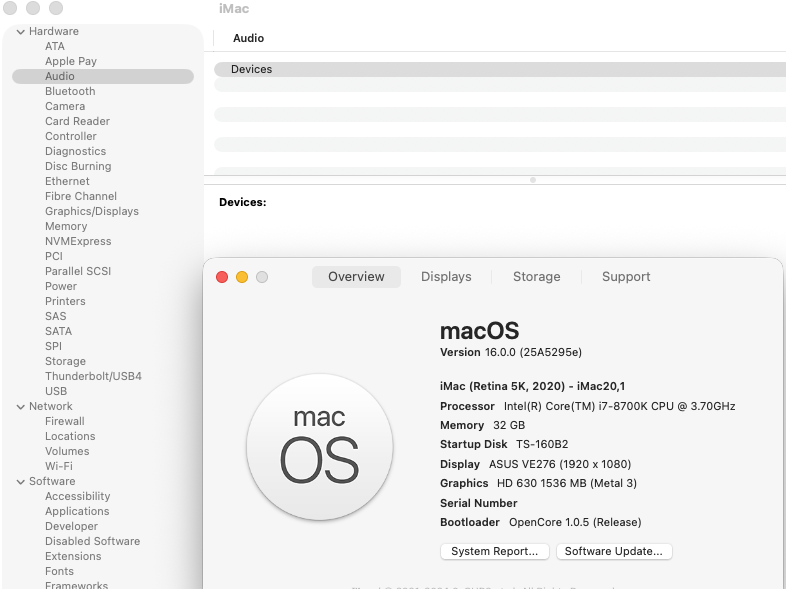

fusion71au Posted June 26, 2025 Share Posted June 26, 2025 7 hours ago, Luchina said: Another configuration with Beta 2. Qiyida X99 H9S C612 Intel Xeon E5 2667 V4 4x 16Gb DDR4 ECC AMD Radeon RX 6900 XT Sapphire Realtek ALC897 NVME Kingson NV2 500Gb Audio working with AppleALC/AppleHDA 🚀 USBs all OK, converted in less than 30 seconds with the new USBMap that came out a few days ago. The only thing that doesn't work is the WiFi, but that's nothing new, the rest is OK! Could you please elaborate on how you got audio working again with AppleALC/AppleHDA in DB2? Did you have to disable SIP? Did you use the AppleHDA.kext from DB1? Was it installed in /L/E or injected with OC or root patched in /S/L/E? Link to comment https://www.insanelymac.com/forum/topic/361162-pre-release-macos-tahoe/page/62/#findComment-2835018 Share on other sites More sharing options...
LockDown Posted June 26, 2025 Share Posted June 26, 2025 @fusion71au probably this I have yet to try it Link to comment https://www.insanelymac.com/forum/topic/361162-pre-release-macos-tahoe/page/62/#findComment-2835019 Share on other sites More sharing options...

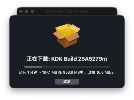

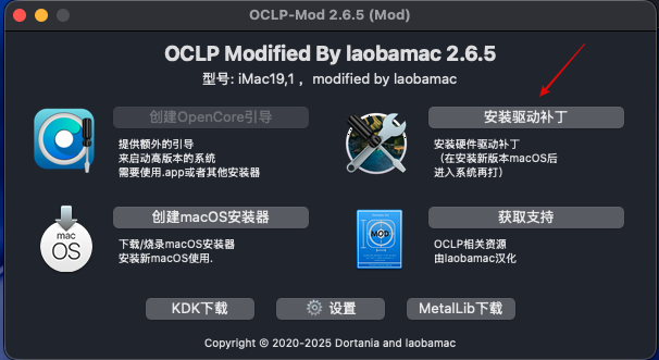

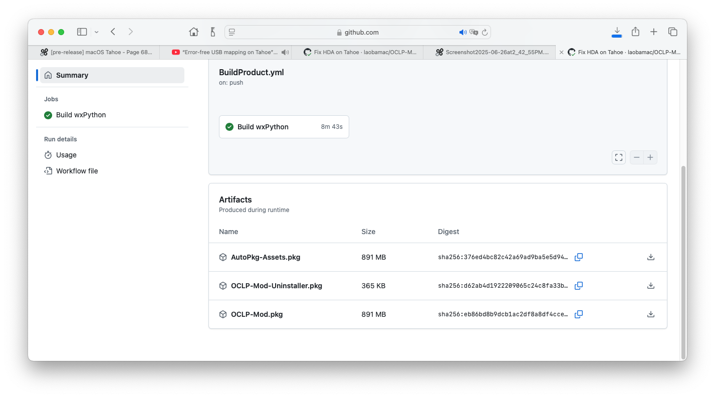

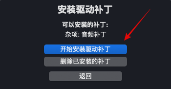

daliansky Posted June 26, 2025 Share Posted June 26, 2025 (edited) The fix from https://github.com/laobamac/OCLP-Mod/actions/runs/15883186157 has resolved the issue and made AppleHDA work again. As a result, AppleALC can regain its functionality. Thanks to the developer of OCLP-Mod, @laobamac. Edited June 26, 2025 by daliansky 12 3 Link to comment https://www.insanelymac.com/forum/topic/361162-pre-release-macos-tahoe/page/62/#findComment-2835020 Share on other sites More sharing options...

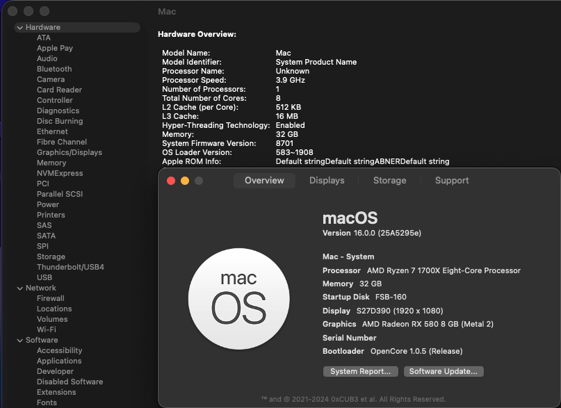

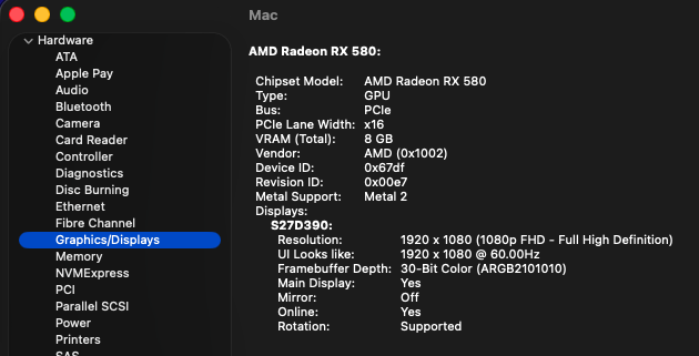

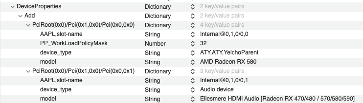

jsl Posted June 26, 2025 Share Posted June 26, 2025 (edited) 21 hours ago, jsl said: After repeated trial and errors at last my Ryzen 1700X hackintosh can boot TaHoe beta 2 now, but it's quite unstable ! Audio output from HDMI of RX580 is working, however Finder and Firefox are unstable for daily use ! [Edit] I found after edit config.plist as the following its stability is moderately improved ! The same Tahoe beta2 in my ASUS PRIME Z690-P D4 hackintosh working much, much better and stable than in ASUS X370 (CrossHair VI Hero)| CPU: Ryzen 1700X hackintosh. No Finder or Firefox issues at all and VoodooHDA working perfectly too ! Edited June 26, 2025 by jsl 1 Link to comment https://www.insanelymac.com/forum/topic/361162-pre-release-macos-tahoe/page/62/#findComment-2835024 Share on other sites More sharing options...

robi62 Posted June 26, 2025 Share Posted June 26, 2025 3 hours ago, daliansky said: The fix from https://github.com/laobamac/OCLP-Mod/actions/runs/15883186157 has resolved the issue and made AppleHDA work again. As a result, AppleALC can regain its functionality. Thanks to the developer of OCLP-Mod, @laobamac. hi which package did you use the mod or normal one??? Link to comment https://www.insanelymac.com/forum/topic/361162-pre-release-macos-tahoe/page/62/#findComment-2835030 Share on other sites More sharing options...

Anto65 Posted June 26, 2025 Share Posted June 26, 2025 (edited) Help yourself with official OCLP Then Edited June 26, 2025 by Anto65 3 1 Link to comment https://www.insanelymac.com/forum/topic/361162-pre-release-macos-tahoe/page/62/#findComment-2835033 Share on other sites More sharing options...
kaoskinkae Posted June 26, 2025 Share Posted June 26, 2025 9 minutes ago, Anto65 said: Help yourself with official OCLP Thanks as always I'm going to try 1 Link to comment https://www.insanelymac.com/forum/topic/361162-pre-release-macos-tahoe/page/62/#findComment-2835035 Share on other sites More sharing options...
Anto65 Posted June 26, 2025 Share Posted June 26, 2025 I uploaded more images...see above 1 Link to comment https://www.insanelymac.com/forum/topic/361162-pre-release-macos-tahoe/page/62/#findComment-2835036 Share on other sites More sharing options...
