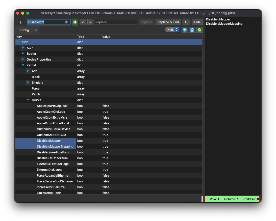

sok5 Posted June 26, 2025 Share Posted June 26, 2025 6 hours ago, Max.1974 said: Enable DisableIoMapper and DisableIoMapperMapping in Kernel > Quirks HeliPort.zip itlwm.kext.zip. itlwm doesn't work for me 1 Link to comment https://www.insanelymac.com/forum/topic/361162-pre-release-macos-tahoe/page/64/#findComment-2835073 Share on other sites More sharing options...
Anto65 Posted June 26, 2025 Share Posted June 26, 2025 (edited) Maybe you have to play with VT-D in bios and kernel quirks ? Tried it ? Edited June 26, 2025 by Anto65 2 Link to comment https://www.insanelymac.com/forum/topic/361162-pre-release-macos-tahoe/page/64/#findComment-2835074 Share on other sites More sharing options...

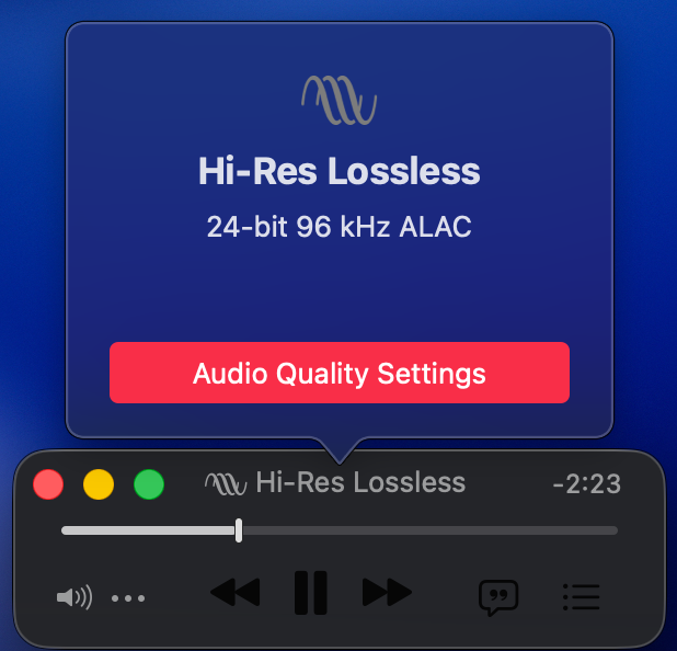

Takiller Posted June 26, 2025 Share Posted June 26, 2025 For the first time ever since I have been hackintoshing, I am enjoying hi-res lossless apple music and thanks to Teaho for messing with the sound kexts 🤪. This is what I call new discoveries in the last days of Hackintosh and surely am going to miss all this fun in the near future. I just so love my hybrid Hackintosh laptop 😜 1 1 Link to comment https://www.insanelymac.com/forum/topic/361162-pre-release-macos-tahoe/page/64/#findComment-2835077 Share on other sites More sharing options...

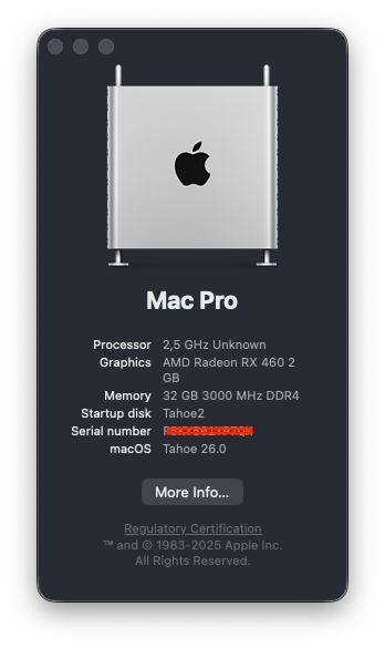

ori Posted June 26, 2025 Share Posted June 26, 2025 In the second Tahoe beta already works RX 460, which did not want to work at all with beta 1. 1 Link to comment https://www.insanelymac.com/forum/topic/361162-pre-release-macos-tahoe/page/64/#findComment-2835084 Share on other sites More sharing options...

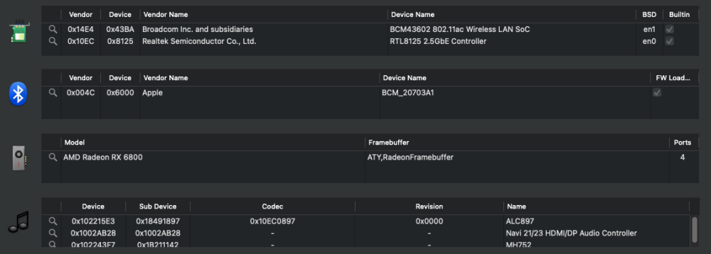

surfinchina Posted June 26, 2025 Share Posted June 26, 2025 Can someone please check my EFI? It's a maldon one (thanks for the work!!!) Tahoe installed on the Z690, ethernet and sound ok, no bluetooth or wifi yet - wifi because no OCLP, bluetooth dunno yet lol. Bios is just defaults with v-td enabled, although I tried it both ways. The issue is that it freezes. First time was good for a few hours and shutdown normally. After that it lasts in Tahoe (beta 2) for a second to a few minutes before it hangs. Could be software because I installed it from a Sequoia copy and it's loaded with my stuff. I've also tried weg (using nootrx atm), turned off usbinject all - I use the tahoe usbinjectall. Done nvram resets and the usual stuff. All the kexts and opencore up to date. I'm randomly playing with quirks now because I'm old and useless, but stubborn - would appreciate some help! Thanks for the work guys 😊 Z690RX6800.zip 1 Link to comment https://www.insanelymac.com/forum/topic/361162-pre-release-macos-tahoe/page/64/#findComment-2835085 Share on other sites More sharing options...

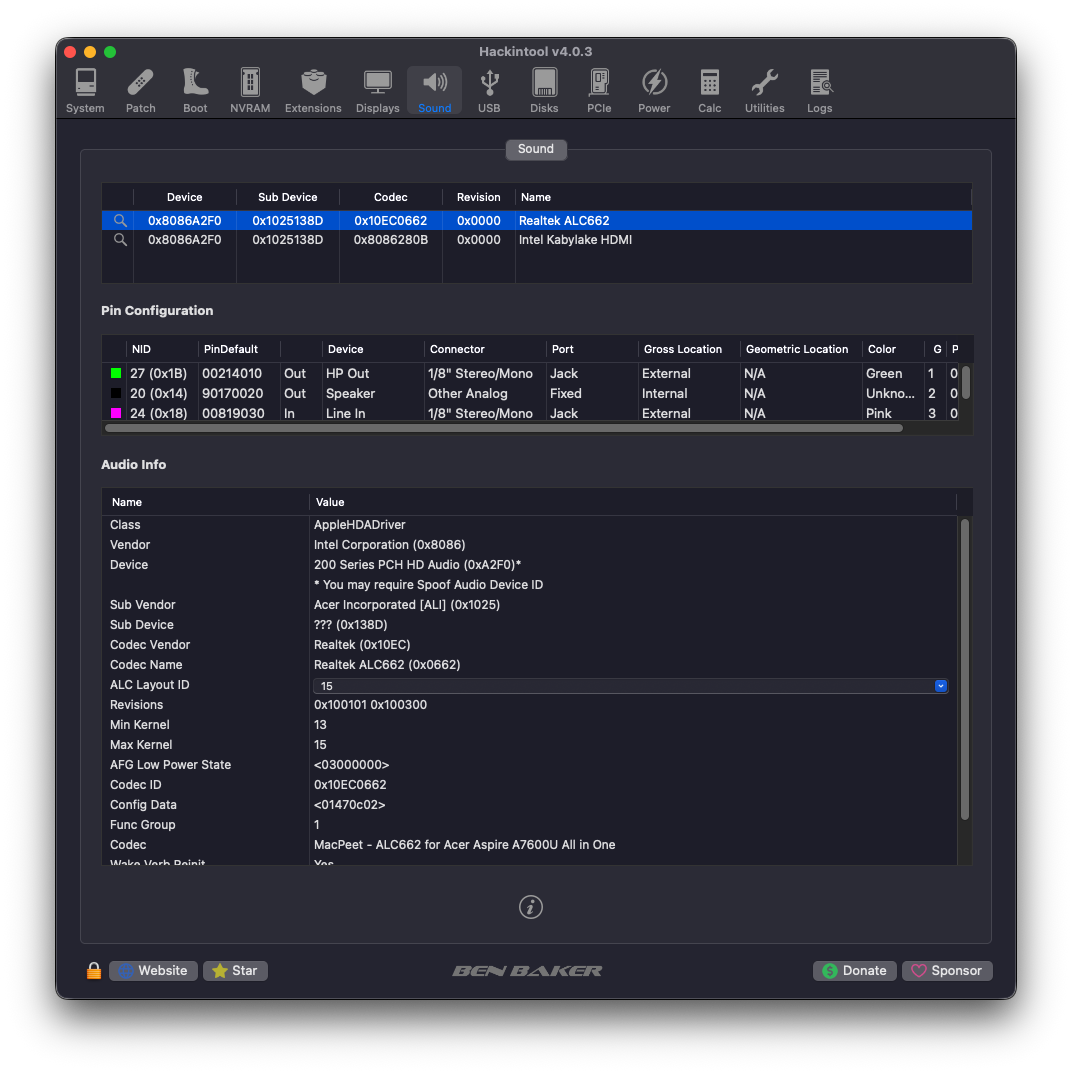

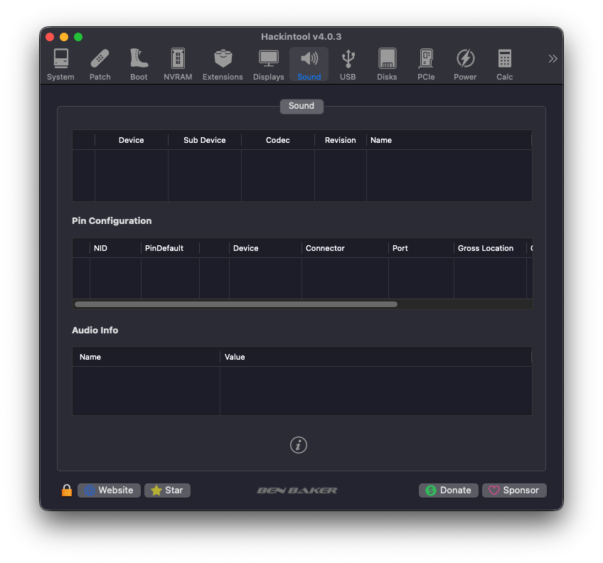

jlrycm Posted June 26, 2025 Share Posted June 26, 2025 9 hours ago, Anto65 said: OCLP-Mod 2.6.5 (Mod) Installing driver patches The following patches will be installed: Misc: Audio patches - Determining required patch sets for Darwin 25 Pulling KDK list from KdkSupportPkg API No direct match found for 25A5295e, falling back to closest match Closest match: 25A5279m (26.0) Recommended KDKs are as follows: - KDK build: 25A5279m - KDK version: 26.0 - KDK URL: https://gitapi.simplehac.top/https:// github.com/dortania/KdkSupportPkg/releases/download/ 25A5279m/ Kernel_Debug_Kit_26.0_build_25A5279m.dmg - Verifying root patches are available.... - Ready to patch! - Mounted Universal-Binaries.dmg -Running integrity check before proceeding with patching -Running patch for 10T8S1Y60T - Running precheck before patching - Found SkylightPlugins folder, deleting old plugins -Cleaning up auxiliary kernel collection - Moving EnergyDriver.kext kext to /Library/Relocated Extensions Extracted downloaded KDK disk image Install KDK package: KernelDebugKit.pkg - This may take a while... Back @Anto65 this OCLP-Mod requires lowering SIP, right? 1 Link to comment https://www.insanelymac.com/forum/topic/361162-pre-release-macos-tahoe/page/64/#findComment-2835086 Share on other sites More sharing options...
Irish_Man Posted June 26, 2025 Share Posted June 26, 2025 10 minutes ago, surfinchina said: Can someone please check my EFI? It's a maldon one (thanks for the work!!!) Tahoe installed on the Z690, ethernet and sound ok, no bluetooth or wifi yet - wifi because no OCLP, bluetooth dunno yet lol. Bios is just defaults with v-td enabled, although I tried it both ways. The issue is that it freezes. First time was good for a few hours and shutdown normally. After that it lasts in Tahoe (beta 2) for a second to a few minutes before it hangs. Could be software because I installed it from a Sequoia copy and it's loaded with my stuff. I've also tried weg (using nootrx atm), turned off usbinject all - I use the tahoe usbinjectall. Done nvram resets and the usual stuff. All the kexts and opencore up to date. I'm randomly playing with quirks now because I'm old and useless, but stubborn - would appreciate some help! Thanks for the work guys 😊 Z690RX6800.zip 4.63 MB · 4 downloads You should remove all Weg boot args since you don't Weg. Also, remove "dk.e1000=0" and leave "e1000=0". You don't need both. And try with less kexts enabled as possible. Especially those related to BT. Later you can enable one by one and see which one is the culprit. But the most important thing for you is to map you USB Ports and use created kext instead of USBInjectAll and XHCI kexts. Link to comment https://www.insanelymac.com/forum/topic/361162-pre-release-macos-tahoe/page/64/#findComment-2835087 Share on other sites More sharing options...
maly70 Posted June 26, 2025 Share Posted June 26, 2025 22 minutes ago, surfinchina said: Can someone please check my EFI? It's a maldon one (thanks for the work!!!) Tahoe installed on the Z690, ethernet and sound ok, no bluetooth or wifi yet - wifi because no OCLP, bluetooth dunno yet lol. Bios is just defaults with v-td enabled, although I tried it both ways. The issue is that it freezes. First time was good for a few hours and shutdown normally. After that it lasts in Tahoe (beta 2) for a second to a few minutes before it hangs. Could be software because I installed it from a Sequoia copy and it's loaded with my stuff. I've also tried weg (using nootrx atm), turned off usbinject all - I use the tahoe usbinjectall. Done nvram resets and the usual stuff. All the kexts and opencore up to date. I'm randomly playing with quirks now because I'm old and useless, but stubborn - would appreciate some help! Thanks for the work guys 😊 Z690RX6800.zip 4.63 MB · 5 downloads Hi there, remove: adgpmod=pikera usbinjectall.kext AppleIGC.kext AirportBrcmFixup.kext. (optional) dk.e1000=0 Link to comment https://www.insanelymac.com/forum/topic/361162-pre-release-macos-tahoe/page/64/#findComment-2835088 Share on other sites More sharing options...
surfinchina Posted June 26, 2025 Share Posted June 26, 2025 4 minutes ago, Irish_Man said: You should remove all Weg boot args since you don't Weg. Also, remove "dk.e1000=0" and leave "e1000=0". You don't need both. And try with less kexts enabled as possible. Especially those related to BT. Later you can enable one by one and see which one is the culprit. But the most important thing for you is to map you USB Ports and use created kext instead of USBInjectAll and XHCI kexts. Thanks! aml or kext with hackintool? Or does it not matter... Link to comment https://www.insanelymac.com/forum/topic/361162-pre-release-macos-tahoe/page/64/#findComment-2835089 Share on other sites More sharing options...

surfinchina Posted June 26, 2025 Share Posted June 26, 2025 14 minutes ago, maly70 said: Hi there, remove: adgpmod=pikera usbinjectall.kext AppleIGC.kext AirportBrcmFixup.kext. (optional) dk.e1000=0 Thanks maly! AppleIGC was needed for ethernet but I turned the rest off and so far so good. As a bonus I now have bluetooth. I'll get to work mapping USB ports now. Link to comment https://www.insanelymac.com/forum/topic/361162-pre-release-macos-tahoe/page/64/#findComment-2835092 Share on other sites More sharing options...
Anto65 Posted June 26, 2025 Share Posted June 26, 2025 42 minutes ago, jlrycm said: @Anto65 this OCLP-Mod requires lowering SIP, right? Same settings as official OCLP, obviously only the Amfi kext , Sip 03080000 , I didn't put any Block in the kernel Spoiler Befor After 2 1 Link to comment https://www.insanelymac.com/forum/topic/361162-pre-release-macos-tahoe/page/64/#findComment-2835093 Share on other sites More sharing options...
