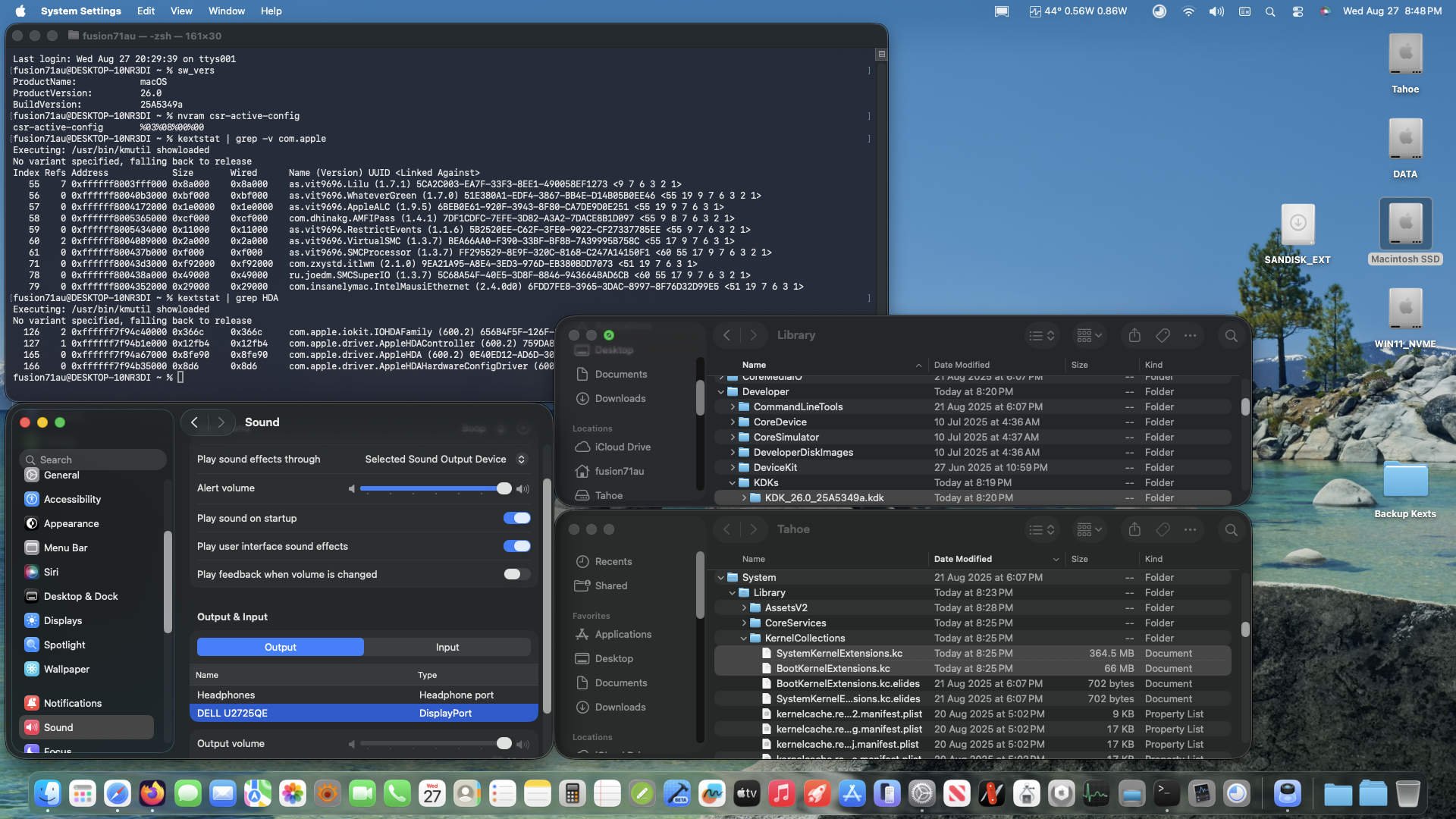

Another successful Tahoe Beta delta update aka "Groundhog Day" for my NUC6i5SYH 😜.  No change in settings from B6->B7->B8.
Root patched B8 with B1 AppleHDA and B8 KDK_26.0_25A5349a.kdk from Apple Developer or Dortania downloads...
Spoiler
fusion71au@DESKTOP-10NR3DI ~ % mount
/dev/disk1s4s1 on / (apfs, sealed, local, read-only, journaled)
devfs on /dev (devfs, local, nobrowse)
/dev/disk1s2 on /System/Volumes/Preboot (apfs, local, journaled, nobrowse)
/dev/disk1s6 on /System/Volumes/VM (apfs, local, noexec, journaled, noatime, nobrowse)
/dev/disk1s5 on /System/Volumes/Update (apfs, local, journaled, nobrowse)
/dev/disk1s1 on /System/Volumes/Data (apfs, local, journaled, nobrowse, root data)
map auto_home on /System/Volumes/Data/home (autofs, automounted, nobrowse)
/dev/disk6s1 on /System/Library/AssetsV2/com_apple_MobileAsset_PKITrustStore/purpose_auto/6dd55b0d06633a00de6f57ccb910a66a5ba2409a.asset/.AssetData (apfs, sealed, local, read-only, journaled, nobrowse)
/dev/disk0s3 on /Volumes/WIN11_NVME (ntfs, local, read-only, noowners, noatime, fskit)
/dev/disk3s2 on /Volumes/DATA (ntfs, local, read-only, noowners, noatime, fskit)
/dev/disk2s1 on /Volumes/Macintosh SSD — Data (apfs, local, journaled, nobrowse)
/dev/disk2s5 on /Volumes/Macintosh SSD (apfs, sealed, local, read-only, journaled)
/dev/disk4s1 on /Volumes/SANDISK_EXT (exfat, local, nodev, nosuid, noowners, noatime, fskit)
/dev/disk7s1 on /Volumes/Kernel Debug Kit (hfs, local, nodev, nosuid, read-only, noowners, quarantine, mounted by fusion71au)
fusion71au@DESKTOP-10NR3DI ~ % sudo mount -o nobrowse -t apfs /dev/disk1s4 /System/Volumes/Update/mnt1
Password:
fusion71au@DESKTOP-10NR3DI ~ % sudo ditto /Library/Developer/KDKs/KDK_26.0_25A5349a.kdk/System /System/Volumes/Update/mnt1/System
fusion71au@DESKTOP-10NR3DI ~ % sudo cp -R /Users/fusion71au/Desktop/Backup\ Kexts/AppleHDA.kext /System/Volumes/Update/mnt1/System/Library/Extensions
fusion71au@DESKTOP-10NR3DI ~ % sudo touch /System/Volumes/Update/mnt1/System/Library/Extensions
fusion71au@DESKTOP-10NR3DI ~ % sudo kmutil create --allow-missing-kdk --volume-root /System/Volumes/Update/mnt1 --update-all --variant-suffix release --no-authentication --no-authorization
checking collections...
Warning: com.apple.driver.KextExcludeList was not found!
updated kernel binaries (Mach-O UUID changed from <unknown> to <unknown>)
rebuilding release collections:
	boot kernel collection
	system kext collection
rebuilding local auxiliary collection
kmutil rebuild done
fusion71au@DESKTOP-10NR3DI ~ % sudo bless --folder /System/Volumes/Update/mnt1/System/Library/CoreServices --bootefi --create-snapshot
fusion71au@DESKTOP-10NR3DI ~ % sudo reboot
  • Like 9

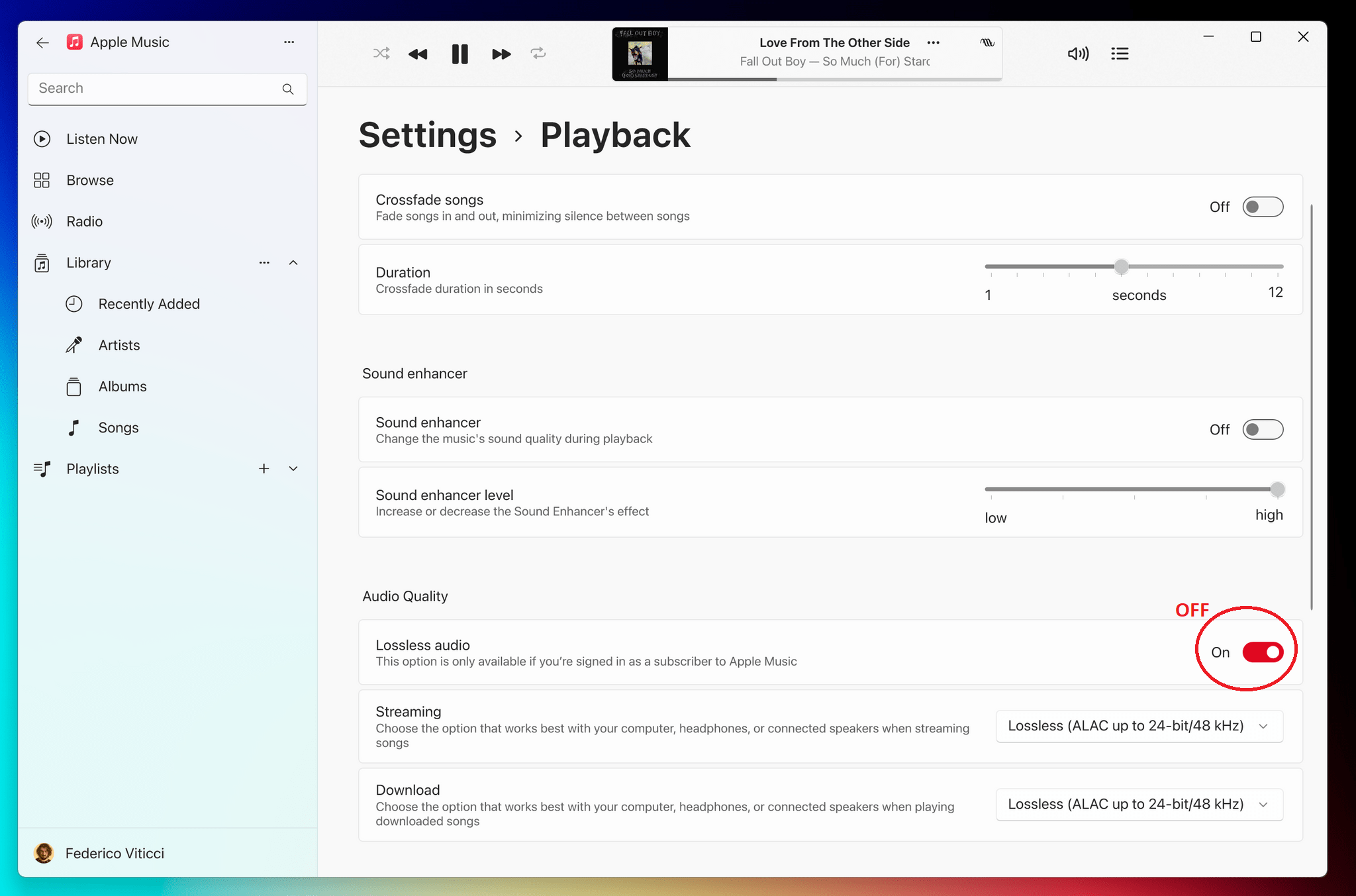

All tracks are played with the parameter unfairgva=4 in bootarg under Tahoe beta 8 on intel I7 8700 igpu. All radio stations are played, high-res quality played via USB DAC cx31993 good. Try to disable high-res (see pic) in the playback settings and try to find and play the AAC quality file in the library (not lossless). It should play.

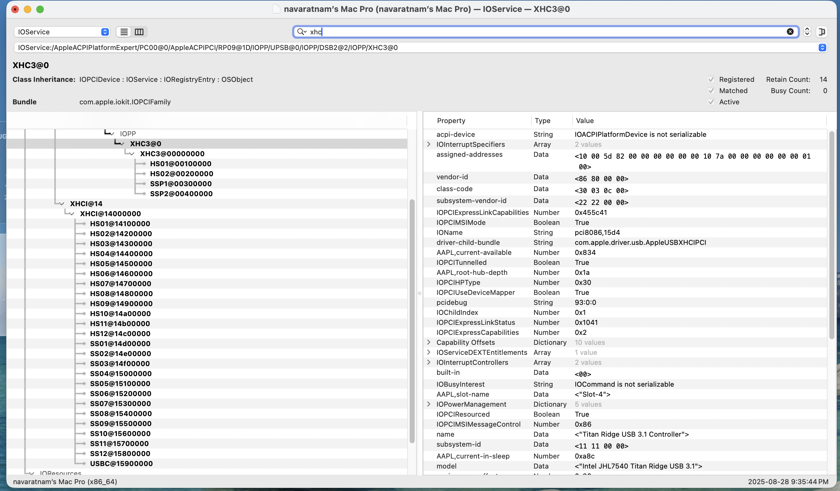

25 Ports Enabled
Thanks for OCLP-Mod 3.0 for Ports Limit 25 USB Kexts patched.please remove if you add USBMap.kext or USBPort.Kext this ssdt.aml support with out this kexts.
SSDT-XHC-25Ports.aml
Edited by nmano
  • Like 3

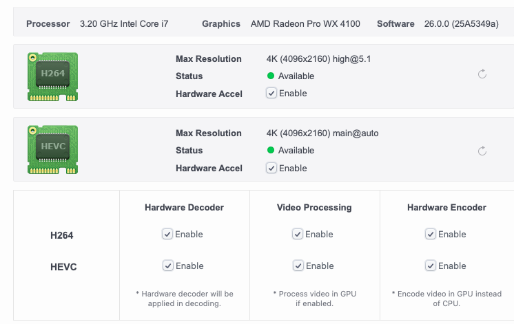

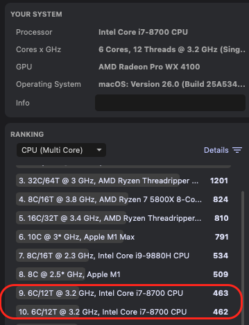

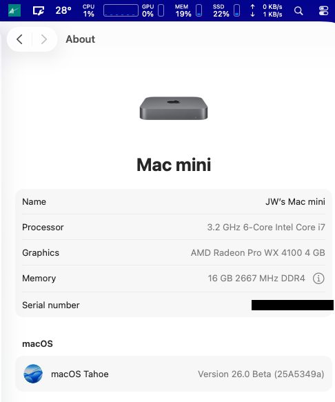

I have retired this computer at work 2 years ago, and today I decided to give it a chance with MacOS Tahoe. A little bit of cleaning, new thermal paste and voila!
HP EliteDesk 800 G4 SFF - i7 8700 | 16GB DDR4 | WX 4100 | Samsung 950 Pro 500GB. Everything works very smooth, WX 4100 worked out of the box. Pretty cool compact machine that can be bought for dirt cheap on the used market nowadays.

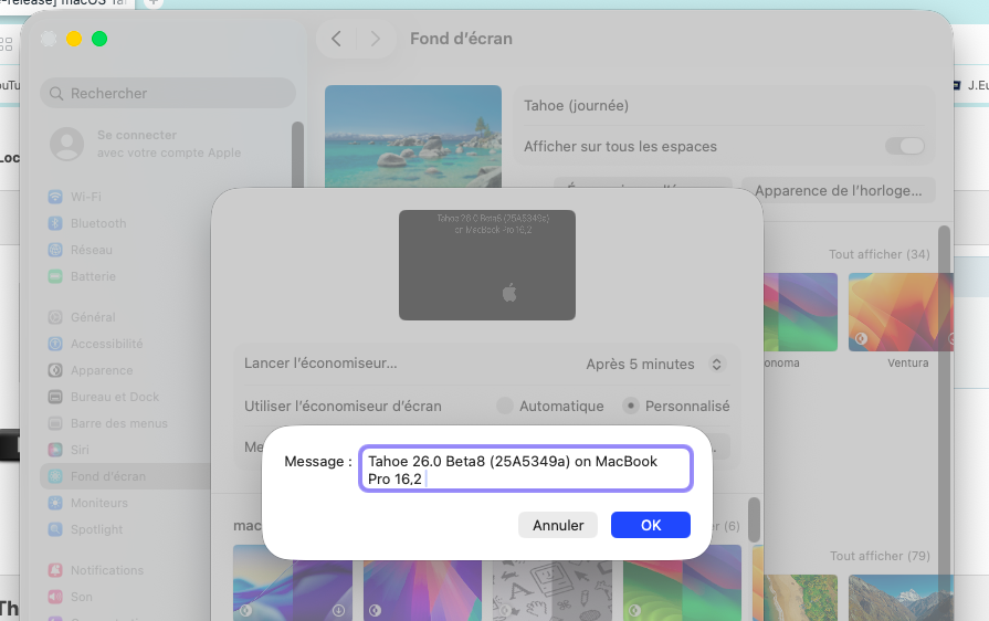

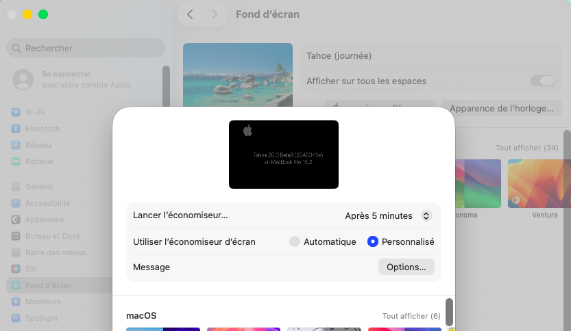

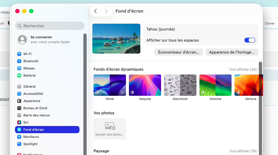

20 hours ago, Thebes Knossos said:
Have you found how to setup a simple black + text screen saver on tahoe ? Other ones are nor really screen (and CPU) savers ....
@Thebes Knossos
1) On System Settings click on Wallpaper
Spoiler
2)On Wallpaper click on Screen Saver
Spoiler
On Screen Saver check "Use Custom Screensaver" and click on Options and then you can enter the text you want to appear on the screensaver.
Spoiler
I hope I have met your expectations.
Regards

16 hours ago, nmano said:
25 Ports Enabled
Thanks for OCLP-Mod for Ports Limit 25 USB Kexts patched.
SSDT-XHC-25Ports.aml 855 B · 27 downloads
So you have been able to access al of these USB ports with no issues using this SSDT? I have missing ports.
Edited by pkdesign
Sorry if I’m going OT here but I thought we were supposed to keep the USB ports at 15 to avoid unstable USB behavior.
