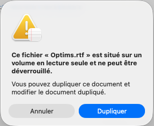

You can install it OK. I have tested it yet, try to modify a .rtf file on the partition -> file is locked in read mode only. So nothing more than default MacOS read only mounting mode. Tahoe I haven't latest beta installed but if it is not working with Sequoia ...

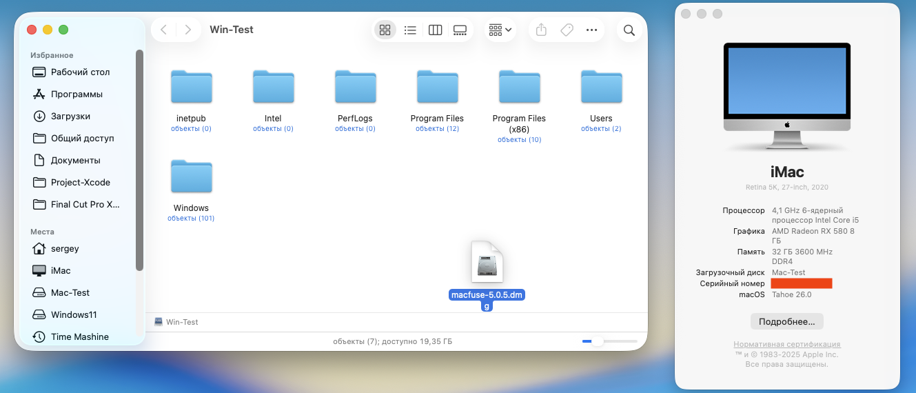

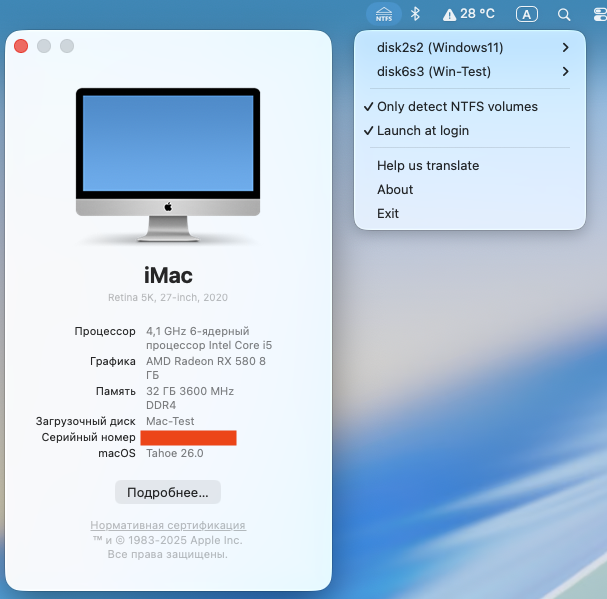

I just installed on Tahoe-beta7 and it works. Just need to manually install macfuse-5.0.5 - https://macfuse.github.io/
2025-08-2214_19_35.png.a69d5a549412640b3c04a7e347490694.png 123.thumb.png.8ace4abe7f8f10cd2d96e224caa29f87.png

Je viens de l'installer sur Tahoe-beta7 et ça fonctionne. Il me suffit d'installer manuellement macfuse-5.0.5 - https://macfuse.github.io/
Tested on my beta. I can have same picture as you, and macfuse updated of course.
But if i want edit a file on mounted partition, it says : read only
If you can write on mounted partitions, can you share our CSR config ? Other tricks ?

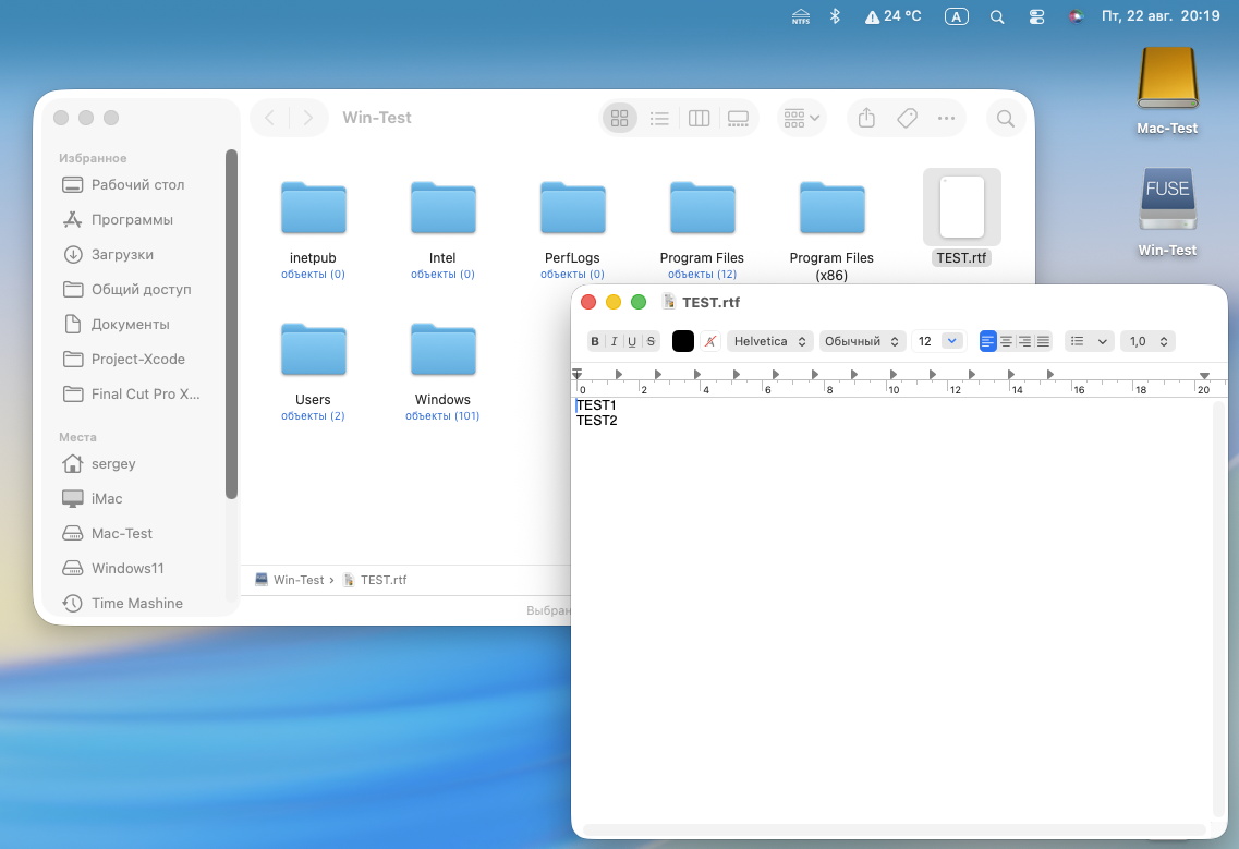

I conducted an experiment - I created a text file called TEST, wrote "TEST1" in the text, saved it on the desktop. Then I mounted the NTFS volume, and copied the text file TEST, opened this file, there was the inscription "TEST1", added the inscription "TEST2" and saved the file. With the subsequent opening of this file I see two inscriptions - "TEST1" and "TEST2". In general, I do not have such a problem as you. In CSR, I only disable ALLOW_UNRESTRICTED_NVRAM\ncsr-active-config (40000000), there are reasons for this, but usually SIP is enabled for me.

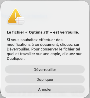

Thanks sergey for your test. When I modify directly a text file (here an .rtf one) I get first a proposal to unlock it. After click to unlock (Déverrouiiler in French), i says it can't because volume is read only.
My Csr csr-active-config    %03%08%00%00
Edited by Thebes Knossos

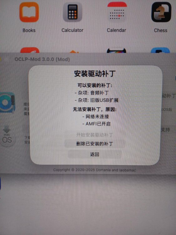

I downloaded and tried to install OCLP-mod 3.0 from GitHub.  It did seem to do something but upon reboot things were the same.  So I guess it doesn’t work.
I've tried version 3.0.0 from Actions in GitHub repo and it has worked.
Chinese language makes it confusing, but it's not hard to figure out where to click. Have you checked AppleHDA patch in Settings >> Patches? I checked Classic Launchpad too. Integrated audio and classic Launchpad are back.

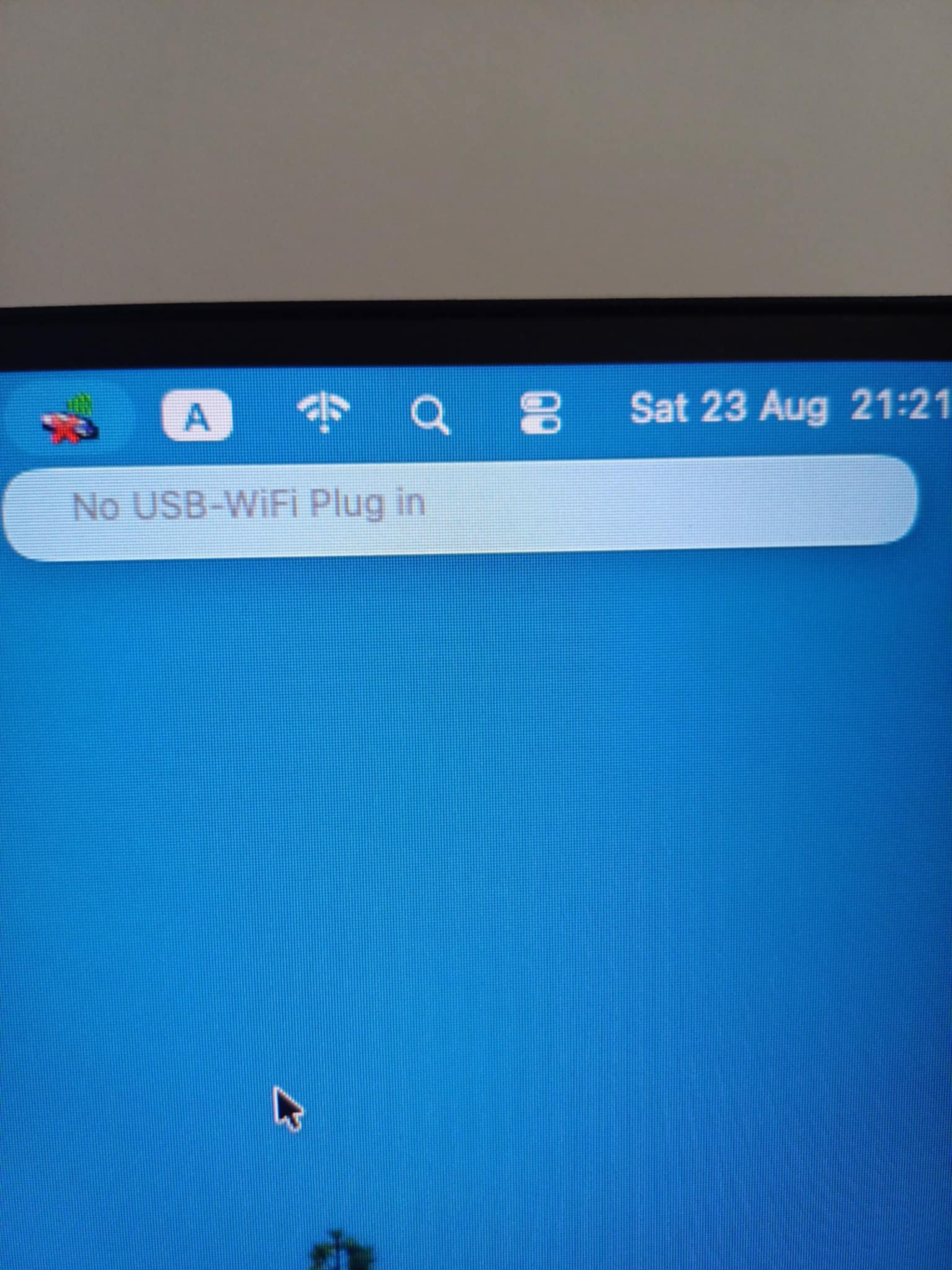

Hi, i manage to install Tahoe without major issues, disable/enable WEG
Almost everything is working except WIFI
I have a usb wifi adapter, RTL8812BU USB 3.0 WLAN Adapter 1200Mbps 2.4GHz/5GHz WiFi USB that is working properly on Sequoia
I'm trying to use @chris1111 driver https://github.com/chris1111/Wireless-USB-OC-Big-Sur-Adapter/blob/master/Usage-macOS-Tahoe.md

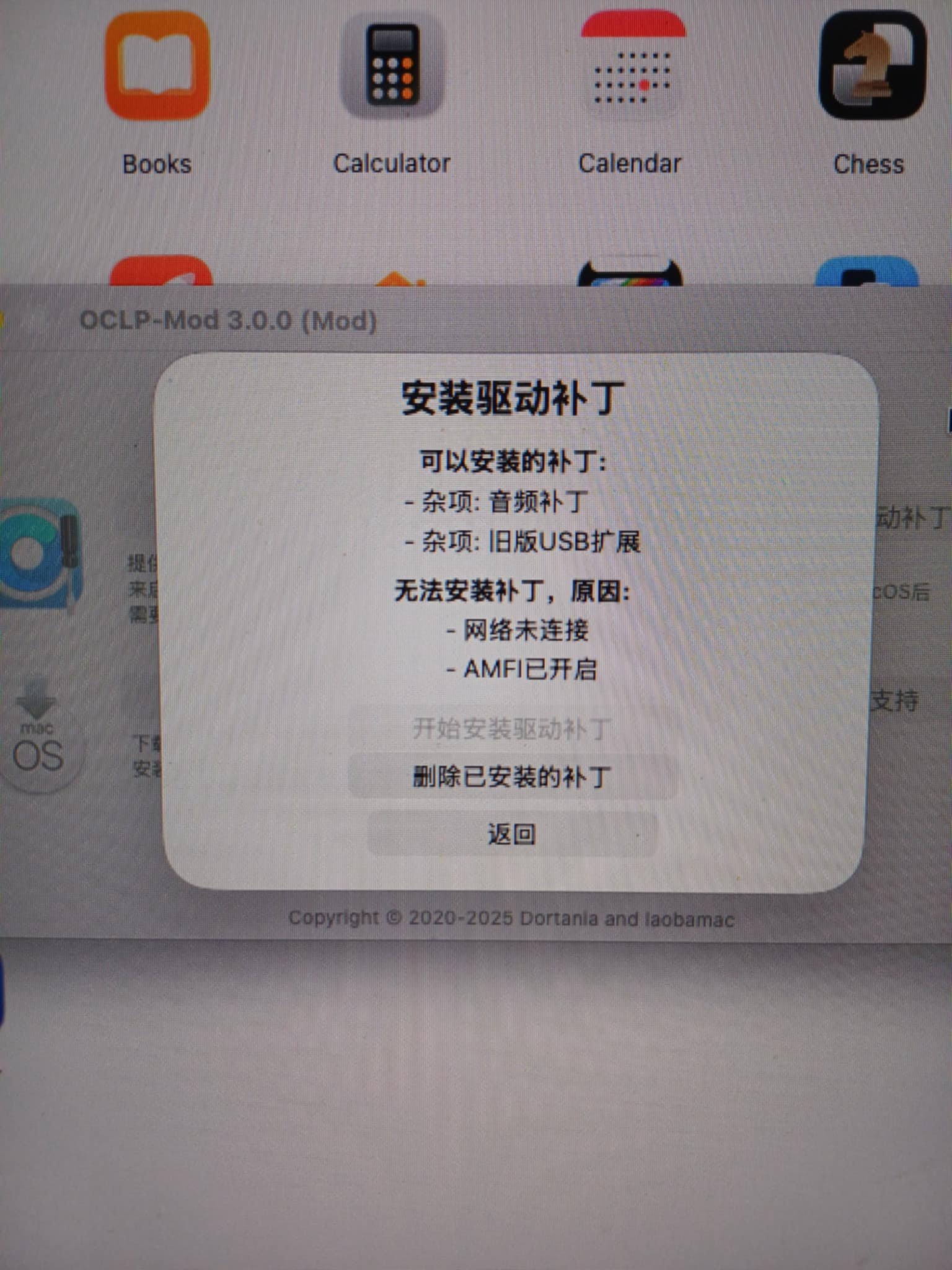

The problem that when i try to use OCLP the install button is greyout
After i continue and installed the Wireless-USB-OC-Big-Sur-Adapter after the reboot the WIFI usb adapter is not detelcted
My specs are:
GPU: RX580
MB: ASUS Maximus X hero Z370
CPU: I7 8700K
SMBIOS: I,MAC 20.2
Can someone has any idea regarding how to make wifi work, really appreciate any suggestion. Thanks

22 minutes ago, mandstef said:
Thanks @verdazil i will try to disable AMFi, but why do i need to have a working LAN network?
Because it is a requirement for the OCLP to work. In particular, it must download the KDK. Use IntelMausi.kext
