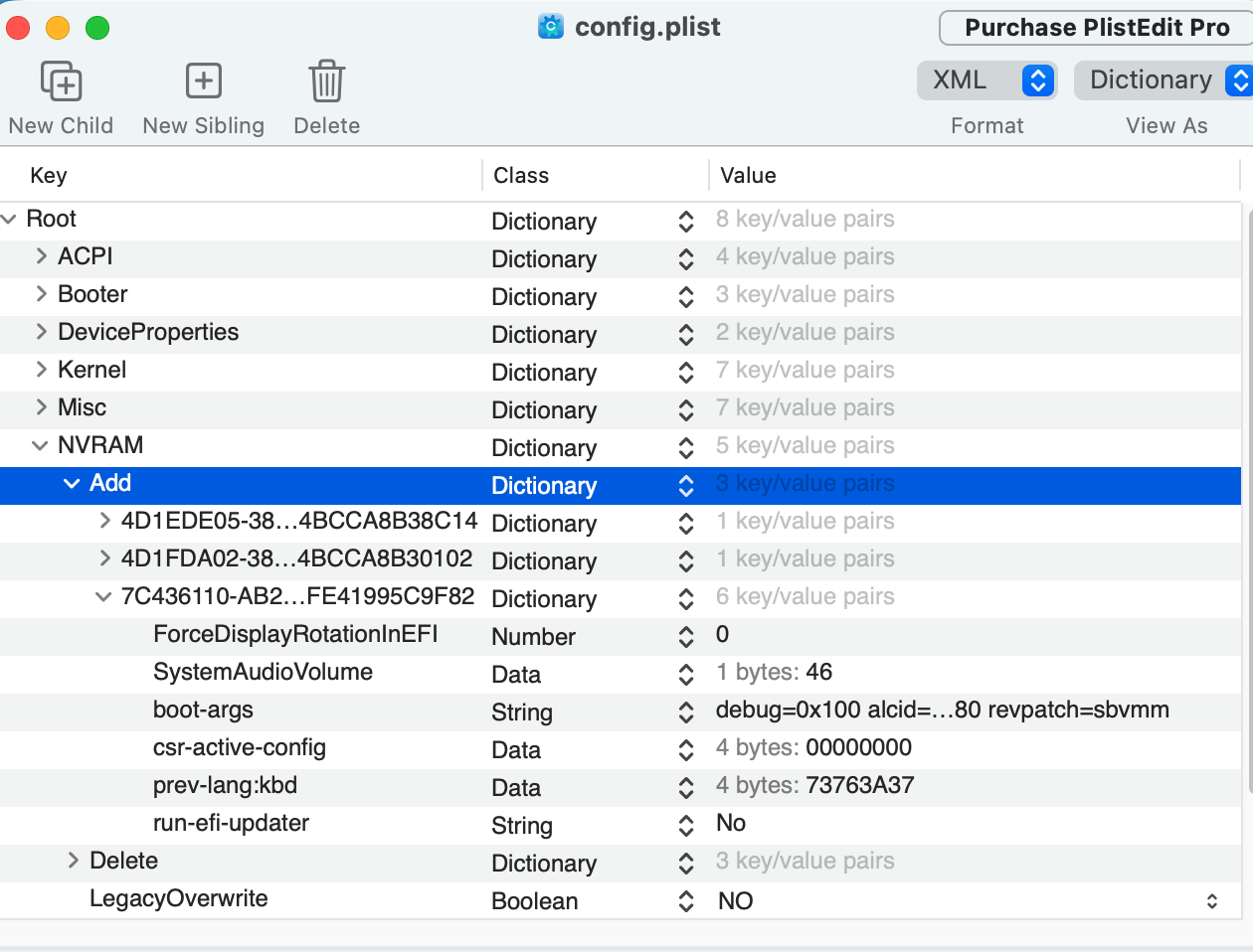

New installation (beta 7) from scratch with USB installer. Used my original Sequoia MacPro7,1 EFI with WEG enabled, Apple Secure Boot, fully enabled Sip (00000000) and Vault. Before install updated USBkext (CorpNewt-tool) and everything is working fine as in Sequoia. Booting with same EFI for both Tahoe and Sequoia. Fully working USB ports.
Spoiler

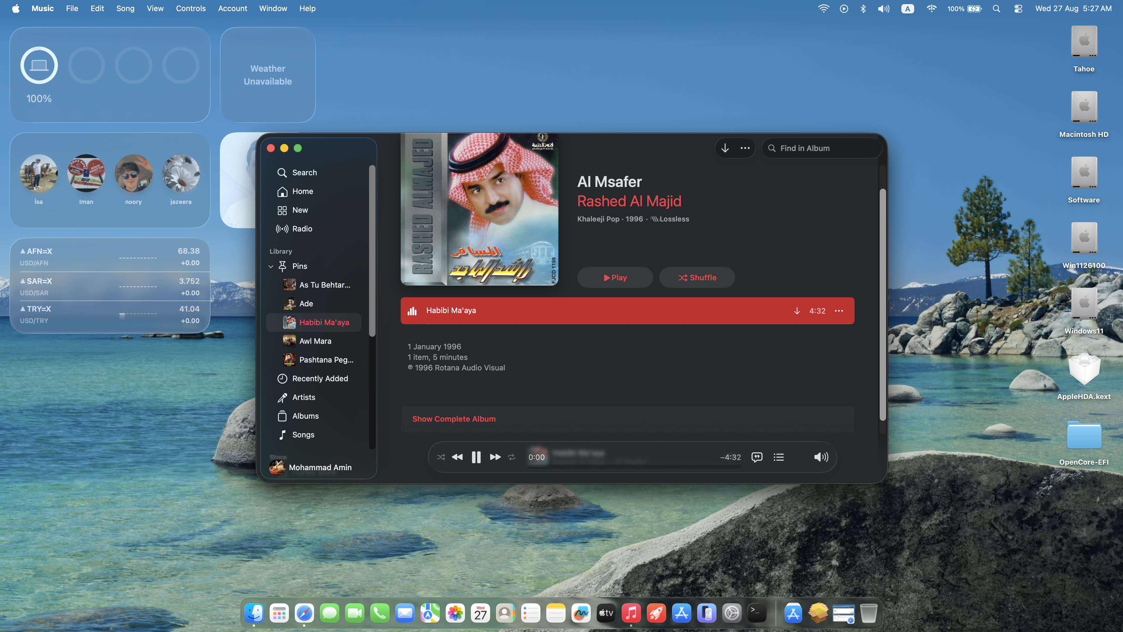

3 hours ago, ameenjuz said:
Apple Music playing song but no sound and stuck track time
anyone have this problem on macOS Tahoe
in sequoia working fine
downloaded song working fine otherwise streaming not work
It's DRM. On Intel IGPU in Sequoia I have this problem too. Unfairgva=4 & 5 & 6 & 7 in boor-arg solves this problem, but destroys the 264 codec and VDA decoder fail. If you have dGPU AMD , me be need to set correct SMbios, MacPro 7,1 & Imac Pro 1,1
  • Thanks 1

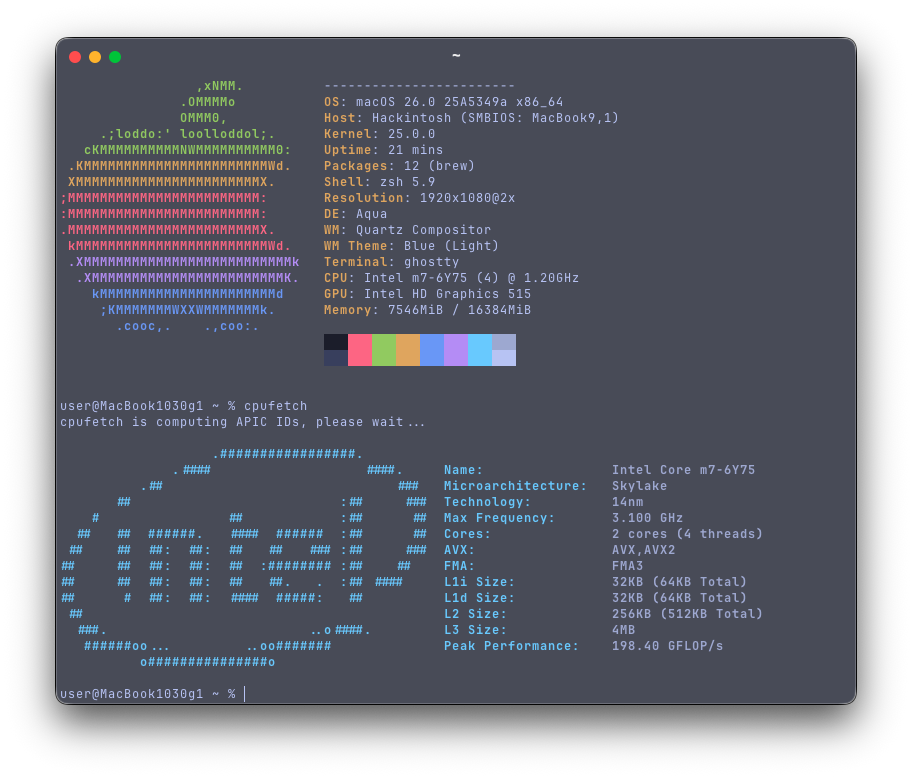

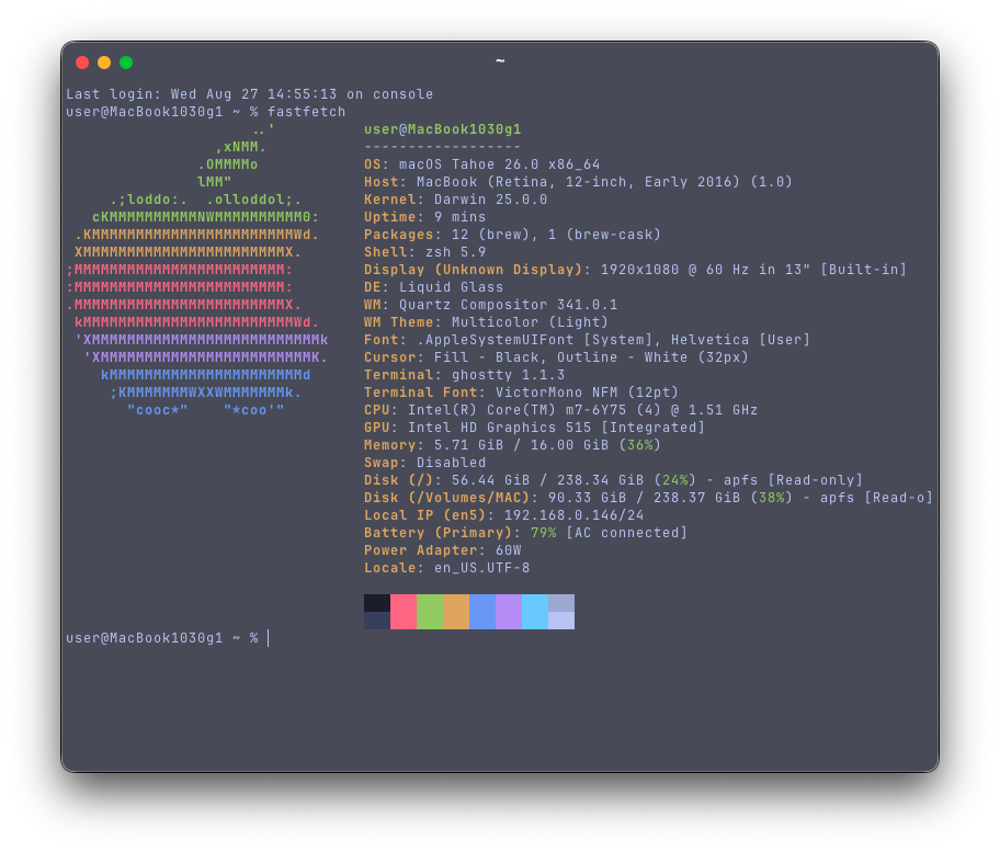

Just updated on my hp 1030g1  from beta2 to latest beta.
I downloaded KDK before on my Sequoia disk and also OCLP -mod latest commit as I knew I would not have internet after installation.
Selected patches I wanted rebooted and all good😀
unfortunately this boot-arg is not help for me
I tried change AAPL,ig-platform-id to 09009B3E too but no luck
