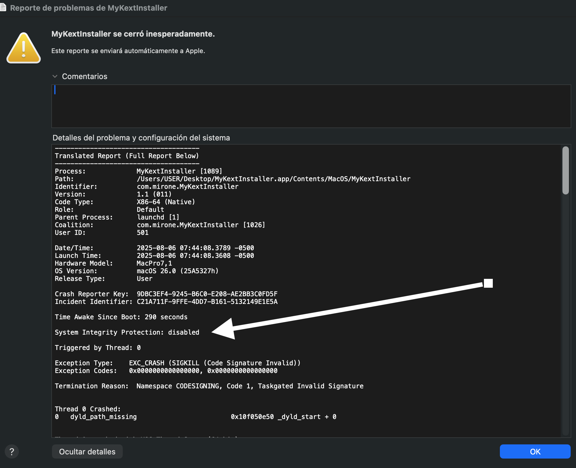

Oyecomova Posted August 6, 2025 Share Posted August 6, 2025 Tahoe beta 5 no audio Mykextinstaller quit unexpectedly any solution please? Link to comment https://www.insanelymac.com/forum/topic/361162-pre-release-macos-tahoe/page/122/#findComment-2838502 Share on other sites More sharing options...
bluenote56 Posted August 6, 2025 Share Posted August 6, 2025 9 minutes ago, Oyecomova said: Tahoe beta 5 no audio Mykextinstaller quit unexpectedly any solution please? Use simple loader. It works. 1 Link to comment https://www.insanelymac.com/forum/topic/361162-pre-release-macos-tahoe/page/122/#findComment-2838503 Share on other sites More sharing options...

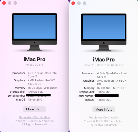

gsxb Posted August 6, 2025 Share Posted August 6, 2025 (edited) all sorted my Z97 just needed WEG set to false to install from my test EFi on a usb stick to third reboot then all sorted my HP 280g2 SFF was a bit more involved MacPr07,1 smbios with WEG set to false until the welcome screen with test usb then back to my IMacPro1,1 to log into Tahoe then turn FileVault off back to normal booting Edited August 6, 2025 by gsxb 1 Link to comment https://www.insanelymac.com/forum/topic/361162-pre-release-macos-tahoe/page/122/#findComment-2838507 Share on other sites More sharing options...

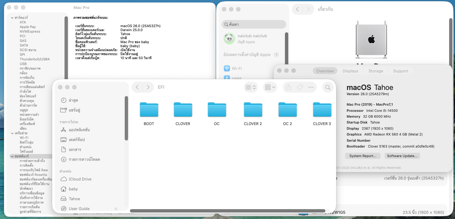

naiclub Posted August 6, 2025 Share Posted August 6, 2025 (edited) 1 hour ago, Matgen84 said: Thanks @eSaF @strangeron I try to boot Beta 6 from USB with Lilu debug + WEG. No "Kextlog: Collection UUID matches with loaded KCs" issue. But stuck after entering password session like previous Beta. Like for Beta 4, I will wait 25-30 minutes if desktop appear. I hope. Next time, I will disable WEG on my Z390 machine. I don't know if WEG is necessary for RX580 graphics card !!!! I used several EFI packages: Package 1, full system, Package 2, removed WEG, Package 2, didn't add BlueToolFixup, IntelBluetoothFirmware, IntelBTPatcher, WhateverGreen . config.plist set 2, delete unnecessary ones. Set 1 is not deleted, it is still full system. Spoiler Separate 1GB EFI partition for booting instead of 200MB system because it requires quite a lot of space. Edited August 6, 2025 by naiclub 1 Link to comment https://www.insanelymac.com/forum/topic/361162-pre-release-macos-tahoe/page/122/#findComment-2838520 Share on other sites More sharing options...

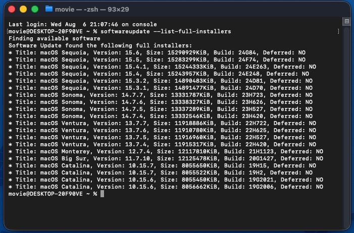

fantomas Posted August 6, 2025 Author Share Posted August 6, 2025 On 8/5/2025 at 7:18 PM, Moviemakergr said: Direct Installer link needed 23 hours ago, webipsum said: Any direct download options? macOS Tahoe Version 26.0 (25A5327h)? And what about terminal command softwareupdate --list-full-installers? Quote softwareupdate --list-full-installers; echo; echo "Please enter version number you wish to download:"; read REPLY; [ -n "$REPLY" ] && softwareupdate --fetch-full-installer --full-installer-version "$REPLY" 1 1 Link to comment https://www.insanelymac.com/forum/topic/361162-pre-release-macos-tahoe/page/122/#findComment-2838535 Share on other sites More sharing options...

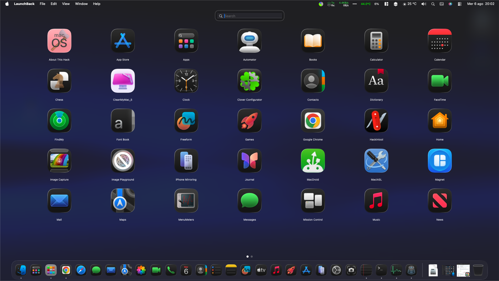

Anto65 Posted August 6, 2025 Share Posted August 6, 2025 (edited) If it's interesting, there's this one now " LaunchBack "... it seems to work 😅 Spoiler https://github.com/trey-a-12/LaunchBack/releases/tag/v1.0.0-initial Edit : The mouse wheel doesn't work; you have to hold it down while left-clicking to scroll. It doesn't allow you to organize apps. Edited August 6, 2025 by Anto65 2 Link to comment https://www.insanelymac.com/forum/topic/361162-pre-release-macos-tahoe/page/122/#findComment-2838537 Share on other sites More sharing options...
Moviemakergr Posted August 6, 2025 Share Posted August 6, 2025 29 minutes ago, fantomas said: And what about terminal command softwareupdate --list-full-installers? Thanks ..but not betas.. 1 Link to comment https://www.insanelymac.com/forum/topic/361162-pre-release-macos-tahoe/page/122/#findComment-2838539 Share on other sites More sharing options...
