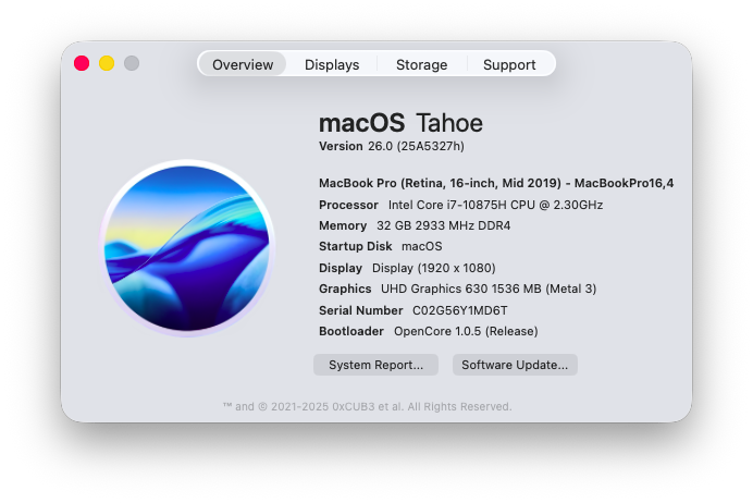

fusion71au Posted August 6, 2025 Share Posted August 6, 2025 No fuss delta update from Beta4_25A5316i to Beta5_25A5327h on my Skylake NUC6i5SYH. Opencore version 1.0.5 iMac20,1 SMBIOS Reverted AppleHDA root patch with MyKextInstaller ver1.1 Obtained Beta 5 OTA update through Software Update No change in SIP settings necessary before or after (still csr-active-config=03080000) No change in kexts from Beta4. RestrictEvents v1.1.6 + revpatch=sbvmm in boot-args No change in File Vault before or after (still disabled, was not locked out) Got squared off Disk Icons on desktop Spoiler 3 Link to comment https://www.insanelymac.com/forum/topic/361162-pre-release-macos-tahoe/page/121/#findComment-2838463 Share on other sites More sharing options...

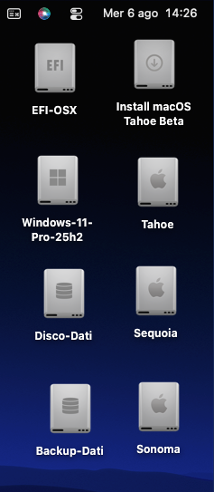

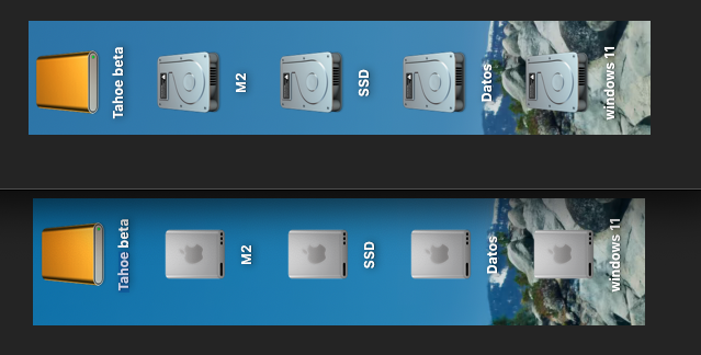

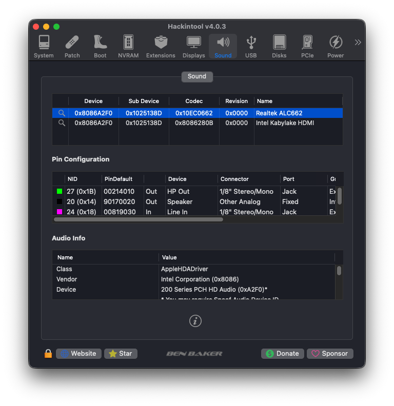

kaoskinkae Posted August 6, 2025 Share Posted August 6, 2025 Yesterday, macOS 26 beta 5 was released. In this beta, it is still necessary to patch the AppleHDA.kext. A new visual change is present in this beta 5: the icons representing the internal drives. See the before and after photos of macOS Sequoia and macOS Tahoe. The Hackintool application closes when we reach the SOUND section once the AppleHDA.kext is parked. If anyone has experienced any other significant changes, please share them in the group. I have also experienced that if we patch the AppleHDA.kext the active system hard drive icon returns to the same as in macOS Sequoia Link to comment https://www.insanelymac.com/forum/topic/361162-pre-release-macos-tahoe/page/121/#findComment-2838477 Share on other sites More sharing options...

Anto65 Posted August 6, 2025 Share Posted August 6, 2025 4 minutes ago, kaoskinkae said: Ieri è stata rilasciata la beta 5 di macOS 26. In questa beta, è ancora necessario applicare la patch ad AppleHDA.kext. In questa beta 5 è presente una nuova modifica visiva: le icone che rappresentano le unità interne. Guarda le foto del prima e del dopo di macOS Sequoia e macOS Tahoe. L'applicazione Hackintool si chiude quando raggiungiamo la sezione AUDIO, una volta parcheggiato AppleHDA.kext. Se qualcuno ha riscontrato altre modifiche significative, è pregato di condividerle nel gruppo. Ho anche riscontrato che se applichiamo una patch ad AppleHDA.kext, l'icona del disco rigido di sistema attivo torna ad essere la stessa di macOS Sequoia OK, about the disk icons. No, about Hackintool. It works here. Spoiler 1 Link to comment https://www.insanelymac.com/forum/topic/361162-pre-release-macos-tahoe/page/121/#findComment-2838479 Share on other sites More sharing options...

Anto65 Posted August 6, 2025 Share Posted August 6, 2025 3 hours ago, kaoskinkae said: Yesterday, macOS 26 beta 5 was released. In this beta, it is still necessary to patch the AppleHDA.kext. A new visual change is present in this beta 5: the icons representing the internal drives. See the before and after photos of macOS Sequoia and macOS Tahoe. The Hackintool application closes when we reach the SOUND section once the AppleHDA.kext is parked. If anyone has experienced any other significant changes, please share them in the group. I have also experienced that if we patch the AppleHDA.kext the active system hard drive icon returns to the same as in macOS Sequoia If Muhammad does not go to the mountain... 😁 2 4 Link to comment https://www.insanelymac.com/forum/topic/361162-pre-release-macos-tahoe/page/121/#findComment-2838494 Share on other sites More sharing options...

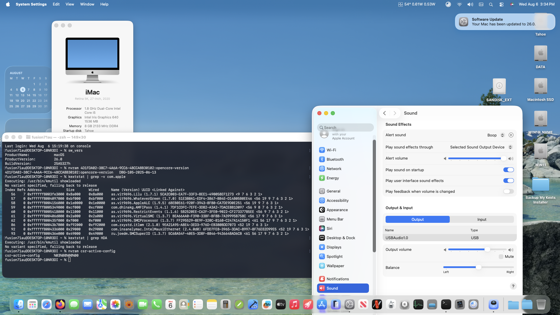

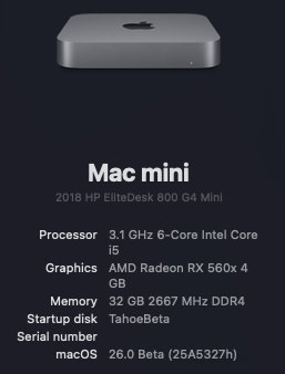

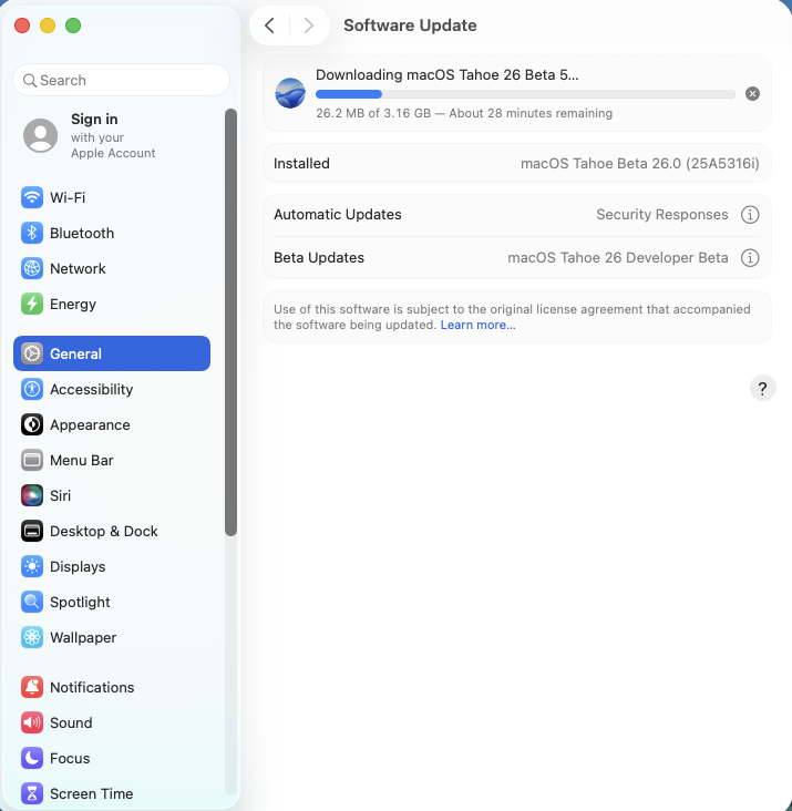

deeveedee Posted August 6, 2025 Share Posted August 6, 2025 (edited) Smooth, uneventful upgrade from Tahoe Beta 4 -> Beta 5 on my HackMini8,1 with Polaris RX 560x. I'm using VoodooHDA.kext 3.0.2 with csr-active-config = <01000000> for audio, so no need for any post-install patches (and no need to revert any patches). My steps for the upgrade are listed below. Note that I did need to disable BluetoolFixup.kext for the incremental OTA upgrade. With BluetoolFixup.kext enabled, OTA upgrade reverted to the full 16.6GB installer. Without BluetoolFixup.kext, OTA upgrade was 3GB incremental. Boot macOS Tahoe with BluetoolFixup.kext disabled and boot-arg -wegnoegpu (leave WhateverGreen.kext enabled for UHD630 iGPU framebuffer patches) Perform OTA upgrade Spoiler Re-enable BluetoolFixup.kext and remove boot-arg -wegnoegpu Sound continues to work flawlessly without any additional operations, since I'm using VoodooHDA.kext. I haven't needed to touch VoodooHDA.kext since initially installing it and setting csr-active-config = <01000000> in Tahoe Beta 2. Audio quality is excellent. EDIT: FileVault was off prior to the incremental OTA upgrade from Beta 4 -> Beta 5 and remained off after the upgrade. No issues with FileVault. Edited August 6, 2025 by deeveedee 4 Link to comment https://www.insanelymac.com/forum/topic/361162-pre-release-macos-tahoe/page/121/#findComment-2838496 Share on other sites More sharing options...
