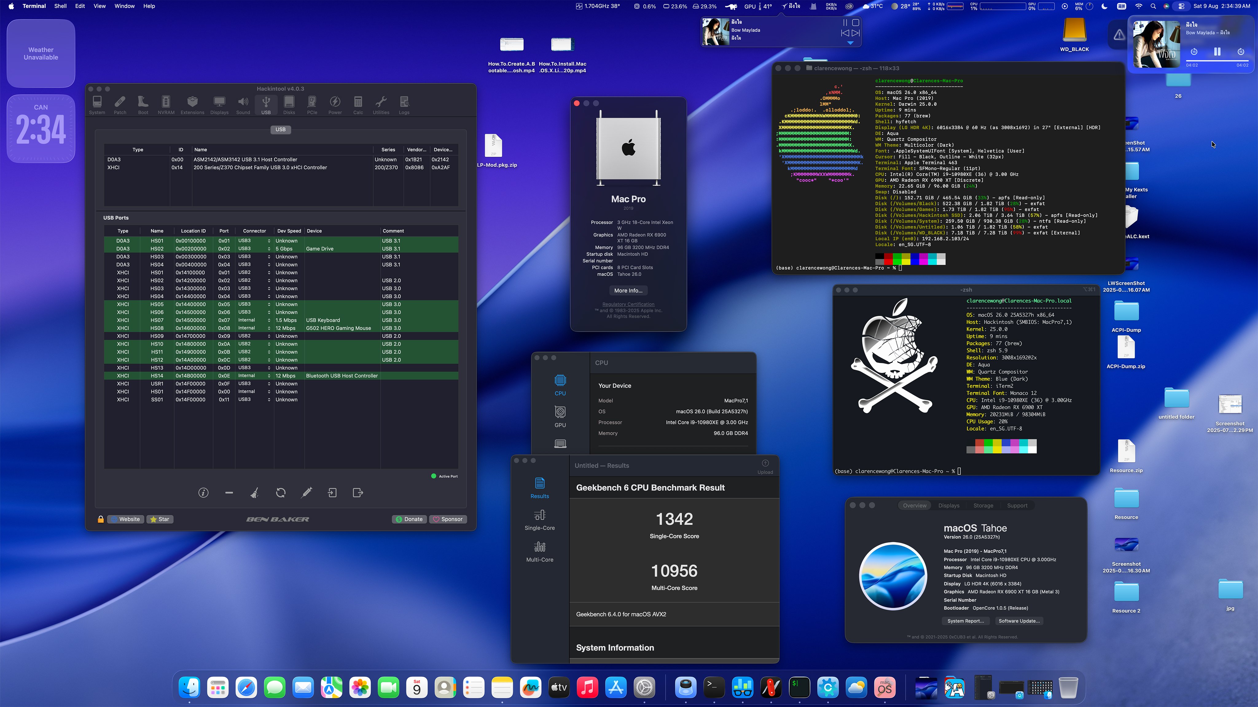

Cyberdevs Posted August 8, 2025 Share Posted August 8, 2025 Little late to the party, been busy with my projects, but I've downloaded and used the full installer to update the previous beta with the 5th beta. Everything went smoothly and no FileVault BS on my end. Same as the previous updates using the full installer. Spoiler Spoiler 6 Link to comment https://www.insanelymac.com/forum/topic/361162-pre-release-macos-tahoe/page/126/#findComment-2838706 Share on other sites More sharing options...

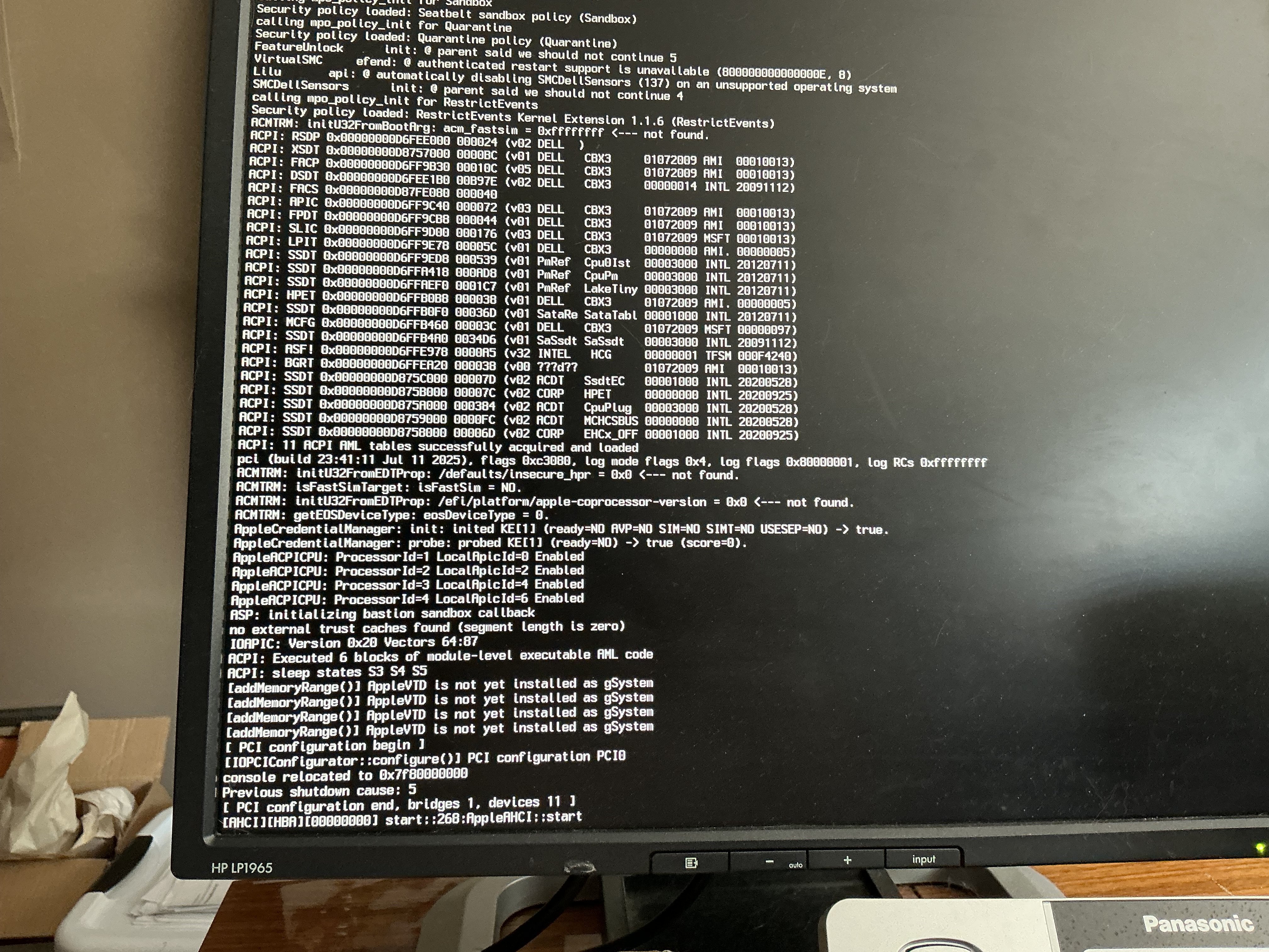

Zevgoli Posted August 9, 2025 Share Posted August 9, 2025 Ok. So I installed the updated USB kext and disabled Weg. Cleared nvram twice and attempted install. I actually got past the prohibited sign into the first verbose screen. There it stopped. I am attaching screen shot for your viewing pleasure and possible interpretation. Hope you can help. Cheers, Howard Link to comment https://www.insanelymac.com/forum/topic/361162-pre-release-macos-tahoe/page/126/#findComment-2838769 Share on other sites More sharing options...

strangeron Posted August 9, 2025 Share Posted August 9, 2025 21 minutes ago, Zevgoli said: I will try and let you know. This can be bypassed with "PCI Configuration begin" npci=2000 or npci=3000. I've seen it mostly on Ryzen processors. As you know, there's no OCLP for the HD4600 yet for the Tahoe. 1 Link to comment https://www.insanelymac.com/forum/topic/361162-pre-release-macos-tahoe/page/126/#findComment-2838775 Share on other sites More sharing options...
Zevgoli Posted August 10, 2025 Share Posted August 10, 2025 (edited) I waited for 20 minutes for the screen to advance. It did not. I will try PCI Configuration begin tomorrow when I have figured out where to put it. The processor is Haswell. 🙂 Edited August 10, 2025 by Zevgoli add text 1 1 Link to comment https://www.insanelymac.com/forum/topic/361162-pre-release-macos-tahoe/page/126/#findComment-2838777 Share on other sites More sharing options...

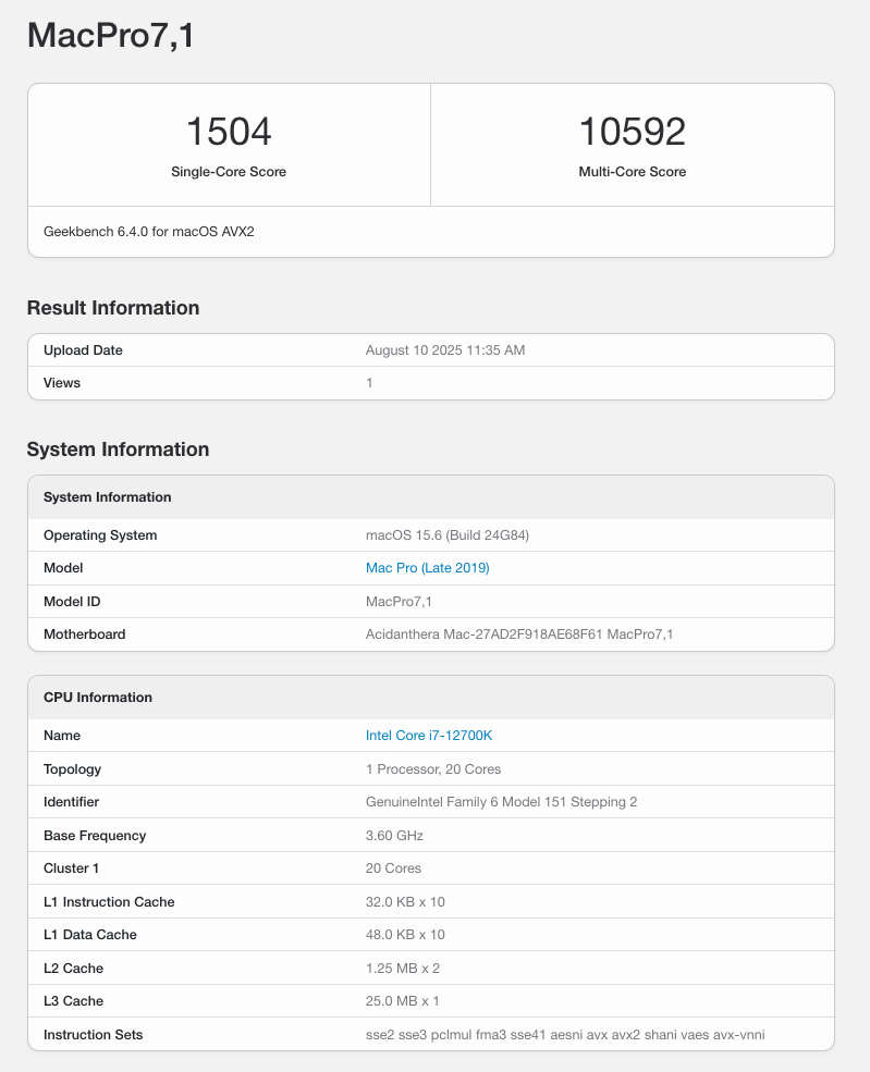

Derty Posted August 10, 2025 Share Posted August 10, 2025 (edited) Interesting, beta 4 is faster than Sequoia 15.6 EFI-Z690 Aourus.zip Edited August 10, 2025 by Derty 4 Link to comment https://www.insanelymac.com/forum/topic/361162-pre-release-macos-tahoe/page/126/#findComment-2838796 Share on other sites More sharing options...

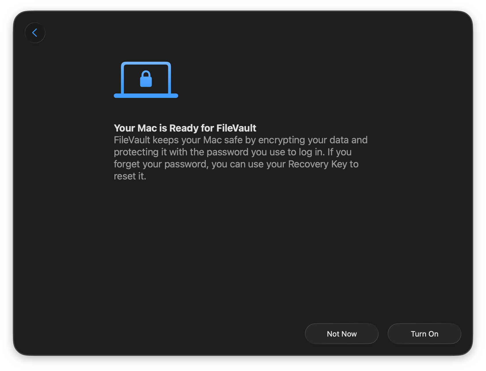

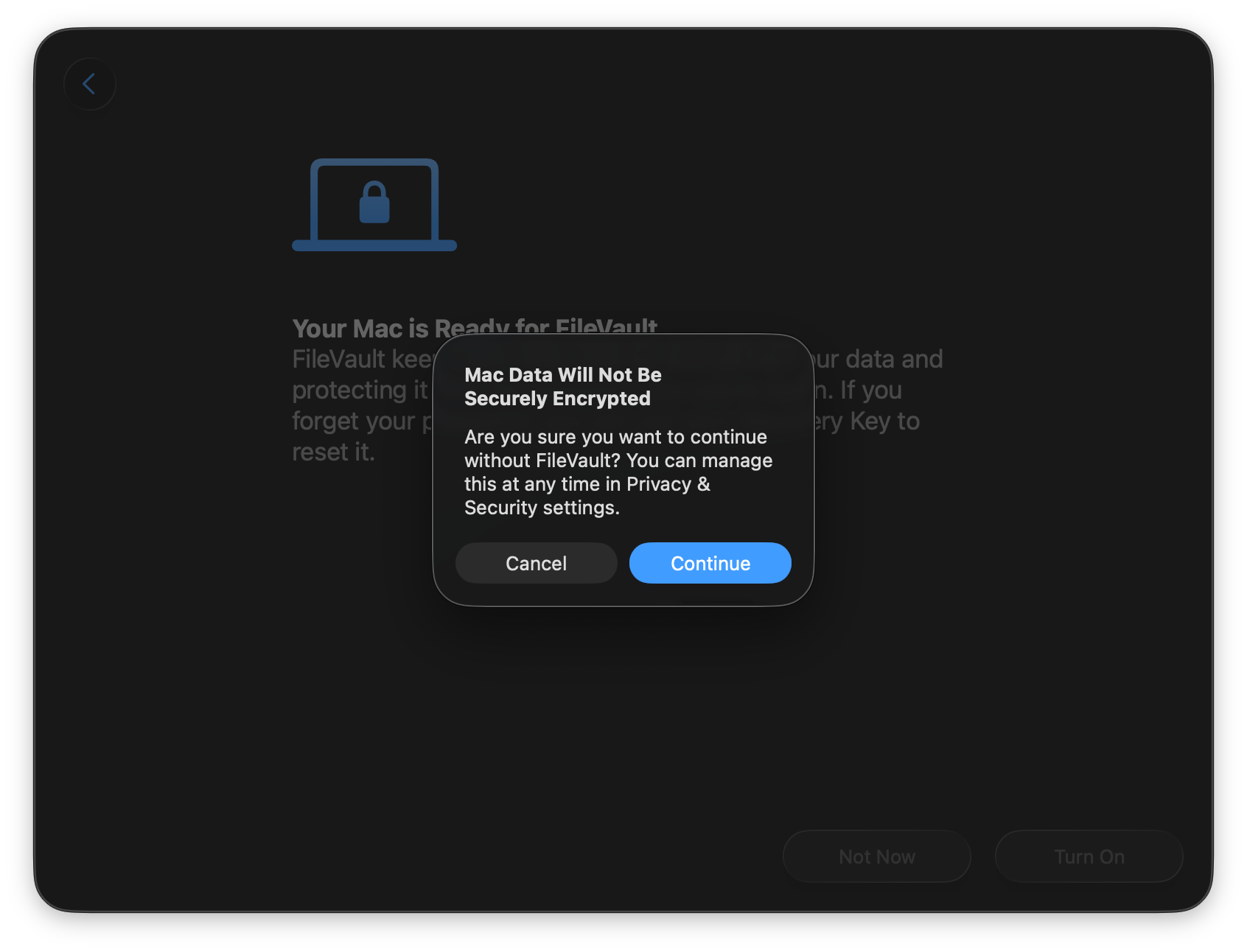

Zevgoli Posted August 10, 2025 Share Posted August 10, 2025 Ok. Some good news and some quite bad news. After using the adjustments listed above and some further refinements I was able to install Tahoe and walked through the set up screens with difficulty. The mouse responded very very slowly to each window. I declined FileVault and got through the install. I rebooted again after getting a blank white screen. This time I got to the desktop with two icons showing and the upper menu bar only. Nothing along the bottom so initially I had no access to any installed apps like Safari. I did manage to get into system settings and Safari through a back door. I realize that my onboard graphics are a problem and probably why I am having trouble with the screen. I did use Safari to get to OCLP picker hoping to correct but they don’t seem to be supporting Tahoe yet. So I guess I am stuck till hopefully support arrives… Thanks for all your help for now. Cheers, Howard Link to comment https://www.insanelymac.com/forum/topic/361162-pre-release-macos-tahoe/page/126/#findComment-2838825 Share on other sites More sharing options...
arsradu Posted August 11, 2025 Share Posted August 11, 2025 On 8/10/2025 at 3:52 AM, Zevgoli said: I waited for 20 minutes for the screen to advance. It did not. I will try PCI Configuration begin tomorrow when I have figured out where to put it. The processor is Haswell. 🙂 Try to configure your iGPU in Device Properties (in case it's not already). Here's what you need to add/change. Adapt to your case, as necessary. Tahoe is a bit pickier than others when it comes to graphics. So you need to make sure everything is set up properly. So, choose an SMBIOS that is compatible with Tahoe (alternatively, I think you could also use -no_compat_check param in NVRAM > boot-args with your current SMBIOS). Haven't tested that thoroughly, so...try that, if you want. In my experience with Tahoe so far, what's causing most of the issues is either Graphics, or, for newer devices (not your case), USB. So try to configure your framebuffers as described on that page, and see if it works for you. 1 Link to comment https://www.insanelymac.com/forum/topic/361162-pre-release-macos-tahoe/page/126/#findComment-2838859 Share on other sites More sharing options...

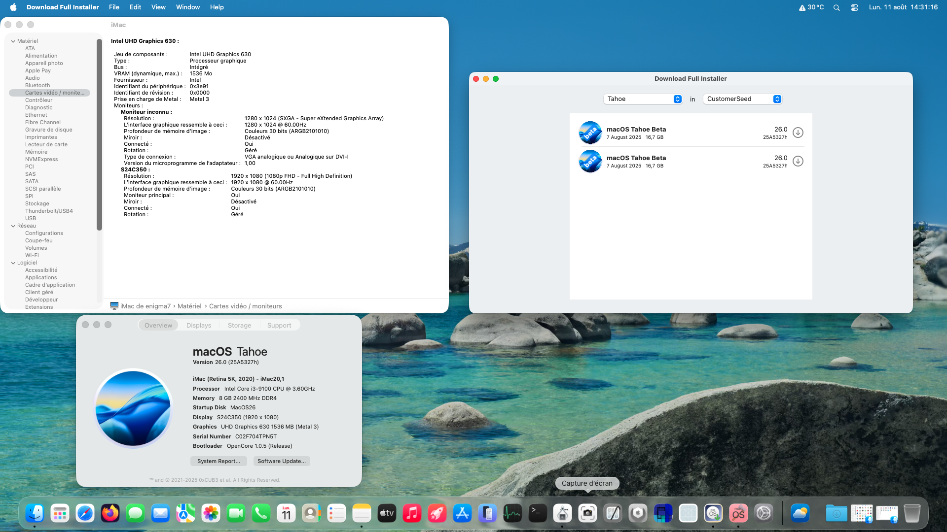

Thebes Knossos Posted August 11, 2025 Share Posted August 11, 2025 My first post in this section. Thanks for your hard work, all is working fine , except dual monitor cold start as usual. Public Beta 2 installed. 3 Link to comment https://www.insanelymac.com/forum/topic/361162-pre-release-macos-tahoe/page/126/#findComment-2838861 Share on other sites More sharing options...
Anto65 Posted August 11, 2025 Share Posted August 11, 2025 Haswell iGPUs are only supported up-to macOS 12 https://dortania.github.io/OpenCore-Install-Guide/config.plist/haswell.html#desktop-haswell-and-broadwell 2 Link to comment https://www.insanelymac.com/forum/topic/361162-pre-release-macos-tahoe/page/126/#findComment-2838868 Share on other sites More sharing options...
Thebes Knossos Posted August 11, 2025 Share Posted August 11, 2025 Il y a 1 heure, Anto65 a dit : Les iGPU Haswell ne sont pris en charge que jusqu'à macOS 12 https://dortania.github.io/OpenCore-Install-Guide/config.plist/haswell.html#desktop-haswell-and-broadwell Was this for me ? Mine is a Coffe Lake... 1 Link to comment https://www.insanelymac.com/forum/topic/361162-pre-release-macos-tahoe/page/126/#findComment-2838873 Share on other sites More sharing options...
Anto65 Posted August 11, 2025 Share Posted August 11, 2025 No no sorry it was for the previous post Link to comment https://www.insanelymac.com/forum/topic/361162-pre-release-macos-tahoe/page/126/#findComment-2838874 Share on other sites More sharing options...
