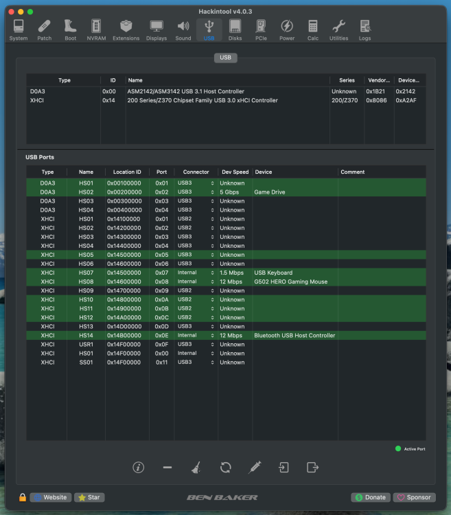

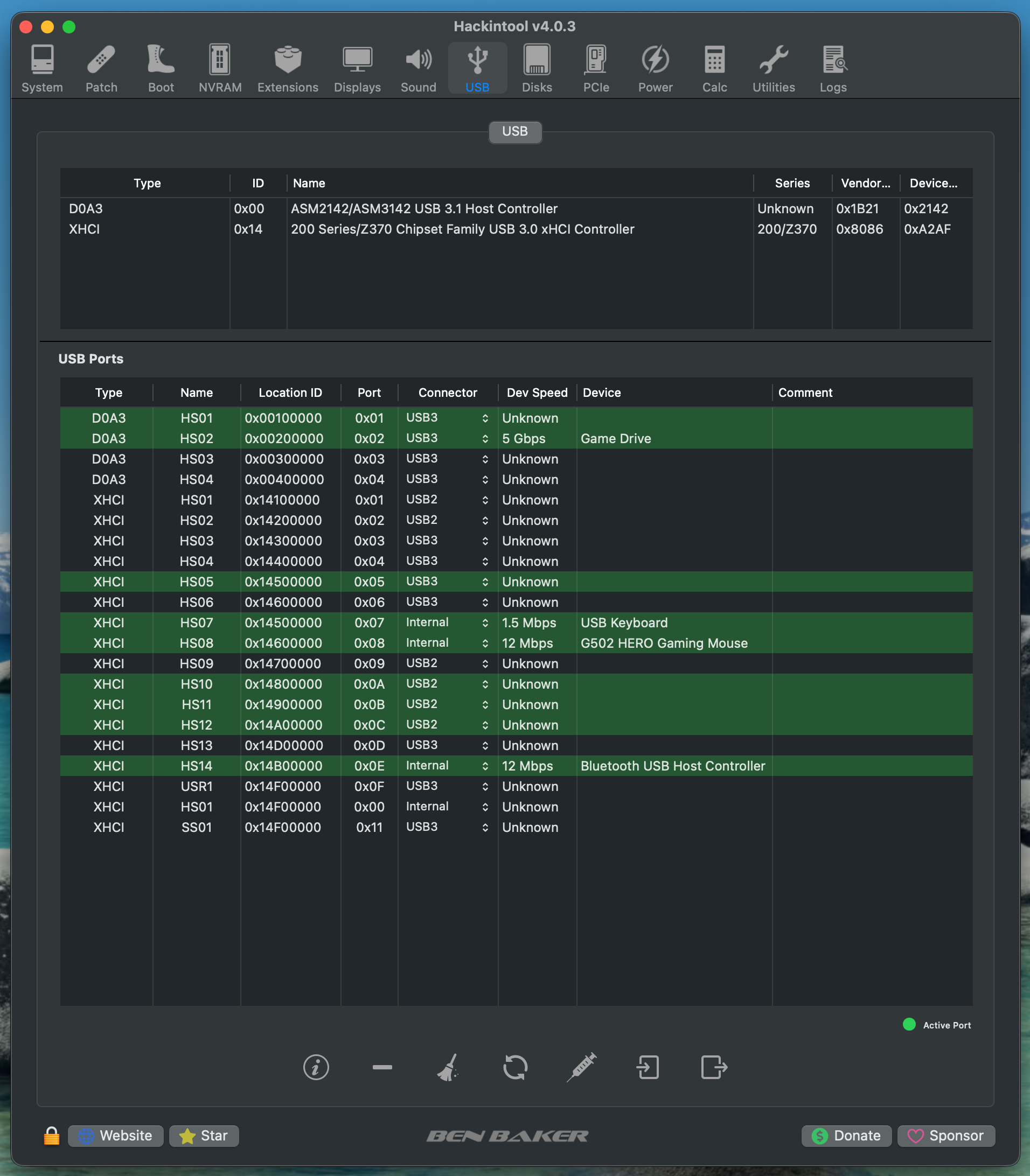

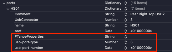

HurricaneX Posted July 29, 2025 Share Posted July 29, 2025 On 7/25/2025 at 8:20 PM, deeveedee said: Â I'm not seeing any problems with USB mapping after the Tahoe Beta 3 -> Beta 4 upgrade. Â My USBPorts.kext is the original USBPorts.kext generated by Hackintool (used since macOS Catalina) with only the addition of usb-port-type and usb-port-number. Â The map has only 15 USB ports. Â Â Â How many ports are in your USB port map? What if there r more than 15 ports in my USB mapping kext? Link to comment https://www.insanelymac.com/forum/topic/361162-pre-release-macos-tahoe/page/117/#findComment-2838053 Share on other sites More sharing options...
surenmunoo Posted July 29, 2025 Share Posted July 29, 2025 47 minutes ago, HurricaneX said: What if there r more than 15 ports in my USB mapping kext? For me, I had to disable a few ports for Beta 4Â 1 Link to comment https://www.insanelymac.com/forum/topic/361162-pre-release-macos-tahoe/page/117/#findComment-2838054 Share on other sites More sharing options...

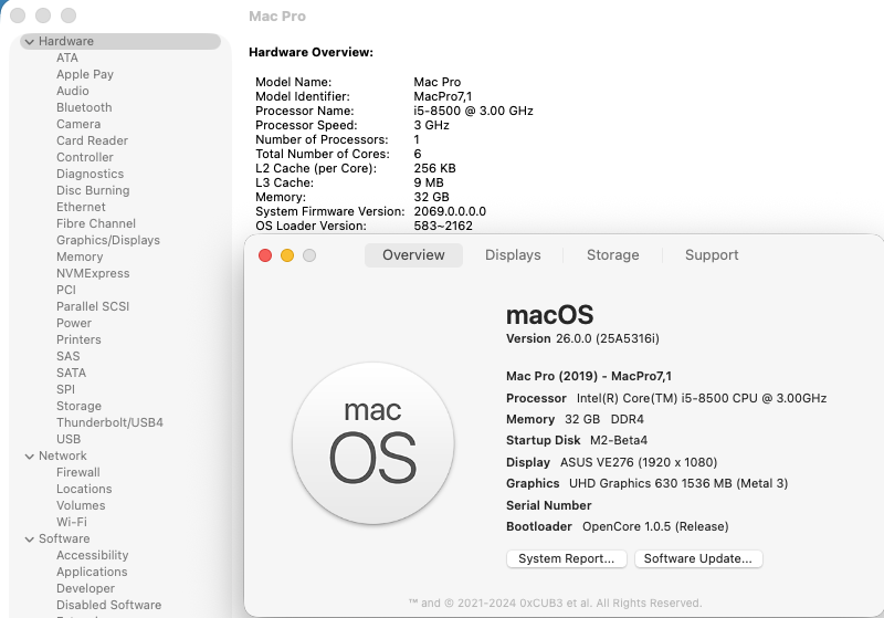

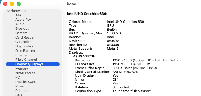

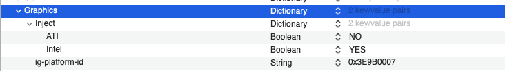

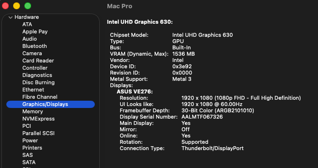

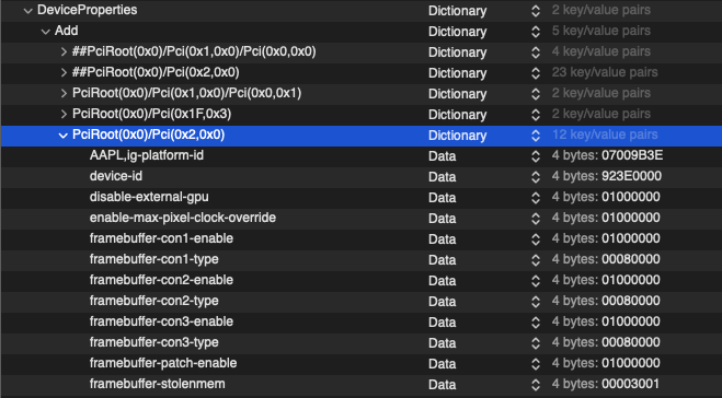

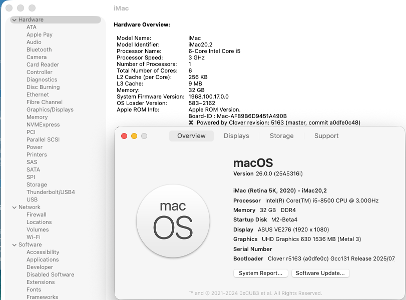

jsl Posted July 29, 2025 Share Posted July 29, 2025 After struggling for more than 1 month Clover 5163 can boot my Acer Veriton X6660G successfully now. It need Inject Intel plus ig-platform-id 0x3E9B0007 otherwise UHD-630 always got blank screen booted by OpenCore 1.0.5.  Spoiler  Spoiler  Spoiler  config.plist [Edit] After repeated trial and errors OpenCore 1.0.5 can boot UHD-630 now !  Spoiler  Spoiler  Spoiler  config-OC.plist 2 Link to comment https://www.insanelymac.com/forum/topic/361162-pre-release-macos-tahoe/page/117/#findComment-2838056 Share on other sites More sharing options...
HurricaneX Posted July 29, 2025 Share Posted July 29, 2025 1 hour ago, surenmunoo said: For me, I had to disable a few ports for Beta 4Â Sometimes my keyboard/mouse can not be recognized with the kext mapped more than 15 ports,i dont know whether it is because of this 1 1 Link to comment https://www.insanelymac.com/forum/topic/361162-pre-release-macos-tahoe/page/117/#findComment-2838057 Share on other sites More sharing options...
miliuco Posted July 29, 2025 Share Posted July 29, 2025 3 hours ago, HurricaneX said: What if there r more than 15 ports in my USB mapping kext? Â Sometimes nothing bad happens but very often there are issues with sleep/wake or with the speed detected on some ports. 5 1 Link to comment https://www.insanelymac.com/forum/topic/361162-pre-release-macos-tahoe/page/117/#findComment-2838064 Share on other sites More sharing options...

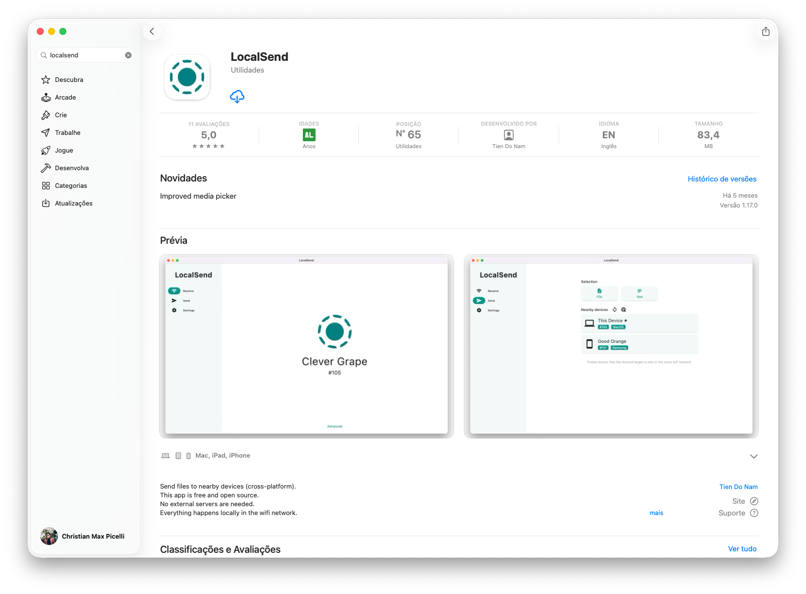

Max.1974 Posted July 29, 2025 Share Posted July 29, 2025 @Robi62 are you already try use LocaSend app? It's free and useful, you can use in your iPhone, Android, macOS, Windows or Linux. Its more fast and you can install from AppleStore  https://apps.apple.com/br/app/localsend/id1661733229  Spoiler  8 3 Link to comment https://www.insanelymac.com/forum/topic/361162-pre-release-macos-tahoe/page/117/#findComment-2838072 Share on other sites More sharing options...

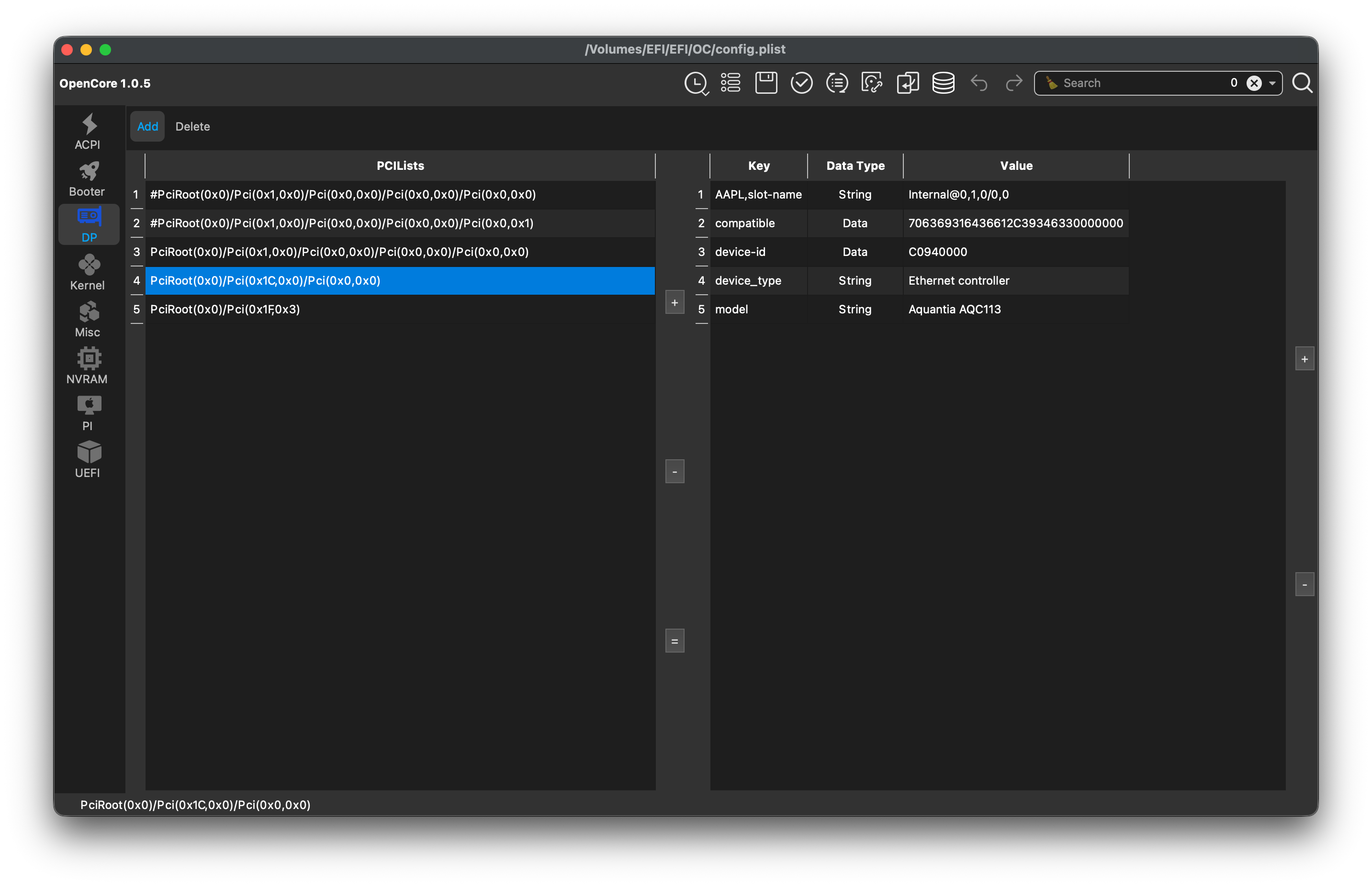

Cyberdevs Posted July 30, 2025 Share Posted July 30, 2025 @Casey_S.J. and others with Aquantia AQC-113C 10GB Ethernet Adapters: I've been using SSDT-Aquantia-AQC113C.aml and DTPG.aml with ForeceAquantiaEthernet Quirk on my GA-Z690 Aorus Master Rig from macOS Monterey but I recently came across these settings which seems to be working just fine on macOS Tahoe and earlier so far. I don't need to use Kernel Patches or the SSDTs I've mentioned above, just thought you might be interested.  compatible: 706369316436612C39346330000000 (Data) device-id: C0940000 (Data)  Spoiler  2 Link to comment https://www.insanelymac.com/forum/topic/361162-pre-release-macos-tahoe/page/117/#findComment-2838124 Share on other sites More sharing options...
Casey_S.J. Posted July 30, 2025 Share Posted July 30, 2025 (edited) 1 hour ago, Cyberdevs said: @Casey_S.J. and others with Aquantia AQC-113C 10GB Ethernet Adapters: I've been using SSDT-Aquantia-AQC113C.aml and DTPG.aml with ForeceAquantiaEthernet Quirk on my GA-Z690 Aorus Master Rig from macOS Monterey but I recently came across these settings which seems to be working just fine on macOS Tahoe and earlier so far. I don't need to use Kernel Patches or the SSDTs I've mentioned above, just thought you might be interested.  compatible: 706369316436612C39346330000000 (Data) device-id: C0940000 (Data)   @Cyberdevs Is AppleVTD enabled on your Intel system (GA-Z690)? The Aquantia kext patches are only needed when AppleVTD is (a) unavailable as on AMD systems, or (b) intentionally disabled on Intel systems. A detailed explanation of the patches is provided here:  https://forum.amd-osx.com/threads/ryzen-7000-testing.3318/page-79#post-25661 Edited July 30, 2025 by Casey_S.J. 2 Link to comment https://www.insanelymac.com/forum/topic/361162-pre-release-macos-tahoe/page/117/#findComment-2838139 Share on other sites More sharing options...
