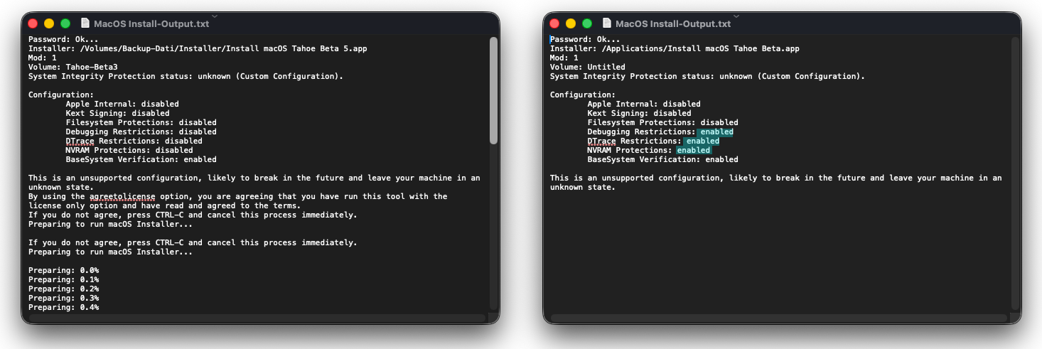

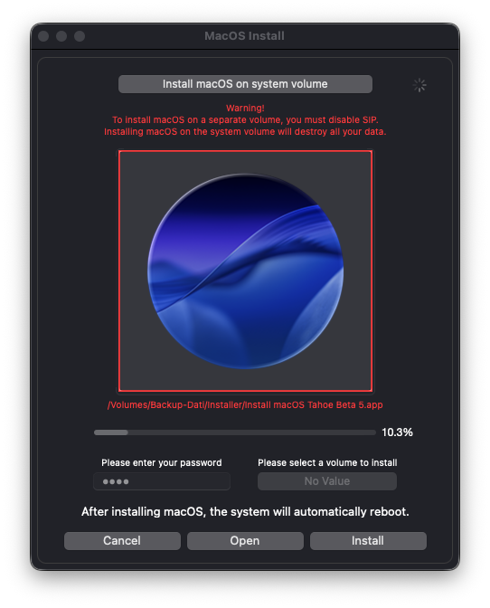

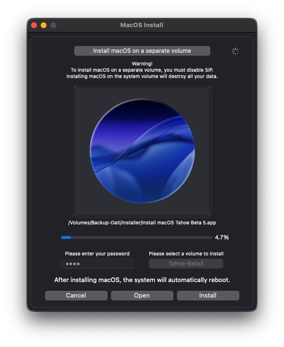

Sergey_Galan Posted August 8, 2025 Share Posted August 8, 2025 (edited) 10 minutes ago, eSaF said: @Sergey_Galan Hi Bro glad you're here. The MacOS Install App is not installing again. Same as before, progress bar is over in 2 to 3 seconds with no image placed on the destination Drive. Hi, I think you need to install SIP 67080000 This is yours System Integrity Protection status: unknown (Custom Configuration). Configuration: Apple Internal: disabled Kext Signing: disabled Filesystem Protections: disabled Debugging Restrictions: enabled DTrace Restrictions: enabled NVRAM Protections: enabled BaseSystem Verification: enabled This is an unsupported configuration, likely to break in the future and leave your machine in an unknown state. This is mine (67080000) System Integrity Protection status: unknown (Custom Configuration). Configuration: Apple Internal: disabled Kext Signing: disabled Filesystem Protections: disabled Debugging Restrictions: disabled DTrace Restrictions: disabled NVRAM Protections: disabled BaseSystem Verification: enabled This is an unsupported configuration, likely to break in the future and leave your machine in an unknown Edited August 8, 2025 by Sergey_Galan Link to comment https://www.insanelymac.com/forum/topic/361162-pre-release-macos-tahoe/page/125/#findComment-2838682 Share on other sites More sharing options...
Anto65 Posted August 8, 2025 Share Posted August 8, 2025 It works here, with the SIP value 67080000 with both options: external or internal disk. I'm using version 1.0.3. Spoiler eSaF you may need to reset the NVRAM if you set the value to 67080000 (Right side yours) Spoiler 1 Link to comment https://www.insanelymac.com/forum/topic/361162-pre-release-macos-tahoe/page/125/#findComment-2838683 Share on other sites More sharing options...

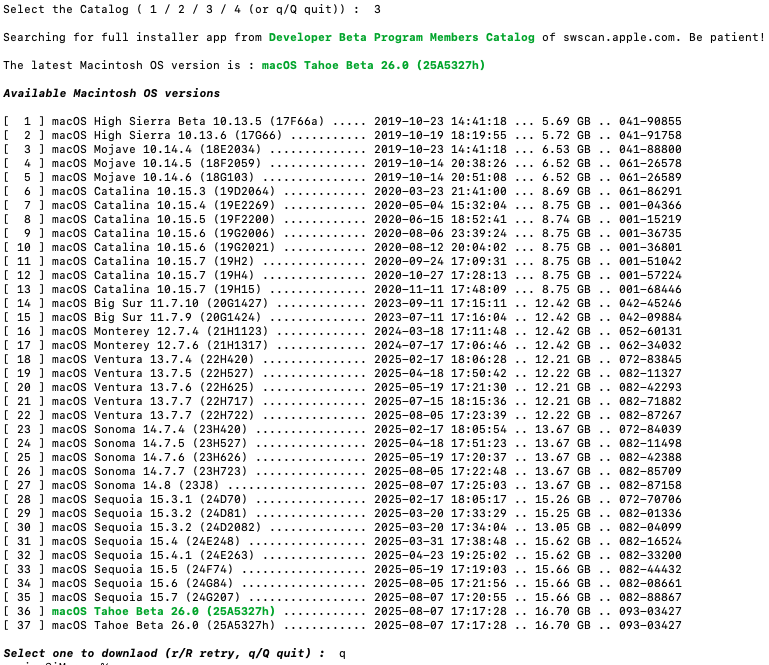

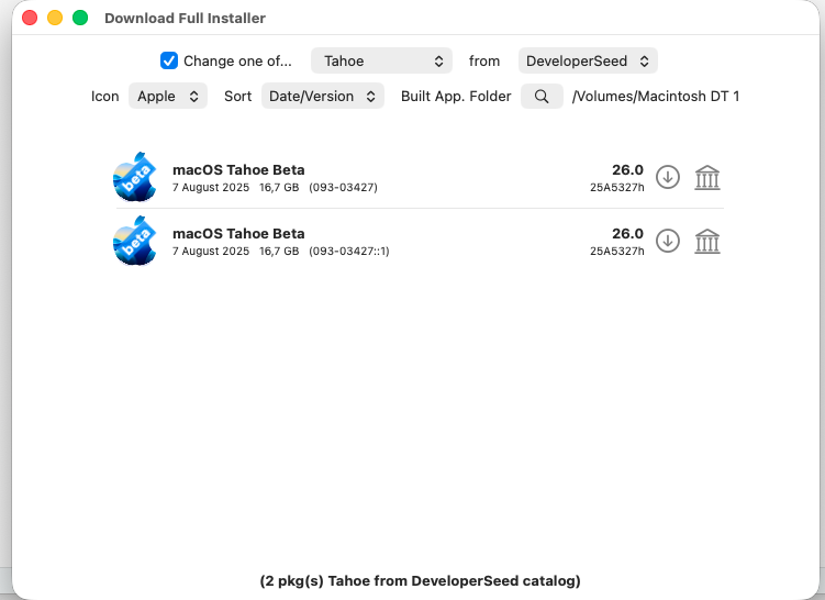

matxpa Posted August 8, 2025 Share Posted August 8, 2025 Hi Two distinct Tahoe Beta5 Product Id from catalog Developer Beta Program Members Catalog 26 https://swscan.apple.com/content/catalogs/others/index-26seed-26-15-14-13-12-10.16-10.15-10.14-10.13-10.12-10.11-10.10-10.9-mountainlion-lion-snowleopard-leopard.merged-1.sucatalog lines Product Id 98061: <key>093-03427</key> ... 98119: <string>https://swcdn.apple.com/content/downloads/57/10/093-03427-A_EP0000QBQL/kigtf6ec5qcfnpgv2m9fkqi8aosx7e3enl/InstallAssistant.pkg</string> 98143: <string>https://swdist.apple.com/content/downloads/57/10/093-03427-A_EP0000QBQL/kigtf6ec5qcfnpgv2m9fkqi8aosx7e3enl/093-03427.English.dist</string> 98146: <key>093-03427::1</key> ... 98204: <string>https://swcdn.apple.com/content/downloads/20/62/093-03427-A_VPBSKN71MH/fmippe2qf0vqiv0mdu2sheyjvfiwkkrj9i/InstallAssistant.pkg</string> 98228: <string>https://swdist.apple.com/content/downloads/20/62/093-03427-A_VPBSKN71MH/fmippe2qf0vqiv0mdu2sheyjvfiwkkrj9i/093-03427.English.dist</string> Spoiler Regards 2 Link to comment https://www.insanelymac.com/forum/topic/361162-pre-release-macos-tahoe/page/125/#findComment-2838684 Share on other sites More sharing options...

Matgen84 Posted August 8, 2025 Share Posted August 8, 2025 @matxpa @Anto65 Did Apple confuse the Beta channel (Public Beta) with the Seed channel (Developer Beta)? 😅 1 Link to comment https://www.insanelymac.com/forum/topic/361162-pre-release-macos-tahoe/page/125/#findComment-2838690 Share on other sites More sharing options...
bluenote56 Posted August 8, 2025 Share Posted August 8, 2025 1 hour ago, eSaF said: @Sergey_Galan @Anto65 - Thanks guys, SIP change was the fix. You know the old saying.........'There is no fool like an old fool'..........Well that is me. Incidentally, my version is this one attached. Thanks again fellows. It seems some guys in the world power chambers missed this pearl.. 2 Link to comment https://www.insanelymac.com/forum/topic/361162-pre-release-macos-tahoe/page/125/#findComment-2838691 Share on other sites More sharing options...

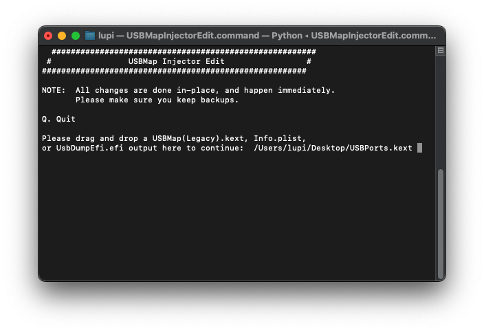

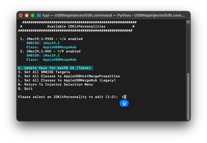

Zevgoli Posted August 8, 2025 Share Posted August 8, 2025 On 7/1/2025 at 4:10 PM, Anto65 said: @Max.1974 You can convert the USBPorts.kext ( Hackintool or old USBMap.kext ) for Tahoe by running USBMapInjectorEdit.command or USBMapInjectorEdit.py (requires python) inside the corpnewt USBMap app modify the Smbios and more Hide contents Hey, I managed to convert the USBMap.kext to Tahoe. I get to the next screen and I get this terminal prompt: Please select an IOKitPersonality to edit (1-1) Do I choose something here or am I done? Link to comment https://www.insanelymac.com/forum/topic/361162-pre-release-macos-tahoe/page/125/#findComment-2838692 Share on other sites More sharing options...

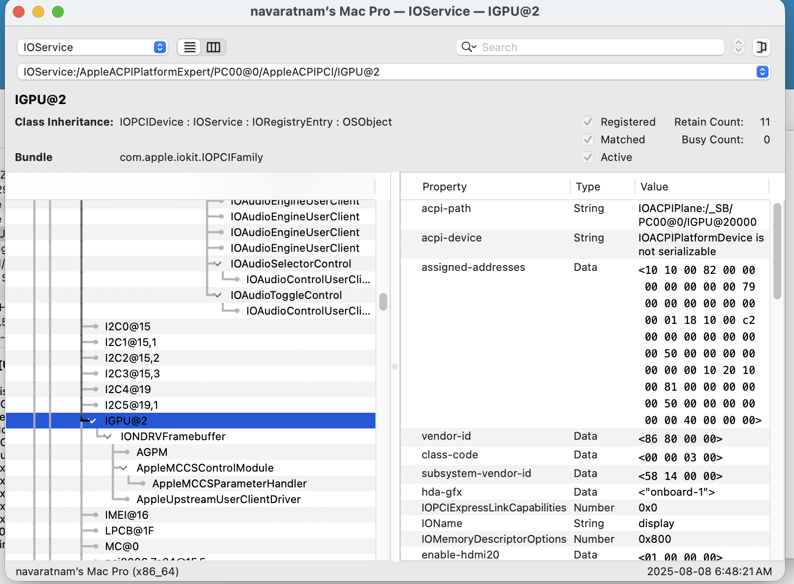

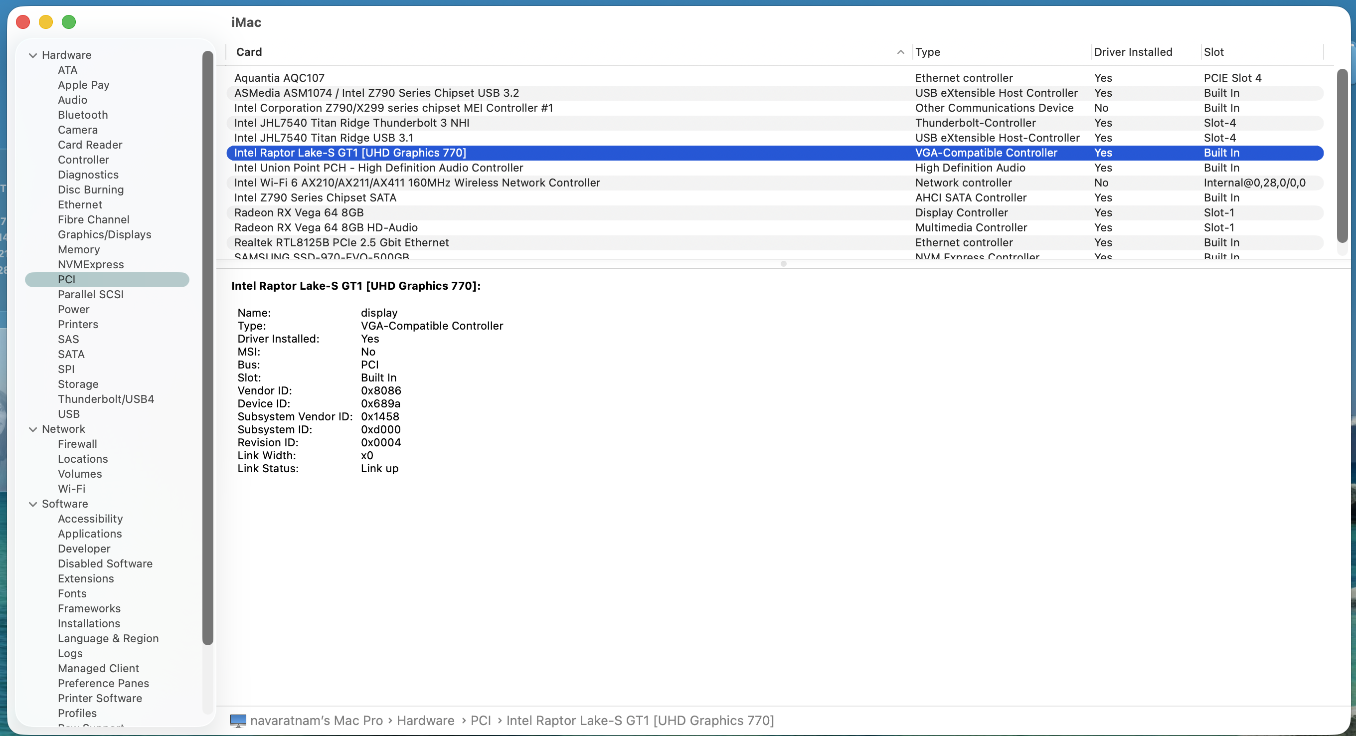

Luminadevapps Posted August 8, 2025 Share Posted August 8, 2025 (edited) Finally Intel Raptor Lake worked. SSDT-IGPU-1.aml Notes IF you Add -wegnoigpu pelese remove. I use iMac20,2 Edited August 8, 2025 by nmano 4 2 Link to comment https://www.insanelymac.com/forum/topic/361162-pre-release-macos-tahoe/page/125/#findComment-2838693 Share on other sites More sharing options...
deeveedee Posted August 8, 2025 Share Posted August 8, 2025 @nmano Your hack appears to have a Radeon dGPU (as I would expect with Intel > 10th Gen). What do you mean by 'Finally Intel Raptor Lake worked'? Are you saying you are using your intel Raptor Lake iGPU with macOS? 1 Link to comment https://www.insanelymac.com/forum/topic/361162-pre-release-macos-tahoe/page/125/#findComment-2838697 Share on other sites More sharing options...
Luminadevapps Posted August 8, 2025 Share Posted August 8, 2025 (edited) 28 minutes ago, deeveedee said: @nmano Your hack appears to have a Radeon dGPU (as I would expect with Intel > 10th Gen). What do you mean by 'Finally Intel Raptor Lake worked'? Are you saying you are using your intel Raptor Lake iGPU with macOS? My System Z790 Gaming X First time I see this result. My CPU Intel Core I9 13900K Yes. Edited August 8, 2025 by nmano 1 1 Link to comment https://www.insanelymac.com/forum/topic/361162-pre-release-macos-tahoe/page/125/#findComment-2838699 Share on other sites More sharing options...
deeveedee Posted August 8, 2025 Share Posted August 8, 2025 @nmano Just to be sure I understand, you are only claiming that Intel Raptor Lake graphics appears in your macOS PCI device list - correct? That's not how I would define 'Raptor Lake Worked,' which is why I'm asking. 1 Link to comment https://www.insanelymac.com/forum/topic/361162-pre-release-macos-tahoe/page/125/#findComment-2838700 Share on other sites More sharing options...
Stefanalmare Posted August 8, 2025 Share Posted August 8, 2025 (edited) 1 hour ago, nmano said: Finally Intel Raptor Lake worked. SSDT-IGPU-1.aml 458 B · 7 downloads Notes IF you Add -wegnoigpu pelese remove. I use iMac20,2 Start Intel Power Gadget, VidoProc Converter, and look if IGPU is used when decoding/encoding H264/HEVC. If not, and I suppose so, ........... Edited August 8, 2025 by Stefanalmare 1 Link to comment https://www.insanelymac.com/forum/topic/361162-pre-release-macos-tahoe/page/125/#findComment-2838701 Share on other sites More sharing options...
Luminadevapps Posted August 8, 2025 Share Posted August 8, 2025 11 minutes ago, Stefanalmare said: Start Intel Power Gadget, VidoProc Converter, and look if IGPU is used when decoding/encoding H264/HEVC. If not, and I suppose so, ........... Now I am at work.Please test if you have time. Link to comment https://www.insanelymac.com/forum/topic/361162-pre-release-macos-tahoe/page/125/#findComment-2838702 Share on other sites More sharing options...
Stefanalmare Posted August 8, 2025 Share Posted August 8, 2025 14 minutes ago, nmano said: Now I am at work.Please test if you have time. I have tried in Alder Lake with SMBIOS 20,1. The kext is loaded, IGPU with AGPM, but DGPU is used for encoding/decoding. So, it is just cosmetic. 1 Link to comment https://www.insanelymac.com/forum/topic/361162-pre-release-macos-tahoe/page/125/#findComment-2838703 Share on other sites More sharing options...
