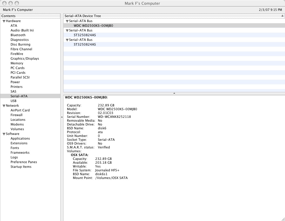

AppleIIGuy Posted February 3, 2007 Share Posted February 3, 2007 (edited) My system Nforce4 Chaintech VN4F/Ultra Installed osx on a pata drive. Installed the Nforce 4 SATA kext Then cloned it onto a 250 gb SATA drive. (Movies and music on the STAT are played correctly) Booted off the SATA get a waiting for root device error. In Windows is gives me this as the hw id PCI\VEN_10DE&DEV_0054&SUBSYS_10DECB84&REV_F3 and the device instance id as PCI\VEN_10DE&DEV_0054&SUBSYS_10DECB84&REV_F3\3&2411E6FE&0&38 so what goes into the Info.plist as the vendor id? Taken from the system profiler when booted from my pata drive AppleNForceATA: Version: 1.0.2 Last Modified: 1/26/07 7:50 PM Get Info String: 1.0.2, Copyright Apple Computer, Inc. 2004 Location: /System/Library/Extensions/AppleNForceATA.kext kext Version: 1.0.2 Load Address: 0x4caa2000 Valid: Yes Authentic: Yes Dependencies: Incomplete Dependency Errors: com.apple.iokit.IOATAFamily: No valid version of this dependency can be found Integrity: Kext has no receipt Edited February 4, 2007 by AppleIIGuy Link to comment Share on other sites More sharing options...

Thico Alves Posted February 4, 2007 Share Posted February 4, 2007 My system Nforce4 Chaintech VN4F/Ultra Installed osx on a pata drive. Installed the Nforce 4 SATA kext Then cloned it onto a 250 gb SATA drive. (Movies and music on the STAT are played correctly) Booted off the SATA get a waiting for root device error. In Windows is gives me this as the hw id PCI\VEN_10DE&DEV_0054&SUBSYS_10DECB84&REV_F3 and the device instance id as PCI\VEN_10DE&DEV_0054&SUBSYS_10DECB84&REV_F3\3&2411E6FE&0&38 so what goes into the Info.plist as the vendor id? Taken from the system profiler when booted from my pata drive AppleNForceATA: Version: 1.0.2 Last Modified: 1/26/07 7:50 PM Get Info String: 1.0.2, Copyright Apple Computer, Inc. 2004 Location: /System/Library/Extensions/AppleNForceATA.kext kext Version: 1.0.2 Load Address: 0x4caa2000 Valid: Yes Authentic: Yes Dependencies: Incomplete Dependency Errors: com.apple.iokit.IOATAFamily: No valid version of this dependency can be found Integrity: Kext has no receipt It seems that you haven't installed the kext correctly, because it's not even mounting your device (that should work 100% with this kext). So, try opening OSX on SATA using VMWare and then copy the kext to system/library/extensions. Then open terminal and do that: sudo -s (type your password) chown -R root:wheel /System/Library/Extensions/(kext name).kext chmod -R 755 /System/Library/Extensions/(kext name).kext rm /System/Library/extensions.mkext rm /System/Library/extensions.kextcache exit exit that's the correct way to install any kext. Do that and try again! Thico Alves. Link to comment Share on other sites More sharing options...
AppleIIGuy Posted February 4, 2007 Share Posted February 4, 2007 (edited) Nope didn't work This is my system booted off the pata drive This happend when i put disk6s1 in the boot.plist Edited February 4, 2007 by AppleIIGuy Link to comment Share on other sites More sharing options...

MeDevil Posted February 4, 2007 Share Posted February 4, 2007 Nope didn't work This is my system booted off the pata drive This happend when i put disk6s1 in the boot.plist Did you modify the kext? Please, check the Info.plist on: - /System/Library/Extensions/IOATAFamily.kext - /System/Library/Extensions/AppleNForceATA.kext As you can see on the init process, there is an error while reading the xml (i think it's related to IOATAFamily). Also, make sure you delete your vendor/device id from: /System/Library/Extensions/IOATAFamily/Contents/PlugIns/AppleOnboardPCATA.kext/Contents/Info.plist Also, what version of osx do you have? This kext is compiled for 10.4.8 and will probabily not boot with older versions (haven't tried yet!). Greetings, Domenico. Link to comment Share on other sites More sharing options...
