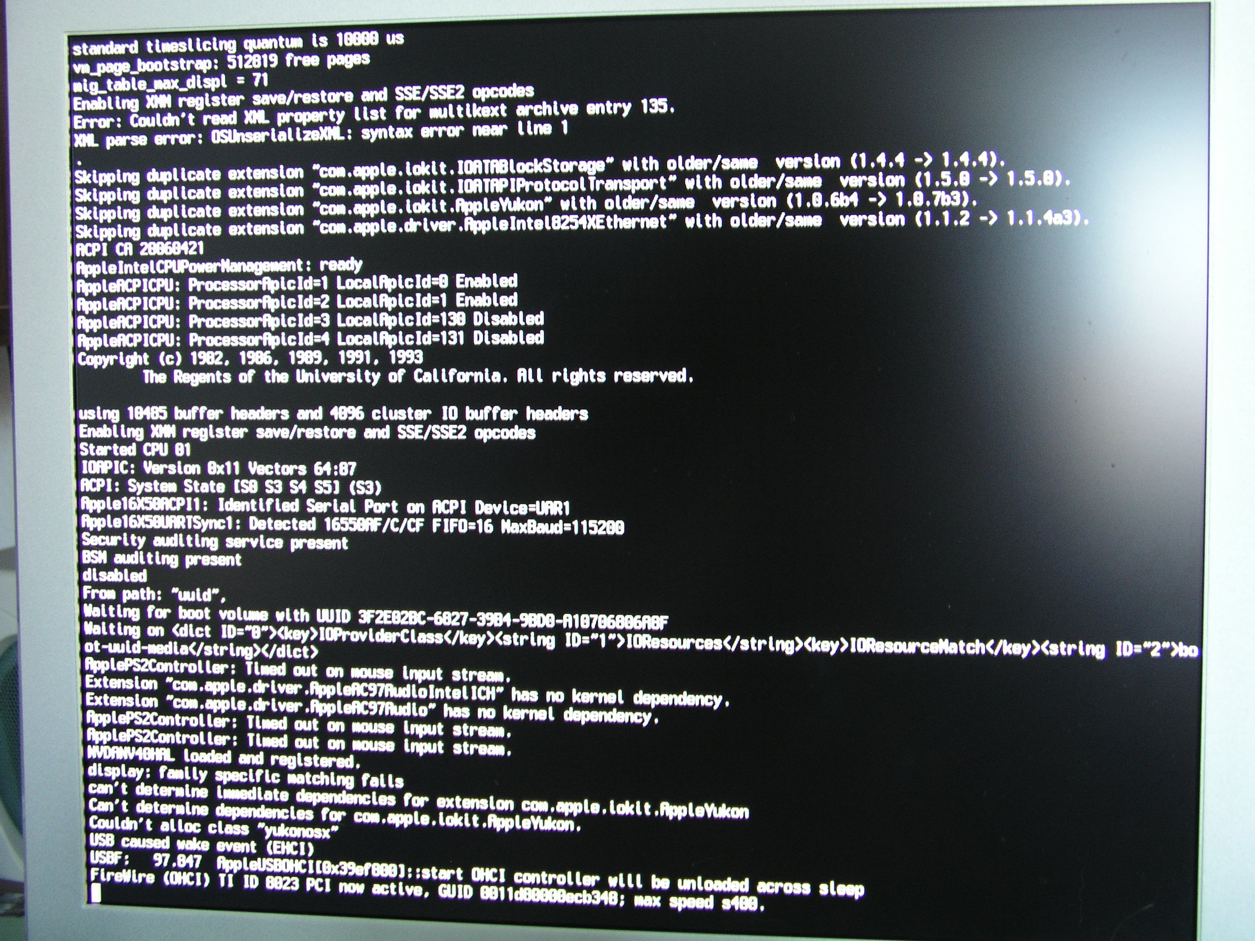

legs Posted January 30, 2007 Share Posted January 30, 2007 I have downloaded the Jas 10.4.8, but still get "Waiting for root device". I have tried the master to slave, slave to master, primary and secondary suggestions from other posts, but they don't seem to work. I have disabled my Sata/Raid 5 configuration, so only my 40gb Maxtor drive is being seen. I am currently downloading the "JaS 10.4.8 AMD Intel SSE2 SSE3 /W PPF1 Integrated & Defi......" version. Maybe this will help..... PC Description: Asus P5N32-SLI SE Deluxe P4 2.4 Core Dua E6600 eVGA 512-P2-N637-AR GeForce 7950GT 512MB 2gb Kingston 667mhz Raid 5 with 4 x 160gb Sata Seagate HDD's Primary IDE Master - Maxtor 40gb Slave - Plextor DVD Burner Secondary IDE Master - Plextor CD-RW Slave - Toshiba DVD Looking to see why I still get "Waiting for root device" Here is a screen shot: Link to comment https://www.insanelymac.com/forum/topic/35985-darwin-nforce4-atasata-controller/page/10/#findComment-289559 Share on other sites More sharing options...
Overclocked Tardis Posted January 30, 2007 Share Posted January 30, 2007 Just simply wait. some progress was made today in the IRC. MeDevil says IRQ's seems to be the problem in regards to MCP51/55 nForce chipsets. @legs I don't see any nForce sata driver debug information in the shot you've included. hehe. Link to comment https://www.insanelymac.com/forum/topic/35985-darwin-nforce4-atasata-controller/page/10/#findComment-289583 Share on other sites More sharing options...
legs Posted January 31, 2007 Share Posted January 31, 2007 (edited) I took the Sata drive issue out of the equation (I think), by disabling the SATA drives via the BIOS. The 40gb IDE is the only drive active, with a FAT32 partition, and is waiting for OSx86 to be installed. I thought I saw someone in another thread get it working without SATA, but can't found where I read this. I was hoping that someone in this thread could point me in the right direction, but will keep watching this post for possible solutions. Any help would be greatly appreciated. Thanks!!!! @plat sajack the only thing missing in my screen shot is the repeated "waiting for root device" x E 43.419533. =D Edited January 31, 2007 by legs Link to comment https://www.insanelymac.com/forum/topic/35985-darwin-nforce4-atasata-controller/page/10/#findComment-289660 Share on other sites More sharing options...
jape Posted January 31, 2007 Share Posted January 31, 2007 (edited) legs: On your screenshot no kext is loading your PATA drive -- that means you have NO IOATAFamily kext at all, cause it would load the generic PATA driver. Probably due to that XML error on the first lines. I think you should regenerate the Extensions.mkext file. Edited January 31, 2007 by jape Link to comment https://www.insanelymac.com/forum/topic/35985-darwin-nforce4-atasata-controller/page/10/#findComment-289689 Share on other sites More sharing options...
legs Posted January 31, 2007 Share Posted January 31, 2007 =D And how do I do this during the initial installation process? I have installed an older version of OSx86 on my Dell laptop 10.4.?, and messed with kext files inside the OS, but never before the install. Sorry....nubee. Thanks in advance for your help Jape!! Link to comment https://www.insanelymac.com/forum/topic/35985-darwin-nforce4-atasata-controller/page/10/#findComment-289716 Share on other sites More sharing options...
