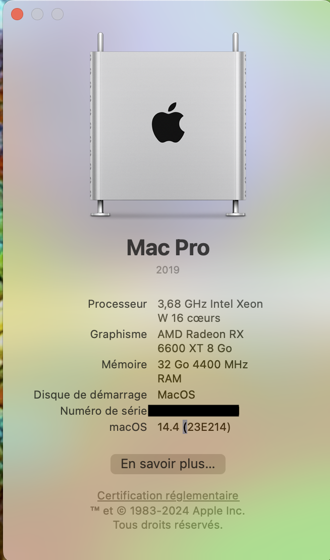

Anto65 Posted March 4, 2024 Author Share Posted March 4, 2024 (edited) Spoiler Only reverted (OCLP same config.) ... downloading 🤞 😛 Edited March 4, 2024 by Antonuccio 4 1 Link to comment https://www.insanelymac.com/forum/topic/358588-pre-release-macos-sonoma-144/page/14/#findComment-2817618 Share on other sites More sharing options...

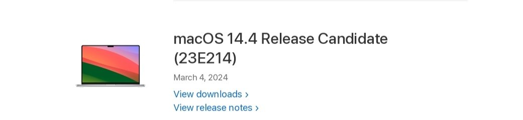

Anto65 Posted March 4, 2024 Author Share Posted March 4, 2024 6 1 Link to comment https://www.insanelymac.com/forum/topic/358588-pre-release-macos-sonoma-144/page/14/#findComment-2817623 Share on other sites More sharing options...

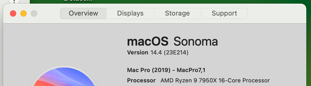

fabiosun Posted March 4, 2024 Share Posted March 4, 2024 AMD patches work always well as usual 11 1 Link to comment https://www.insanelymac.com/forum/topic/358588-pre-release-macos-sonoma-144/page/14/#findComment-2817626 Share on other sites More sharing options...

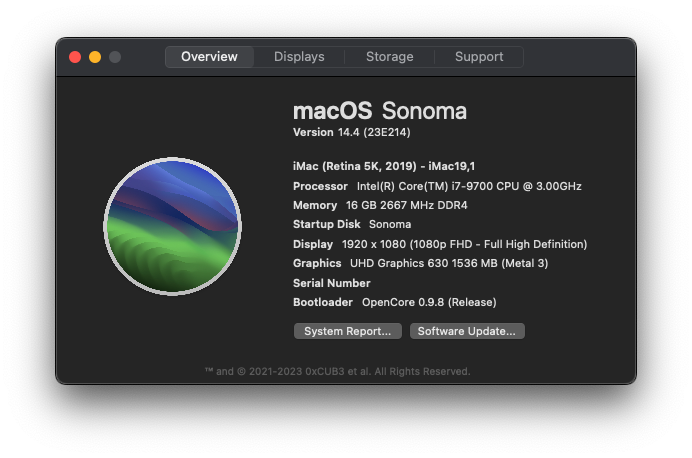

miliuco Posted March 4, 2024 Share Posted March 4, 2024 Updated with no issue. This time, Intel AX210 without OCLP root patch so I got incremental update (iMac19,1). So far, all is working fine. 8 1 Link to comment https://www.insanelymac.com/forum/topic/358588-pre-release-macos-sonoma-144/page/14/#findComment-2817631 Share on other sites More sharing options...

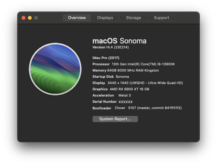

Max.1974 Posted March 4, 2024 Share Posted March 4, 2024 Everething is nice and smooth with OTA Update Clover 5157 Aorus Raptor Lake i9-13900k Lenovo Kaby Lake E470 i5-7200-U 12 1 Link to comment https://www.insanelymac.com/forum/topic/358588-pre-release-macos-sonoma-144/page/14/#findComment-2817635 Share on other sites More sharing options...

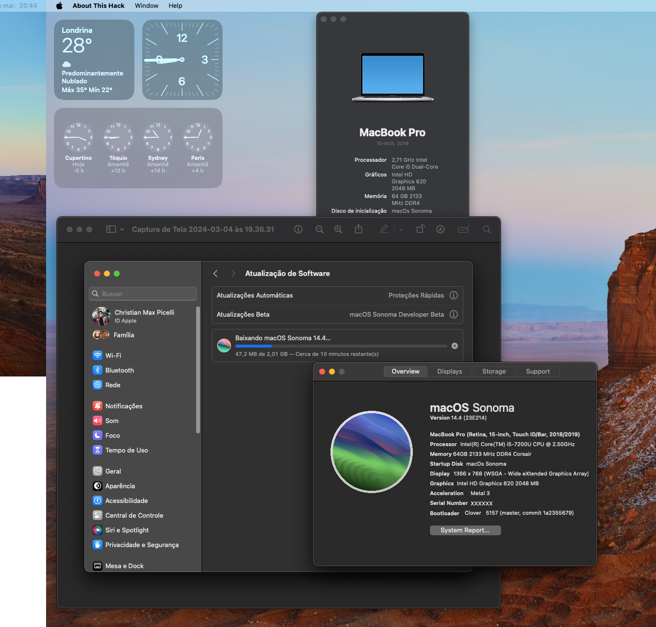

Max.1974 Posted March 4, 2024 Share Posted March 4, 2024 Lenovo All fine Thanks all you guys Spoiler 10 1 Link to comment https://www.insanelymac.com/forum/topic/358588-pre-release-macos-sonoma-144/page/14/#findComment-2817637 Share on other sites More sharing options...

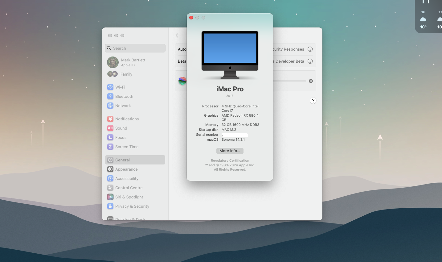

gsxb Posted March 5, 2024 Share Posted March 5, 2024 Hi all after reverting the oclp patches for modern wifi I downloaded the 14,4 update which came in a 2GB the update took approx 15 min on a Z97m-plus with a 4790K,32GB ram and a sabent 256GB M.2 I reinstalled the root patches from OCLP 1.4 nightly and updated the IOSkywalkFamily.kext in my OC EFI KEXTS everything went smoothly see attached pics 3 Link to comment https://www.insanelymac.com/forum/topic/358588-pre-release-macos-sonoma-144/page/14/#findComment-2817658 Share on other sites More sharing options...

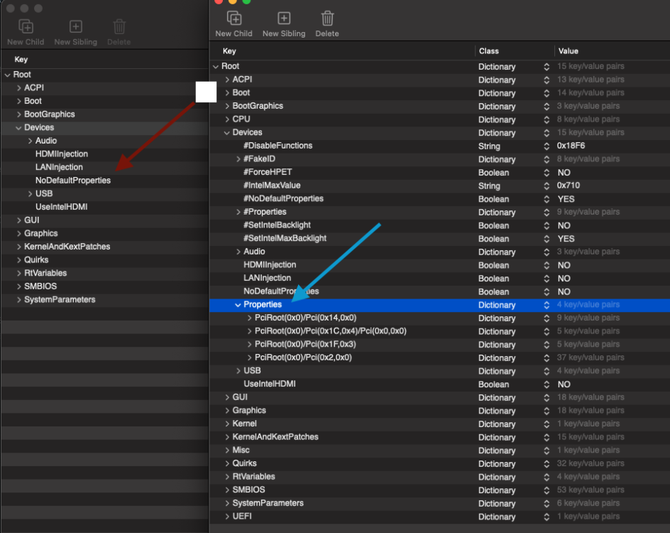

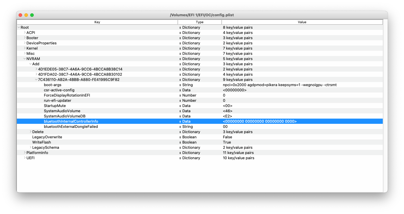

Allan Posted March 6, 2024 Share Posted March 6, 2024 On 2/7/2024 at 5:50 PM, Max.1974 said: Nice my friend, don't forget two lines on Nvram bluetoothInternalControllerInfo data 00000000 00000000 00000000 0000 bluetoothExternalDongleFailed. string 00 or bluetoothExternalDongleFailed. data 00 Reveal hidden contents Hey guys! How do I add those values on Clover? Thks 1 1 Link to comment https://www.insanelymac.com/forum/topic/358588-pre-release-macos-sonoma-144/page/14/#findComment-2817697 Share on other sites More sharing options...
Max.1974 Posted March 6, 2024 Share Posted March 6, 2024 6 hours ago, cankiulascmnfye said: It's not about getting updates. It's about the installer crashing Im discovery that DellSMBIOSpatch is necessary in 5157 revision If you need im post my EFI 26 minutes ago, Allan said: Hey guys! How do I add those values on Clover? Thks @Allan my dear brother, in Clover im not need use, works fine, but if you need add Nvram, I will check for you if is possible. 2 1 Link to comment https://www.insanelymac.com/forum/topic/358588-pre-release-macos-sonoma-144/page/14/#findComment-2817698 Share on other sites More sharing options...
Allan Posted March 6, 2024 Share Posted March 6, 2024 15 hours ago, Max.1974 said: Im discovery that DellSMBIOSpatch is necessary in 5157 revision If you need im post my EFI @Allan my dear brother, in Clover im not need use, works fine, but if you need add Nvram, I will check for you if is possible. Here is the config.plist, without the SMBios info config.plist Thank you pal! 😃 1 Link to comment https://www.insanelymac.com/forum/topic/358588-pre-release-macos-sonoma-144/page/14/#findComment-2817723 Share on other sites More sharing options...
Max.1974 Posted March 6, 2024 Share Posted March 6, 2024 Hi my brother @Allan my friend, you config plist not have insert Device Properties I Guess is the problem I compare with mine my brother If you need my EFI to compare I send to you in WhatsApp my brother Just call me there if you wanted 2 1 Link to comment https://www.insanelymac.com/forum/topic/358588-pre-release-macos-sonoma-144/page/14/#findComment-2817735 Share on other sites More sharing options...
Carlrose Posted March 6, 2024 Share Posted March 6, 2024 20 hours ago, seyd46 said: l use Opencore Try SecureBootModel=Disabled This worked but I would like to know why? Has Apple changed anything? I have had it in default and it updated fine before. 20 hours ago, miliuco said: @Carlrose Please upload here your config.plist. Thank you. I managed to fix it by just disabling secure boot. Thanks though 👍 2 Link to comment https://www.insanelymac.com/forum/topic/358588-pre-release-macos-sonoma-144/page/14/#findComment-2817737 Share on other sites More sharing options...
miliuco Posted March 6, 2024 Share Posted March 6, 2024 @Allan Actually I don't see any difference adding or removing those 2 Bluetooth properties in NVRAM, the system works fine in both ways. To add them into Clover, I don't know. @Carlrose Sometimes disabling SecureBoot Model is required to install or update the system but often you can enable it back after installation. 5 Link to comment https://www.insanelymac.com/forum/topic/358588-pre-release-macos-sonoma-144/page/14/#findComment-2817740 Share on other sites More sharing options...
