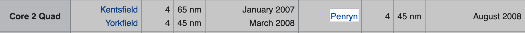

Stefanalmare Posted August 31, 2020 Share Posted August 31, 2020 9 minutes ago, Matgen84 said: You're sur that HP Desktop Core2Duo config is compatible with Big Sur ! I have Quad Processor Q9300 and I suppose it works: https://dortania.github.io/OpenCore-Install-Guide/config.plist/legacy/penryn.html Link to comment https://www.insanelymac.com/forum/topic/350754-opencore-general-discussion/page/239/#findComment-2735984 Share on other sites More sharing options...
Matgen84 Posted August 31, 2020 Share Posted August 31, 2020 (edited) 24 minutes ago, Stefanalmare said: I have Quad Processor Q9300 and I suppose it works: https://dortania.github.io/OpenCore-Install-Guide/config.plist/legacy/penryn.html Opencore is a bootloader who can boot several macOS version. Apple specifies that macOS Big Sur runs on these Macs: MacBook (2015 and later) MacBook Air (2013 and later) MacBook Pro (Late 2013 and later) iMac Pro (2017 and later) iMac (2014 and later) --> at least Haswell Mac mini (2014 and later) Mac Pro (2013 and later) --> at least Core Xeon W Your HP corresponds to an Imac 2008-2009. Have a look to macrumors site for Unsupported Mac by Big Sur instructions. Old system patchedSorry for my bad English. Edited August 31, 2020 by Matgen84 1 Link to comment https://www.insanelymac.com/forum/topic/350754-opencore-general-discussion/page/239/#findComment-2735985 Share on other sites More sharing options...
MacNB Posted August 31, 2020 Share Posted August 31, 2020 44 minutes ago, Stefanalmare said: I have Quad Processor Q9300 and I suppose it works: https://dortania.github.io/OpenCore-Install-Guide/config.plist/legacy/penryn.html Mojave, Catalina AND Big Sur are NOT supported on Q9300 officially by Apple. You have to make sure that you have made the correct "workarounds". Eg. Install the Telemetrytrap kext or Mousse kext if you are using AMD graphics. 1 Link to comment https://www.insanelymac.com/forum/topic/350754-opencore-general-discussion/page/239/#findComment-2735991 Share on other sites More sharing options...

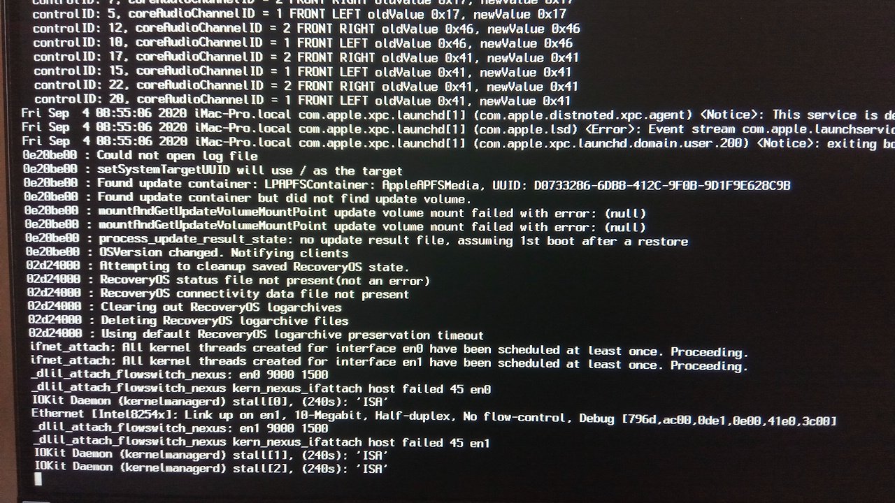

ghost8282 Posted September 4, 2020 Share Posted September 4, 2020 (edited) On 8/23/2020 at 11:12 AM, ghost8282 said: Hi all! I have a weird issue with Big Sur. The issue started with beta 1 and it was related to accessing the system preference panel --> Network: the panel opens soon but it took a long time (several minutes) to load the list of my two virtual networks (ethernet) on the left of the panel and nothing strange showed up in the mac os logs. The network panel issue was there from beta 1 to beta 4. In beta 5 the network panel and the list of networks loads faster, it's ok, but booting mac os takes a lot of time (like 4 to 5 minutes) with the following messages, that I think are related to this issue: IOKit Daemon (kernelmanagerd) stall[0], (60s): 'ISA' IOKit Daemon (kernelmanagerd) stall[1], (60s): 'ISA' IOKit Daemon (kernelmanagerd) stall[2], (60s): 'ISA' IOKit Daemon (kernelmanagerd) stall[3], (60s): 'ISA' The same messages were displayed during installation and recovery but with stall time of 240s each. I was using the latest versions of opencore and kexts (lilu, whatevergreen, applealc, virtualsmc), checked/updated every day. I never had these problems with other versions of mac os. I'm not really sure that this is related to the bootloader or to mac os, anyone with the same issue? Here's a log from open core:opencore-2020-08-23-093509.txt mmm..same issue with beta 6. Noone having the same issue or anybody knows what 'isa' refers to? Apparently not related at all to networks, since if I remove all network cards the issue is still there.. Spoiler @Pavo I know you are using vm too, did you have the same issue? Edited September 4, 2020 by ghost8282 Link to comment https://www.insanelymac.com/forum/topic/350754-opencore-general-discussion/page/239/#findComment-2736353 Share on other sites More sharing options...
Pavo Posted September 4, 2020 Share Posted September 4, 2020 8 hours ago, ghost8282 said: mmm..same issue with beta 6. Noone having the same issue or anybody knows what 'isa' refers to? Apparently not related at all to networks, since if I remove all network cards the issue is still there.. Hide contents @Pavo I know you are using vm too, did you have the same issue? ISA refers to your qemu arg you added to the VM settings, I switched to bare metal install on my TRX40 now. Everything is working perfect. 1 Link to comment https://www.insanelymac.com/forum/topic/350754-opencore-general-discussion/page/239/#findComment-2736379 Share on other sites More sharing options...
ghost8282 Posted September 4, 2020 Share Posted September 4, 2020 (edited) 2 hours ago, Pavo said: ISA refers to your qemu arg you added to the VM settings thank you for replying, unfortunately I'm using virtualsmc not a qemu arg for the osk Edited September 4, 2020 by ghost8282 Link to comment https://www.insanelymac.com/forum/topic/350754-opencore-general-discussion/page/239/#findComment-2736387 Share on other sites More sharing options...
ghost8282 Posted September 5, 2020 Share Posted September 5, 2020 (edited) On 9/4/2020 at 10:39 AM, ghost8282 said: IOKit Daemon (kernelmanagerd) stall[0], (60s): 'ISA' IOKit Daemon (kernelmanagerd) stall[1], (60s): 'ISA' IOKit Daemon (kernelmanagerd) stall[2], (60s): 'ISA' Finally I found the culprit. Big Sur >= beta 5 doesn't like my AppleLPCInjector kext. By disabling it no more stall messages and boot and shutdown a lot faster. So, nothing to do with opencore, but maybe useful for others searching google for the same issue. Update: My injector kext was injecting pci8086,2918; to load again AppleLPC without stall messages now I'm injecting without any kext but simply in opencore pci8086,2916. Edited September 5, 2020 by ghost8282 1 Link to comment https://www.insanelymac.com/forum/topic/350754-opencore-general-discussion/page/239/#findComment-2736408 Share on other sites More sharing options...
