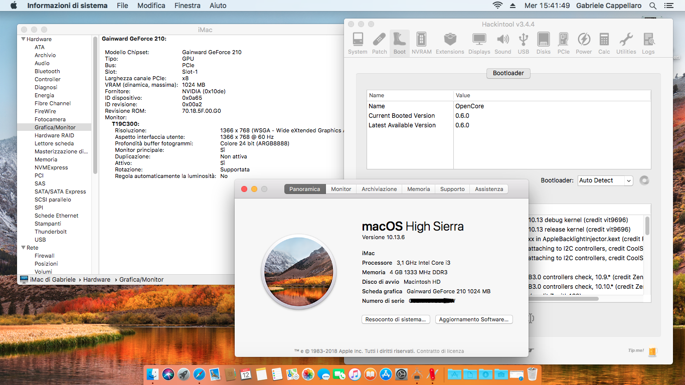

MacNB Posted August 12, 2020 Share Posted August 12, 2020 8 hours ago, CappeXXIII said: Thanks you very much. Now i can run in recovery without nv_disable and without any glitch, so i reinstalled macos for removing all clover junk. It reboots and without any problem it finished the second part of installation but at the third (and last reboot) i get black screen with working mouse and when I press a key the screen flashes. I leave in the attachment a gif to explain it better. Try different video output connector. Looks like default login port is on another connector. Before you try to reinstall macOS, did the existing macOS boot correctly and provide video output ? BTW, there was no reason to reinstall macOS just to remove Clover. You can remove Clover by just following these instructions. Link to comment https://www.insanelymac.com/forum/topic/350754-opencore-general-discussion/page/232/#findComment-2733942 Share on other sites More sharing options...
CappeXXIII Posted August 12, 2020 Share Posted August 12, 2020 Just now, MacNB said: Try different video output connector. I tried HDMI and VGA, now i will try also DVI. Just now, MacNB said: Looks like default login port is on another connector. This is most likely because if I move the mouse cursor to the right disappears, as if in fact there was another display. Just now, MacNB said: Before you try to reinstall macOS, did the existing macOS boot correctly and provide video output ? Same things, for that I reinstalled. Link to comment https://www.insanelymac.com/forum/topic/350754-opencore-general-discussion/page/232/#findComment-2733943 Share on other sites More sharing options...

MacNB Posted August 12, 2020 Share Posted August 12, 2020 12 hours ago, xKaoSx said: My full Efi folder in link I replied to you in that separate thread to Inject Nvidia. Try it. 2 hours ago, CappeXXIII said: I tried HDMI and VGA, now i will try also DVI. This is most likely because if I move the mouse cursor to the right disappears, as if in fact there was another display. Same things, for that I reinstalled. It's a shame you reinstalled as your original OS had booted and you could have logged in remotely from another system to get the new IOREG. Link to comment https://www.insanelymac.com/forum/topic/350754-opencore-general-discussion/page/232/#findComment-2733960 Share on other sites More sharing options...
CappeXXIII Posted August 12, 2020 Share Posted August 12, 2020 (edited) Just now, MacNB said: It's a shame you reinstalled as your original OS had booted and you could have logged in remotely from another system to get the new IOREG. I know, it's my mistake. I configurated new macOS using nv_disable=1, enabled Remote Screen and removed nv_disable. So i rebooted and connected using VNC but i can see the same thing: a black screen with working pointer. Edited August 12, 2020 by CappeXXIII Link to comment https://www.insanelymac.com/forum/topic/350754-opencore-general-discussion/page/232/#findComment-2733964 Share on other sites More sharing options...

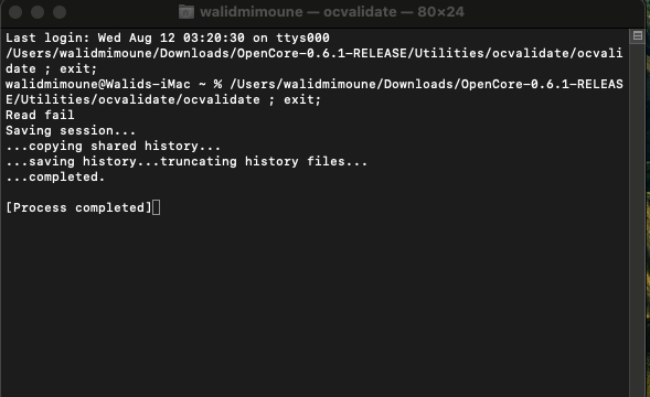

OneLife2000 Posted August 12, 2020 Share Posted August 12, 2020 hi guys how to fix this issue related to ocvalidate utilitie how to appendite it to config.plist Link to comment https://www.insanelymac.com/forum/topic/350754-opencore-general-discussion/page/232/#findComment-2733967 Share on other sites More sharing options...
SavageAUS Posted August 12, 2020 Share Posted August 12, 2020 hi guys how to fix this issue related to ocvalidate utilitie how to appendite it to config.plistI told you how in a different thread. Please don’t double post. Drag and drop ocvalidate into terminal then drag and drop your config.plist from finder into terminal window and press enter. Sent from my iPhone using Tapatalk Link to comment https://www.insanelymac.com/forum/topic/350754-opencore-general-discussion/page/232/#findComment-2733968 Share on other sites More sharing options...

MacNB Posted August 12, 2020 Share Posted August 12, 2020 (edited) 1 hour ago, CappeXXIII said: I know, it's my mistake. I configurated new macOS using nv_disable=1, enabled Remote Screen and removed nv_disable. So i rebooted and connected using VNC but i can see the same thing: a black screen with working pointer. Try the attached SSDT. I changed the boot-display to @0,AAPL,boot-display. SSDT-GFX0.aml Also, post your IOREG once you have booted with nv_disable=1. Edited August 12, 2020 by MacNB Link to comment https://www.insanelymac.com/forum/topic/350754-opencore-general-discussion/page/232/#findComment-2733974 Share on other sites More sharing options...
CappeXXIII Posted August 12, 2020 Share Posted August 12, 2020 15 minutes ago, MacNB said: Try the attached SSDT. I changed the boot-display to @0,AAPL,boot-display. SSDT-GFX0.aml Also, post your IOREG once you have booted with nv_disable=1. I don't know how to thank you! Now it works very well. Thanks again. Link to comment https://www.insanelymac.com/forum/topic/350754-opencore-general-discussion/page/232/#findComment-2733981 Share on other sites More sharing options...
MacNB Posted August 12, 2020 Share Posted August 12, 2020 47 minutes ago, CappeXXIII said: I don't know how to thank you! Now it works very well. Thanks again. You are welcome. Please post your IOREG. Link to comment https://www.insanelymac.com/forum/topic/350754-opencore-general-discussion/page/232/#findComment-2733987 Share on other sites More sharing options...

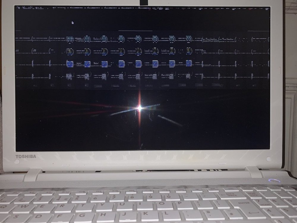

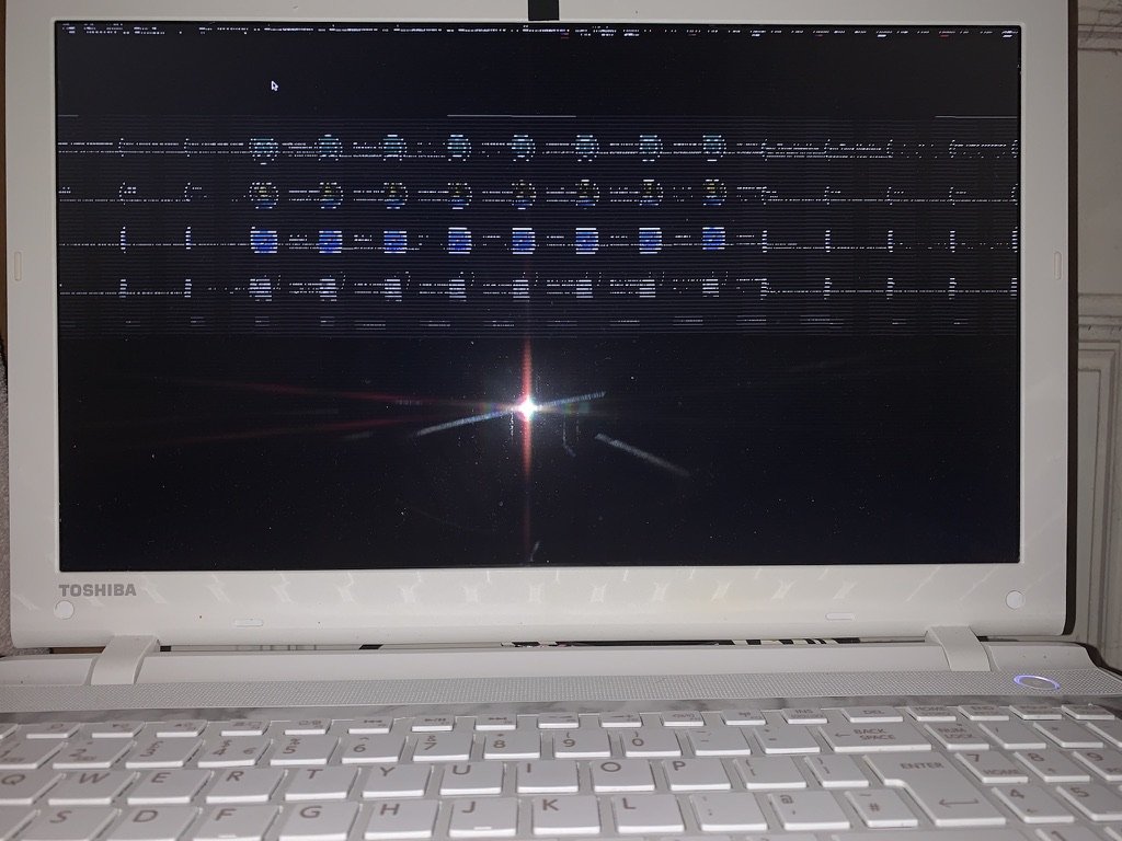

Deanor30 Posted August 12, 2020 Share Posted August 12, 2020 Hi Folks, I am trying to get Macos running on a Toshiba Satellite L50-C-22l using opencore 0.6. I have been able to get Catalina & BigSur public Beta running on a Dell 3020 with a I5 Haswell CPU and GT710 gpu and everything is working without issue with overall performance and boot time improving when switching from Clover to Opencore. So as a secondary project I though I would try to get same running on the Toshiba Satellite L50-C-22l using Dorthania's laptop guide for Broadwell and I am getting no panics. I created the SSDT's using SSDTtime and double checked the config.plist using the sanity checker. As you can see from the image below I am getting to the installer screen in BigSur but it is very distorted. I am getting the same when booting to Catalina. I have looked at a lot of forums on here and other Hachintosh sources and while this seems very common relating to the HD 5500 from Yosemite to Catalina, Nobody has posted an actual fix. I have tried: Applying framebuffer patches in the config.plist. Changing UEFI -> Resolution in the config.plist. All kexts & Drivers are the latest versions. I cannot enable the legacy or CSM boot mode on this laptop as otherwise the USB will not boot. There are no settings in bios to assign memory to GPU. Someone posted that putting the laptop to sleep and then waking the system can fix this issue but it has not worked for me and it seems a poor fix even if it did work. I have attached my EFI so any fixes or suggestions would be welcome. EFI.zip Link to comment https://www.insanelymac.com/forum/topic/350754-opencore-general-discussion/page/232/#findComment-2734006 Share on other sites More sharing options...

CappeXXIII Posted August 12, 2020 Share Posted August 12, 2020 2 hours ago, MacNB said: You are welcome. Please post your IOREG. iMac di Gabriele.ioreg But now i realized that when i am connected with the vga it sees another monitor on the right. how can i disable it? I need only VGA, DVI and HDMI can be disabled iMac di Gabriele.ioreg Link to comment https://www.insanelymac.com/forum/topic/350754-opencore-general-discussion/page/232/#findComment-2734019 Share on other sites More sharing options...
obus Posted August 12, 2020 Share Posted August 12, 2020 14 minutes ago, 5T33Z0 said: OCConfigCompare says you are missing a Key in your Config. I don't know if it matters, though. You can copy it over from the sample.plis That missing key isn't the problem (could be deleted according to Dortania Guide). Thank's anyway. 1 Link to comment https://www.insanelymac.com/forum/topic/350754-opencore-general-discussion/page/232/#findComment-2734020 Share on other sites More sharing options...
feartech Posted August 12, 2020 Share Posted August 12, 2020 7 minutes ago, CappeXXIII said: iMac di Gabriele.ioreg But now i realized that when i am connected with the vga it sees another monitor on the right. how can i disable it? I need only VGA, DVI and HDMI can be disabled iMac di Gabriele.ioreg VGA has not been used on mac's for a very long time, over 10 years.. 1 Link to comment https://www.insanelymac.com/forum/topic/350754-opencore-general-discussion/page/232/#findComment-2734022 Share on other sites More sharing options...
CappeXXIII Posted August 12, 2020 Share Posted August 12, 2020 1 minute ago, feartech said: VGA has not been used on mac's for a very long time, over 10 years.. Yeah I know but it's working fine, I only need to disable DVI and HDMI Link to comment https://www.insanelymac.com/forum/topic/350754-opencore-general-discussion/page/232/#findComment-2734023 Share on other sites More sharing options...
