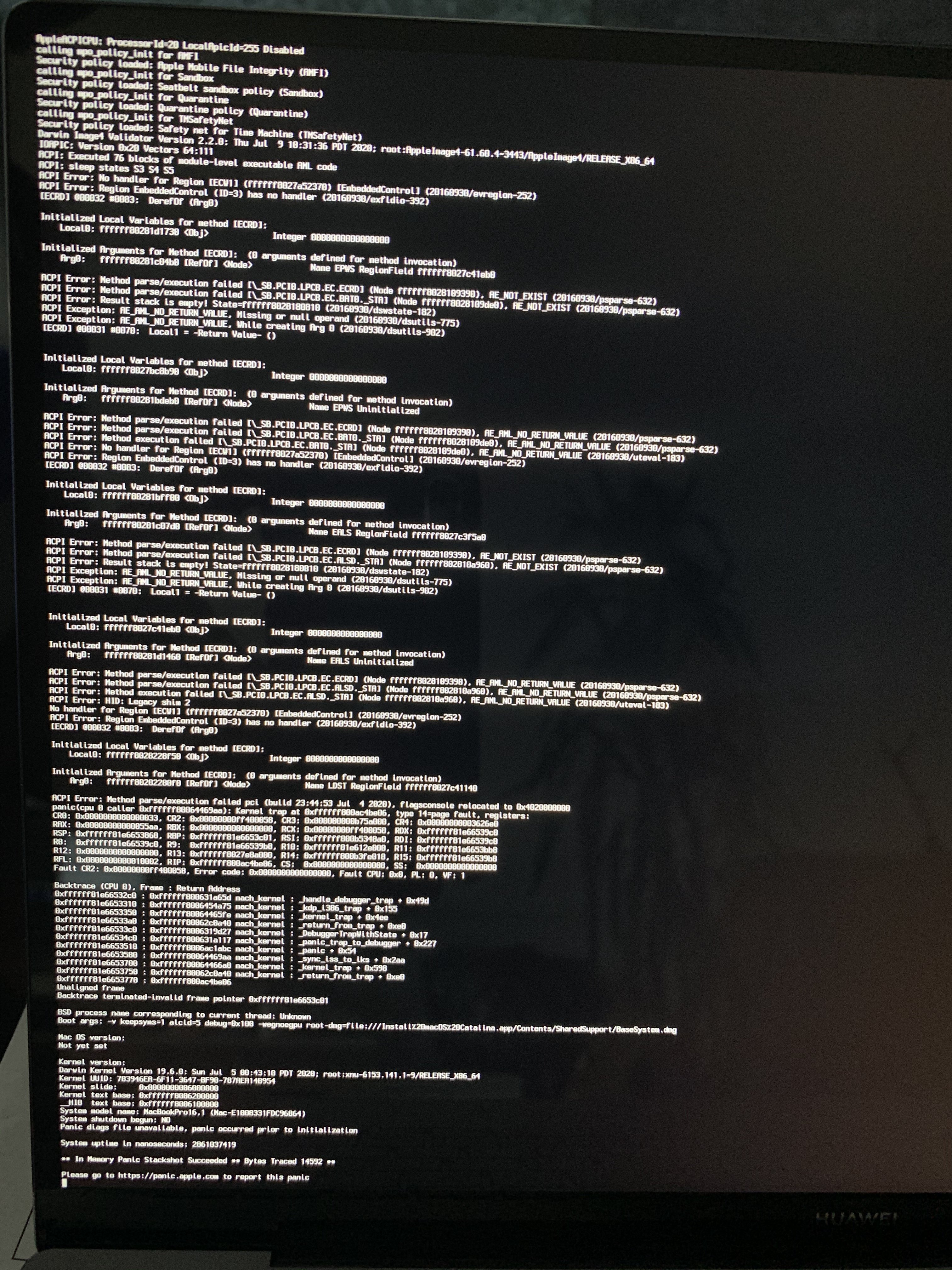

Killuminati91 Posted July 17, 2020 Share Posted July 17, 2020 (edited) Any Idea what this error is related to? Searching through the net gave me basically zero results. ACPI Error: Method parse/execution failed [\_SB.PCI0.LPCB.EC.ECRD] (Node ffffff8028109390), AE_NOT_EXIST (20160930/psparse-632) ACPI Error: Method parse/execution failed [\_SB.PCI0.LPCB.EC.BAT0._STA] (Node placeholder), AE_NOT_EXIST (placeholder) ACPI Error: Result stack is empty! EFI and Screenshot attached. EFI 2.0 DEBUG Dortania.zip Edited July 17, 2020 by Killuminati91 Link to comment https://www.insanelymac.com/forum/topic/350754-opencore-general-discussion/page/224/#findComment-2730714 Share on other sites More sharing options...

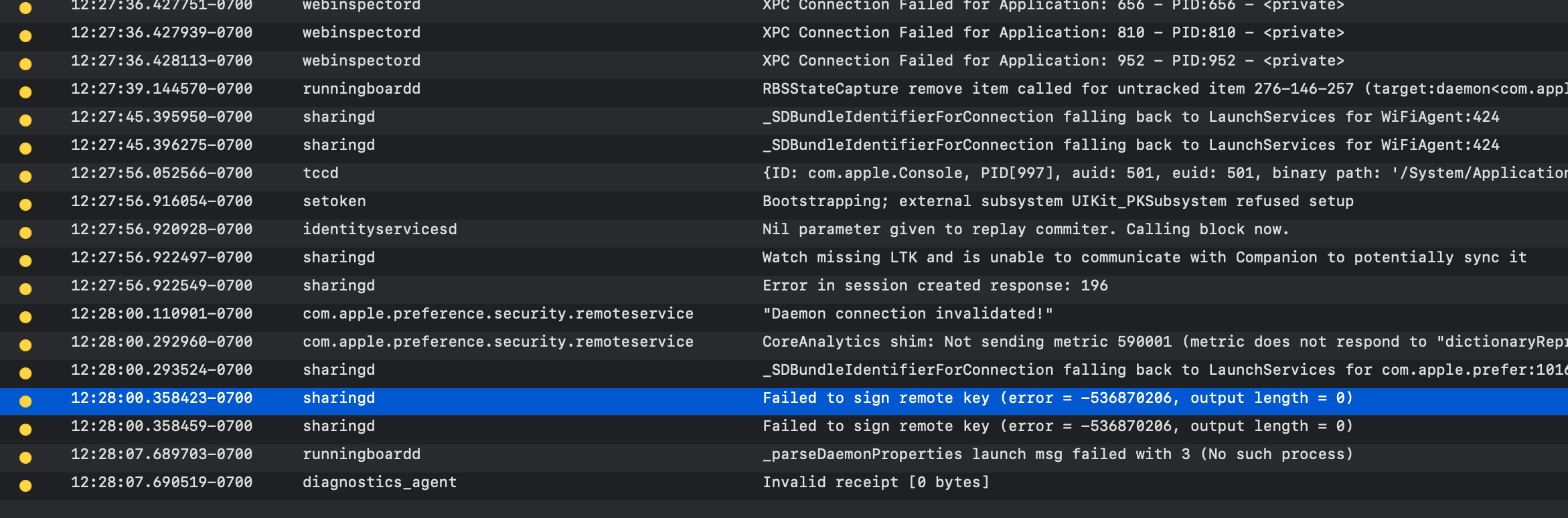

Tiem Posted July 17, 2020 Share Posted July 17, 2020 Updated to dd6e13c yesterday and woke up to my Watch unable to unlock my Hack. The setting is unchecked and when re-checking it errors out. Console reports the following: Signed out on my Mac. Rebooted all my devices. Everything else works, handoff, everything. Just not aWatch unlock. *throws PC out the window Link to comment https://www.insanelymac.com/forum/topic/350754-opencore-general-discussion/page/224/#findComment-2730784 Share on other sites More sharing options...
Tiem Posted July 17, 2020 Share Posted July 17, 2020 Ok resetting the aWatch fixed it. *runs outside to pick up the pieces of his PC Link to comment https://www.insanelymac.com/forum/topic/350754-opencore-general-discussion/page/224/#findComment-2730787 Share on other sites More sharing options...

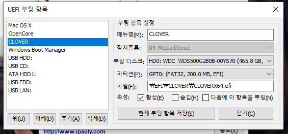

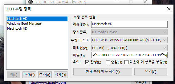

Sherlocks Posted July 18, 2020 Share Posted July 18, 2020 I have a question for boot entry. i usually use this option RequestBootVarRouting true Scan Policy 0 BlessOverride \EFI\Microsoft\Boot\bootmgfw.efi it shows clean boot picker 1. Windows 2. Macintosh HD 3. Recovery HD ~ but i found some issues of UEFI bootloader order in Windows. i usually control UEFI boot part easily from BOOTICEx64 but when using this option RequestBootVarRouting true Scan Policy 0 in windows, i can't see exact same boot entry in BIOS. so i change options. RequestBootVarRouting false Scan Policy 0 BlessOverride \EFI\Microsoft\Boot\bootmgfw.efi i can get exact same boot entry of BIOS in windows. but in boot picker. added two EFI entry. i want to remove two EFI and bootmgfw entries. i tried to change Scan Policy bit. it is no luck. anyone who give me tip? 1 Link to comment https://www.insanelymac.com/forum/topic/350754-opencore-general-discussion/page/224/#findComment-2730833 Share on other sites More sharing options...
Andrey1970 Posted July 18, 2020 Share Posted July 18, 2020 18 minutes ago, Sherlocks said: BlessOverride \EFI\Microsoft\Boot\bootmgfw.efi It isn't required for Windows, OpenCore knows this way. RequestBootVarRouting=true - surely need. Link to comment https://www.insanelymac.com/forum/topic/350754-opencore-general-discussion/page/224/#findComment-2730835 Share on other sites More sharing options...
Sherlocks Posted July 18, 2020 Share Posted July 18, 2020 10 minutes ago, Andrey1970 said: It isn't required for Windows, OpenCore knows this way. RequestBootVarRouting=true - surely need. RequestBootVarRouting=true i lost boot entry of BIOS in windows. if RequestBootVarRouting=false i get same boot entry of BIOS in windows. i prefer UEFI boot entry control in windows if needs. Link to comment https://www.insanelymac.com/forum/topic/350754-opencore-general-discussion/page/224/#findComment-2730837 Share on other sites More sharing options...
