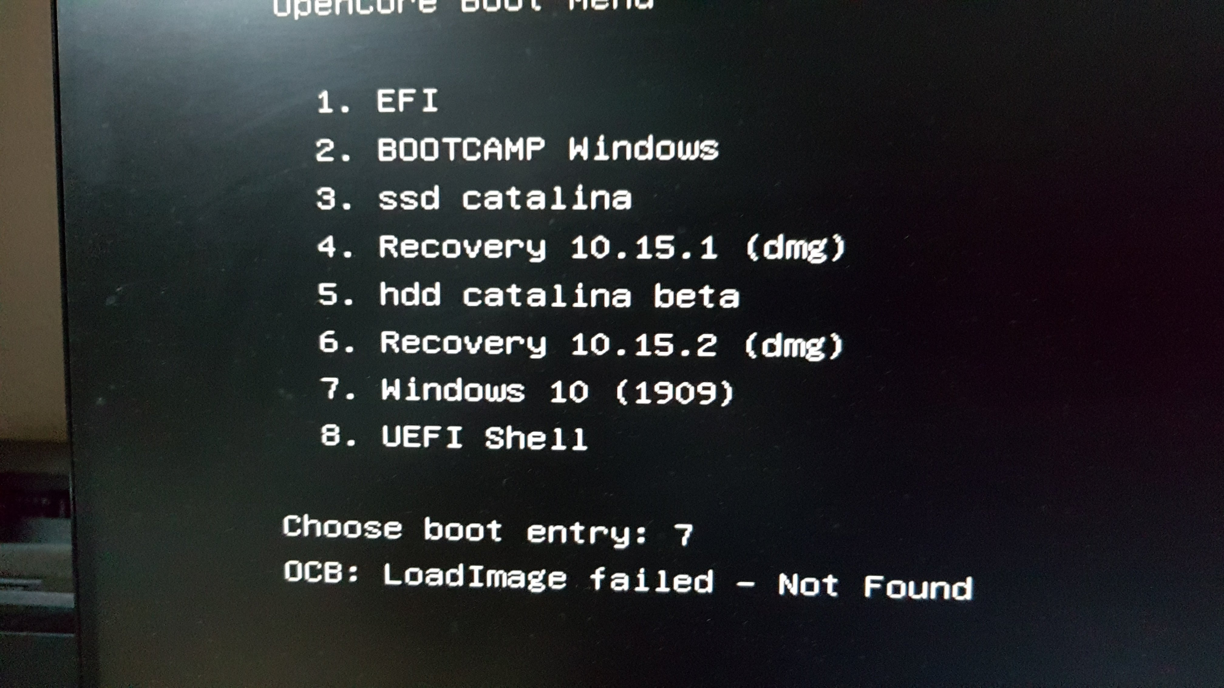

Are there any known issues about booting windows. I use veracrypt on old asus laptop and  this this entry:
                              <key>Arguments</key>
                              <string></string>
                                        <key>Name</key>
                                        <string>Vera</string>
                              <key>Comment</key>
                              <string>Not signed for security reasons</string>
                              <key>Enabled</key>
                              <true/>
                                        <key>Path</key>
                                        <string>PciRoot(0x0)/Pci(0x1F,0x2)/Sata(0x0,0xFFFF,0x0)/HD(1,GPT,8D0AD20F-B2D8-453E-852C-1AA2CCAF639D,0x44,0xFFBC)/\EFI\VeraCrypt\Dcs.efi</string>
                                </dict>
                        </array>
I get blue screen on windows boot using OC but ok boot using laptop bios. OC is overiding the ACPI BGTR logo for the windows too because the ASUS logo is AWOL
Also using the UEFI shell from edk2 to get the PciRoot device the result doesn't work because when I add debug I get the correct value Sata(0x0,0xFFFF,0x0) but with edk2 shell (probably buggy UEFI) which is annoying.
@l.monay @kaos kinkae
Check out this post:
 NTFS Driver is also needed. @l.monay You might need some arguments for veracrypt but that latter encryption seems problematic even with Clover.
Edited by Ellybz
  • Confused 1
Why would the NTFS driver be needed? The NTFS partition is encrypted. The problem is after veracrypt has decrypted the drived Windows doesn't work. If you boot windows without OC then the same install boots fine. The windows 10 loader and veracrypt both live on the ESP partition
Can you please explain why you think that NTFS is needed? Why would veracrypt need arguments, there are no arguments needed when you boot veracrypt from the shell.
What shell? "GUI Shell" as in the boot menu or UEFI Shell?
