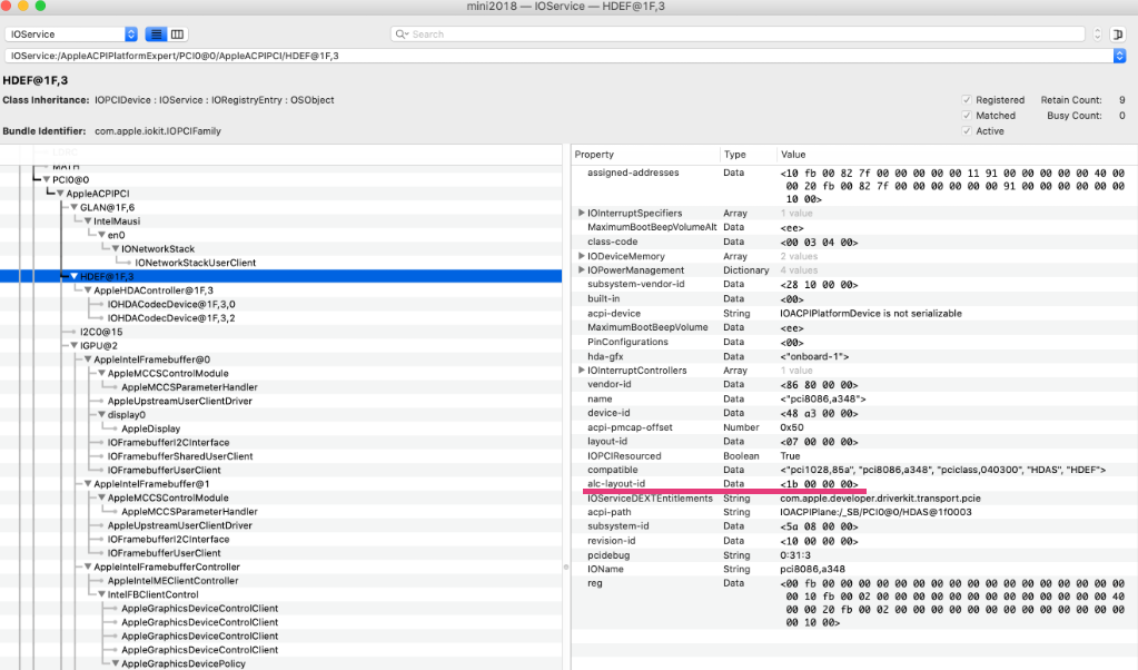

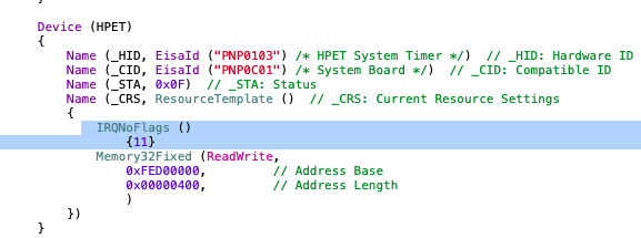

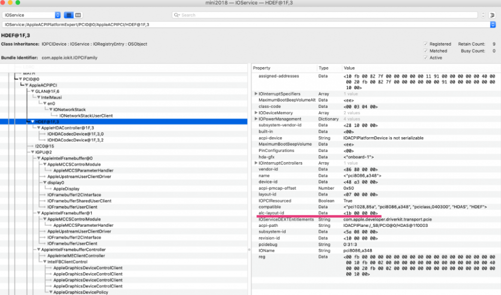

DanielMac Posted December 20, 2019 Share Posted December 20, 2019 On 12/14/2019 at 1:21 AM, Andrey1970 said: OK, so after hours of googling, it looks like OpenCore has a bug/issue/feature (whatever you want to call it), but the problem is that it doesn't load AppleHDA and so I get no sound. Do I need to open a bugtracker ticket somewhere for this? I have found a temporary solution, which is kind of weird, but OpenCore loads AppleHDA if I block a kext (I block HPET for what it's worth). I can give complete specs of my machine if required. Would be great if OpenCore could be fixed so I don't need this workaround. Link to comment https://www.insanelymac.com/forum/topic/350754-opencore-general-discussion/page/109/#findComment-2701214 Share on other sites More sharing options...
hardcorehenry Posted December 20, 2019 Share Posted December 20, 2019 2 hours ago, DanielMac said: OK, so after hours of googling, it looks like OpenCore has a bug/issue/feature (whatever you want to call it), but the problem is that it doesn't load AppleHDA and so I get no sound. Do I need to open a bugtracker ticket somewhere for this? I have found a temporary solution, which is kind of weird, but OpenCore loads AppleHDA if I block a kext (I block HPET for what it's worth). I can give complete specs of my machine if required. Would be great if OpenCore could be fixed so I don't need this workaround. Here you might find interesting info and you might want to take a look at this repository and the way HPET is disabled via small SSDT, don't know if it cause any problems in Windows, you'd have to check it. Link to comment https://www.insanelymac.com/forum/topic/350754-opencore-general-discussion/page/109/#findComment-2701232 Share on other sites More sharing options...

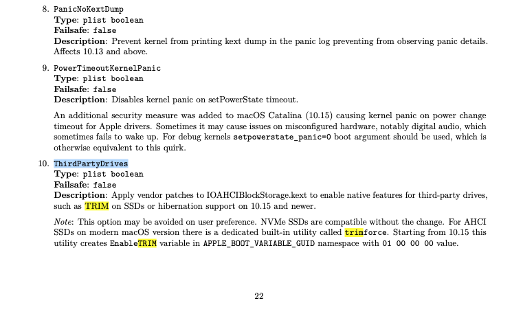

HmO Posted December 20, 2019 Share Posted December 20, 2019 This is bug? 1 Link to comment https://www.insanelymac.com/forum/topic/350754-opencore-general-discussion/page/109/#findComment-2701234 Share on other sites More sharing options...
DanielMac Posted December 20, 2019 Share Posted December 20, 2019 14 minutes ago, hardcorehenry said: Here you might find interesting info and you might want to take a look at this repository and the way HPET is disabled via small SSDT, don't know if it cause any problems in Windows, you'd have to check it. I don't use Windows, so not an issue. I see in IOReg that HPET came back anyway (must have been loaded by another kext later?) Real issue has nothing to do with HPET in fact, but that the sound system is not working without this "hack" (AppleHDA not loading). Link to comment https://www.insanelymac.com/forum/topic/350754-opencore-general-discussion/page/109/#findComment-2701235 Share on other sites More sharing options...
Andres ZeroCross Posted December 20, 2019 Share Posted December 20, 2019 11 minutes ago, HmO said: This is bug? You should read Configuration.pdf or SampleFull.plist Link to comment https://www.insanelymac.com/forum/topic/350754-opencore-general-discussion/page/109/#findComment-2701236 Share on other sites More sharing options...

Andrey1970 Posted December 20, 2019 Share Posted December 20, 2019 (edited) 5 hours ago, DanielMac said: OK, so after hours of googling, it looks like OpenCore has a bug/issue/feature (whatever you want to call it), but the problem is that it doesn't load AppleHDA and so I get no sound. Do I need to open a bugtracker ticket somewhere for this? I have found a temporary solution, which is kind of weird, but OpenCore loads AppleHDA if I block a kext (I block HPET for what it's worth). I can give complete specs of my machine if required. Would be great if OpenCore could be fixed so I don't need this workaround. Fix HPET in ACPI. (Add IRQ in HPET) For example: Edited December 20, 2019 by Andrey1970 Link to comment https://www.insanelymac.com/forum/topic/350754-opencore-general-discussion/page/109/#findComment-2701257 Share on other sites More sharing options...

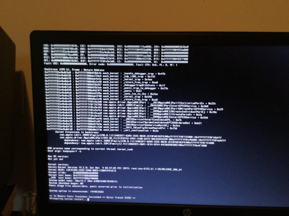

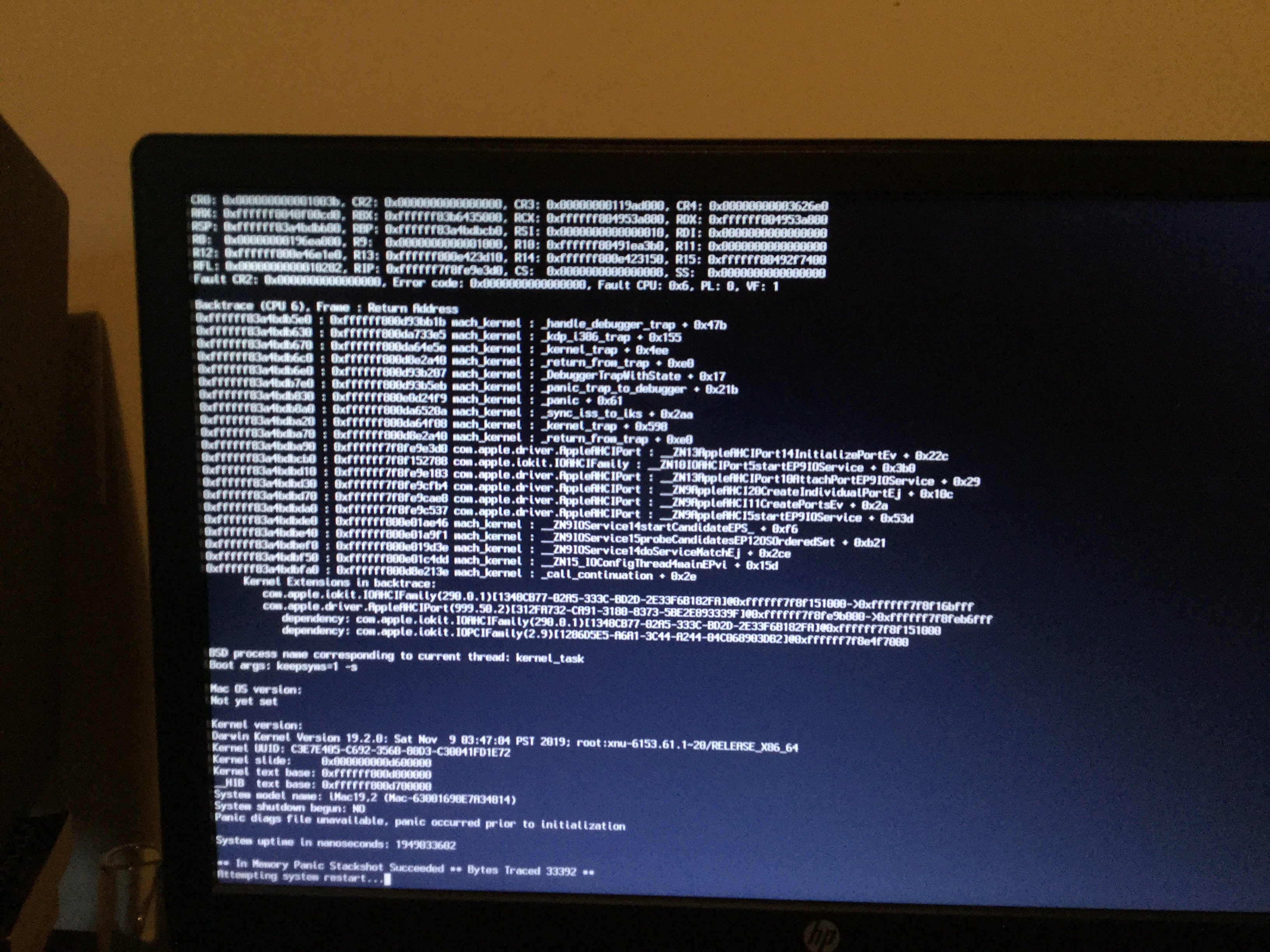

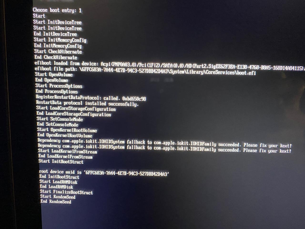

NorthAmTrans Posted December 20, 2019 Share Posted December 20, 2019 I thought I was ready for Catalina 10.15.2 from Mojave 10.14.6 but it seems I didn't read enough. Im sure I've missed something simple. I get to the progress bar then I just reboot. Attached are two screen shots I grabbed with the fast scrolling in -v along with my current EFI. For what its worth I can reset NVRAM and enter Recovery. Im currently reinstalling from here now. One note, even though I've renamed the drive to "Catalina", the OS shows up in Picker as Mojave. Im assuming this is my best lead. Any help is more than welcome. OC EFI 20191207 2.zip Link to comment https://www.insanelymac.com/forum/topic/350754-opencore-general-discussion/page/109/#findComment-2701313 Share on other sites More sharing options...
Erroruser Posted December 20, 2019 Share Posted December 20, 2019 41 minutes ago, NorthAmTrans said: I thought I was ready for Catalina 10.15.2 from Mojave 10.14.6 but it seems I didn't read enough. Im sure I've missed something simple. I get to the progress bar then I just reboot. Attached are two screen shots I grabbed with the fast scrolling in -v along with my current EFI. For what its worth I can reset NVRAM and enter Recovery. Im currently reinstalling from here now. One note, even though I've renamed the drive to "Catalina", the OS shows up in Picker as Mojave. Im assuming this is my best lead. Any help is more than welcome. OC EFI 20191207 2.zip try this but not sure why you have a ACPI/whatever kexts 1 Link to comment https://www.insanelymac.com/forum/topic/350754-opencore-general-discussion/page/109/#findComment-2701321 Share on other sites More sharing options...
NorthAmTrans Posted December 20, 2019 Share Posted December 20, 2019 (edited) 20 minutes ago, errorexists said: OC EFI 20191207 2.zip try this but not sure why you have a ACPI/whatever kexts Still no go. This is a new one for me. I use WEG for my RX580 though it's not completely necessary I guess. Do you not? Hmm any other ideas? EDIT: 00:000 00:000 OCC: No compatible mode for 1900x1600@0 (max: 0) resolution 00:056 00:056 OC: Changed resolution to 1900x1600@0 (max: 0) from 1900x1600 - Not Found 09:384 09:327 OC: Nested ReRun is not supported 09:701 00:317 BS: Failed to start OpenCore image - Already started 09:760 00:058 BS: Failed to load OpenCore from disk - Already started 09:814 00:054 OC: Boot failed - Not Found 09:871 00:057 OCB: StartImage failed - Not Found Edited December 20, 2019 by NorthAmTrans Link to comment https://www.insanelymac.com/forum/topic/350754-opencore-general-discussion/page/109/#findComment-2701322 Share on other sites More sharing options...

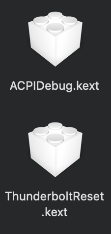

Erroruser Posted December 20, 2019 Share Posted December 20, 2019 12 minutes ago, NorthAmTrans said: Still no go. This is a new one for me. I use WEG for my RX580 though it's not completely necessary I guess. Do you not? Hmm any other ideas? the only thing i can think of you bios is not correct an these 2 kexts in pic an for bios update to current bios (2401) adjustBoot/secure bootos type otherkey management clear secure boot keysAdanced/system agent VT-d disableabove 4g doesnt matterGraphics configuration/ primary Display PCIEPCH storage config / SATA mode selection/AHCI an block out these ssdt 1 Link to comment https://www.insanelymac.com/forum/topic/350754-opencore-general-discussion/page/109/#findComment-2701325 Share on other sites More sharing options...
NorthAmTrans Posted December 20, 2019 Share Posted December 20, 2019 24 minutes ago, errorexists said: the only thing i can think of you bios is not correct an these 2 kexts in pic an for bios update to current bios (2401) adjustBoot/secure bootos type otherkey management clear secure boot keysAdanced/system agent VT-d disableabove 4g doesnt matterGraphics configuration/ primary Display PCIEPCH storage config / SATA mode selection/AHCI an block out these ssdt Bios is updated and I tried slimming down the ACPI patches as well. So strange. I feel like there's one more step to the installation that isn't launching. Link to comment https://www.insanelymac.com/forum/topic/350754-opencore-general-discussion/page/109/#findComment-2701327 Share on other sites More sharing options...
Erroruser Posted December 20, 2019 Share Posted December 20, 2019 9 minutes ago, NorthAmTrans said: Bios is updated and I tried slimming down the ACPI patches as well. So strange. I feel like there's one more step to the installation that isn't launching. you should have a running system before attempting to use opencore an must be functioning first on an established machine Link to comment https://www.insanelymac.com/forum/topic/350754-opencore-general-discussion/page/109/#findComment-2701328 Share on other sites More sharing options...
NorthAmTrans Posted December 20, 2019 Share Posted December 20, 2019 1 minute ago, errorexists said: you should have a running system before attempting to use opencore an must be functioning first on an established machine Sorry I don't think I gave you enough info here. My apologies. This is was a fully functioning Mojave 10.14.6 machine with OC 0.5.4. I started at 0.5.0 and have been following along with each update. I've been waiting on a piece of software to become compatible with Catalina to update and it finally did yesterday. Yay! So in short I've got an established system and working EFI, I'm just for some reason getting caught up here. Also, I receive the same error with Clover. @Pavo, have you come across this? If you don't have time for this then just ignore the tag. Link to comment https://www.insanelymac.com/forum/topic/350754-opencore-general-discussion/page/109/#findComment-2701329 Share on other sites More sharing options...

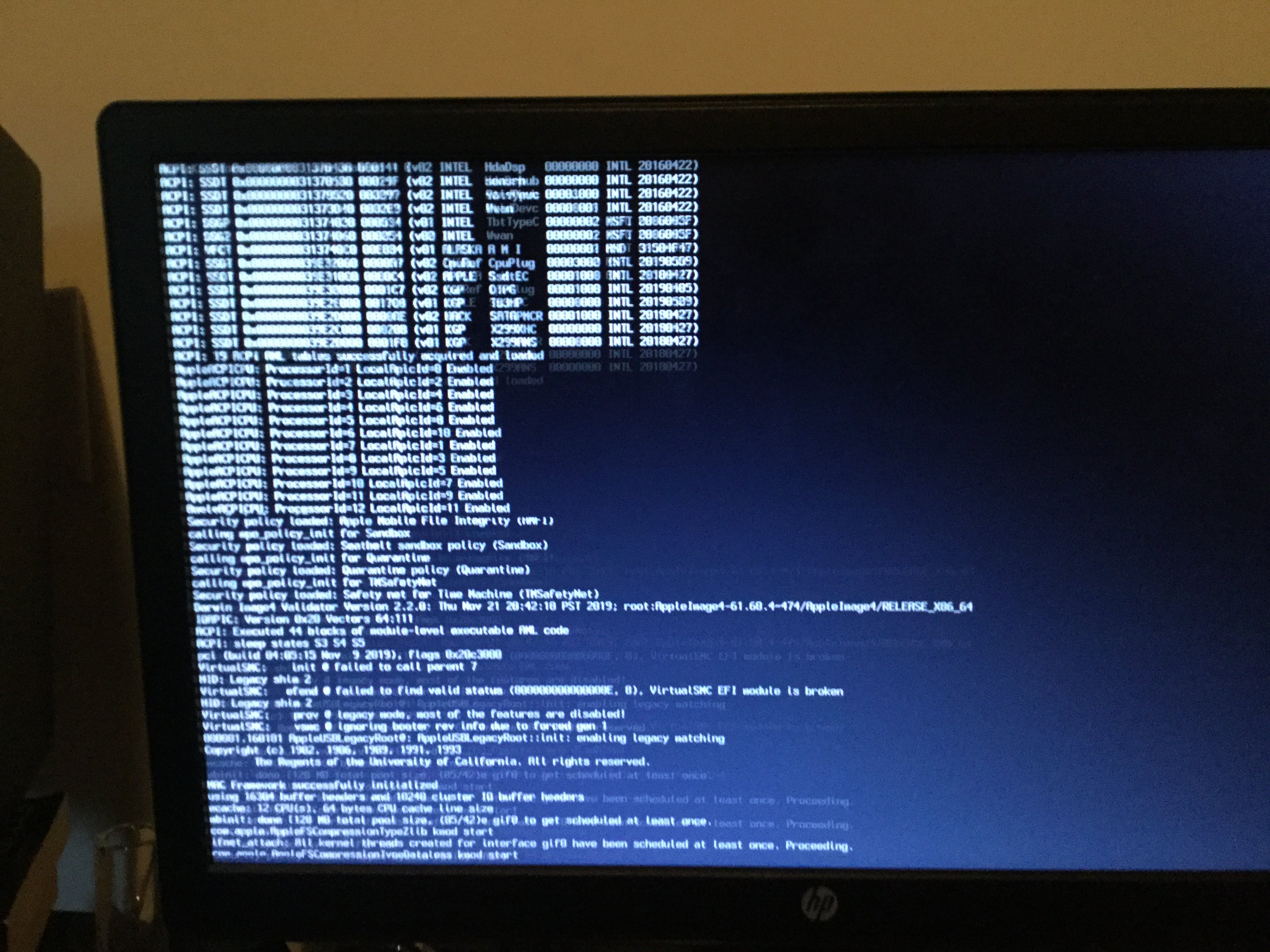

startergo Posted December 21, 2019 Share Posted December 21, 2019 On 12/19/2019 at 4:19 PM, Erroruser said: no one will be able to help you if you do not set your signature to know what your specs are Not sure why was it not visible. So here is the issue. When booted normally and I grep the CPU info everything appears correctly. When I boot through OC the CPU frequency is improperly set in about this mac and grepped.: g5@G5s-Mac-Pro ~ % sysctl -a | grep cpu hw.ncpu: 24 hw.activecpu: 24 hw.physicalcpu: 12 hw.physicalcpu_max: 12 hw.logicalcpu: 24 hw.logicalcpu_max: 24 hw.cputype: 7 hw.cpusubtype: 4 hw.cpu64bit_capable: 1 hw.cpufamily: 1463508716 hw.cpufrequency: 3500000000 hw.cpufrequency_min: 3500000000 hw.cpufrequency_max: 3500000000 hw.cputhreadtype: 1 machdep.cpu.max_basic: 11 machdep.cpu.max_ext: 2147483656 machdep.cpu.vendor: GenuineIntel machdep.cpu.brand_string: Intel(R) Xeon(R) CPU X5690 @ 3.47GHz machdep.cpu.family: 6 machdep.cpu.model: 44 machdep.cpu.extmodel: 2 machdep.cpu.extfamily: 0 machdep.cpu.stepping: 2 machdep.cpu.feature_bits: 188838921972218879 machdep.cpu.extfeature_bits: 5034215680 machdep.cpu.signature: 132802 machdep.cpu.brand: 0 machdep.cpu.features: FPU VME DE PSE TSC MSR PAE MCE CX8 APIC SEP MTRR PGE MCA CMOV PAT PSE36 CLFSH DS ACPI MMX FXSR SSE SSE2 SS HTT TM PBE SSE3 PCLMULQDQ DTES64 MON DSCPL VMX SMX EST TM2 SSSE3 CX16 TPR PDCM SSE4.1 SSE4.2 POPCNT AES PCID machdep.cpu.extfeatures: SYSCALL XD 1GBPAGE EM64T LAHF RDTSCP TSCI machdep.cpu.logical_per_package: 32 machdep.cpu.cores_per_package: 16 machdep.cpu.microcode_version: 0 machdep.cpu.processor_flag: 0 machdep.cpu.mwait.linesize_min: 64 machdep.cpu.mwait.linesize_max: 64 machdep.cpu.mwait.extensions: 3 machdep.cpu.mwait.sub_Cstates: 4384 machdep.cpu.thermal.sensor: 1 machdep.cpu.thermal.dynamic_acceleration: 1 machdep.cpu.thermal.invariant_APIC_timer: 1 machdep.cpu.thermal.thresholds: 2 machdep.cpu.thermal.ACNT_MCNT: 1 machdep.cpu.thermal.core_power_limits: 0 machdep.cpu.thermal.fine_grain_clock_mod: 0 machdep.cpu.thermal.package_thermal_intr: 0 machdep.cpu.thermal.hardware_feedback: 0 machdep.cpu.thermal.energy_policy: 0 machdep.cpu.arch_perf.version: 3 machdep.cpu.arch_perf.number: 4 machdep.cpu.arch_perf.width: 48 machdep.cpu.arch_perf.events_number: 7 machdep.cpu.arch_perf.events: 4 machdep.cpu.arch_perf.fixed_number: 3 machdep.cpu.arch_perf.fixed_width: 48 machdep.cpu.cache.linesize: 64 machdep.cpu.cache.L2_associativity: 8 machdep.cpu.cache.size: 256 machdep.cpu.tlb.inst.small: 64 machdep.cpu.tlb.inst.large: 7 machdep.cpu.tlb.data.small: 64 machdep.cpu.tlb.data.large: 32 machdep.cpu.tlb.shared: 512 machdep.cpu.address_bits.physical: 40 machdep.cpu.address_bits.virtual: 48 machdep.cpu.core_count: 6 machdep.cpu.thread_count: 12 machdep.cpu.tsc_ccc.numerator: 0 machdep.cpu.tsc_ccc.denominator: 0 machdep.xcpm.cpu_thermal_level: 0 As you can see the CPU frequency is hw.cpufrequency: 3500000000 hw.cpufrequency_min: 3500000000 Yet it is read properly from OCCPU at boot: 00:000 00:000 OC: OpenCore is now loading (Vault: 0/0, Sign 0/0)... 00:060 00:060 OC: Boot timestamp - 2019.12.19 20:42:34 00:129 00:069 OCCPU: Hypervisor: 0 00:188 00:058 OCCPU: Found Intel(R) Xeon(R) CPU X5690 @ 3.47GHz 00:251 00:062 OCCPU: Signature 206C2 Stepping 2 Model 2C Family 6 Type 0 ExtModel 2 ExtFamily 0 00:310 00:059 OCCPU: Detected Apple Processor Type: 05 -> 0501 00:368 00:058 OCCPU: Ratio Min 12 Max 26 Current 0 Turbo 28 28 27 27 00:428 00:059 OCCPU: Timer address is 408 from LPC 00:587 00:159 OCCPU: CPUFrequencyFromTSC 3457998909Hz 3457MHz 00:645 00:057 OCCPU: CPUFrequency 3457998909Hz 3457MHz 00:704 00:059 OCCPU: FSBFrequency 132999958Hz 132MHz 00:763 00:058 OCCPU: Pkg 1 Cores 6 Threads 12 Also the microcode version is 0 instead of 31. Link to comment https://www.insanelymac.com/forum/topic/350754-opencore-general-discussion/page/109/#findComment-2701337 Share on other sites More sharing options...
NorthAmTrans Posted December 21, 2019 Share Posted December 21, 2019 4 hours ago, NorthAmTrans said: Sorry I don't think I gave you enough info here. My apologies. This is was a fully functioning Mojave 10.14.6 machine with OC 0.5.4. I started at 0.5.0 and have been following along with each update. I've been waiting on a piece of software to become compatible with Catalina to update and it finally did yesterday. Yay! So in short I've got an established system and working EFI, I'm just for some reason getting caught up here. Also, I receive the same error with Clover. @Pavo, have you come across this? If you don't have time for this then just ignore the tag. Update: I disabled SATA in my bios and everything is fine. Likely due to my rename of SAT0 to SATA. @Erroruser when you sent me back an adjusted config, why did you enable Legacy Schema? Link to comment https://www.insanelymac.com/forum/topic/350754-opencore-general-discussion/page/109/#findComment-2701338 Share on other sites More sharing options...
