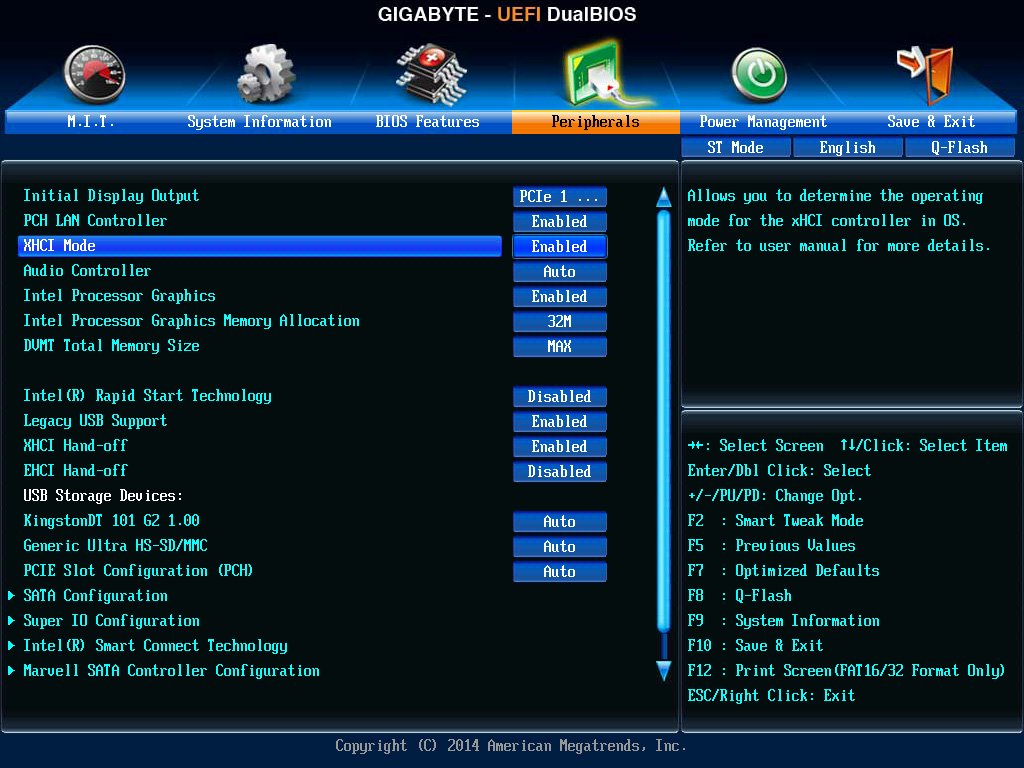

Hi, I just realized we have same motherboard, Z87-UD4H
Do you mind share your "EFI" file? I can change Serial number, UUID by myself.
my system still not stable especially YouTube audio choppy after sleep.

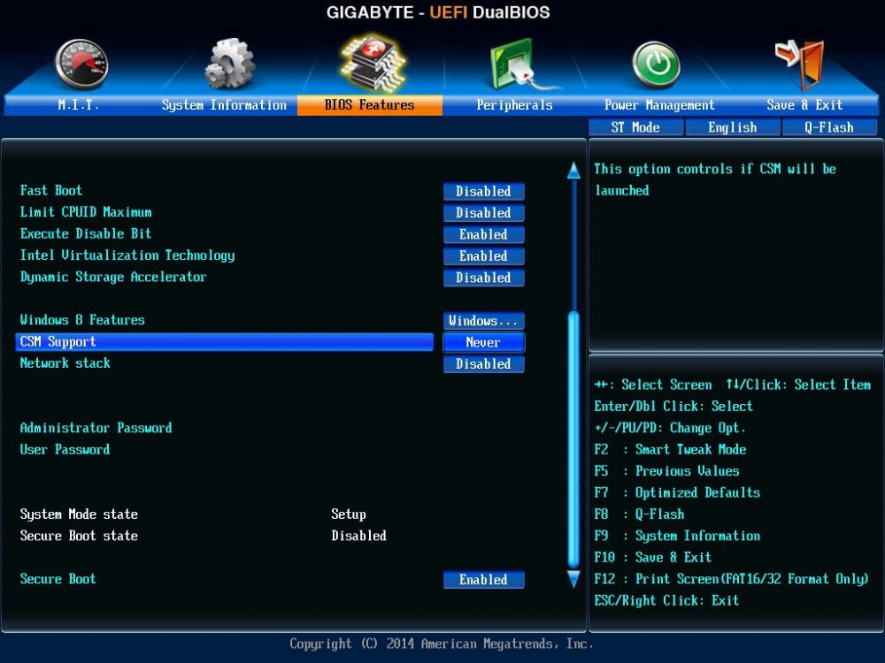

For BIOS setting, I pretty much follow the OpenCore guide, but it didn't mention the following
"XHCI Mode" - I have "XHCI Hand-off" Enabled, don't know what's the difference.
"Secure Boot"
"Super IO Configuration"
"Intel Processor Graphic" - I have RX580, so this is Enabled.
"Intel Processor Graphics Memory Allocation"
"DVMT Total Memory Size"
Thank you, if you can share your set up and file would be awesome.
