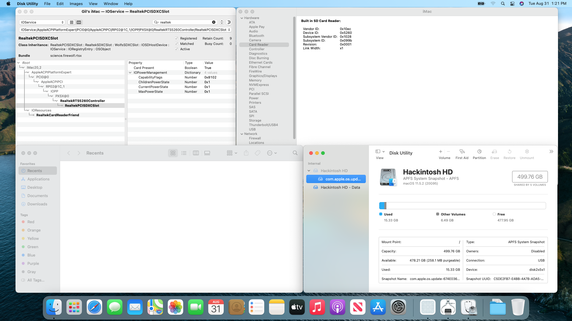

Thanks for adding support for the RTS5260!
The driver is not fully working for me yet, but it seems that it’s almost ready.
It seems to detect my card reader, but is unable to mount a card in Finder/Disk Utility.
On a good note, it looks like your driver knows when a card is connected/disconnected which is a great sign!
(please see attached screenshot/boot log with a card inserted)
Boot Log for RTS5260.txt

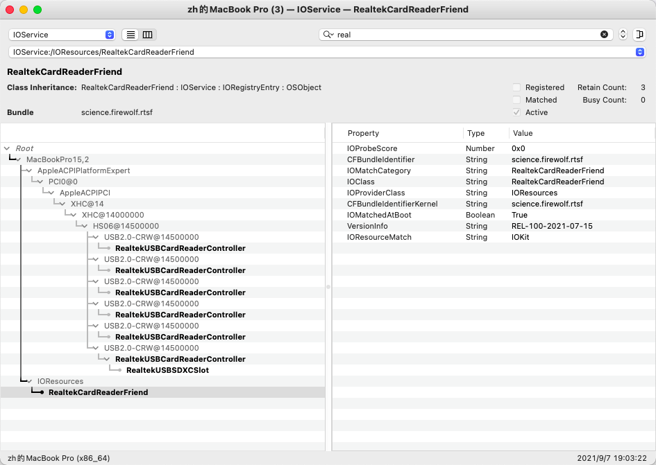

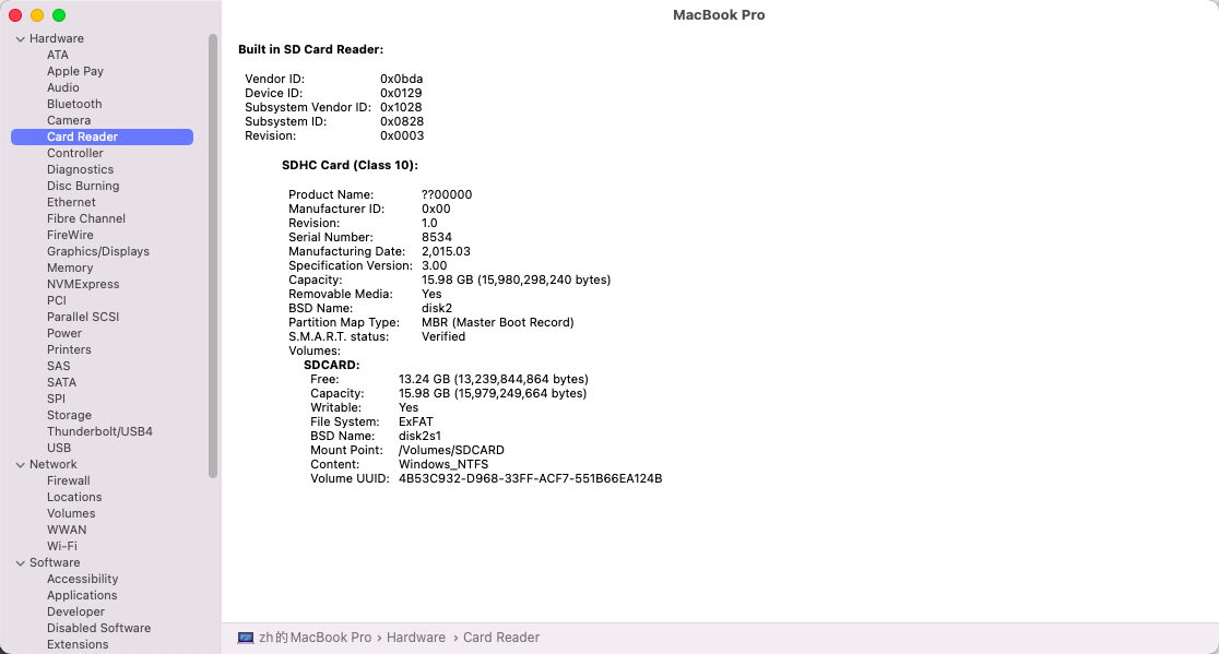

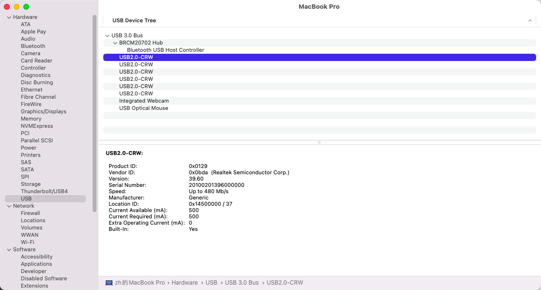

This issue has been solved in the latest version 0.9.7, you can download and try.
RealtekCardReader_0.9.7_f4eca02_RELEASE.zip

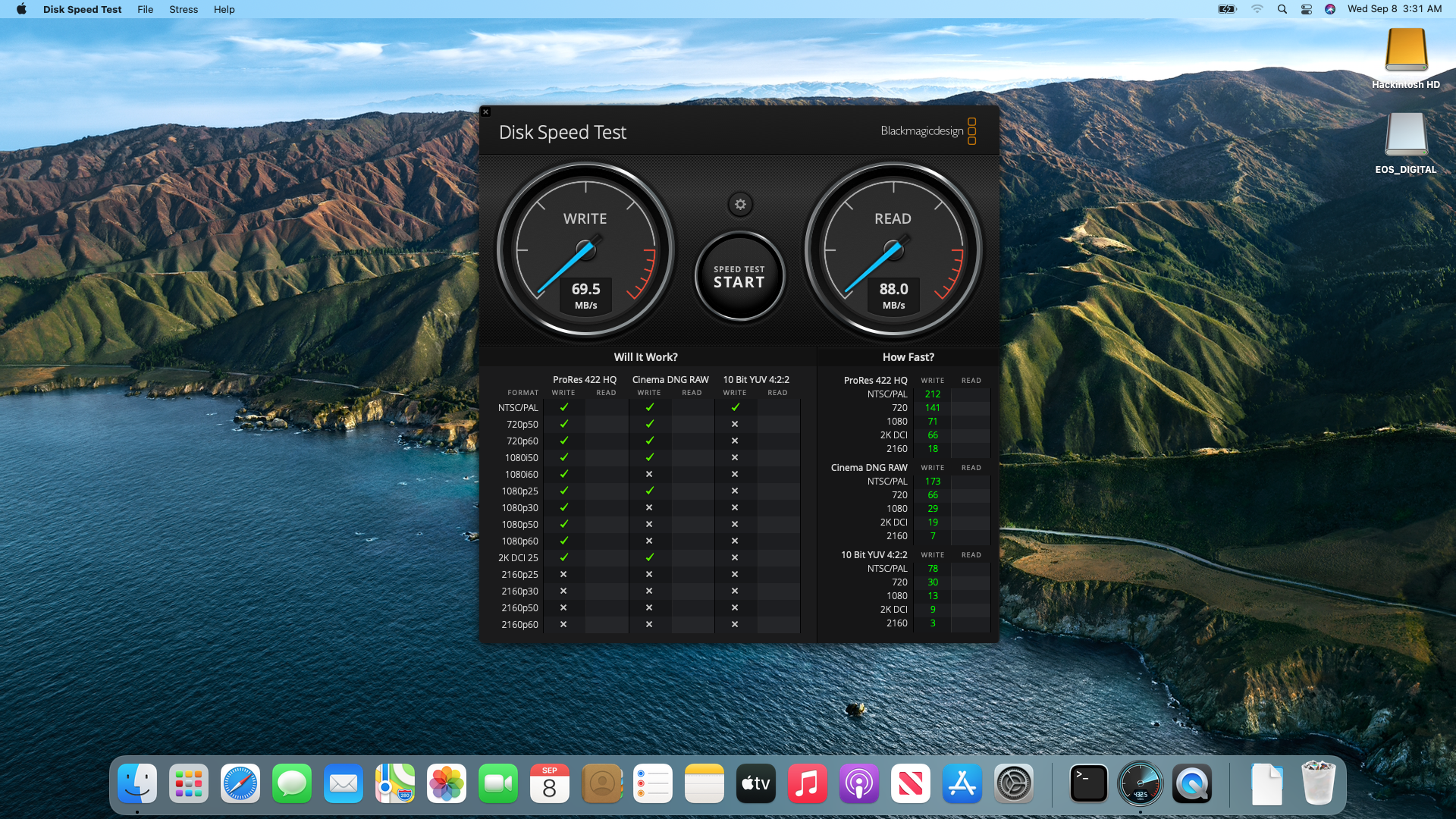

No, it doesn't work, the issue exists still. I tried debug version of that same kext in last post and as you said to try release version I tried it and same again, no change. Keep the sdcard inserted while waking from sleep and try it, going to sleep is not the issue.
41 minutes ago, gnpaone said:
what card reader you have?
My machine is DELL 7472, please see the screenshot below for details. Everything works fine now, including the SD card still being loaded automatically after waking up from sleep with the SD card inserted.
46 minutes ago, gnpaone said:
No, not working, sorry, what card reader you have?
also not working too.

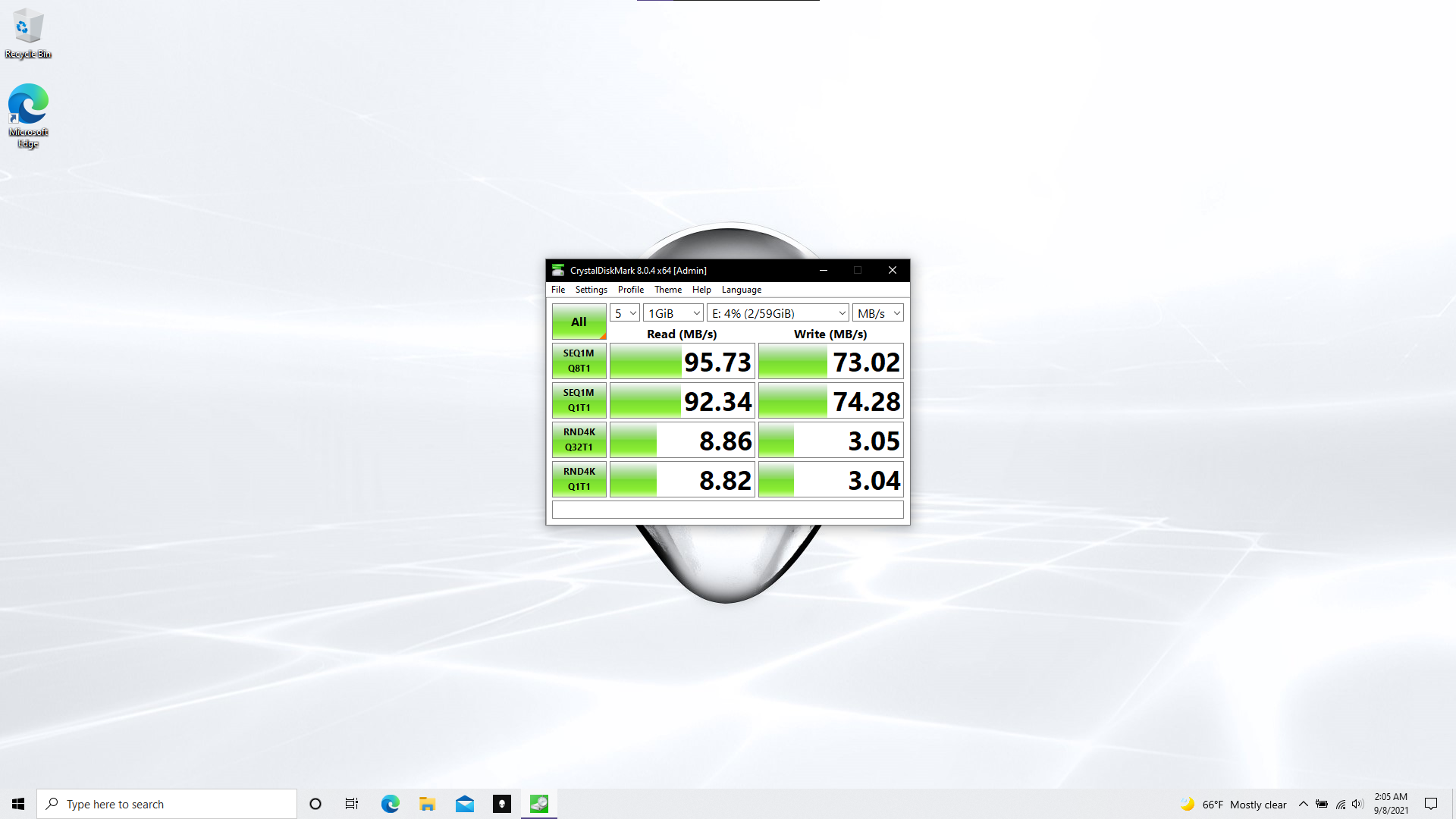

Adding `-iosd3v3` seemed to do the trick! My SD is now being mounted.
There’s just one problem though… The read/write speeds of my SD card are incredibly slow compared to Windows.
I’ve attached another kernel log with an SD card inserted and -iosd3v3` added.
rtsx-5260 Slow Read:Write.log
Aside from that, the driver seems to be very stable! Thank you so much for taking the time to write this driver!
If it helps, the only SD card that I have is this one, but I’m happy to buy any others in the future that you’d recommend for testing:

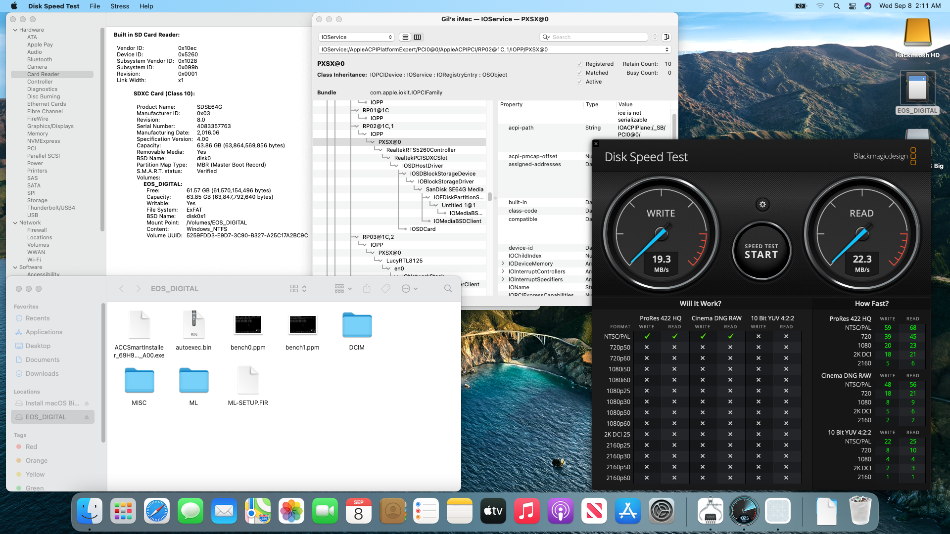

There’s just one problem though… The read/write speeds are incredibly slow compared to Windows.

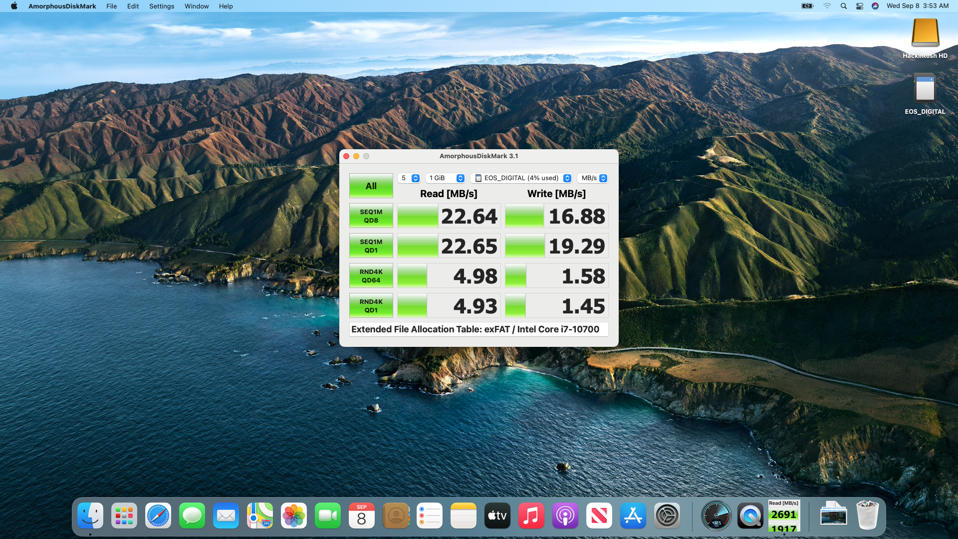

@Fortitude Well, the benchmarking method of CrystalDisk is different compared to BlackMagic Disk benchmark, so please try CrystalDisk available for mac
AmorphousDiskMark.app.zip
Edited by gnpaone
Here's my results of AmorphousDiskMark when my SD card is inserted into the internal card reader:
And here's my results when attaching my SD card to a USB adapter and running the Blackmagic Disk benchmark again:
853845013_BlackmagicDIskTestSD-USBAdapter.thumb.png.f3ad6c4f30f360fe3c04c611d8dbc13c.png
Read/Write speeds are much slower than they should be in the internal card reader.
Edited by Fortitude
19 minutes ago, Fortitude said:
I attached my SD card to a USB adapter and ran the Blackmagic Disk benchmark again.
No not like that, I mean use the app provided by me earlier to test in Mac, just for apples to apples comparison as windows results were posted by you already. I gave the same app. Blackmagic speed test is a bit complicated, for example your first and second pictures show different levels of the test so definitely the speed indication is different for different levels and the test order is not standard.

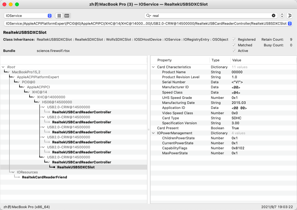

@Austere.J I did test the kext provided by you. There are pretty interesting results this time.
Scenario 1:
Everything went well and Mac behaved normally. Nothing unusual. So here it works fine.
Scenario 2:
Here's where the twist occurs. I did tests two times (well the reason is only to gather IOReg dumps with and without sdcard inserted during force reboot after kernel panic as you asked in the last). This time the kernel log is very different compared to kernel logs provided by all of us in earlier posts.
As commented by @Sherlocks in the last comment (well I am online when he is posting 😉), I got the black screen similar to him (screenshot is uploaded) but not even once it woke from sleep with sdcard inserted (both tests - first is putting my Mac to sleep without shutting down my Mac after Scenario 1 (it's the same case as said by @Sherlocks where he told his Mac woke from sleep with sdcard inserted), second is formally shutting down my Mac after Scenario 1 and following the steps mentioned in Scenario 2).
