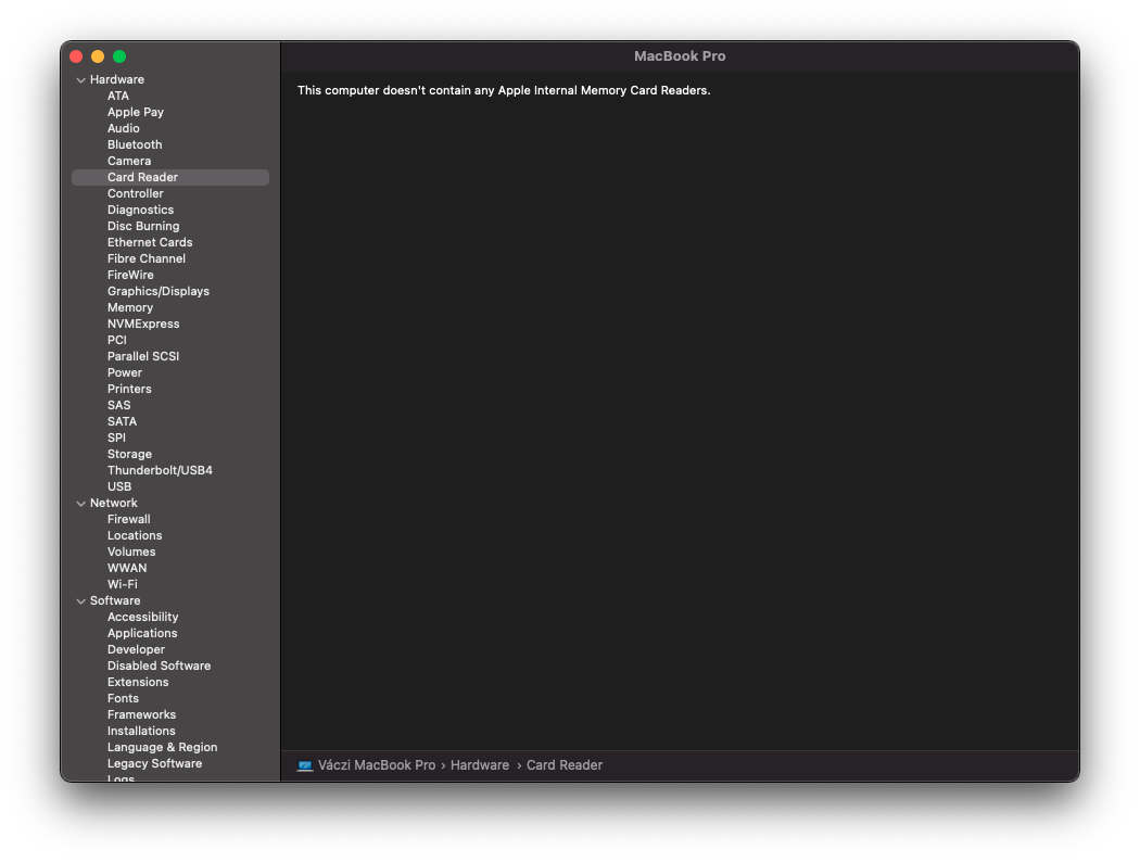

Hi everyone,
just a small feedback: my RTS522A seems fully working using opencore 0.7.2 on BS 11.5 on my HP 450 G5.
I wrote "seems" because I did not test any speed but after just plugging in an SDXC card it was mounted immediately.
And, of course, card reader tab on system profiler is natively populated.
Thanks to @Austere.J and @Hervé for this huge work.

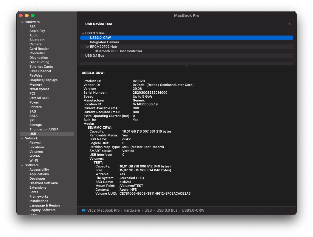

Feedback on USB3.0-CRW: It's working good, the only issue is that after sleep, the card is ejecting and re-mounting. Well, that's not a problem for me tho, I'm pretty happy with this.
The reader won't show up in System Info -> Card Reader, only as an USB device (I think that's the normal behaviour)
Otherwise, no issue with the card or the card reader.

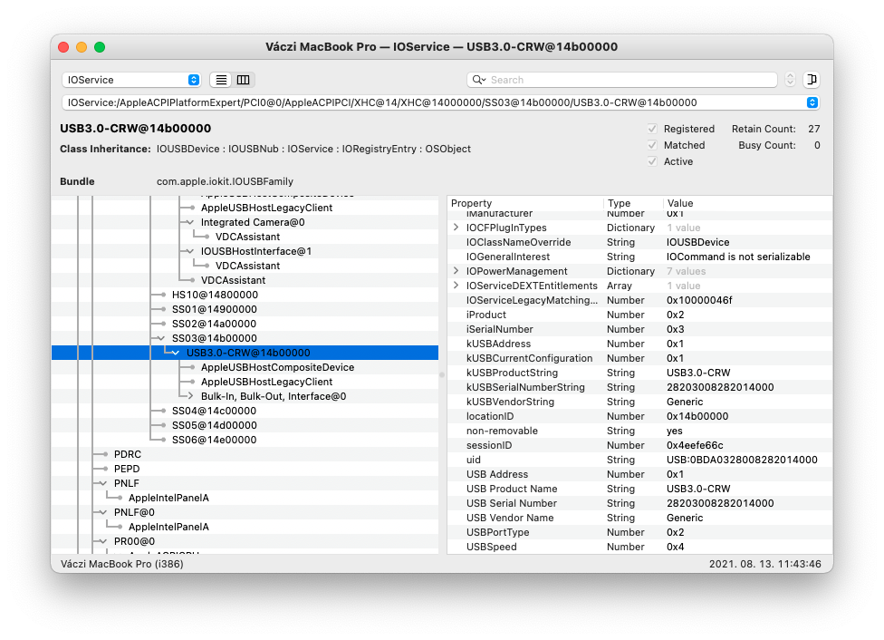

IOReg:

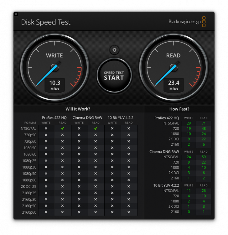

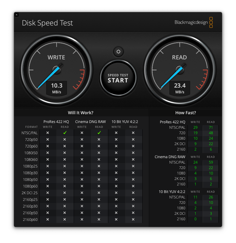

The speed is slow, but It's not an issue, this particular card is pretty slow.
EDIT: But I had a high-speed one too, I didn't measure the speed of that, but it was pretty quick when I burned a debian iso to that.
The card won't show up in System Info -> Card Reader, only as an USB device (I think that's the normal behaviour)
Otherwise, no issue with the card.

IOReg:

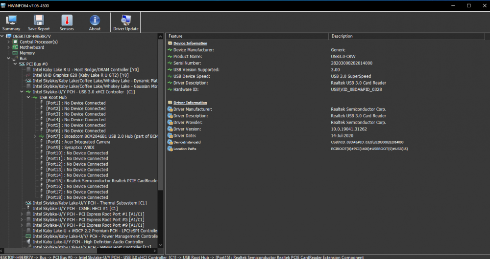

HWInfo64:
  Hide contents
System: Lenovo X1 Carbon 6th - Big Sur 11.5.2
Thanks for your hard work!
