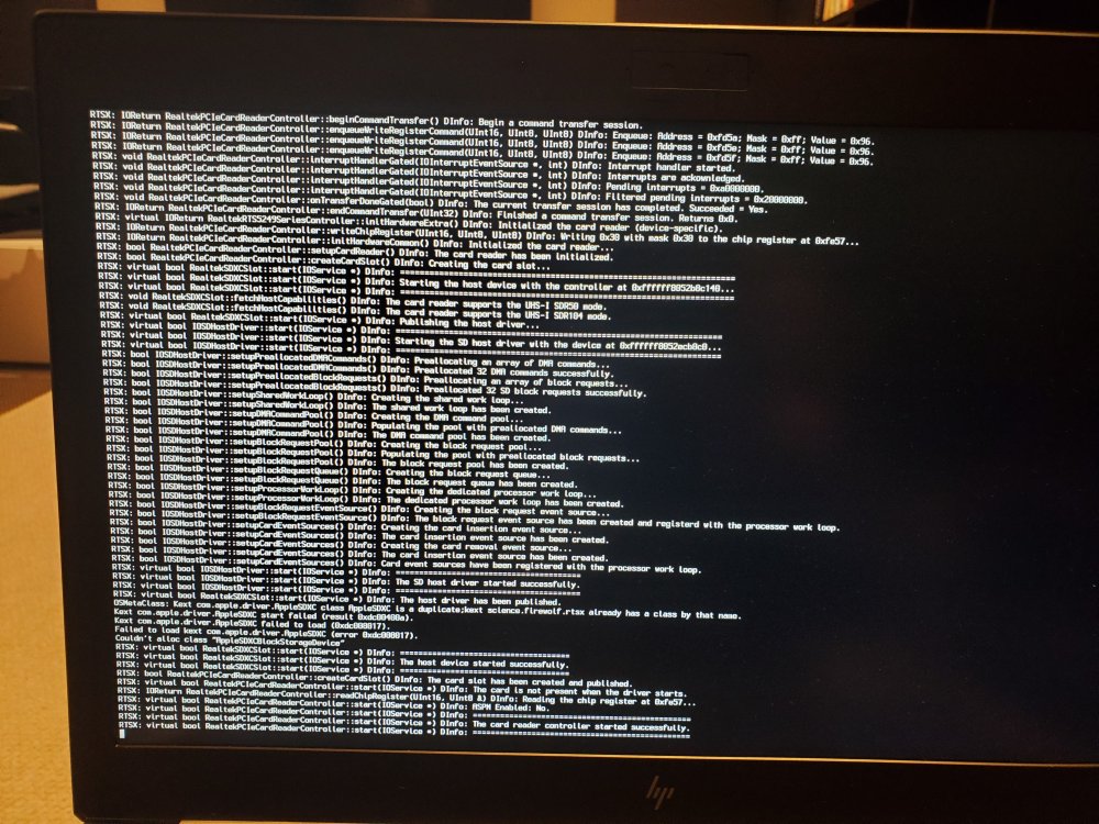

Systematic instantaneous/immediate KP 1s after initiating boot when injecting or caching this kext (whether Debug or Release version) in Big Sur 11.4 (Clover r5133) on my Skylake Dell Latitude E7270 laptop fitted with PCie Realtek RTS525a:
No log produced... 😪
Had to revert to Cholonam's sinetek-rtsx kext.
I hate my plist editor. It changed the value type of IOProbeScore from interger to real.
That's why you saw the serialization error.
v0.9.1 should fix the issue and is working fine on my machine.
Please give a try. Thank you.

Hi, thank you for your work on this kext, however it's not working and when loaded I experience a KP.
No bootlog is generated
Device is RTS525a
HP Zbook G5
I also wonder if it would be possible to make it compatible with Mojave

When loaded directly:
Edited by theroadw
more info
@theroadw
1) Add the boot argument `keepsyms=1` so that you can see which function triggers the kernel panic.
2) Remove the SD card while your system is booting.
3) Use your bootloader to inject the kernel extension.
4) Once your system boots, insert your card and check whether the same kernel panic occurs.
If so, please attach the full kernel panic report as well as your kernel log.
It is hard to see the log and debug the issue by watching the recording.
Note that I don't have macOS Mojave installed on my machine, so I have not checked the compatibility and tested the driver yet.
Edited by Austere.J
