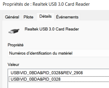

lazzy Posted March 13, 2022 Share Posted March 13, 2022 Hello, Can you support VID_0BDA&PID_0328 please I will attach ioreg latter Link to comment https://www.insanelymac.com/forum/topic/348130-realtek-pcieusb-sd-card-reader-driver-for-macos/page/7/#findComment-2778181 Share on other sites More sharing options...
