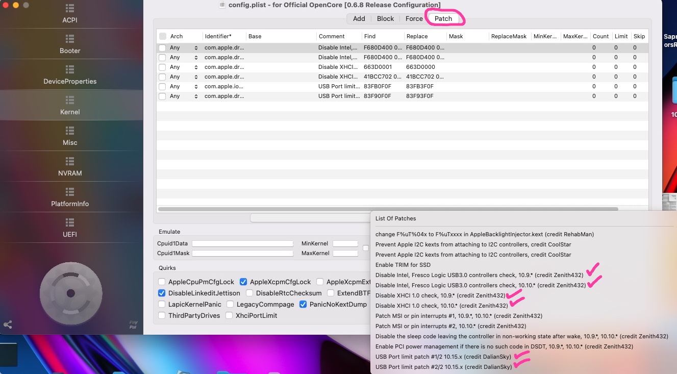

2 hours ago, XanthraX said:
After the upgrade, I lost the USB 3.0 connections on the i3 based Hackintosh in my signature. Using Using OpenCore 0.6.8.
I resolved this and I post it for whose encounter the same problem. First I downloaded the last version of USBInjectAll.kext and XHCI-unsupported.kext as the advice of MladOn:
After this, only the USB 3.0 devices were seen, but not the USB 2.0 devices.
Then I unchecked the XhciPortLimit in Kernel -> Quirks, because some of my back panel USB ports were not recognised
Then I applied the patched in the picture. I don't know which of them makes the trick, but it works now. I hope it helps.

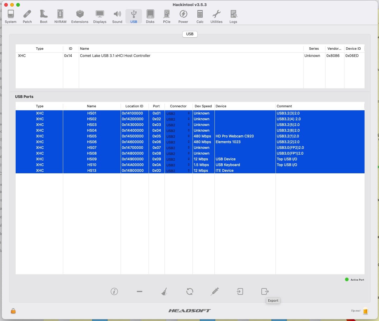

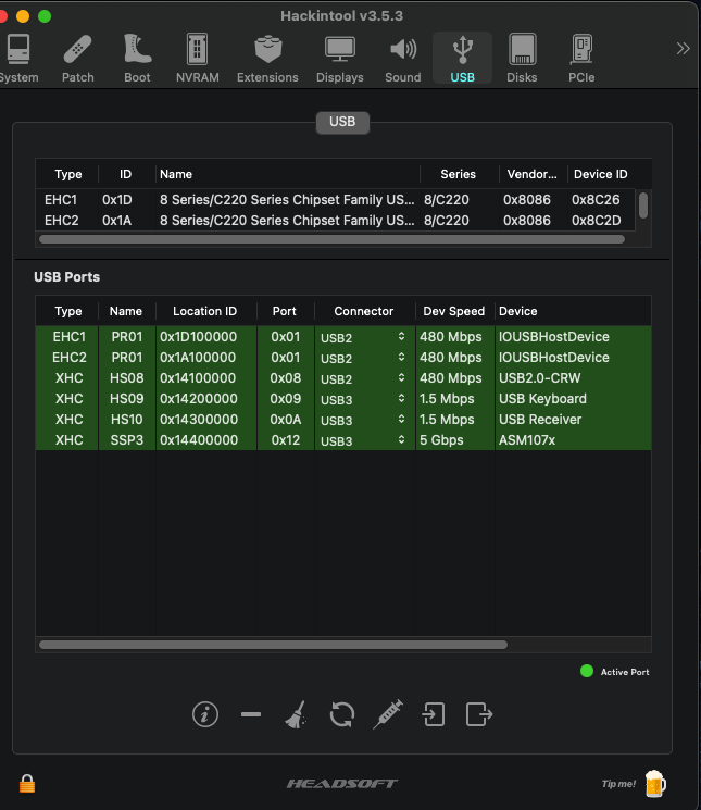

After updating I lost the USB, all of them, I had to go to my test disk of big sur 11.2.3, update Hackintool to the latest version, do the mapping of my USB again and change the EFI 0.6.8 of the disk, that's how it worked all over again.
only those marked in green after placing a usb stick 2 and 3 in all ports
you export results and put the resulting ssdt and kext in your EFI
You must map your USB ports either though SSDT or though the plist-only kext, and disable XhciPortLimit
https://dortania.github.io/OpenCore-Post-Install/usb/intel-mapping/intel.html
  • Like 3
I agree
USBInjectall is not the right way ; USBPort.kext is so much easier and correct .
@XanthraX remap your USB ports as a kext and forget about it forever
