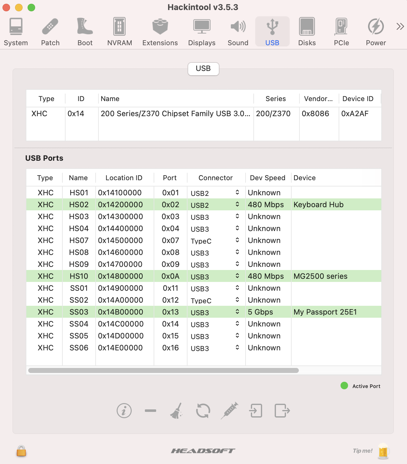

duffs Posted April 29, 2021 Share Posted April 29, 2021 I had problems with USB on AsRock mobo z270 to. Quick AsRock z270 guide. The board has SSDT called SSDT-3-xh_rvp08.aml which I had to disable in OC and load fixed one SSDT-3USB.amlwith disabled ports that I don't use. 8 ports what is in total 14 ports. 2x usb2 and 6x usb3 with usb2 support. OC Delete apci table <key>Delete</key> <array> <dict> <key>All</key> <false/> <key>Comment</key> <string>xh_rvp08</string> <key>Enabled</key> <true/> <key>OemTableId</key> <data>eGhfcnZwMDg=</data> <key>TableLength</key> <integer>0</integer> <key>TableSignature</key> <data>U1NEVA==</data> </dict> </array> Link to comment https://www.insanelymac.com/forum/topic/347547-release-macos-big-sur-113/page/2/#findComment-2756855 Share on other sites More sharing options...

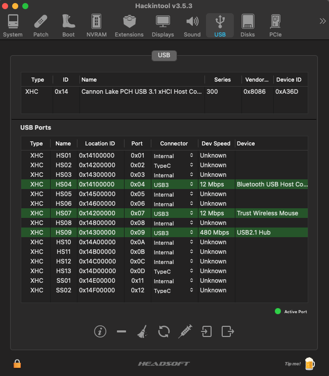

MorenoAv Posted May 2, 2021 Share Posted May 2, 2021 Hi all, Finally today I was able to update from 11.2.3 to 11.3 without loosing bluetooth and all ports work after making a USBMap.kext with corpnewt USBMap... Thanks to all that made suggestions and to all that had the same problems, losing ports and various problems with this update. Thank you all... 2 Link to comment https://www.insanelymac.com/forum/topic/347547-release-macos-big-sur-113/page/2/#findComment-2756996 Share on other sites More sharing options...

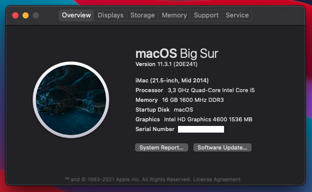

moozuki Posted May 4, 2021 Share Posted May 4, 2021 (edited) Smooth update. Spoiler Edited May 4, 2021 by moozuki spoiler Link to comment https://www.insanelymac.com/forum/topic/347547-release-macos-big-sur-113/page/2/#findComment-2757101 Share on other sites More sharing options...
