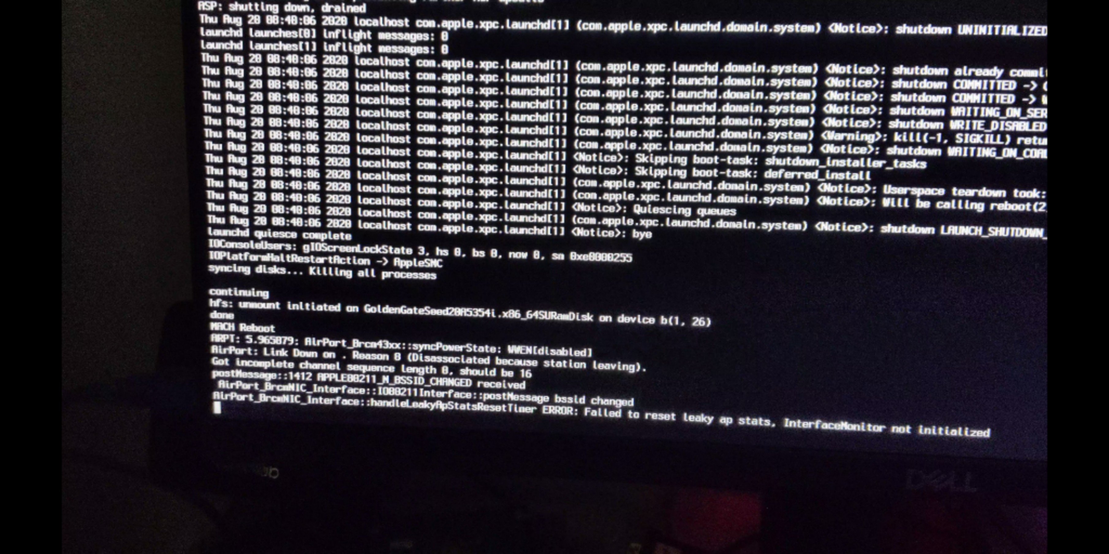

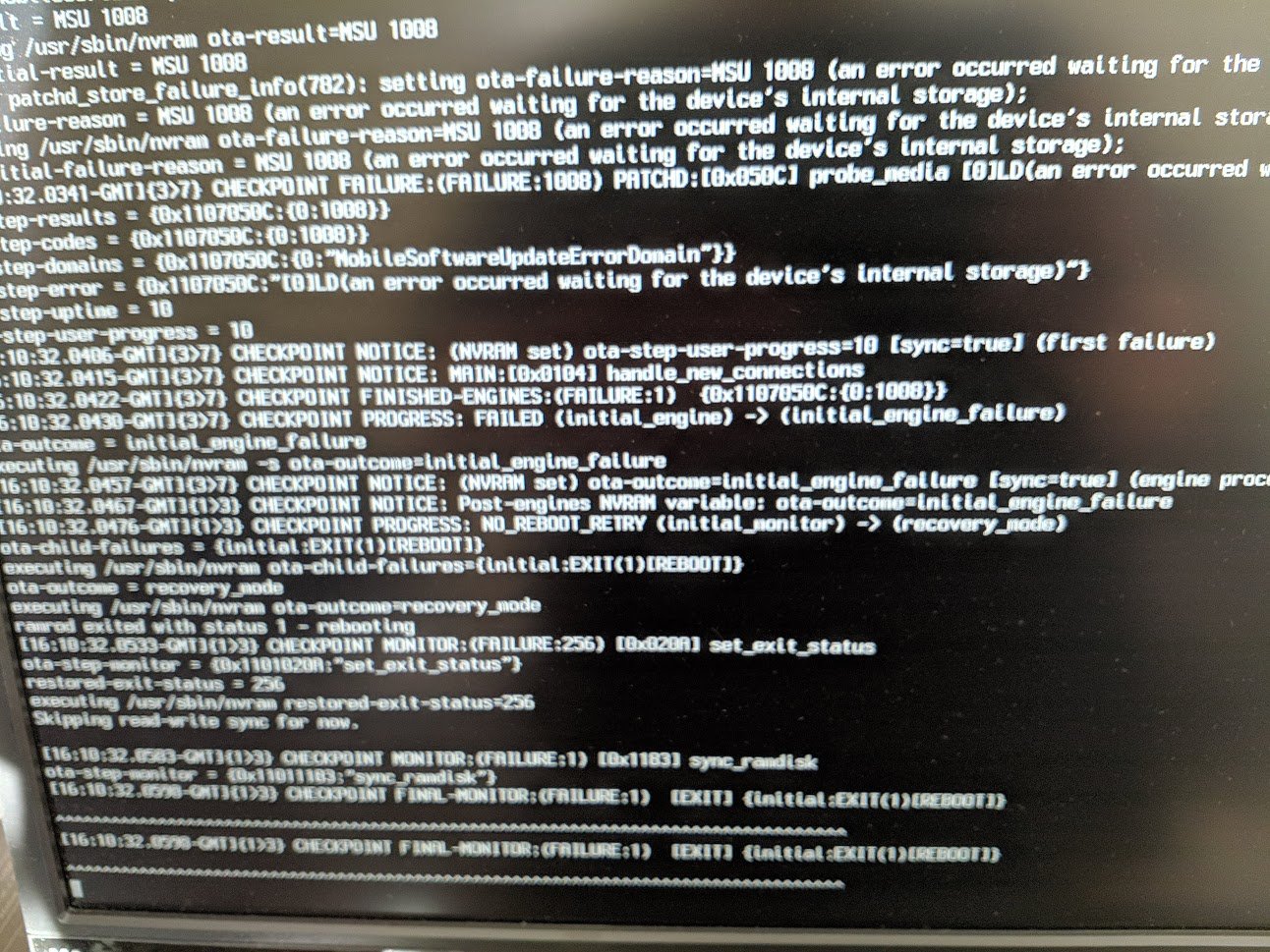

Hi All users
I can't finish to update Beta 4 to Beta 5. Big Sur reboot loop on macOS Installer stage. This time, I use @fusion71au method copy/past Instal Big Sur Beta.app in Application and run it.
Opencore 0.6.1 latest, Lilu and Kexts latest commits, vsmcgen=1 as boot-args
Please if somebody know why ! Below the only photo I can take before reboot loop.
Beta 4 boot normally

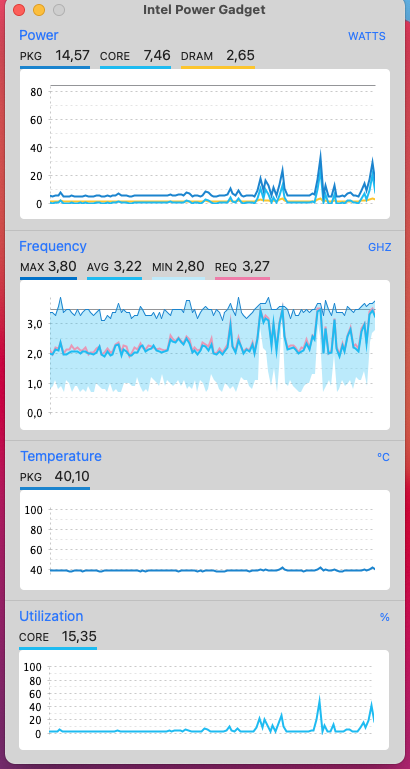

Hi guys. I' ve two questions (problems).
1) After several... so many tries I maybe finally get to work PM, I bought a device that measures consumption of the whole system. I follow the guide on dorthania site and create my own ssdts (with my "luck" my system was one of the special cases because the EC has the _STA method, windows can recognize the path of the EC... and other things). I put them in ACPI folder and reboot. Pc working fine, I have better temp and lower freq than before. The whole system (i5 4690, PSU 550w, 2x8 RAM, RX580, wifi card apple with adapter, 3 ssd, 1 hdd, 4 ultra low fan and other usb dongles) in idle take 48w and 60-65 when doing some tasks like internet browsing or watch a full hd movie on TV+. Geekbench score are in average.
But, it is my question. in IOREG I can't see "plugin-type" on CPU0. I suspect that something don't work properly.
I post a screen of intel power gadget when the cpu was in idle for the most time.
1094102434_Schermata2020-08-20alle19_14_19.thumb.png.1bb2276c124fabd274dabf3606e00a61.png
2) I can't install Big Sur Beta 5 update. I update OpenCore to 0.6.1 and than launch the update. My system reboot right after the progress bar and the apple logo appears.

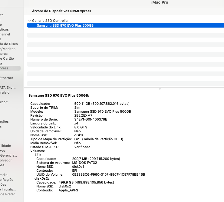

2 hours ago, Common_Sense said:
I noticed in Big Sur beta 5 that trim on my SSDs is no longer supported even though it was in beta 4, running "sudo trimforce enable" in the terminal does not help even though the command always worked before.
Anyone else have noticed this?
I am using regular Samsung sata SSDs and intel Z87 chipset. I do get generic sata in system profiler but it was like that in beta 4 as well and it seems to be only cosmetic as the capabilities of the SATA controller seems to be correctly reported.
Works since im run "sudo trimforce enable" command in Catalina. Im not need re-enable again...all my machines with hack.

1 hour ago, Matgen84 said:
Hi All users
Seems like you install Beta 4 twice, so try delete all Snapshot first, re-enable SIP (im think its not necessary) and try again without others HDs/SSds with another systems. Use only one EFi. Good Luck. ;)
My bad, it seems what trimforce does is to add a NVRAM variable called EnableTRIM and I did clear my NVRAM after that so it disappeared.
Thanks for checking :)
