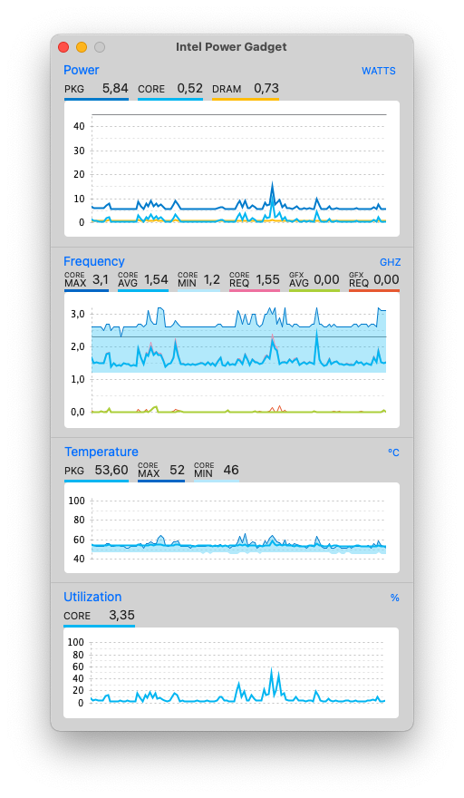

Yep! As Sherlocks says not averaging below 2.0ghz. :no:
sorry for my bad english.
average 2.0ghz or over.
now, seems many laptop user have this problem.
i did think only my problem before i mentioned it here.

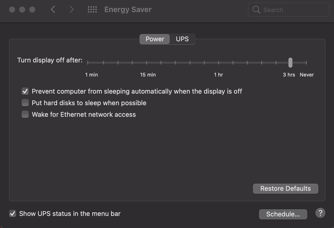

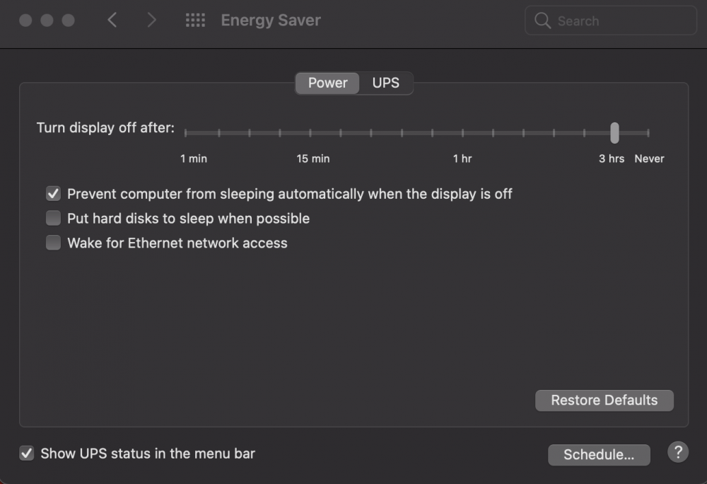

18 hours ago, Ellybz said:
The differences posted on energy saver are related to the Power management of your CPU. ( Depending if you're using the SSDT-PLUG recommended by the OC Devs or not )
In the EFI for my X299, I do not use SSDTs.  XCPM is managed thru the bios.
Therefore, as @BALDY_MAN I have less options but everything works perfectly.
I don't have the "Automatic restart after power failure" because I have a UPS :hysterical:
In short, the differences or less options in your system preferences might be related to your Bios &/or SSDT-PLUG.

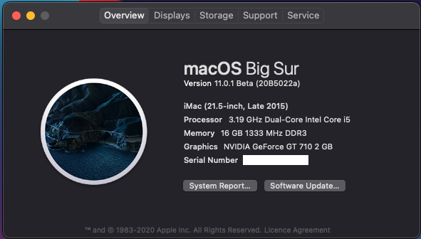

Big Sur 11.0.1 Beta (20B5022a)
771449071_ScreenShot2020-11-06at12_26_24PM.thumb.png.ffe4fe6854e6e50dba246e7247b08f1f.png

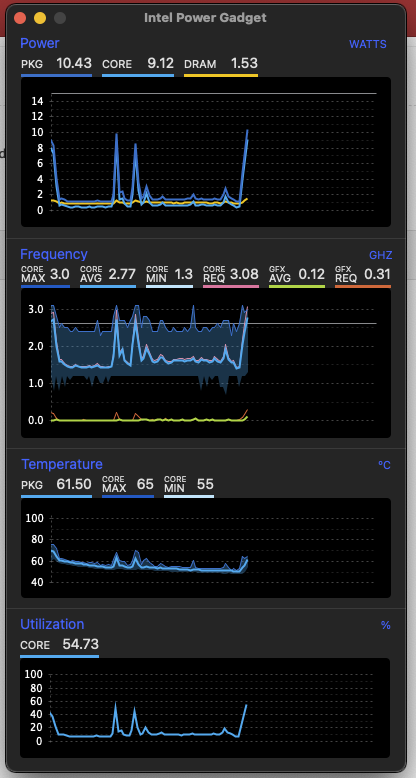

i have same issue too

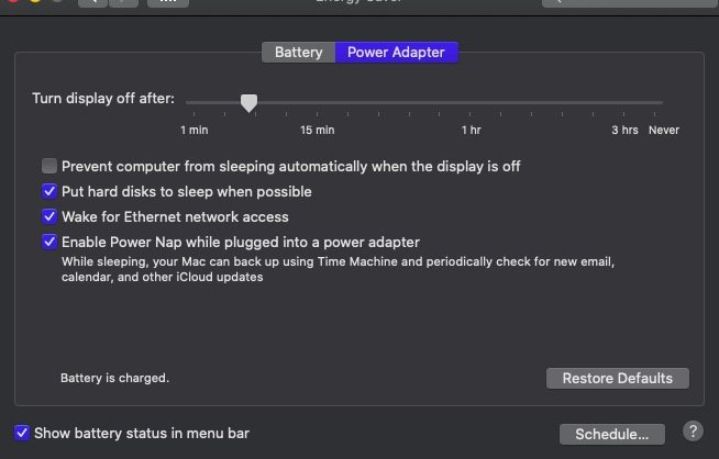

Catalina shows 5 boxes under Energy
but Big Sur shows like this
97797193_ScreenShot2020-11-07at5_55_40PM.jpg.e02b442682be53a1fdb682efc8a39b82.jpg1379013639_ScreenShot2020-09-23at4_46_42AM.jpg.608db8442dfac07fd19172a8450be12a.jpg
in my laptop, no drop low frequency...
Because it always maintains a high frequency
My laptop is vulnerable to throttling.
This problem is currently degrading the overall performance of my laptop.
I am worried that this problem has not been solved in RC.
I clean installed the RC version today, but the symptoms continued to appear.
I even disabled CPUFriend kext, but the same symptom.

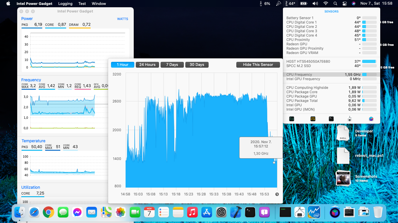

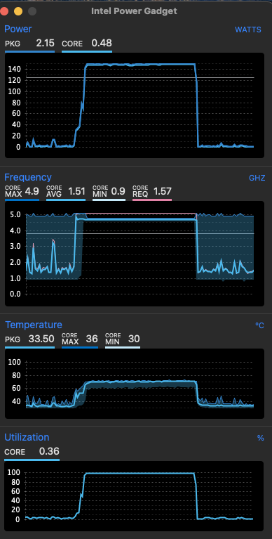

16 minutes ago, eSaF said:
@kushwavez - Let us know if the average drops any lower than the average that is shown in the pic. So far your result doesn't look too bad.
Here, I closed all applications, opened Power Gadget and iStat Menus. It goes down for 1.3 Ghz in idle, that's the floor set by Mac-A5C67F76ED83108C.plist so it's normal, and turboing up to ~2.8 GHz when doing some demanding work.
Spoiler
2326830_Screenshot2020-11-07at15_58_29.thumb.png.a3e98072b6139a4b7c277872f7274865.png
EDIT: HWP enabled, PluginType=1
Edited by kushwavez

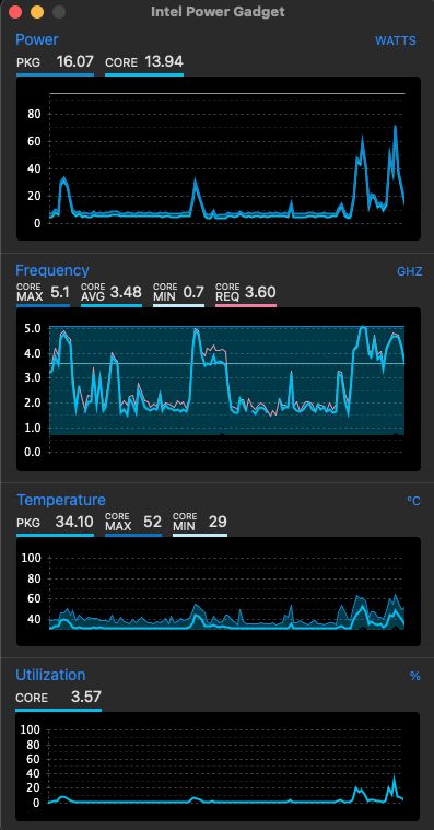

  Reveal hidden contents
I have the same result as you do.
Min 1.3ghz in idle and turboing up too 5.1ghz.
Seems as it should be to me while using SMbios iMacPro1,1 with a 9900k :thumbsup_anim:

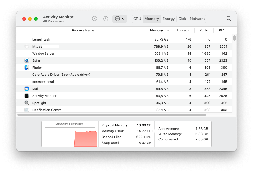

@eSaF yep. I still experiencing a lots of minor visual bugs, and several major bugs with Safari.
  1. Opening new tabs with Sidebar opened is reeeally slow.
  2. Safari still can't show my opened tabs/window after system restart, just if I click on it, and a new empty window will open as well, really annoying
  3. Streaming an 1080p (HEVC 10-bit FLAC) video in Safari on some sites are eating up my whole 16 GB RAM, even more, then system became unresponsive because of that. I mean look at this RAM usage..... ~36 GB?? how is that even possible???
2021767143_Screenshot2020-11-07at16_57.03copy.png.abb8bed3208c0041cfec7b3b047ed81b.png
I really hope apple will fix these issues.
Edited by kushwavez

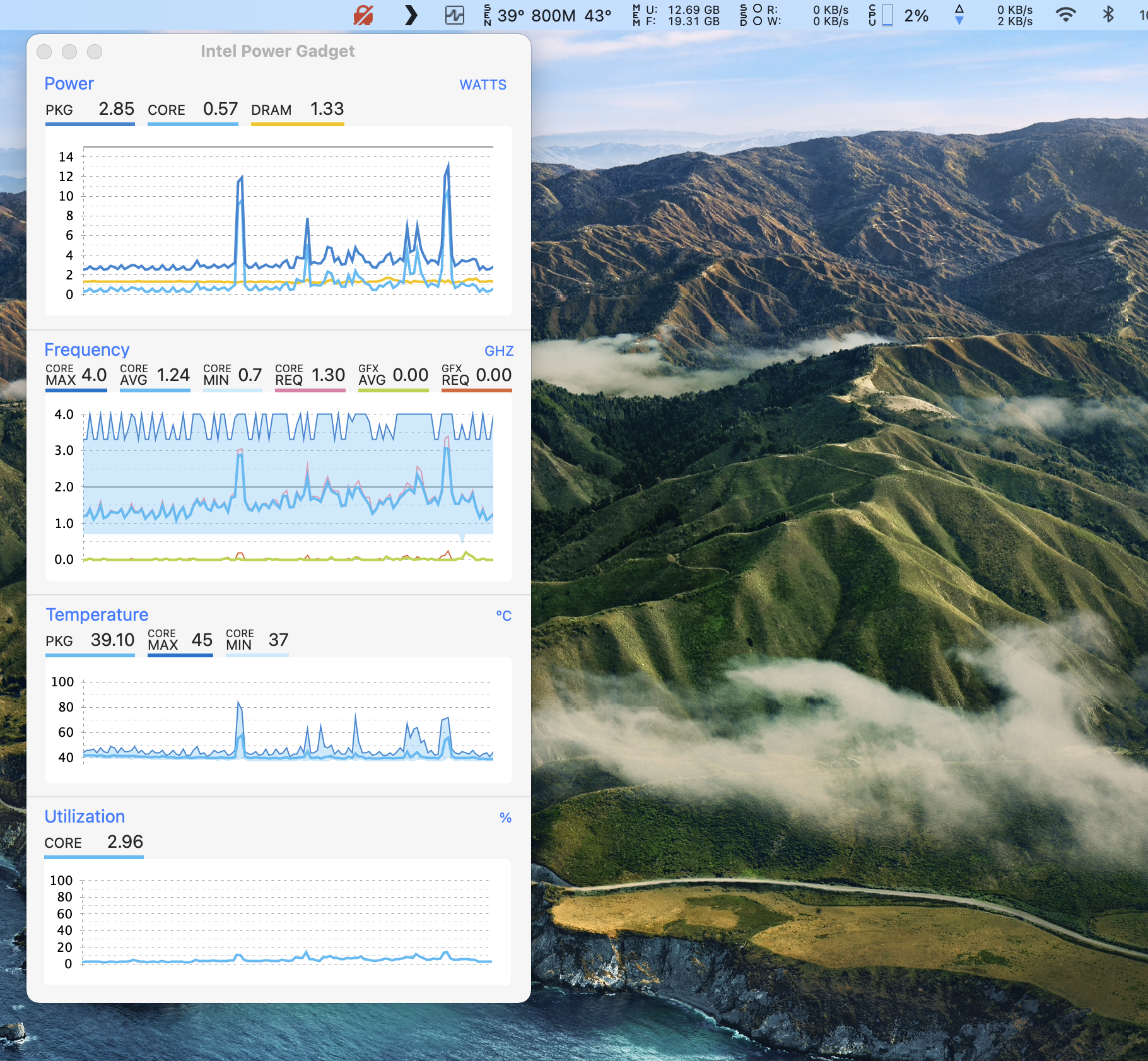

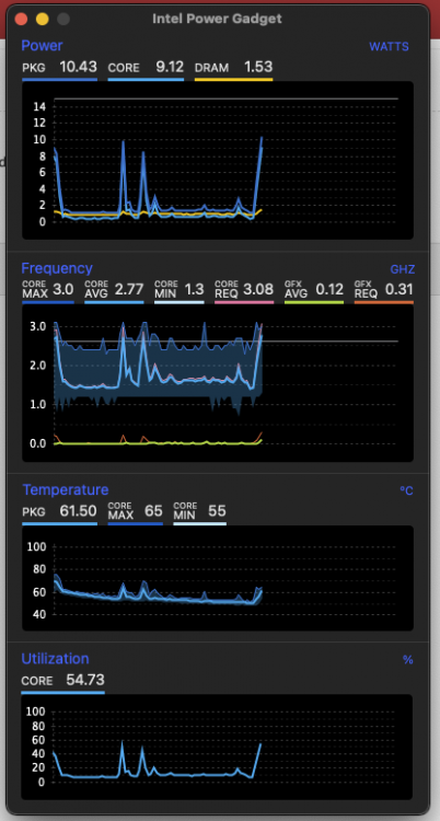

I'm getting proper speed-stepping on my laptop.  I use CPU Friend and selected a board ID that will allow me to go down to 700 MHz.

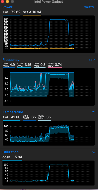

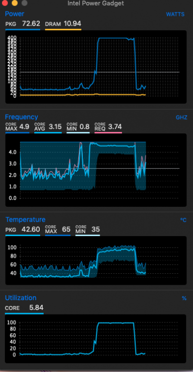

@BALDY_MAN Same here (  without SSDT-PLUG ). Just a 400w peak consumption after running Cinebench :hysterical:
All 18 cores @4.9Ghz
CPU Stepping ok
93881149_ScreenShot2020-11-07at12_26_24.thumb.png.3d61b8dedfb33fc1076249fb7af652d4.png
Edited by Ellybz

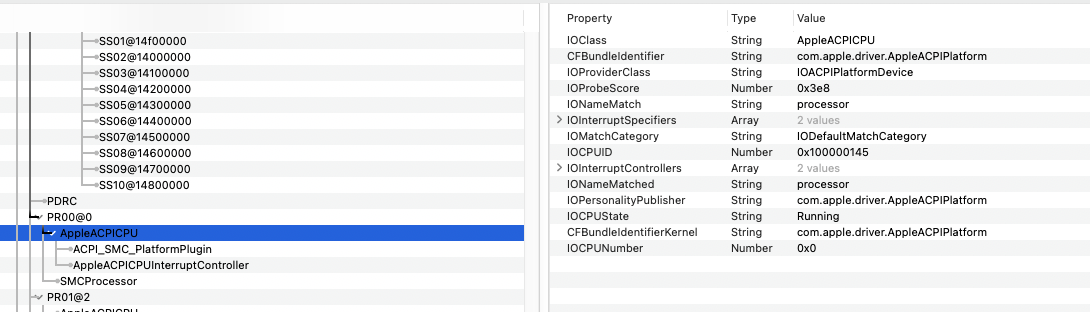

11 hours ago, BALDY_MAN said:
@Tiem is this ok
1952230836_Screenshot2020-11-07at08_48_32.thumb.png.c0646ee09ef306ade67bd8152a53efe4.png
Doubtful, the X86PlatformPlugin needs to be loaded.
Probably over my pay grade but the guide needs to be rewritten. It specifies that X86PlatformPlugin needs to be attached (this is correct) but then later makes reference to AppleACPICPU needing to be attached, which may be there even tho XCPM module isn't functioning properly.
I'm still trying to suss out whether machdep.xcpm.mode can return an on state (1) despite XCPM not working correctly.
Probably best to reach out to Pikera's docs on all this stuff (no he's not coming back) as he's done a boatload of work on this dating well back to 10.8. But you can't just rip out an SSDT unless you really know what you're doing. And unless it's conflicting with Windows, you probably shouldn't just because some guy said to. Just saying.

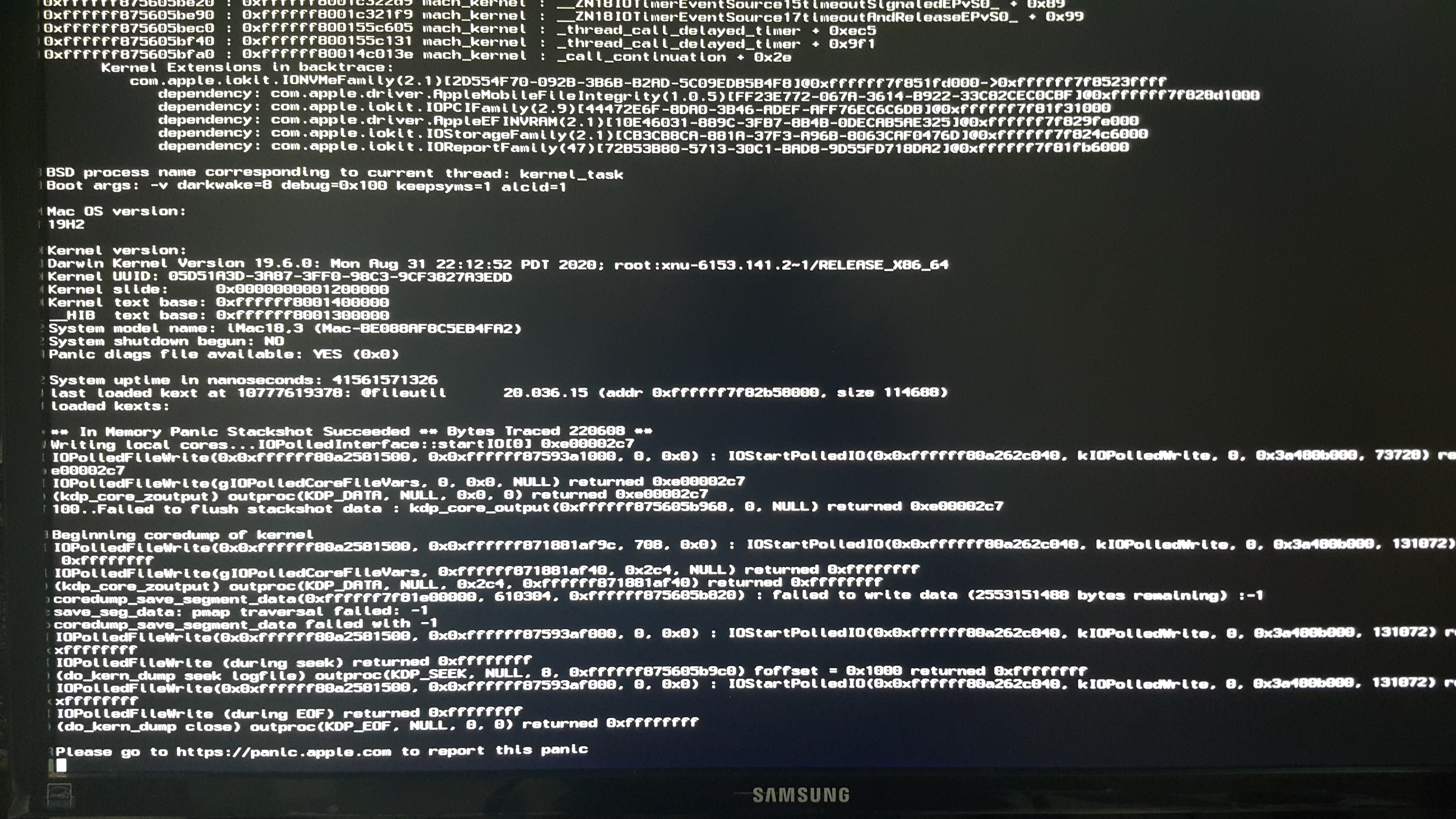

Hello Everyone -
I have a system with 3 m.2 drives
1. Windows
2. macOS Catalina
3. macOS BigSur (Public Beta)
I recently replaced my Windows M.2 nVme drive (SK Hynix P31 Gold 1 TB) and after that I am unable to boot either of my mac Os's. I get the following KP. Anyone has any clues on how to get past this?
I am using the latest OC version. Unable to get to the EFI right now.
Edited by manmo71
  • Sad 1
the word impossible seems out of place, a little more difficult, but feasible:
you can mount efi from windows with bootice or minitool partition wizard free access it with total commander or explorer started as an admin and with a plist editor type propertree or plistedplus add and define for example nvmefix.kext
  • Like 3
Thanks for the tip! PlistEDPlus looks really promising I'd go that. Also I did have some strange problems with Total Commander (sometimes it just messed up my Clover) so I would go with Explorer++ (admin mode of course)

12 hours ago, manmo71 said:
Hello Everyone -
1. Windows
2. macOS Catalina
are you try NVMeFix.kext ? Just a suggestion
