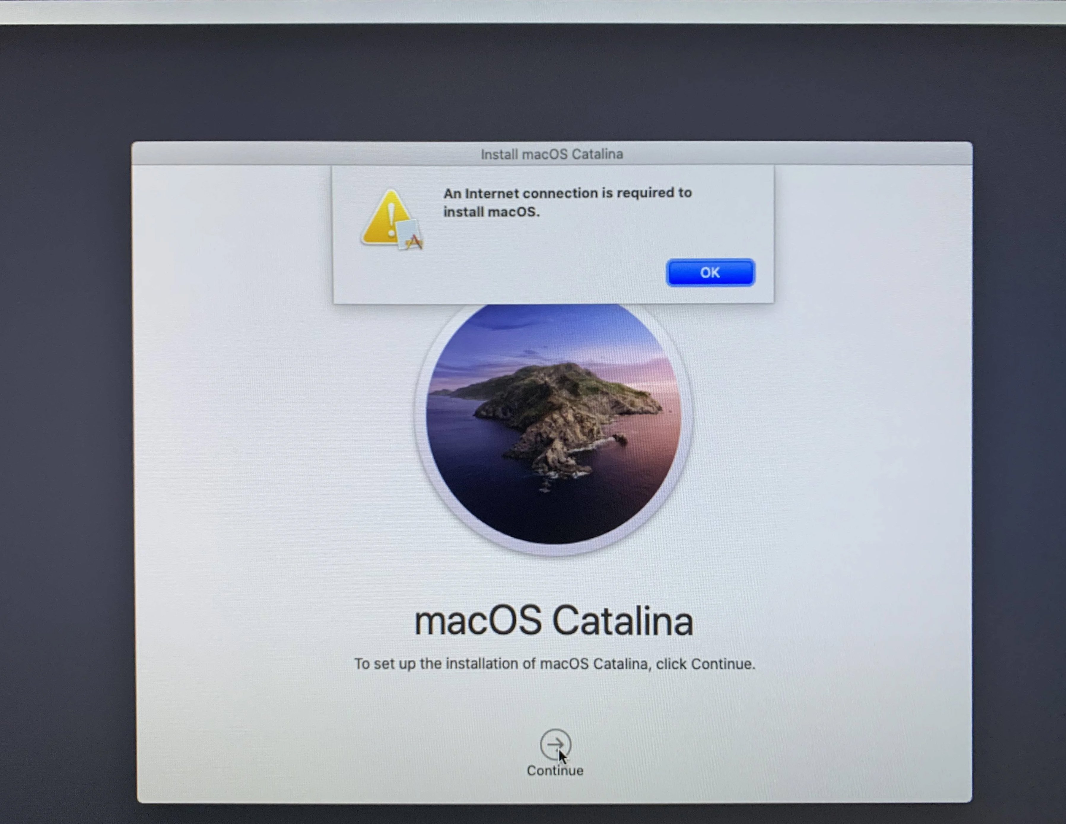

MacLover1984 Posted September 19, 2020 Share Posted September 19, 2020 (edited) An internet connection is required to install MacOS Catalina; 3700X, RX 5500XT, MSI x570 tomahawk wifi with Realtek® 8125B 2.5G LAN controller I have the same issue. I am installing MacOS Catalina by OpenCore version 0.6.1 with following configuration: · Ryzen 7 3700X, · Sapphire Nitro RX 5500XT, · MSI x570 tomahawk wifi with Realtek® 8125B 2.5G LAN controller I have gathered all required files and doable with LucyRTL8125Ethernet.kext[V1.0.0d6] according to installation guide. But when I am going to install Catalina, a message “An internet connection is required to install MacOS” is showing. Please guide me to resolve the issue. config.plist Info.plist Edited September 19, 2020 by MacLover1984 1 1 Link to comment https://www.insanelymac.com/forum/topic/343542-lucyrtl8125ethernetkext-for-realtek-rtl8125/page/4/#findComment-2737729 Share on other sites More sharing options...
vuongdingo Posted September 20, 2020 Share Posted September 20, 2020 (edited) On 9/19/2020 at 1:11 PM, MacLover1984 said: An internet connection is required to install MacOS Catalina; 3700X, RX 5500XT, MSI x570 tomahawk wifi with Realtek® 8125B 2.5G LAN controller I have the same issue. I am installing MacOS Catalina by OpenCore version 0.6.1 with following configuration: · Ryzen 7 3700X, · Sapphire Nitro RX 5500XT, · MSI x570 tomahawk wifi with Realtek® 8125B 2.5G LAN controller I have gathered all required files and doable with LucyRTL8125Ethernet.kext[V1.0.0d6] according to installation guide. But when I am going to install Catalina, a message “An internet connection is required to install MacOS” is showing. Please guide me to resolve the issue. config.plist Info.plist on open terminal ``` ifconfig -m ``` and try change media your system support: example: ```ifconfig en0 media 100baseTX mediaopt half-duplex``` Edited September 20, 2020 by vuongdingo Link to comment https://www.insanelymac.com/forum/topic/343542-lucyrtl8125ethernetkext-for-realtek-rtl8125/page/4/#findComment-2737863 Share on other sites More sharing options...

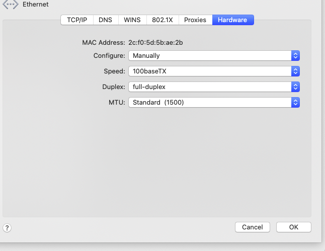

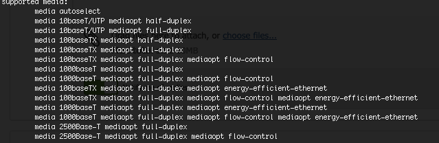

vuongdingo Posted September 20, 2020 Share Posted September 20, 2020 (edited) On 9/19/2020 at 3:37 AM, Mieze said: Well, in this case the problem is located somewhere else. Please fix your system! Mieze If I chose Network -> Advanced -> hardware and set 100baseT, Ethernet will work. If I chose another doesn;t work. How can I using 1000base or 2500base? my pc: MSI Z490 Gaming Plus / Core i3 10100 / 16GB RAM / macOS 10.15.6 Edited September 20, 2020 by vuongdingo Link to comment https://www.insanelymac.com/forum/topic/343542-lucyrtl8125ethernetkext-for-realtek-rtl8125/page/4/#findComment-2737879 Share on other sites More sharing options...
Mieze Posted September 20, 2020 Author Share Posted September 20, 2020 @vuongdingo It might be a firmware issue, hardware incompatibility, a bad cable or maybe just dust on the connectors but it's definitely not my fault. As I already said, please fix your system! Mieze 1 1 Link to comment https://www.insanelymac.com/forum/topic/343542-lucyrtl8125ethernetkext-for-realtek-rtl8125/page/4/#findComment-2737883 Share on other sites More sharing options...
MacLover1984 Posted September 21, 2020 Share Posted September 21, 2020 On 9/20/2020 at 4:00 PM, vuongdingo said: on open terminal ``` ifconfig -m ``` and try change media your system support: example: ```ifconfig en0 media 100baseTX mediaopt half-duplex``` It works for me on ifconfig en0 media 100baseTX. thank you very much. but after installation i got no sound though the sound preference shows [internal speaker, line out etc.]. it tried all option but it does not work. i also tried all layoutid in AppleALC for ALC1200A. can you fever again. Link to comment https://www.insanelymac.com/forum/topic/343542-lucyrtl8125ethernetkext-for-realtek-rtl8125/page/4/#findComment-2737983 Share on other sites More sharing options...
