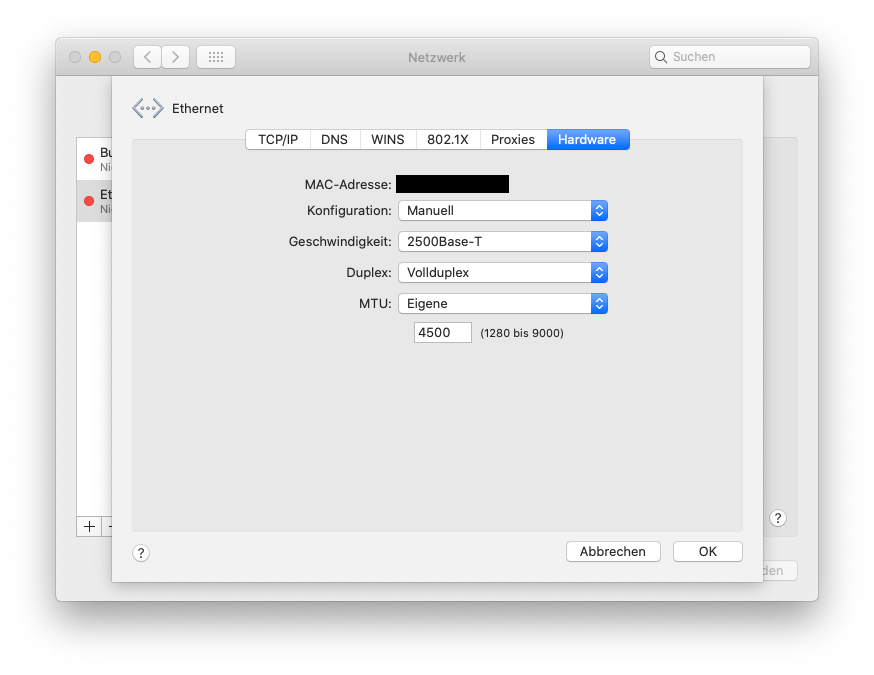

kidooe Posted May 19, 2020 Share Posted May 19, 2020 hi there, Thank you so much for your work on this kext, i did test d5 version kext and its loading in macOS mojave and working fine but i want to report one thing i still have to select medium manually to make it work. if you tell me anything you want and i can upload the logs or anything. Again thanks for your Work <3 Specs: MSI MEG X570 UNIFY - motherboard - ATX - Socket AM4 - AMD X570 MSI Gaming Radeon Rx 590 AMD Ryzen 9 3900X Link to comment https://www.insanelymac.com/forum/topic/343542-lucyrtl8125ethernetkext-for-realtek-rtl8125/page/2/#findComment-2722999 Share on other sites More sharing options...
Mieze Posted May 19, 2020 Author Share Posted May 19, 2020 @kidooe That's nothing to worry about and it happens sometimes if both devices don't agree on the best speed. it's a hardware issue which can be resolved easily with manual intervention. Mieze 1 Link to comment https://www.insanelymac.com/forum/topic/343542-lucyrtl8125ethernetkext-for-realtek-rtl8125/page/2/#findComment-2723000 Share on other sites More sharing options...

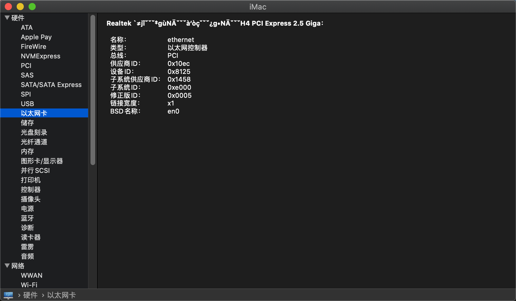

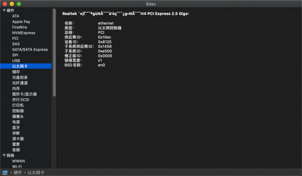

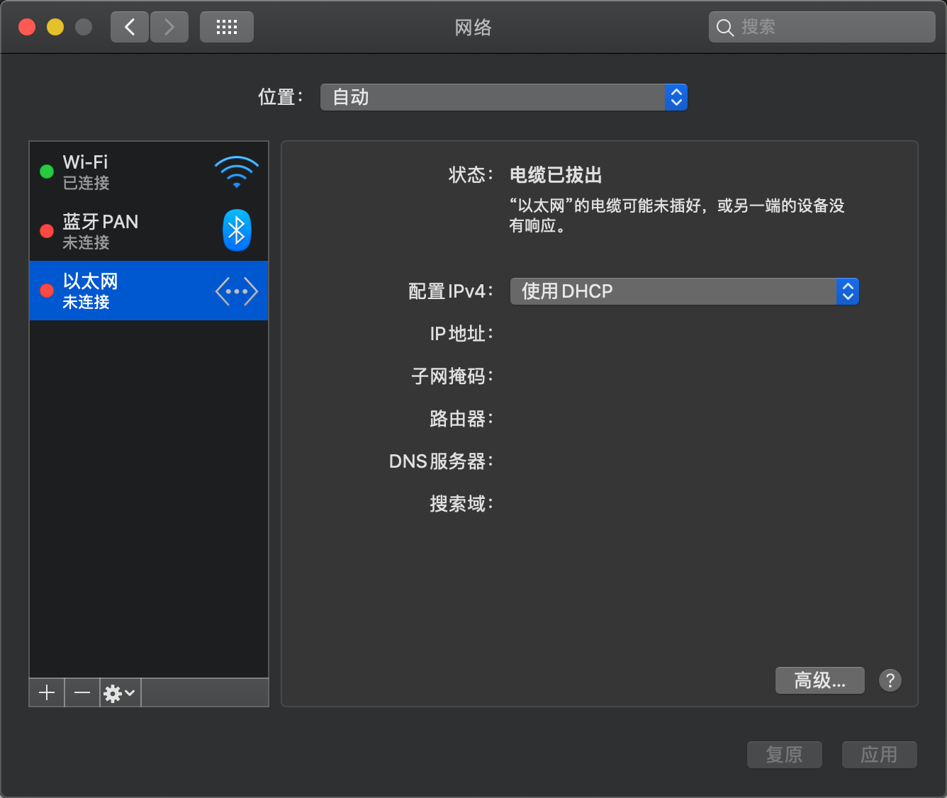

bugprogrammer Posted May 26, 2020 Share Posted May 26, 2020 (edited) 您好,我的主板技嘉Z490 ELITE使用您共享的驱动程序配备了RTL8125 2.5G。当前,乱码显示在本机上,无法连接到网络,并且已经过自动和手动测试。很抱歉使用的翻译工具是英语的辛勤工作。 lan.log Edited May 27, 2020 by bugprogrammer add logs Link to comment https://www.insanelymac.com/forum/topic/343542-lucyrtl8125ethernetkext-for-realtek-rtl8125/page/2/#findComment-2723825 Share on other sites More sharing options...

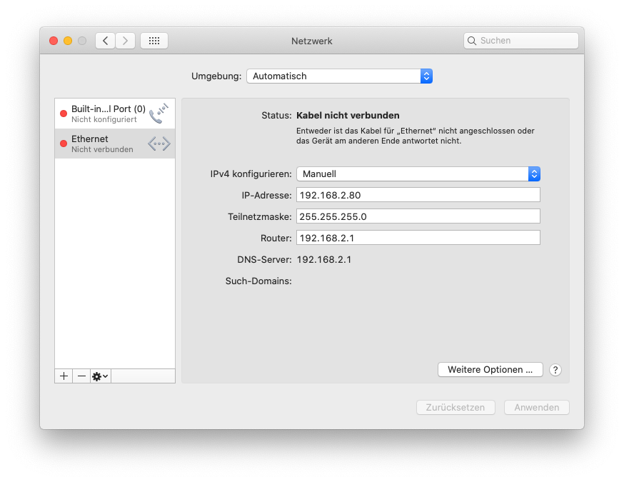

joe2347234782357 Posted June 10, 2020 Share Posted June 10, 2020 Is a RTL8125AG chip supported with this? I tried version d5 and the ethernet interface does nothing when connected to my router. Compiling logs and info atm. My mainboard is a Gigabyte Z490 Aorus Elite AC Link to comment https://www.insanelymac.com/forum/topic/343542-lucyrtl8125ethernetkext-for-realtek-rtl8125/page/2/#findComment-2725451 Share on other sites More sharing options...
joe2347234782357 Posted June 10, 2020 Share Posted June 10, 2020 (edited) Ok, so here's the logs, a rather boring wireshark trace and some screenshots of ioregistryexplorer. Log starts with a fresh boot, manual configuration of 1000Base-T, Full Duplex => self-assign 169.254... IP. Then after a whie i changed to automatic configuration (no connection) Might as well be ACPI related issues, as I'm only just learning how to fix all that. So if anyone can give me a hint towards this I'll be glad as well! Oh and connecting the very same cable end to my MBP results in a perfectly fine 1000Base-T, Full DUplex, EEE connection. Other end is a router with DHCP enabled, which I never had any issues with. Thansk in advance to anyone who's looking into this - and of course to @Mieze for writing the driver in the first place! Update: Bug resolved, removed logs Edited June 15, 2020 by joe2347234782357 Link to comment https://www.insanelymac.com/forum/topic/343542-lucyrtl8125ethernetkext-for-realtek-rtl8125/page/2/#findComment-2725473 Share on other sites More sharing options...

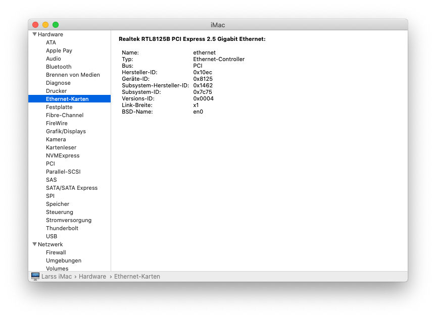

opa334 Posted June 12, 2020 Share Posted June 12, 2020 20 hours ago, Brumbaer said: Please try the attached version of the kext and tell me whether it makes a difference. LucyRTL8125Ethernet.kext.zip Still doesn't work for me sadly. I'm using an MSI Z490 Gaming Plus (RTL8125B) on 10.15.5. Log and screenshots are attached. @Mieze log.txt Link to comment https://www.insanelymac.com/forum/topic/343542-lucyrtl8125ethernetkext-for-realtek-rtl8125/page/2/#findComment-2725606 Share on other sites More sharing options...
Brumbaer Posted June 13, 2020 Share Posted June 13, 2020 Do you have a 2500 network ? If not select the correct speed. If so, do you have an ordinary 1 Giga network for testing ? Just to make sure that it's not working. Link to comment https://www.insanelymac.com/forum/topic/343542-lucyrtl8125ethernetkext-for-realtek-rtl8125/page/2/#findComment-2725608 Share on other sites More sharing options...
opa334 Posted June 13, 2020 Share Posted June 13, 2020 25 minutes ago, Brumbaer said: Do you have a 2500 network ? If not select the correct speed. If so, do you have an ordinary 1 Giga network for testing ? Just to make sure that it's not working. Oh lol, I didn't realize I need to select whatever speed my network has, I thought I'm supposed to select the speed of my network card. Setting it to 1000 does not work, but 100 does... 100 is probably the speed of my network because I use some fairly old wireless device to get the ethernet to my room. Thanks! Link to comment https://www.insanelymac.com/forum/topic/343542-lucyrtl8125ethernetkext-for-realtek-rtl8125/page/2/#findComment-2725609 Share on other sites More sharing options...
