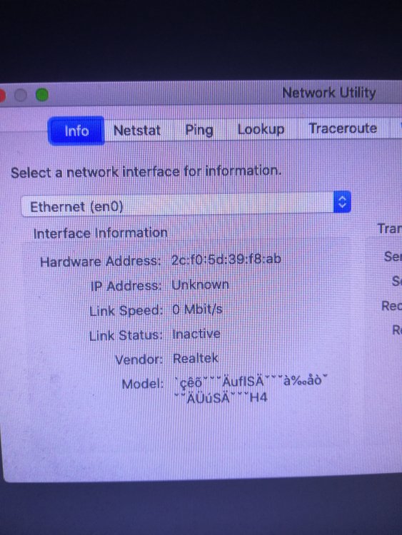

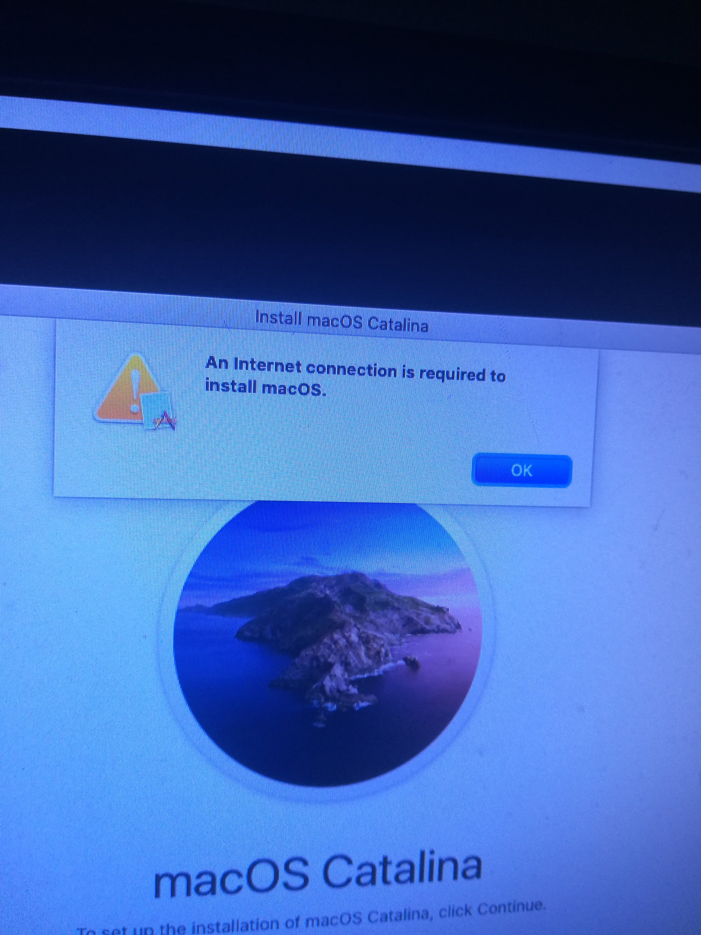

Cungbinh9327 Posted July 16, 2020 Share Posted July 16, 2020 Hi, I'm a new member of MacOS. I have problem with my Realtek RTL8125 that MacOS didn't see the ethernet. Can you show me how to install the drive or using Clover to open it? I never did that before, so sorry for stupid request. . Link to comment https://www.insanelymac.com/forum/topic/343542-lucyrtl8125ethernetkext-for-realtek-rtl8125/page/3/#findComment-2730563 Share on other sites More sharing options...

alazium Posted July 22, 2020 Share Posted July 22, 2020 (edited) Hello guys. First time here. On the first page luckyducky8676 asked how to install system with this Kext on RTL8125 without system settings. In installer use terminal. Type in commmand: ifconfig to know what your interface name is, it can be en0 or en1 etc. Then type in command ifconfig en0 media 1000baseT where "en0" your interface name This command will push your connection to 1Gb speed, and you can install your OS without exxxternal LAN adapter. Works fine for me. Edited July 22, 2020 by alazium Link to comment https://www.insanelymac.com/forum/topic/343542-lucyrtl8125ethernetkext-for-realtek-rtl8125/page/3/#findComment-2731392 Share on other sites More sharing options...

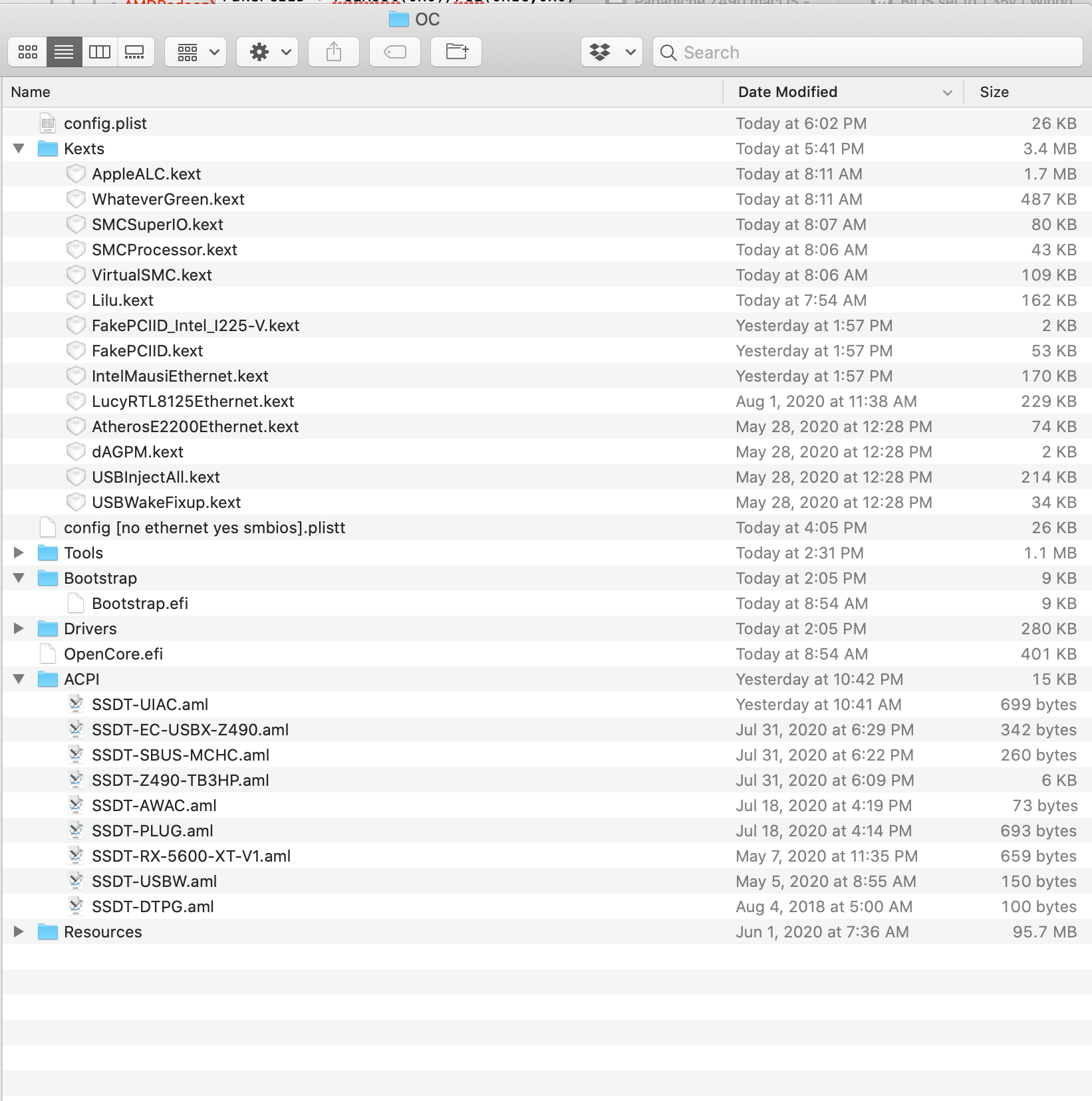

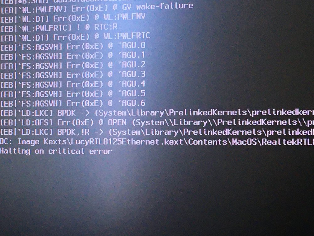

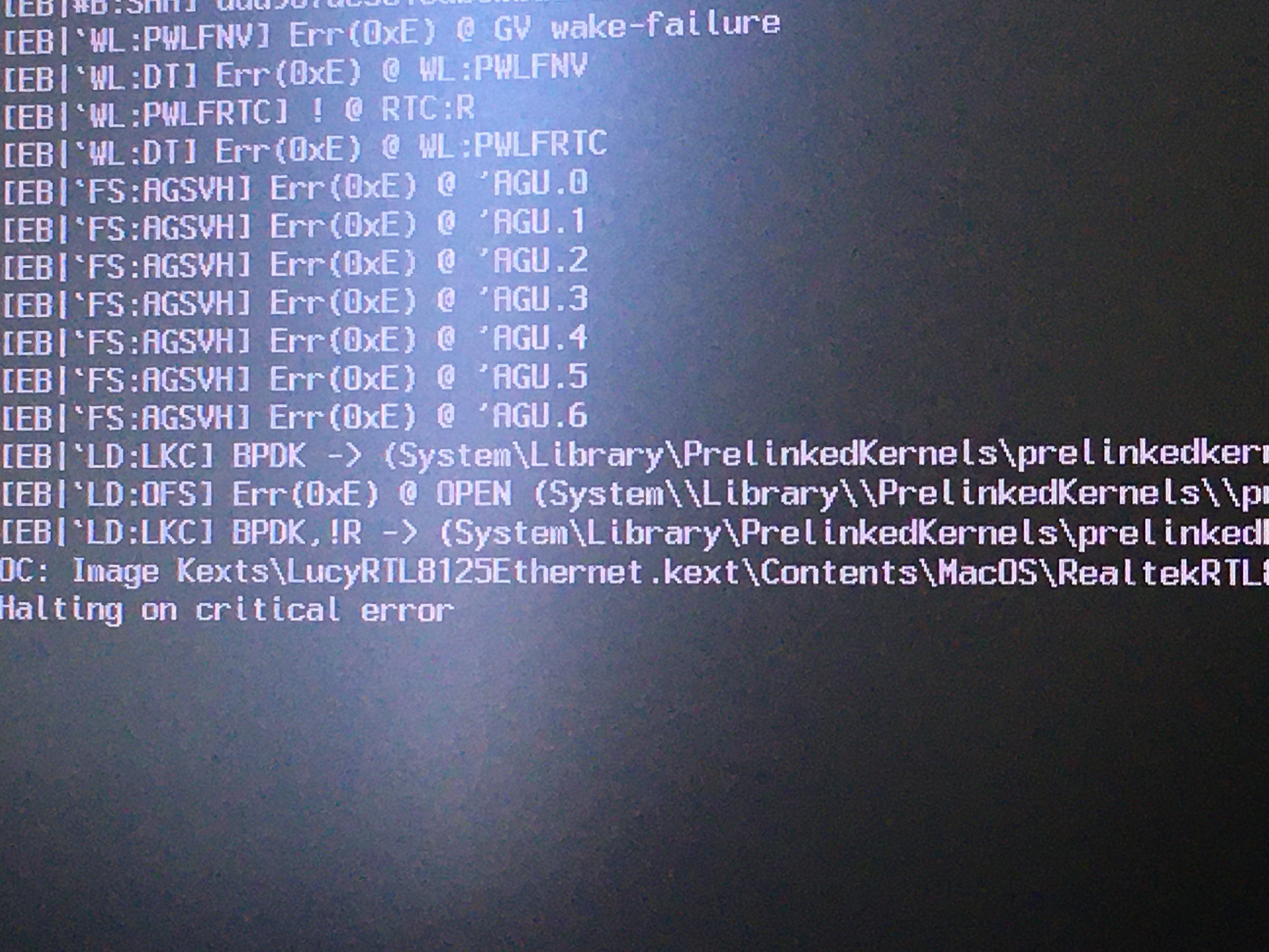

zoe934 Posted August 3, 2020 Share Posted August 3, 2020 I have problem to install LucyRTL8125Ethernet.kext with OpenCore 0.6.0 I have all my kexts place in the EFI/OC/Kexts, also enabled all of them in config.plist but Lucy shows error. any advise? On 7/10/2020 at 7:29 PM, kidooe said: just use opencore to inject the kext, i never installed any kexts in LE or SLE. use bootloader to inject kexts I never installed in LE or SLE too. Does OC 0.6.0 able to inject the Kext by placing it under EFI/OC/Kexts? Link to comment https://www.insanelymac.com/forum/topic/343542-lucyrtl8125ethernetkext-for-realtek-rtl8125/page/3/#findComment-2732937 Share on other sites More sharing options...

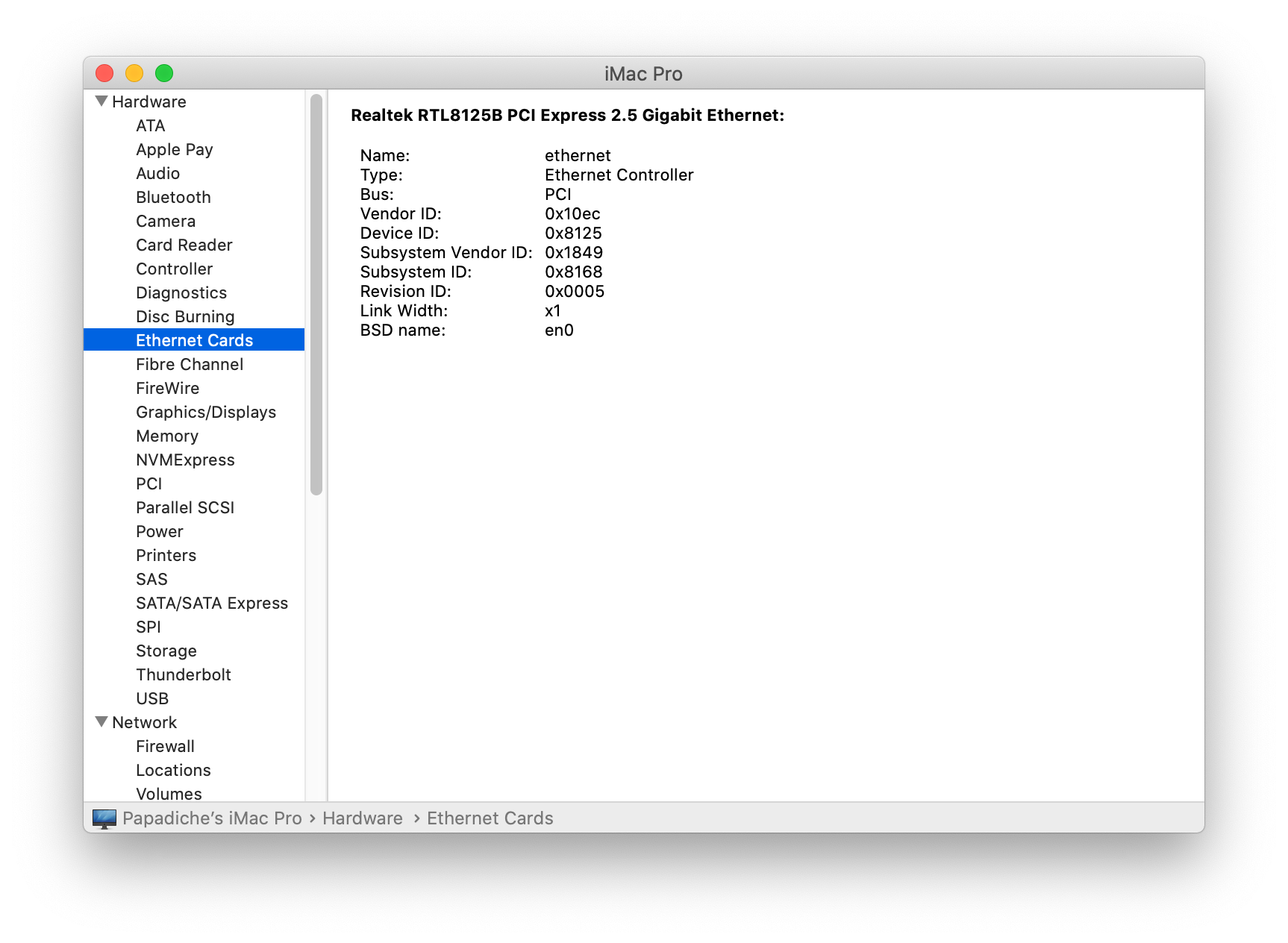

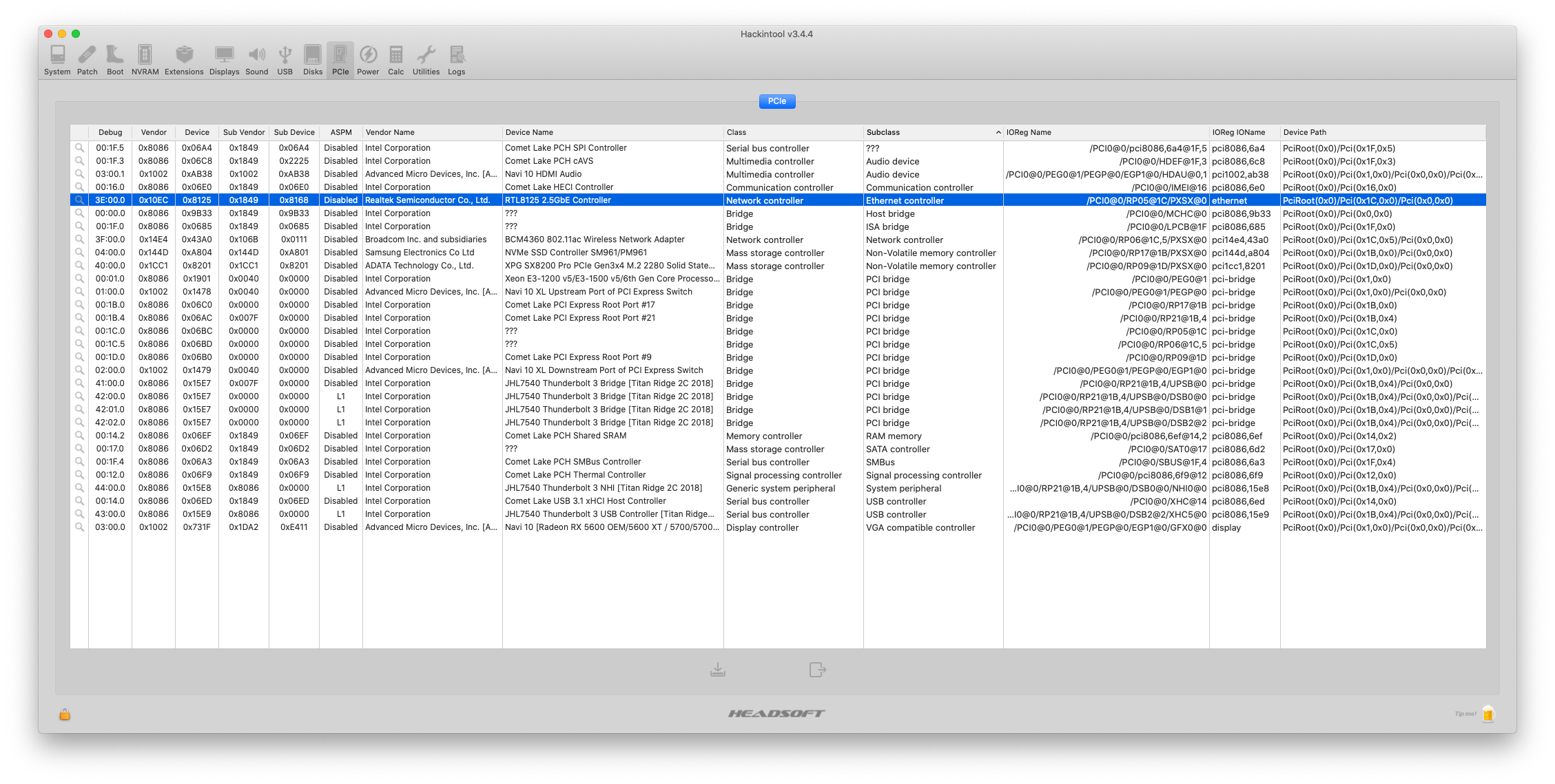

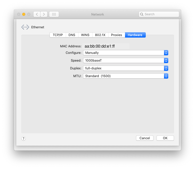

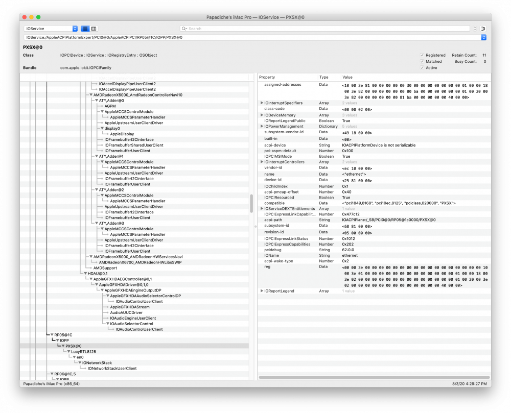

papadiche Posted August 4, 2020 Share Posted August 4, 2020 Hey guys, I'm not able to get Ethernet working! I'm running an ASRock Z490 Phantom Gaming ITX/ac with a Realtek 8125 LAN device; current driver is v1.0.0d6 of LucyRTL8125Ethernet.kext. Computer works perfectly otherwise, but no Ethernet. When I inject device-id F2150000 to my Ethernet PCI root (slightly different than the one listed in the Opencore guide: RP05 -> 0x1C,0x0 instead of RPxx -> 0x1C,0x1) I lose the Ethernet option in System Preferences -> Network. Similarly if I remove LucyRTL8125Ethernet.kext I have no Ethernet network option. Here's a well-formatted post on Reddit showing all of my testing: Any idea what I'm doing wrong or what else I can try to get Ethernet working? Thanks to all of you, especially Mausi !! config.plist Ethernet Debug log.txt Link to comment https://www.insanelymac.com/forum/topic/343542-lucyrtl8125ethernetkext-for-realtek-rtl8125/page/3/#findComment-2732952 Share on other sites More sharing options...
bendodo Posted August 4, 2020 Share Posted August 4, 2020 hi @Mieze can you help me? i have the msi mpg z490 gaming plus and i used your LucyRTL8125Ethernet-V1.0.0d5 "thank you for that" but nothing work i don't know what happen, im over that Link to comment https://www.insanelymac.com/forum/topic/343542-lucyrtl8125ethernetkext-for-realtek-rtl8125/page/3/#findComment-2733020 Share on other sites More sharing options...
papadiche Posted August 4, 2020 Share Posted August 4, 2020 Solved!! @bendodo perhaps this is your issue as well? Compile and use V1.0.0d6 of the LucyRTL8125Ethernet.kext (available here) and then change your Ethernet's Speed to Base1000T as shown below. @Mieze Would there be any way to edit config.plist or the kext to automatically negotiate the Ethernet port's speed? Possibly just force 1Gbit? Thank you so so much for your kernel extension and all your hard work!!! We all really appreciate you Cheers! Link to comment https://www.insanelymac.com/forum/topic/343542-lucyrtl8125ethernetkext-for-realtek-rtl8125/page/3/#findComment-2733034 Share on other sites More sharing options...

sulitfactor Posted August 18, 2020 Share Posted August 18, 2020 for those who are stuck on the install screen with no network options type this in the command terminal ifconfig en0 media 1000baseT i was installing high sierra 10.13.6 Link to comment https://www.insanelymac.com/forum/topic/343542-lucyrtl8125ethernetkext-for-realtek-rtl8125/page/3/#findComment-2734621 Share on other sites More sharing options...

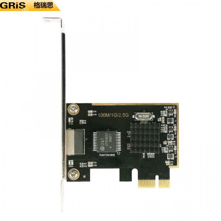

Henry2010 Posted August 20, 2020 Share Posted August 20, 2020 (edited) On 8/19/2020 at 6:37 AM, ITzTravelInTime said: Hey @Mieze how are you? I just discovered this kext and my question is: how many cats do or did you have? And also any reccomendation for a cheap pcie card compatible with it? since i have plenty of pcie slots it would be nice to upgrade to 2.5 Gigabit you can find some sellers on aliexpress. GRIS or TP-LINK would do. they should look like these. Edited August 20, 2020 by Henry2010 1 Link to comment https://www.insanelymac.com/forum/topic/343542-lucyrtl8125ethernetkext-for-realtek-rtl8125/page/3/#findComment-2734918 Share on other sites More sharing options...

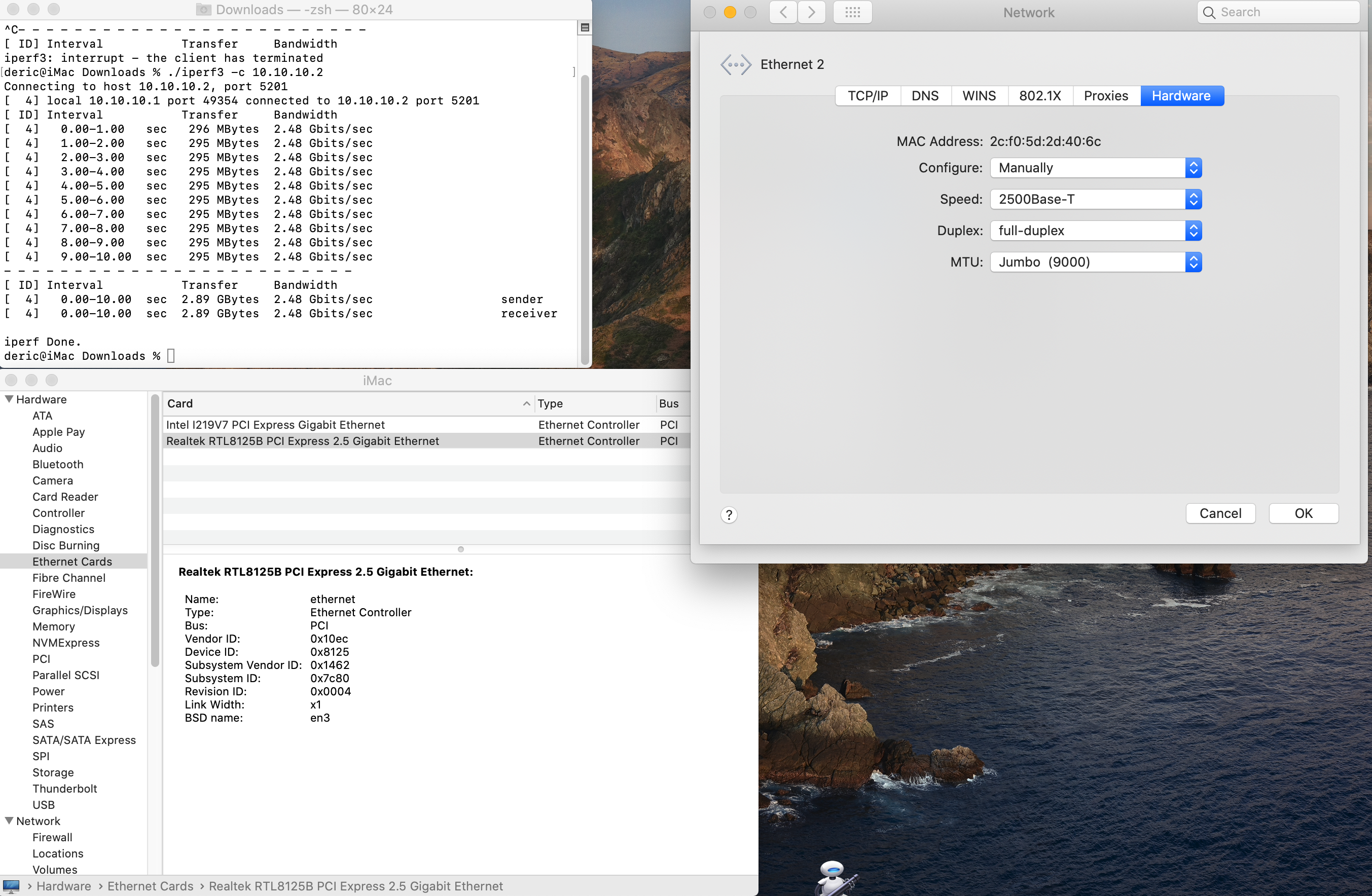

deric Posted August 27, 2020 Share Posted August 27, 2020 version 1.0.0d6 version 1.0.0d6 1 Link to comment https://www.insanelymac.com/forum/topic/343542-lucyrtl8125ethernetkext-for-realtek-rtl8125/page/3/#findComment-2735507 Share on other sites More sharing options...
