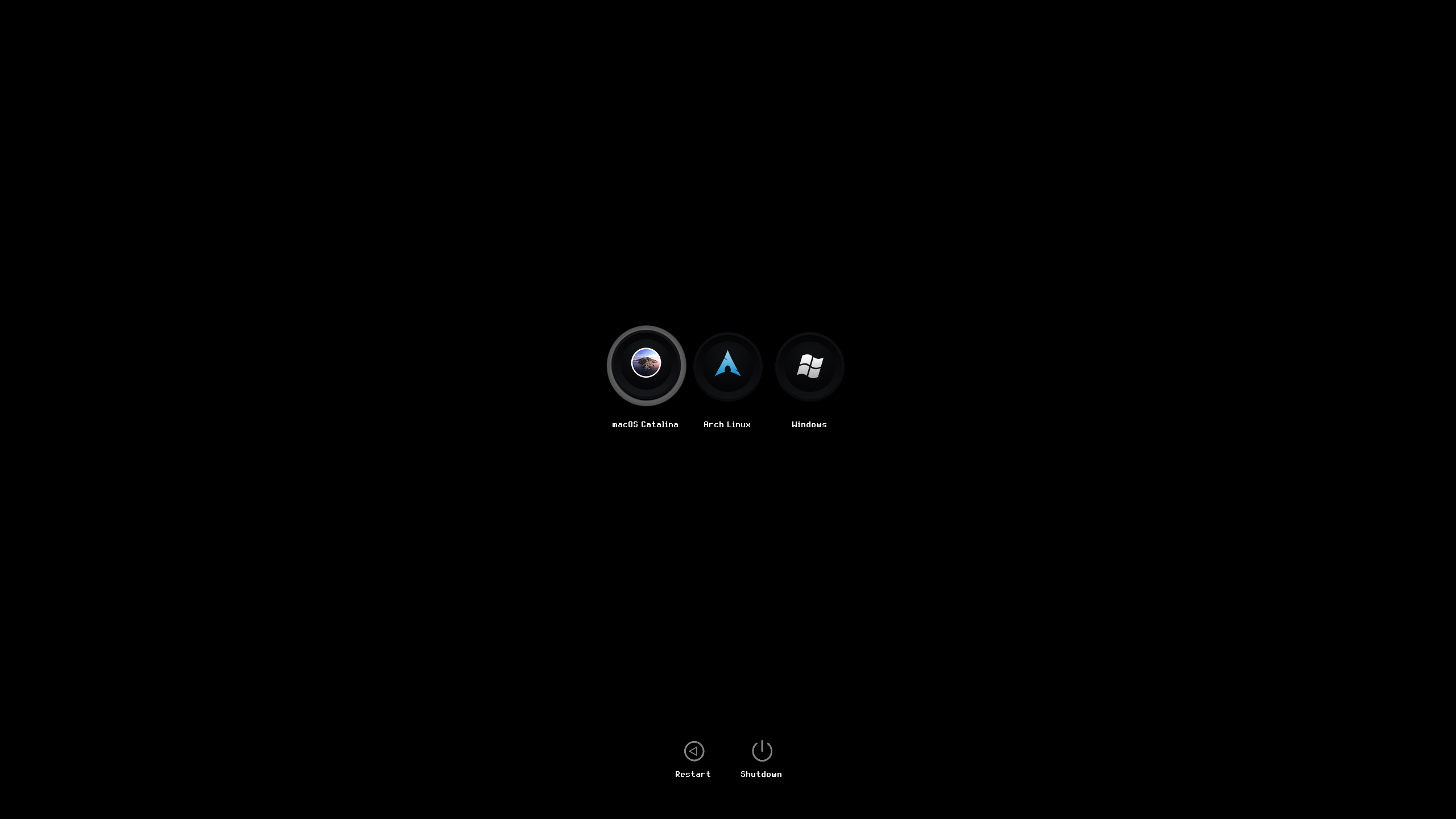

@n.d.k I've noticed for the last day or two of commits the list of custom entries randomly will get out of order or entries won't appear (aka are 'lost').
Here's how it should look (with the list in this order, Windows 10, macOS Catalina and Arch Linux)...
But at random, the order is getting mixed up to this...
Looks like the Windows 10 entry is randomly getting 'lost' with the generic entry being shown. I did double check the path for the Windows 10 entry but it's correct and the correct Windows 10 entry will reappear after a reboot. I've also noticed a couple times the Arch Linux entry will randomly be 'lost' as well - I also checked the path for this and it's correct (and it will appear back after a reboot). It's not the drives failing (odd that two different SSDs would fail at the same time, and both appear fine in the UEFI BIOS boot list) or anything like that. For the time being, I've reverted to a backup from three days ago (I first noticed this this morning, so within the last day or so). Who knows, maybe it's related to the EDKII stuff from the last few days?
Any ideas?
Edited by Awesome Donkey
Any ideas?
I recently added custom entry and tool check, which meant before the custom/tool entry is added, it will check for the file existence based on the provided path. This ensure that all displayed boot entries are valid.
The problem you described seems like your drives are inconsistence available during the file check.
Can there be a way to disable the file check (like an advanced option)? I'm willing to accept the potential consequences of having that file check disabled (even though I've never had issues with custom entries not booting).
The only reason I can think of why there might be an inconsistency is perhaps from a delay initializing all the drives in my PC while it POSTs, since I have 6 of them installed. However the drives *are* always there and do boot correctly regardless. Or it might be some UEFI BIOS quirk, not sure.

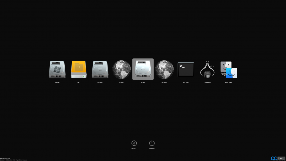

BTW, I also noticed while testing with my 'issue' above that tools, e.g. OpenShell.efi, failed to appear as well. Looking at the OC debug logs it mentioned this...
OC: Invalid tool path
Which may or may not have anything to do with it. I'm going to guess this is happening because tools that are used (like in the sample .plist files) don't use the full paths, instead appearing like this by default...

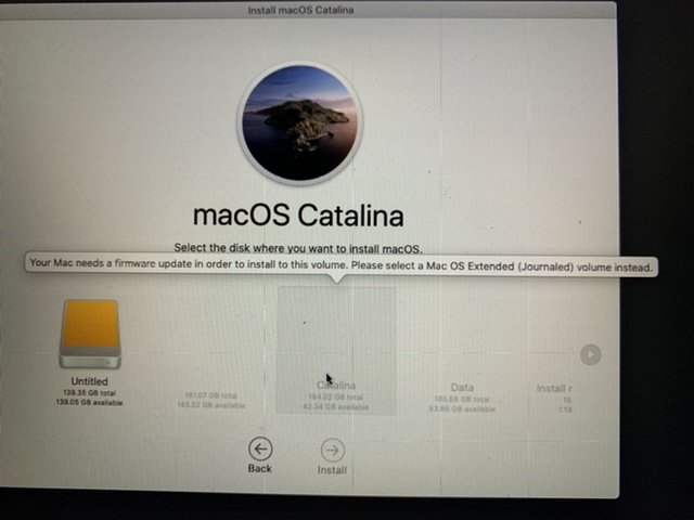

However I now tried to upgrade my 10.15.2 installation to 10.15.4 (I’m using the full Installer), the Installer says that my Mac needs a firmware update to install to APFS volume and it asks me to pick a HFS+ partition instead. See the attached screenshot.
I can however workaround the problem by choosing Macbookpro14,1 instead of Macbookpro13,1 that I normally use. It seems OpenCore is spoofing / reporting  an older Boot ROM when using Macbookpro13,1.
My hack is a Lenovo T460 laptop with i5-6300u and is better matched with Macbookpro13,1 but even otherwise the problem of spoofing an older Boot ROM seems to be a bug with OpenCore. I’m using OpenCore 0.5.7. What you all think?
