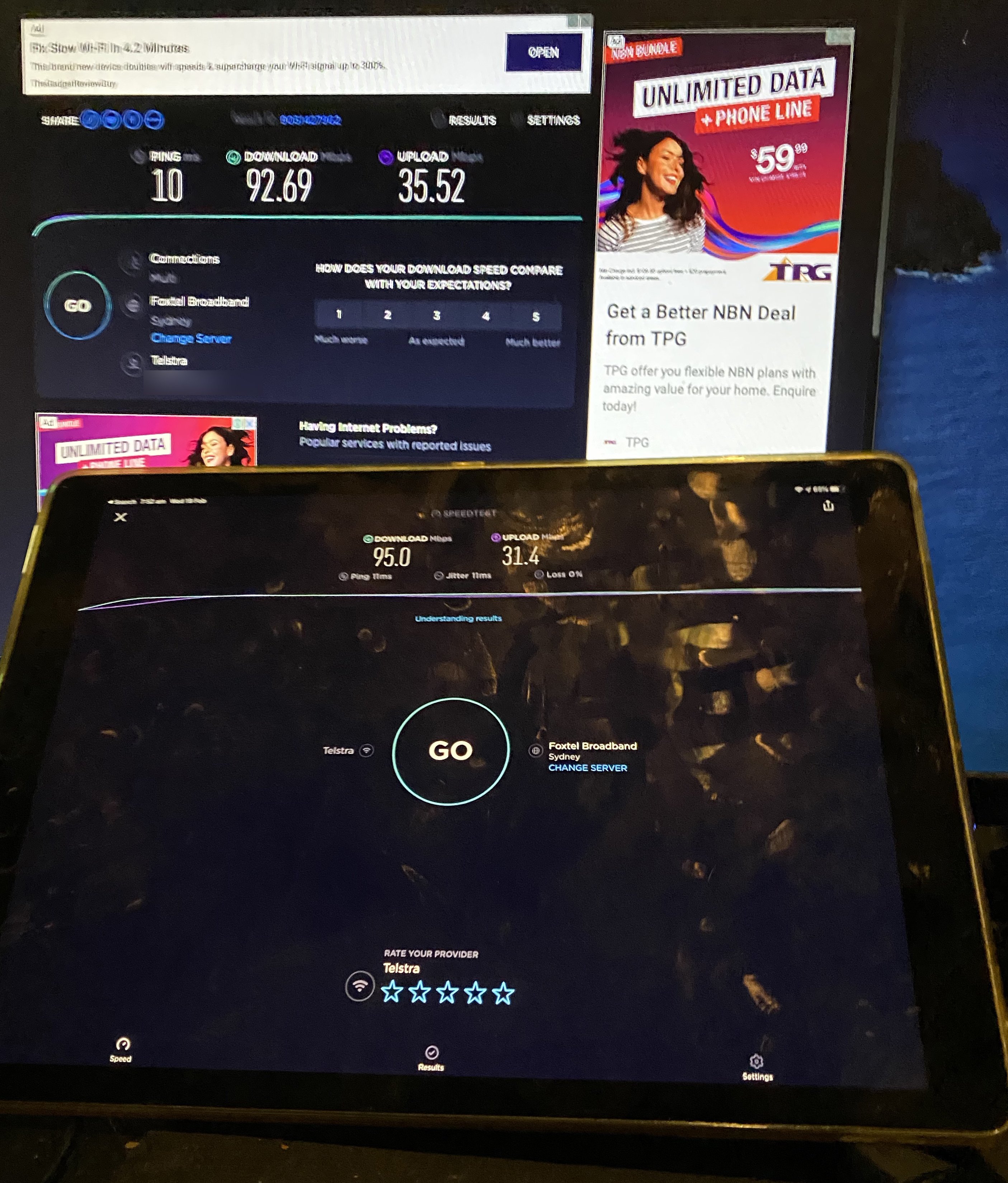

AudioGod Posted February 18, 2020 Author Share Posted February 18, 2020 (edited) 49 minutes ago, Tiem said: Tested the range, still the same. It's going to perform the same in any slot. Even at PCIe 1x, the card has plenty of throughput for WiFi/BT. Like slapping your Honda Civic on the autobahn. It's not going to turn into a Ferrari. Snake oil. you can’t call all other people liars bro cos that’s what your basically doing. If somebody says it fixed there problems and then a second one says it you got to open them German eyes of yours and consider why it’s happening instead of dropping into a stance that everybody is wrong apart from you. Be helpful and everybody will be thankfully right or wrong but be a {censored} and expect to be treated like one back. be nice dude or be silent, you ruffle to many feathers on here and I’m not talking about my own. Edited February 18, 2020 by AudioGod Link to comment https://www.insanelymac.com/forum/topic/339980-audiogods-aorus-z390-pro-patched-dsdt-mini-guide-and-discussion/page/68/#findComment-2708859 Share on other sites More sharing options...

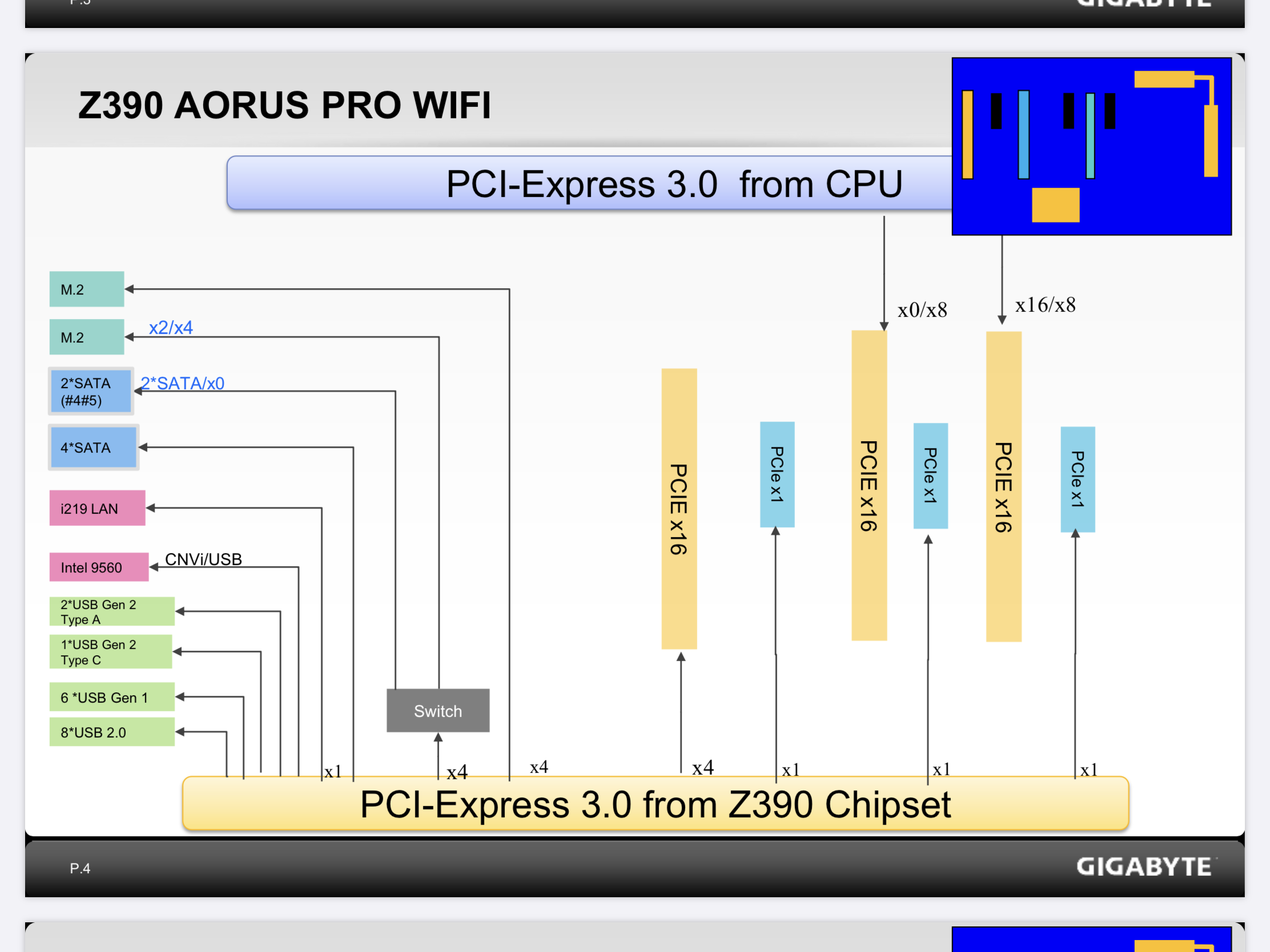

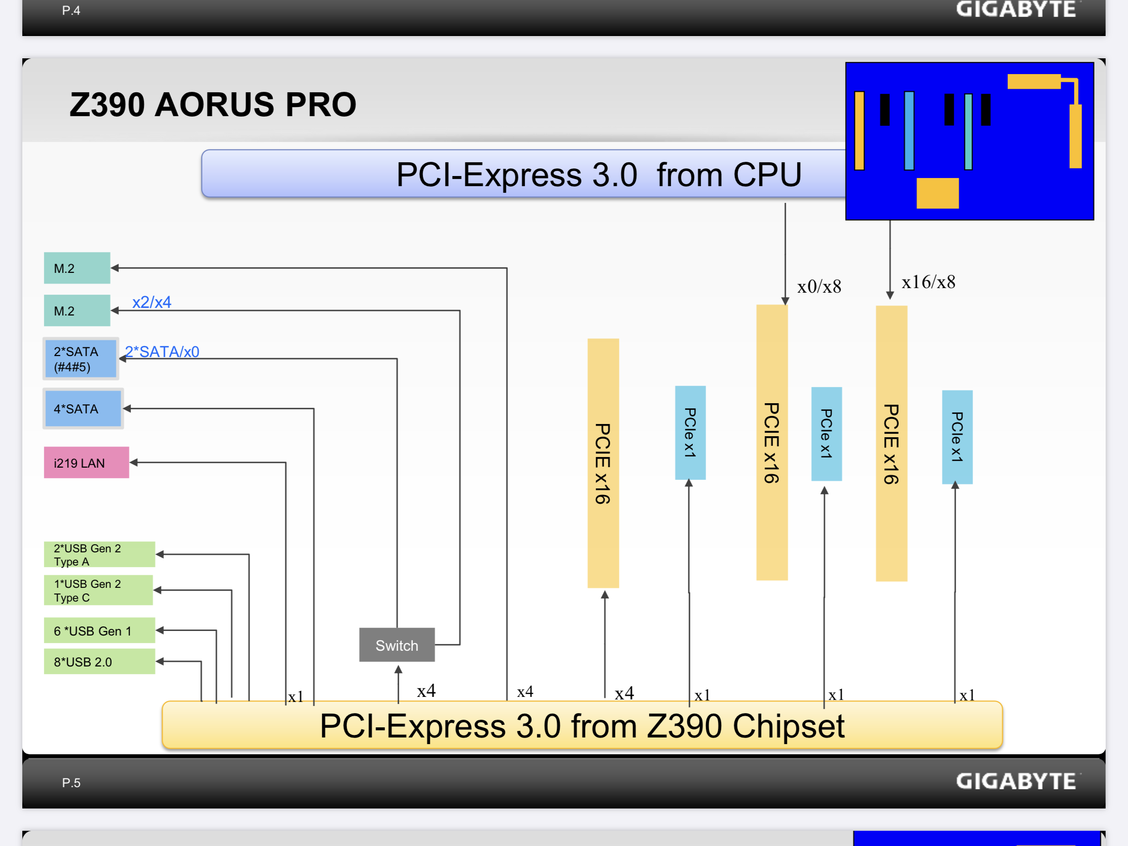

AudioGod Posted February 18, 2020 Author Share Posted February 18, 2020 (edited) Here’s the lane sharing and Tiem is correct in the fact that it shouldn’t make a difference as no lanes get swapped or taken from anywhere else for any of the x1 or the x4 slots. I wonder what on earth is going on in that case. Don’t worry I believe you guys that are having the problem, no doubts from me there I just can’t work out why it’s happening or why moving the card to slot 4 helps. I’m not ashamed to say that I’m clueless over this I’m afraid. Edited February 18, 2020 by AudioGod Link to comment https://www.insanelymac.com/forum/topic/339980-audiogods-aorus-z390-pro-patched-dsdt-mini-guide-and-discussion/page/68/#findComment-2708862 Share on other sites More sharing options...
WizeMan Posted February 18, 2020 Share Posted February 18, 2020 14 minutes ago, AudioGod said: Here’s the lane sharing and Tiem is correct in the fact that it shouldn’t make a difference as no lanes get swapped or taken from anywhere else for any of the x1 or the x4 slots. I wonder what on earth is going on in that case. Don’t worry I believe you guys that are having the problem, no doubts from me there I just can’t work out why it’s happening or why moving the card to slot 4 helps. I’m not ashamed to say that I’m clueless over this I’m afraid. [IMAGE] [IMAGE] The only thing I know is that I am about one day in with MSR Unlocked and no bluetooth issues whatsoever have appeared with the Fenvi card on PCIEX4 Link to comment https://www.insanelymac.com/forum/topic/339980-audiogods-aorus-z390-pro-patched-dsdt-mini-guide-and-discussion/page/68/#findComment-2708863 Share on other sites More sharing options...
AudioGod Posted February 18, 2020 Author Share Posted February 18, 2020 (edited) 54 minutes ago, WizeMan said: The only thing I know is that I am about one day in with MSR Unlocked and no bluetooth issues whatsoever have appeared with the Fenvi card on PCIEX4 And now that makes 3 people that it’s helped. Baffle! Edited February 18, 2020 by AudioGod 1 Link to comment https://www.insanelymac.com/forum/topic/339980-audiogods-aorus-z390-pro-patched-dsdt-mini-guide-and-discussion/page/68/#findComment-2708866 Share on other sites More sharing options...

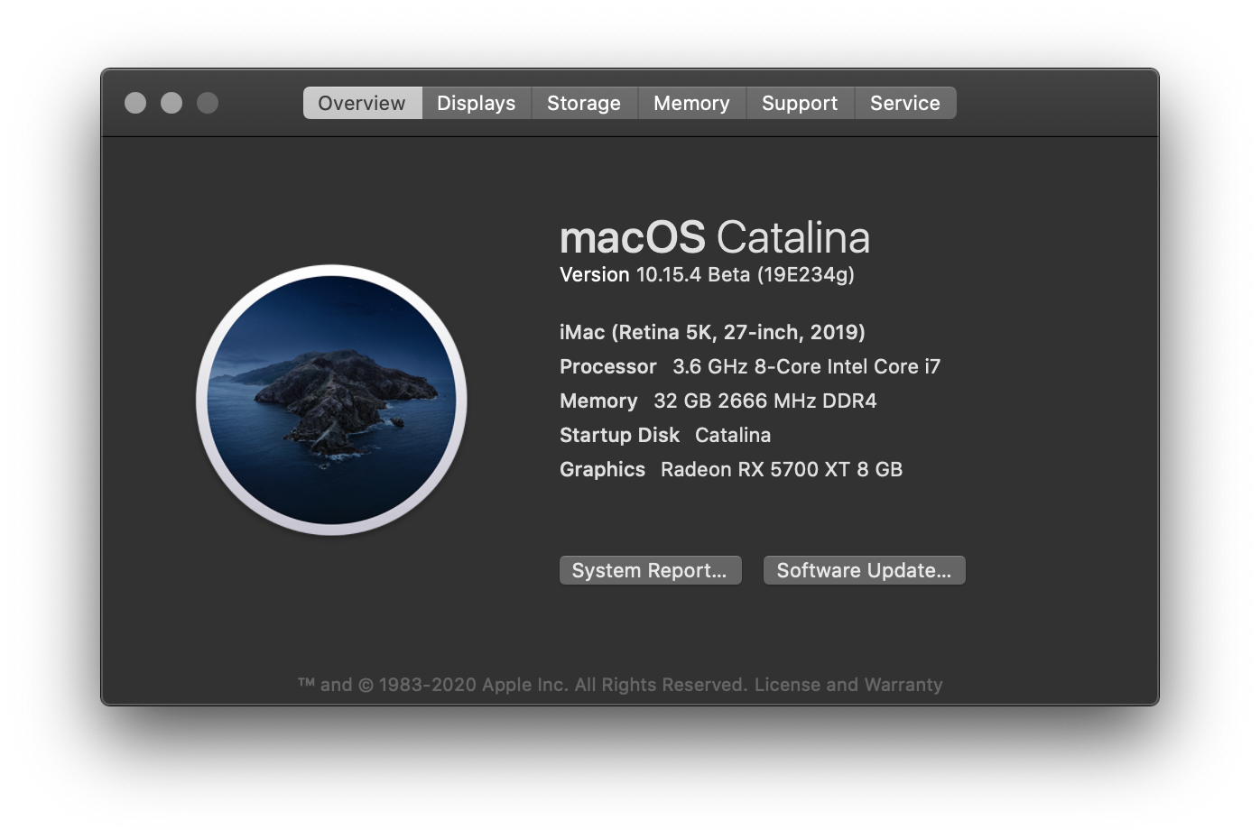

Tiem Posted February 19, 2020 Share Posted February 19, 2020 (edited) 21 hours ago, larabee said: Then communication training and behavioral therapy can help people with the syndrome learn to socialize more successfully. Good luck daughter. Thanks I like the way I am Beta 2 working fine so far: Edited February 19, 2020 by Tiem Link to comment https://www.insanelymac.com/forum/topic/339980-audiogods-aorus-z390-pro-patched-dsdt-mini-guide-and-discussion/page/68/#findComment-2709075 Share on other sites More sharing options...
