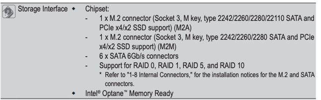

Ok,  I'll check it out, thanks. I think it only uses sata

2 hours ago, AudioGod said:
Check in the Z390 pro Manual for what lanes get used for what slots.
on the Z390 Master the bottom m.2 slot uses the lanes from the lowest pcie slot and the middle m.2 slot uses the lanes from sata 0 and 1
top slot if fee to use with no effect.
Seems to make no diff to me either this, i have pcie m.2 in the bottom m.2 slot (m2m)  and the wifi card in the x4 slot .. Works alright !

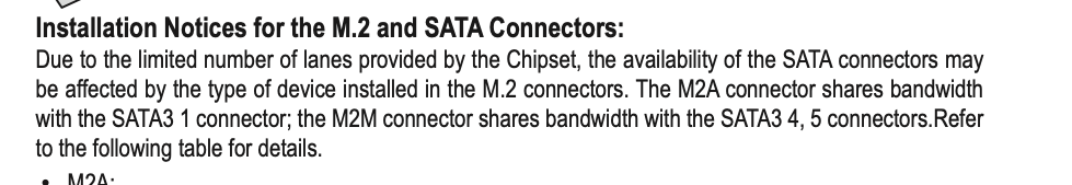

I did say check the manual for the pro as it has 2 m.2 slots that come off different lanes to the master.
as you can see from the above post it losses sata ports only so for you it’s no biggie.
the masters third m.2 slot shares with the bottom pcie slot.

I just checked for myself and the pro uses sata 1 for m2a and 4 5 for m2m, no pcie lanes for pcie slots are affected.

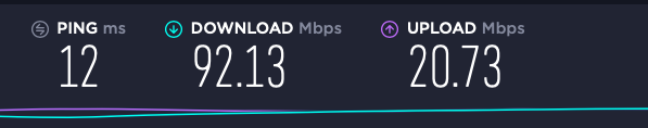

16 minutes ago, Cameron Nicholson said:
Changing to the bottom x4 slot fixed my WiFI. Still no sidecar but I don't think thats related to my BT card.
yeah confirmed, I just refitted the t919 to my hack to test but using the lowest slot instead of the 1x above it and it sure does work a lot better there.
Edited by AudioGod
After all these weeks/months of trial and error. But from a theoretical stand point it makes sense.
Does it?
Hhhhmmmmm, it’s a 1x card to start with isn’t it?
i don’t see how using a 4x slot instead of the 1x can cause that.
thinking about it though, I use a BCM943602CS native card and it’s on a pcie adaptor. The adaptor is a 1x pcie card yet I know the BCM943602CS runs at 4x natively so you might actually have a point there. Baffled I am :hysterical:
ok ok I just did some digging and the t919 is a pcie 4x card. That explains it then. :thumbsup_anim:
@WizeMan are you using the lowest pcie slot already? Switch your card to it if your not.
Thats what made me start to wonder, when I retrieved the link to post here I noticed it's a x4 card.
