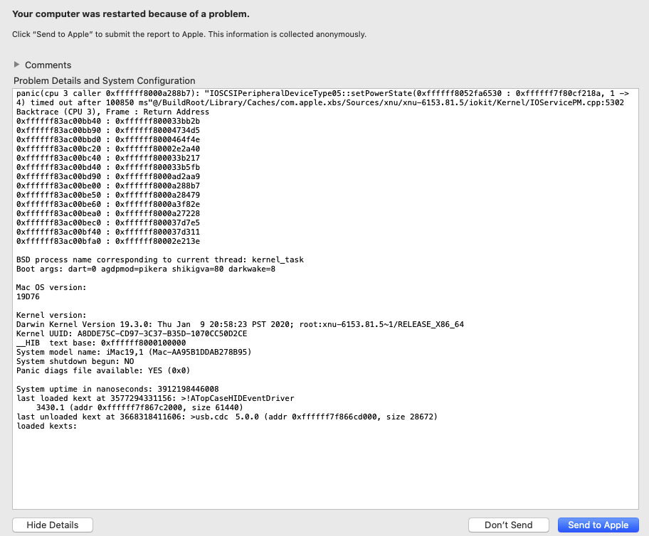

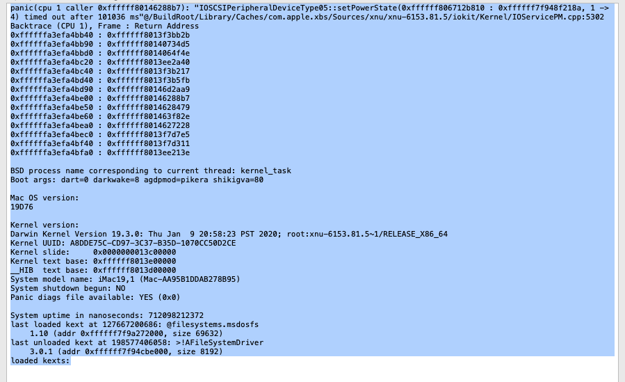

mariodj Posted February 27, 2020 Share Posted February 27, 2020 Aorus Z390 pro , i7 9700K , 32GB , Sapphire RX5700 XT Nitro+ , F11 Got random reboots Link to comment https://www.insanelymac.com/forum/topic/339980-audiogods-aorus-z390-pro-patched-dsdt-mini-guide-and-discussion/page/73/#findComment-2710150 Share on other sites More sharing options...
AudioGod Posted February 27, 2020 Author Share Posted February 27, 2020 44 minutes ago, mariodj said: Aorus Z390 pro , i7 9700K , 32GB , Sapphire RX5700 XT Nitro+ , F11 Got random reboots If your using my latest EFI then you need to update your bios to the latest version or the dsdt will be incorrect. (F12d is the correct bios to be using) Link to comment https://www.insanelymac.com/forum/topic/339980-audiogods-aorus-z390-pro-patched-dsdt-mini-guide-and-discussion/page/73/#findComment-2710156 Share on other sites More sharing options...
mariodj Posted February 27, 2020 Share Posted February 27, 2020 12 minutes ago, AudioGod said: If your using my latest EFI then you need to update your bios to the latest version or the dsdt will be incorrect. (F12d is the correct bios to be using) i start wit F12d and got reboots as well then i move to F11 will flash back to new bios and report Link to comment https://www.insanelymac.com/forum/topic/339980-audiogods-aorus-z390-pro-patched-dsdt-mini-guide-and-discussion/page/73/#findComment-2710158 Share on other sites More sharing options...
AudioGod Posted February 27, 2020 Author Share Posted February 27, 2020 1 minute ago, mariodj said: i start wit F12d and got reboots as well then i move to F11 will flash back to new bios and report Make sure you use the correct bios settings as per my guide too buddy. Link to comment https://www.insanelymac.com/forum/topic/339980-audiogods-aorus-z390-pro-patched-dsdt-mini-guide-and-discussion/page/73/#findComment-2710159 Share on other sites More sharing options...

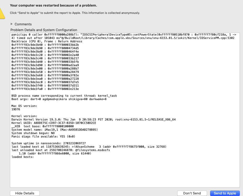

mariodj Posted February 27, 2020 Share Posted February 27, 2020 (edited) bios flashed to F12b, Bios settings as on your tutorial, CFG unlock , Catalina 10.15.3 i was happy little more then one hour and then .... dont now why i got those reboots Edited February 27, 2020 by mariodj Link to comment https://www.insanelymac.com/forum/topic/339980-audiogods-aorus-z390-pro-patched-dsdt-mini-guide-and-discussion/page/73/#findComment-2710169 Share on other sites More sharing options...
mariodj Posted February 27, 2020 Share Posted February 27, 2020 next crush Link to comment https://www.insanelymac.com/forum/topic/339980-audiogods-aorus-z390-pro-patched-dsdt-mini-guide-and-discussion/page/73/#findComment-2710174 Share on other sites More sharing options...

WizeMan Posted February 28, 2020 Share Posted February 28, 2020 11 hours ago, mariodj said: next crush Since this is related to IOServicePM, I feel that your issue is related to power management and some external device that is connected to your hack. Could be a USB Device or maybe an SATA device. Try disconnecting your external devices one at a time and test if this keeps happening. Disconnect them one by one and test. The most suspicious devices could be USB drives that draw too much power OR could be a DVD - DVDRW drive. Link to comment https://www.insanelymac.com/forum/topic/339980-audiogods-aorus-z390-pro-patched-dsdt-mini-guide-and-discussion/page/73/#findComment-2710238 Share on other sites More sharing options...
