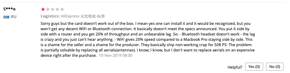

Cameron Nicholson Posted February 16, 2020 Share Posted February 16, 2020 (edited) Hiya, I'll look at my DSDT later as I'll have to research it. I come back yet again with FV-T919 issues, since upgrading to OC my wifi is extremely slow, almost a quarter of what my internet speed is. Also sidecar doesn't work. AirportBrcmFixup reduces my WIFI and BT performance further. Any ideas? I wonder if its a issue with the card itself. Thanks Edited February 16, 2020 by Cameron Nicholson Link to comment https://www.insanelymac.com/forum/topic/339980-audiogods-aorus-z390-pro-patched-dsdt-mini-guide-and-discussion/page/65/#findComment-2708505 Share on other sites More sharing options...

AudioGod Posted February 16, 2020 Author Share Posted February 16, 2020 (edited) 3 hours ago, Cameron Nicholson said: Hiya, I'll look at my DSDT later as I'll have to research it. I come back yet again with FV-T919 issues, since upgrading to OC my wifi is extremely slow, almost a quarter of what my internet speed is. Also sidecar doesn't work. AirportBrcmFixup reduces my WIFI and BT performance further. Any ideas? I wonder if its a issue with the card itself. Thanks Is it working normal in clover but slow in OC and is this NDKs version of OC or the vanilla version? the T919 is a funny old card, I have one sitting here on my shelf and it’s range is really bad but in fairness if you get better antennas for it then your see a marked improvement in performance. Im personally not a fan of it but many people on this thread use one and swear by them. I agree that it’s not fully compatible out of the box like it’s claimed to be but again many people disagree with me and have it working perfectly with no extra kexts. It’s also been noted by @WizeMan that it works much better for him if he’s got he’s MSR Locked.@WizeMan where do you stand on your one now days? oh and one other thing, there are a load of rouge versions of this card (knock offs, Chinese copies) floating around on eBay and a few other places so I always advise to get one though somewhere like amazon where the chances of getting a rouge one are a lot smaller. Edited February 16, 2020 by AudioGod Link to comment https://www.insanelymac.com/forum/topic/339980-audiogods-aorus-z390-pro-patched-dsdt-mini-guide-and-discussion/page/65/#findComment-2708522 Share on other sites More sharing options...
Cameron Nicholson Posted February 16, 2020 Share Posted February 16, 2020 (edited) 35 minutes ago, AudioGod said: the T919 is a funny old card, I have one sitting here on my shelf and it’s range is really bad but in fairness if you get better antennas for it then your see a marked improvement in performance. Im personally not a fan of it but many people on this thread use one and swear by them. I agree that it’s not fully compatible out of the box like it’s claimed to be but again many people disagree with me and have it working perfectly with no extra kexts. It’s also been noted by @WizeMan that it works much better for him if he’s got he’s MSR Locked.@WizeMan where do you stand on your one now days? oh and one other thing, there are a load of rouge versions of this card (knock offs, Chinese copies) floating around on eBay and a few other places so I always advise to get one though somewhere like amazon where the chances of getting a rouge one are a lot smaller. Update - WiFi seems to be working again sorta, My iPhone gets 39Mbps down, my iPad gets 80+Mbps down, my hack gets 35-45Mbps down, I was getting <10Mbps this morning, however side car gives me a black screen on my iPad with error " ...-455..." I did get it from Aliexpress but from Fenvi, should I look at getting a Mac card with a adapter, if so what card do you suggest? Edit - Think it's the same in clover, I know I did get 70+ at one point Edited February 16, 2020 by Cameron Nicholson Link to comment https://www.insanelymac.com/forum/topic/339980-audiogods-aorus-z390-pro-patched-dsdt-mini-guide-and-discussion/page/65/#findComment-2708524 Share on other sites More sharing options...

Cameron Nicholson Posted February 16, 2020 Share Posted February 16, 2020 1 hour ago, AudioGod said: Is it working normal in clover but slow in OC and is this NDKs version of OC or the vanilla version? the T919 is a funny old card, I have one sitting here on my shelf and it’s range is really bad but in fairness if you get better antennas for it then your see a marked improvement in performance. Im personally not a fan of it but many people on this thread use one and swear by them. I agree that it’s not fully compatible out of the box like it’s claimed to be but again many people disagree with me and have it working perfectly with no extra kexts. It’s also been noted by @WizeMan that it works much better for him if he’s got he’s MSR Locked.@WizeMan where do you stand on your one now days? oh and one other thing, there are a load of rouge versions of this card (knock offs, Chinese copies) floating around on eBay and a few other places so I always advise to get one though somewhere like amazon where the chances of getting a rouge one are a lot smaller. BTW my MSR is locked Link to comment https://www.insanelymac.com/forum/topic/339980-audiogods-aorus-z390-pro-patched-dsdt-mini-guide-and-discussion/page/65/#findComment-2708534 Share on other sites More sharing options...

Cameron Nicholson Posted February 16, 2020 Share Posted February 16, 2020 Are these worth a try? New antenna's Link to comment https://www.insanelymac.com/forum/topic/339980-audiogods-aorus-z390-pro-patched-dsdt-mini-guide-and-discussion/page/65/#findComment-2708537 Share on other sites More sharing options...
