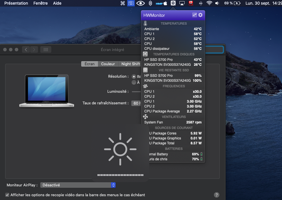

MY problem solved with LCD brightness.  WEG alone does not take care of this for Laptops that have only Nvidia GTX and Intel integrated graphics disabled.  We still need AppleBacklightFixup and WEG alone does not work.  We still need WEG obviously, but whatever code is in ABF needs to be included in WEG for future releases for NVIDIA support.  I was able to get ABF to work again with a bootflag to run on unsupported software such as Beta Catalina so once the final version of Catalina is released it will work without this flag "-applbklbeta hopefully.  We need future release versions of WEG to support exactly what ABF does for Nvidia GFX, and not just Intel.

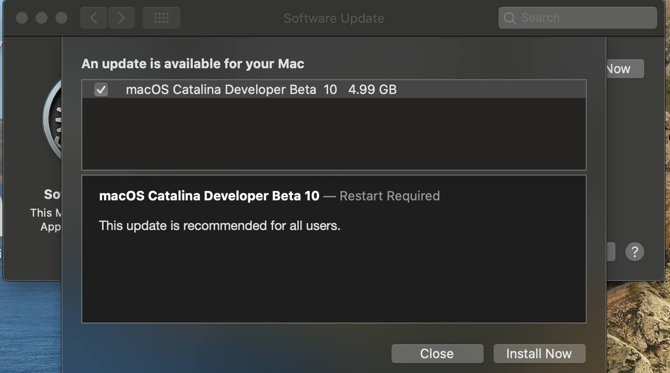

Ok the update through Settings Update went fine.  Maybe its the full download and update from that installer that I am having a problem with?
So its puts the installer onto the Data Volume but does not want to boot to that volume wants to boot back into Catalina without continuing the install.  I have to choose the Data Volume from Clover GUI to continue and complete the installation.

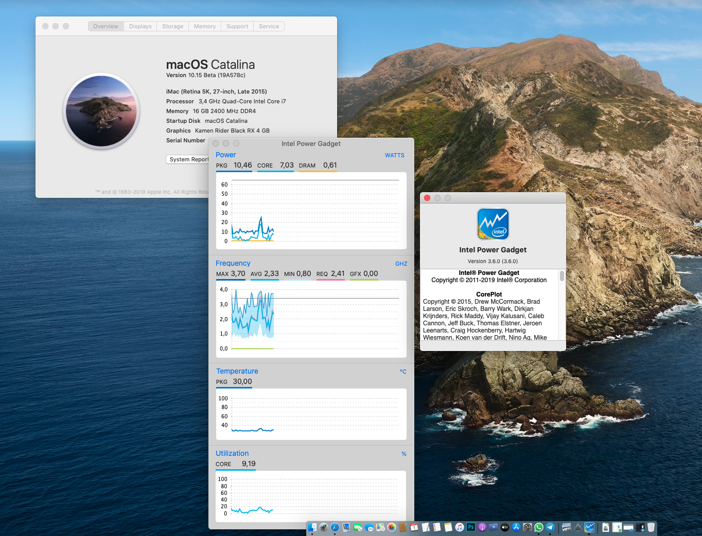

On 9/29/2019 at 12:10 PM, SavageAUS said:
Ok so i did a fresh install of the latest beta (9) i think on my desktop as i couldnt boot after installing the latest IPG (3.6.0). Now i installed IPG and rebooted and it was fine i think but then i installed iCue for my keyboard and mouse and of course it needed a reboot. Upon rebooting it just goes into a boot loop. I think beta 9 is very screwy. Does anyone know how i can download beta 8?
Just remove /Library/Extensions/EnergyDriver.kext will solve your problem.
Then, roll back to Intel Power Gadget 3.5.5 will work.
