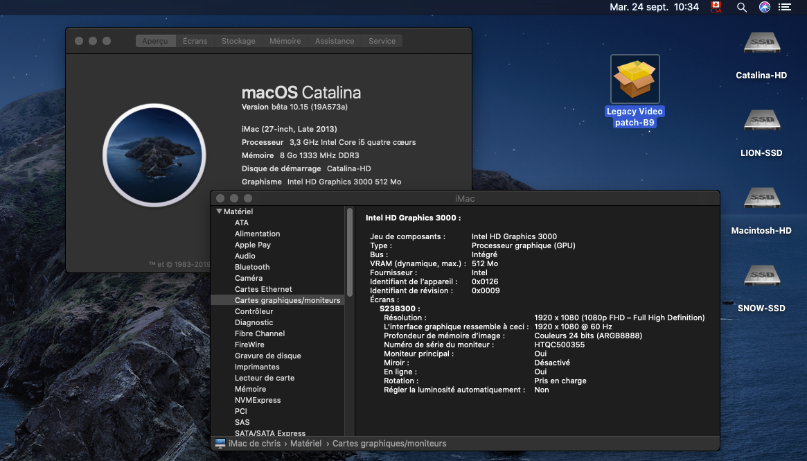

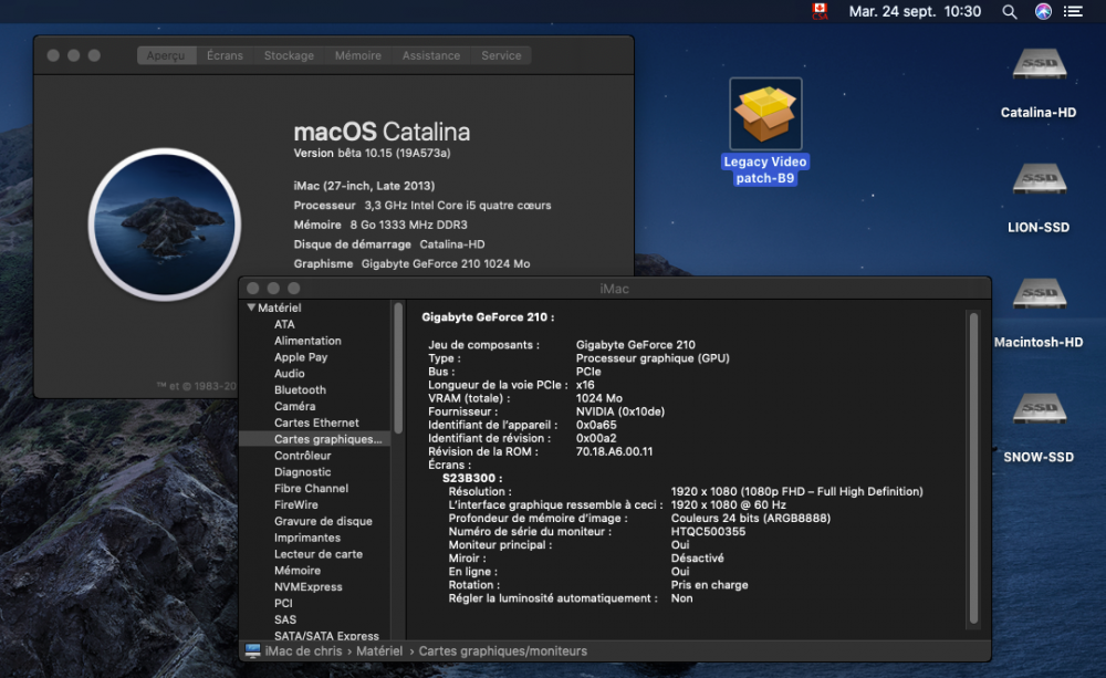

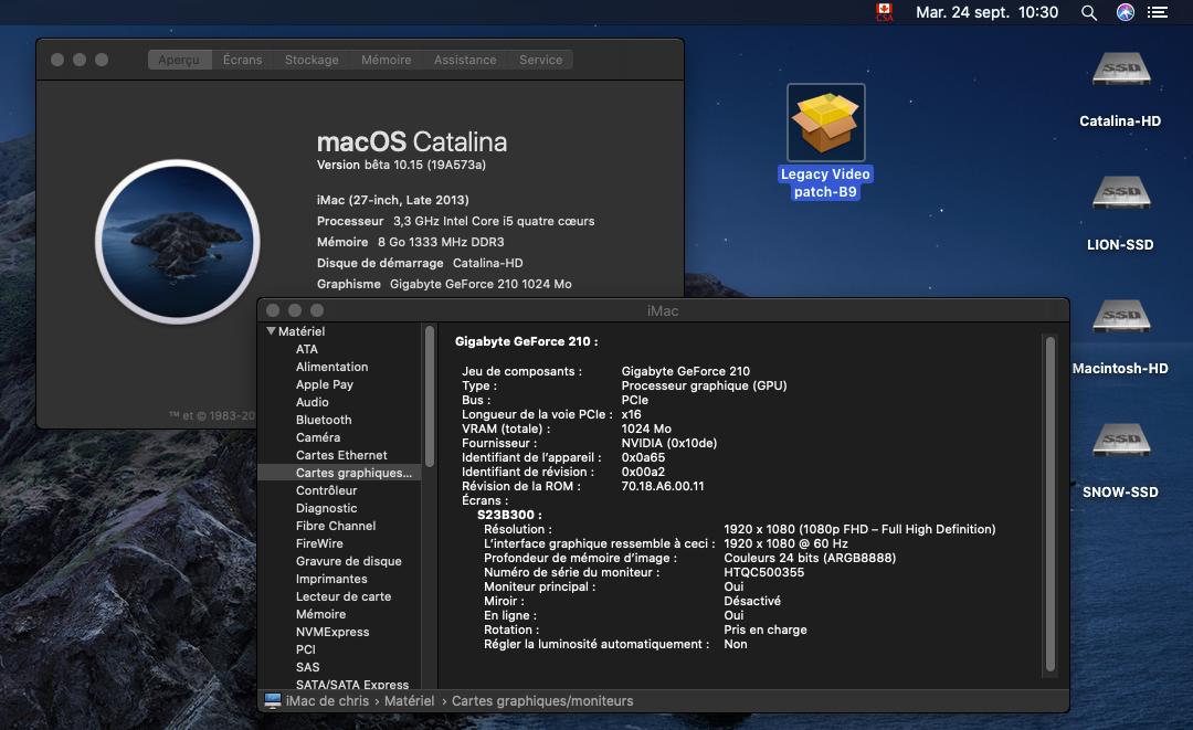

Good news for the Old Nvidia and Intel HD 3000 video card, the package Legacy video B9
Works with out using the Recovery HD but you have to complete a fresh Install of Beta 9 because update beta 8 to Beta 9 not working for the Legacy Video
But its a great succeees annyway ;)
Big thanks to @ASentientBot
  • Like 3
  • Thanks 1

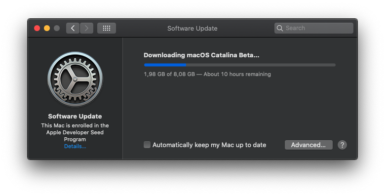

This is my third download. Very slow connection from Apple Server. My Internet Connections is 30Mbps
  • Sad 1
I had the same issue and had to stop and restart numerous times. Took about forty minutes with a gigabyte connection.

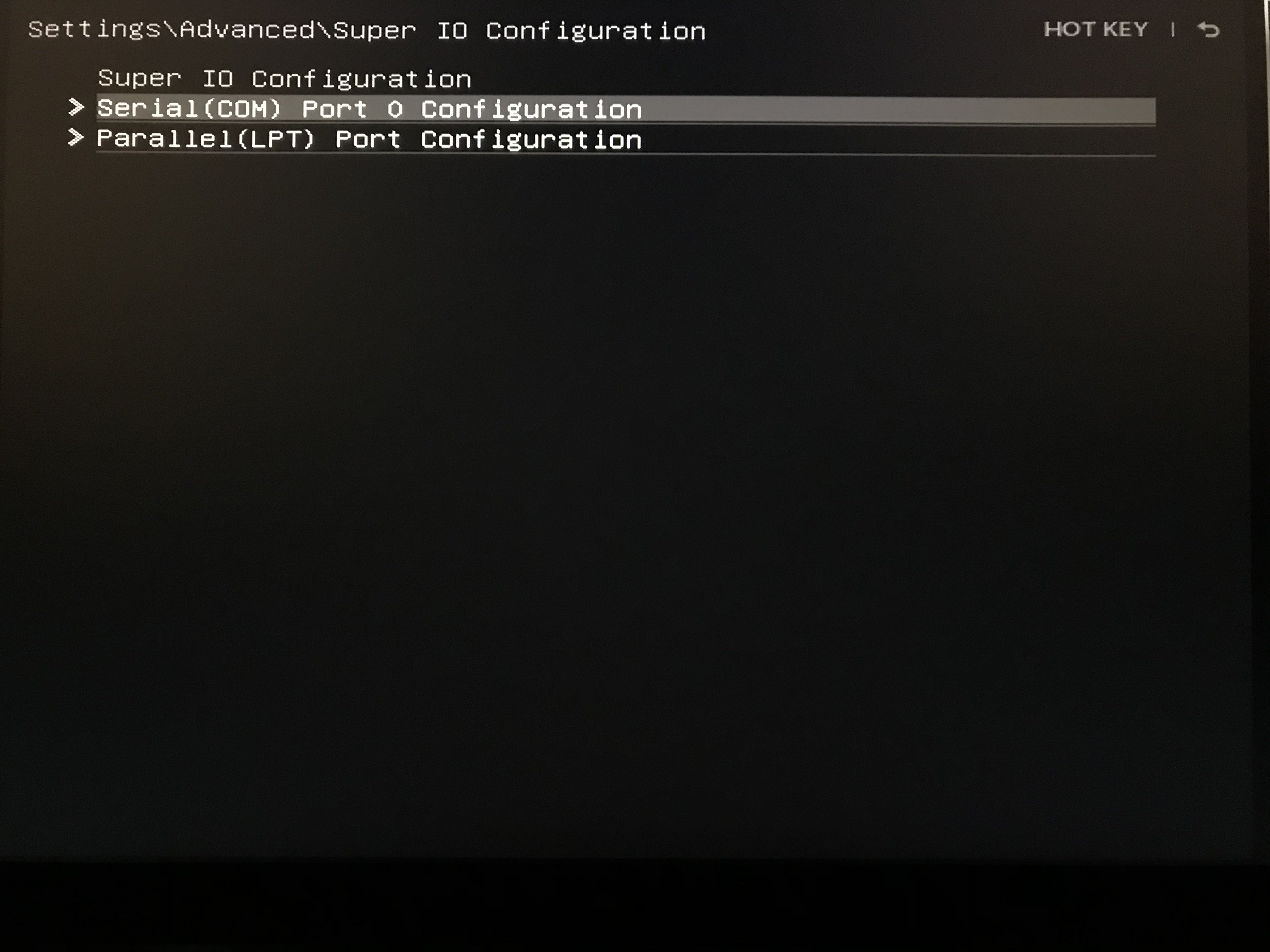

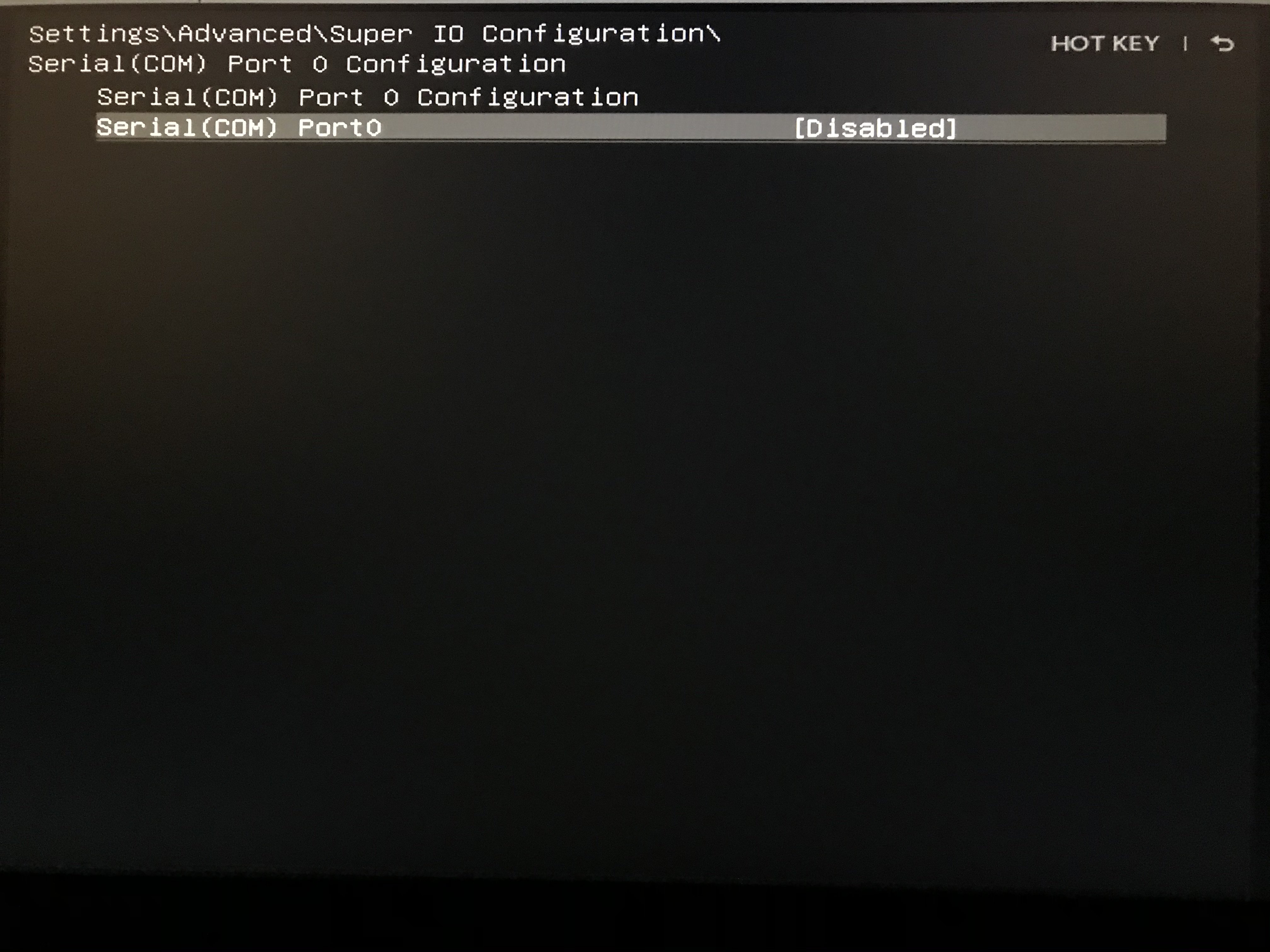

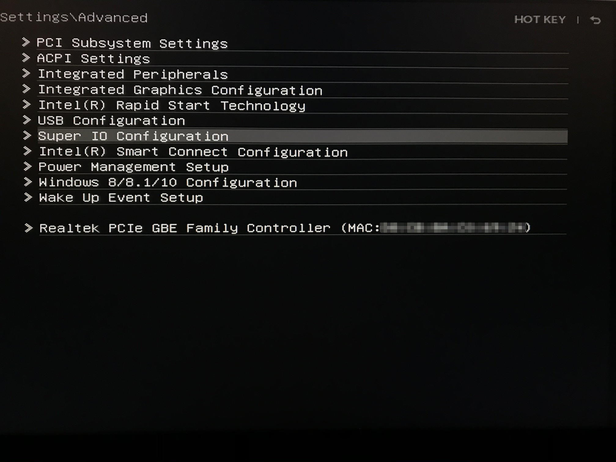

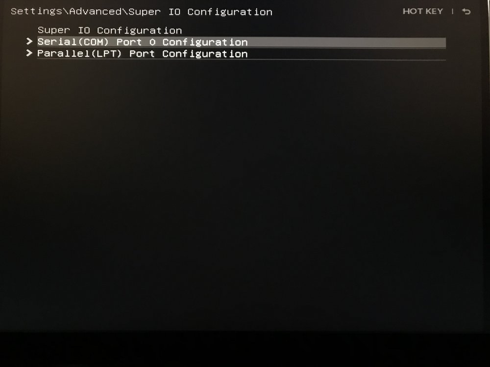

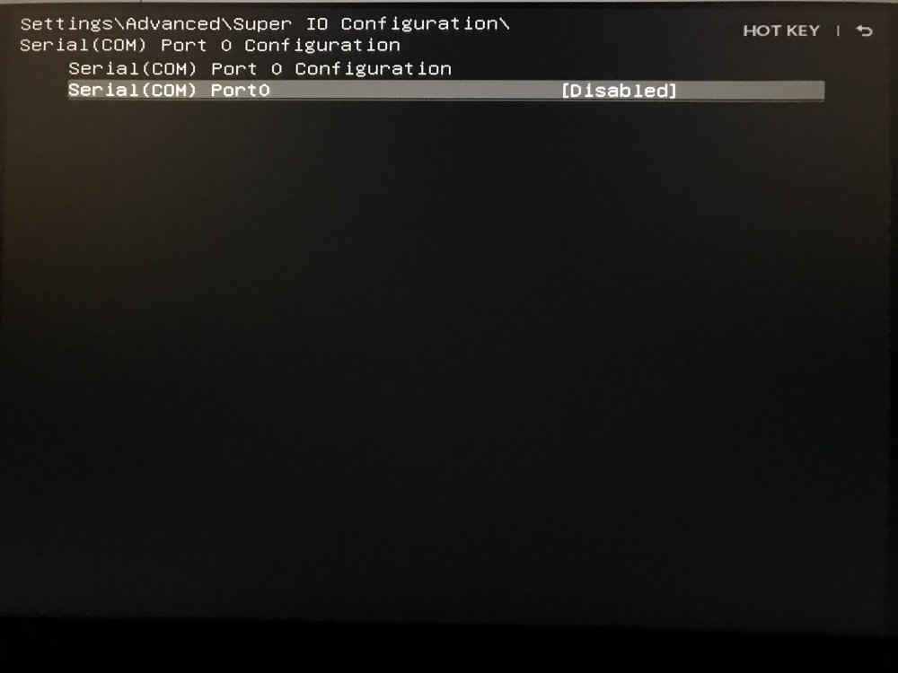

@Andres ZeroCross Fixed it!! FINALLY!!!!!!
I was right when I said this happens with any SMBIOS and the fact that, with the same config, it just stopped working at some point.
But you were definitely right when you said Serial Ports! That option was enabled, and despite the fact that I don't remember giving much importance to that before with Catalina (when it worked), and despite the fact that, with the same option enabled, Mojave works just fine, THAT ACTUALLY FIXED IT! :)))
So yeah, it was an option in the BIOS, it wasn't the config, it wasn't the SMBIOS, and it looks like it is something that might have been recently added to MacOS, since it didn't happen with previous versions of Catalina (though I might have disabled that option before, without realising how important that was), and it definitely didn't happen with Mojave.
So yeah, to sum up:
1. SMBIOS change did nothing
2. fresh installation did nothing
3. setting the iGPU as primary, in my case at least, it didn't change anything.
What did make the whole difference, and I honestly didn't expect it to make all that difference, since to me it looked like the problem is iGPU related...not..serial ports related...was disabling Serial Ports in BIOS.
So yeah, a HUGE thank you to everyone for their feedback on this issue. You guys are awesome! :)
Edited by arsradu
  • Like 4
So yeah, to sum up:

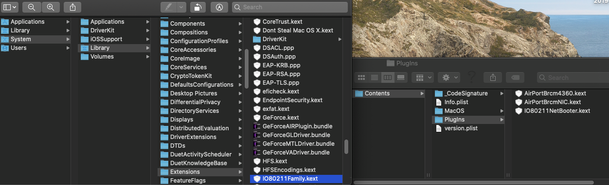

2 minutes ago, Ellybz said:
Andres ZeroCross
@Andres ZeroCross Airdrop works with BRCM4360 works because it's present in the IO80211 family kext. My question was related to those with BRCM4331 that has to be re injected. Thanks for your input :)
Your first line questions above is about "Anybody has an issue with Beta 9 & airdrop not showing? (19A573a)", you didn't write BCM4331 as main issue in your first questions. So i give answer about your Main Questions
PS : AFAIK Airdrop is about Bluetooth, not wifi kext
Yes I did, I wrote" Can anyone report their status with a BRCM4331 Card? Thanks."
No big deal. thanks anyway :). AFAIK, Airdrop needs WIFI to be turned on, but it does not need to be connected to a network.
Edited by Ellybz
Thank you very much for this info. Also works for me on my desktop.  :thumbsup_anim:

Hello, I seem to have encountered the same problem as you. Can you elaborate on how you modified the BIOS settings?
I'm not sure laptops have that option. So...I think in your case, the source of the issue might be different...? Do you get KP? If so, can you post the report you get after reboot? It might be different.
I think your issue might actually be related to the iGPU. Unless your experience says otherwise.
Anyway, this is for my desktop motherboard (and probably other desktop motherboards, as well). Similar naming.
Edited by arsradu

41 minutes ago, xiaoM4095 said:
I found the option you mentioned in the BIOS, but it has been disabled. Attach my panic report.
Anonymous UUID:       73E46EBA-13F5-C21A-BD7C-53473ED43527
Wed Sep 25 20:15:07 2019
*** Panic Report ***
Panic(CPU 2, time 57052043059): NMIPI for unresponsive processor: TLB flush timeout, TLB state:0x0
RAX: 0x0000000000000000, RBX: 0x00000000fe036014, RCX: 0xffffff800b059cdf, RDX: 0xffffff800b059f74
RSP: 0xffffff811e7b3490, RBP: 0xffffff811e7b3500, RSI: 0xfffffe897e036014, RDI: 0x00000000fe036014
R8:  0x0000000000000000, R9:  0x00000000fffffffe, R10: 0x0000000000000000, R11: 0x0000000000000000
R12: 0x0000000000000000, R13: 0x0000000000000001, R14: 0x0000000000000004, R15: 0x0000000000000000
RFL: 0x0000000000000087, RIP: 0xffffff800b059cf9, CS:  0x0000000000000008, SS:  0x0000000000000010
Backtrace (CPU 2), Frame : Return Address
0xffffff811f085f80 : 0xffffff800b065d7b mach_kernel : _interrupt + 0x12b
0xffffff811f085fd0 : 0xffffff800aee4d5d mach_kernel : _hndl_allintrs + 0x11d
0xffffff811e7b3500 : 0xffffff800b6ad2c9 mach_kernel : _serial_init + 0x679
0xffffff811e7b3510 : 0xffffff800b031b4a mach_kernel : _console_printbuf_clear + 0x7a
0xffffff811e7b3530 : 0xffffff800b031f39 mach_kernel : _cnputc_unbuffered + 0xe9
0xffffff811e7b3560 : 0xffffff800b032366 mach_kernel : _console_write + 0x296
0xffffff811e7b35a0 : 0xffffff800b031ab8 mach_kernel : _console_printbuf_putc + 0x68
0xffffff811e7b35c0 : 0xffffff800af5515f mach_kernel : ___doprnt + 0x9f
0xffffff811e7b36a0 : 0xffffff800b6044b1 mach_kernel : _IOLog + 0x131
0xffffff811e7b3850 : 0xffffff7f8f3e8fc7 com.apple.driver.AppleHDA : __ZN19AppleHDAEngineInput19performFormatChangeEP13IOAudioStreamPK20_IOAudioStreamFormatPK18_IOAudioSampleRate + 0x2b
0xffffff811e7b38b0 : 0xffffff7f8ea13abd com.apple.iokit.IOAudioFamily : __ZN13IOAudioStream9setFormatEPK20_IOAudioStreamFormatPK29_IOAudioStreamFormatExtensionP12OSDictionaryb + 0x399
0xffffff811e7b3980 : 0xffffff7f8f3ebdfc com.apple.driver.AppleHDA : __ZN14AppleHDAStream9setFormatEPK20_IOAudioStreamFormatPK29_IOAudioStreamFormatExtensionP12OSDictionaryb + 0xb4
0xffffff811e7b39c0 : 0xffffff7f8ea1341d com.apple.iokit.IOAudioFamily : __ZN13IOAudioStream9setFormatEPK20_IOAudioStreamFormatPK29_IOAudioStreamFormatExtensionb + 0x135
0xffffff811e7b3a50 : 0xffffff7f8f3e8e16 com.apple.driver.AppleHDA : __ZN19AppleHDAEngineInput15initAudioStreamEv + 0x2b4
0xffffff811e7b3ab0 : 0xffffff7f8f3d8aac com.apple.driver.AppleHDA : __ZN14AppleHDAEngine12initHardwareEP9IOService + 0x21e
0xffffff811e7b3b10 : 0xffffff7f8f3e885d com.apple.driver.AppleHDA : __ZN19AppleHDAEngineInput12initHardwareEP9IOService + 0xf
0xffffff811e7b3b30 : 0xffffff7f8ea091d1 com.apple.iokit.IOAudioFamily : __ZN13IOAudioEngine5startEP9IOServiceP13IOAudioDevice + 0x111
0xffffff811e7b3b70 : 0xffffff7f8ea09087 com.apple.iokit.IOAudioFamily : __ZN13IOAudioEngine5startEP9IOService + 0x65
0xffffff811e7b3bb0 : 0xffffff7f8f3cc80b com.apple.driver.AppleHDA : __ZN14AppleHDADriver19activateAudioEngineEP13IOAudioEngineb + 0xf9
0xffffff811e7b3bf0 : 0xffffff7f8f3cd200 com.apple.driver.AppleHDA : __ZN14AppleHDADriver20activateAudioEnginesEv + 0xbe
0xffffff811e7b3c30 : 0xffffff7f8f3c7a7a com.apple.driver.AppleHDA : __ZN14AppleHDADriver18initHardwareActionEP9IOService + 0x316
0xffffff811e7b3c80 : 0xffffff800b63f5f8 mach_kernel : __ZN13IOCommandGate9runActionEPFiP8OSObjectPvS2_S2_S2_ES2_S2_S2_S2_ + 0x138
0xffffff811e7b3ce0 : 0xffffff7f8f3c7756 com.apple.driver.AppleHDA : __ZN14AppleHDADriver12initHardwareEP9IOService + 0x3c
0xffffff811e7b3d00 : 0xffffff7f8ea06588 com.apple.iokit.IOAudioFamily : __ZN13IOAudioDevice5startEP9IOService + 0x10e
0xffffff811e7b3d40 : 0xffffff7f8f3c95a2 com.apple.driver.AppleHDA : __ZN14AppleHDADriver13completeStartEv + 0x180
0xffffff811e7b3ed0 : 0xffffff7f8f3c9254 com.apple.driver.AppleHDA : __ZN14AppleHDADriver11startActionEv + 0xdc
0xffffff811e7b3f40 : 0xffffff800b63c8ae mach_kernel : __ZN10IOWorkLoop9runActionEPFiP8OSObjectPvS2_S2_S2_ES1_S2_S2_S2_S2_ + 0x3e
0xffffff811e7b3f80 : 0xffffff7f8f3c9132 com.apple.driver.AppleHDA : __ZN14AppleHDADriver23handleAsynchronousStartEPv + 0x58
0xffffff811e7b3fa0 : 0xffffff800aee413e mach_kernel : _call_continuation + 0x2e
      Kernel Extensions in backtrace:
         com.apple.iokit.IOAudioFamily(300.2)[36458D20-C250-375B-9978-7F4E536DD8C6]@0xffffff7f8ea02000->0xffffff7f8ea40fff
            dependency: com.apple.vecLib.kext(1.2.0)[0D01481C-BA28-3F00-9CD2-277955842FD6]@0xffffff7f8e956000
         com.apple.driver.AppleHDA(283.13)[A85E9421-A4EC-3E64-9577-93AC1B2AD9E2]@0xffffff7f8f3b8000->0xffffff7f8f4a0fff
            dependency: com.apple.driver.AppleHDAController(283.13)[072BC69C-694B-3921-A7C6-7E4982A2ECFF]@0xffffff7f8f212000
            dependency: com.apple.iokit.IONDRVSupport(557)[1C4E56EA-057E-3DBE-A323-E60698B193D5]@0xffffff7f8ee71000
            dependency: com.apple.iokit.IOAudioFamily(300.2)[36458D20-C250-375B-9978-7F4E536DD8C6]@0xffffff7f8ea02000
            dependency: com.apple.iokit.IOHDAFamily(283.13)[5BBCFD57-A34D-3AF5-990F-AAF8391C86F1]@0xffffff7f8f206000
            dependency: com.apple.iokit.IOGraphicsFamily(557)[21B2E1AE-9952-3C62-B79A-F44C9D333EF4]@0xffffff7f8ee21000
            dependency: com.apple.driver.DspFuncLib(283.13)[BC0B6302-FD12-35AB-9F73-3CF862FC0203]@0xffffff7f8f278000
BSD process name corresponding to current thread: kernel_task
Boot args: dart=0 -v debug=0x100 keepsyms=1  root-dmg=file:///Install%20macOS%20Catalina%20Beta.app/Contents/SharedSupport/BaseSystem.dmg
Mac OS version:
19A526h
Kernel version:
Darwin Kernel Version 19.0.0: Tue Jul 23 01:19:36 PDT 2019; root:xnu-6153.0.103.151.1~4/RELEASE_X86_64
Kernel UUID: 77E43123-9759-324A-BEE5-4C2404BC0BF3
Kernel slide:     0x000000000ac00000
Kernel text base: 0xffffff800ae00000
__HIB  text base: 0xffffff800ad00000
System model name: MacBookPro15,1 (Mac-937A206F2EE63C01)
System shutdown begun: NO
Panic diags file unavailable, panic occurred prior to initialization
System uptime in nanoseconds: 57052522620
last loaded kext at 54468665790: com.apple.driver.AppleGraphicsDevicePolicy	4.1.30 (addr 0xffffff7f8f5ef000, size 86016)
loaded kexts:
(none)
panic(cpu 6 caller 0xffffff800b041eb1): "IPI timeout, unresponsive CPU bitmap: 0x4, NMIPI acks: 0x0, now: 0x1, deadline: 57052041087, pre-NMIPI time: 0xd4891107c, current: 0xd48986ea4, global: 1"@/BuildRoot/Library/Caches/com.apple.xbs/Sources/xnu/xnu-6153.0.103.151.1/osfmk/x86_64/pmap.c:2909
Backtrace (CPU 6), Frame : Return Address
0xffffff811ea73680 : 0xffffff800af3da1b mach_kernel : _handle_debugger_trap + 0x47b
0xffffff811ea736d0 : 0xffffff800b074aa5 mach_kernel : _kdp_i386_trap + 0x155
0xffffff811ea73710 : 0xffffff800b06658b mach_kernel : _kernel_trap + 0x4fb
0xffffff811ea73760 : 0xffffff800aee4bb0 mach_kernel : _return_from_trap + 0xe0
0xffffff811ea73780 : 0xffffff800af3d107 mach_kernel : _DebuggerTrapWithState + 0x17
0xffffff811ea73880 : 0xffffff800af3d4eb mach_kernel : _panic_trap_to_debugger + 0x21b
0xffffff811ea738d0 : 0xffffff800b6cd559 mach_kernel : _panic + 0x61
0xffffff811ea73940 : 0xffffff800b041eb1 mach_kernel : _pmap_flush_tlbs + 0x841
0xffffff811ea739f0 : 0xffffff800b047afa mach_kernel : _pmap_remove_range_options + 0x36a
0xffffff811ea73ad0 : 0xffffff800b0487a6 mach_kernel : _pmap_remove_options + 0x96
0xffffff811ea73b30 : 0xffffff800afd54cb mach_kernel : _vm_map_destroy + 0x8eb
0xffffff811ea73c80 : 0xffffff800afdce1e mach_kernel : _vm_map_remove + 0x5e
0xffffff811ea73cb0 : 0xffffff800afd0766 mach_kernel : _kmem_free + 0x86
0xffffff811ea73ce0 : 0xffffff800b5c8a0f mach_kernel : __ZN11OSSerialize4freeEv + 0x4f
0xffffff811ea73d00 : 0xffffff800b66bb8b mach_kernel : _is_io_registry_entry_get_property_bin + 0x1eb
0xffffff811ea73d60 : 0xffffff800b025be4 mach_kernel : _iokit_server_routine + 0x6464
0xffffff811ea73db0 : 0xffffff800af43888 mach_kernel : _ipc_kobject_server + 0x238
0xffffff811ea73e10 : 0xffffff800af1a725 mach_kernel : _ipc_kmsg_send + 0x135
0xffffff811ea73e70 : 0xffffff800af31135 mach_kernel : _mach_msg_overwrite_trap + 0x2e5
0xffffff811ea73f00 : 0xffffff800b04ca65 mach_kernel : _mach_call_munger64 + 0x205
0xffffff811ea73fa0 : 0xffffff800aee5396 mach_kernel : _hndl_mach_scall64 + 0x16
BSD process name corresponding to current thread: WindowServer
EOF
Model: MacBookPro15,1, BootROM 220.260.170.0.0, 4 processors, Intel Core i5, 2.30 GHz, 8 GB, SMC 1.74f4
Graphics: kHW_IntelUHDGraphics630Item, Intel UHD Graphics 630, Built-In
Memory Module: BANK 0/DIMM0, 8 GB, DDR4, 2667 MHz, SK Hynix, HMA81GS6CJR8N-VK
AirPort: spairport_wireless_card_type_airport_extreme (0x14E4, 0x133), Broadcom BCM43xx 1.0 (7.77.37.31.1a9)
Bluetooth: Version 6.0.7f10, 3 services, 18 devices, 1 incoming serial ports
Network Service: Wi-Fi, AirPort, en1
Serial ATA Device: KINGSTON SA400S37480G, 480.1 GB
USB Device: USB 3.1 Bus
USB Device: DataTraveler 3.0
USB Device: Bluetooth USB Host Controller
USB Device: Integrated Camera
Thunderbolt Bus:
Is this standard? Cause I've seen it before. And I just don't see the point for root-dmg.... Is this something specific to Laptops in general?
