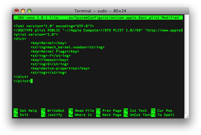

cmdshft Posted December 22, 2008 Share Posted December 22, 2008 For those finding themselves either typing -f at boot or hotplugging the USB adapter after boot to get the driver to load and connect, you can do the following: sudo nano /Library/Preferences/SystemConfiguration/com.apple.Boot.plist Make sure it looks like this: Save and quit terminal. Now you don't have to type it manually anymore, nor will you have to replug it should you forget to type -f. It will add some time to your boot, in the refreshing of the kexts and also when the driver is loaded during boot when it tries to link up with a network. Link to comment https://www.insanelymac.com/forum/topic/33896-new-ralink-rt2500-usb-driver-a-la-airport-driver-v-15/page/14/#findComment-1009223 Share on other sites More sharing options...
