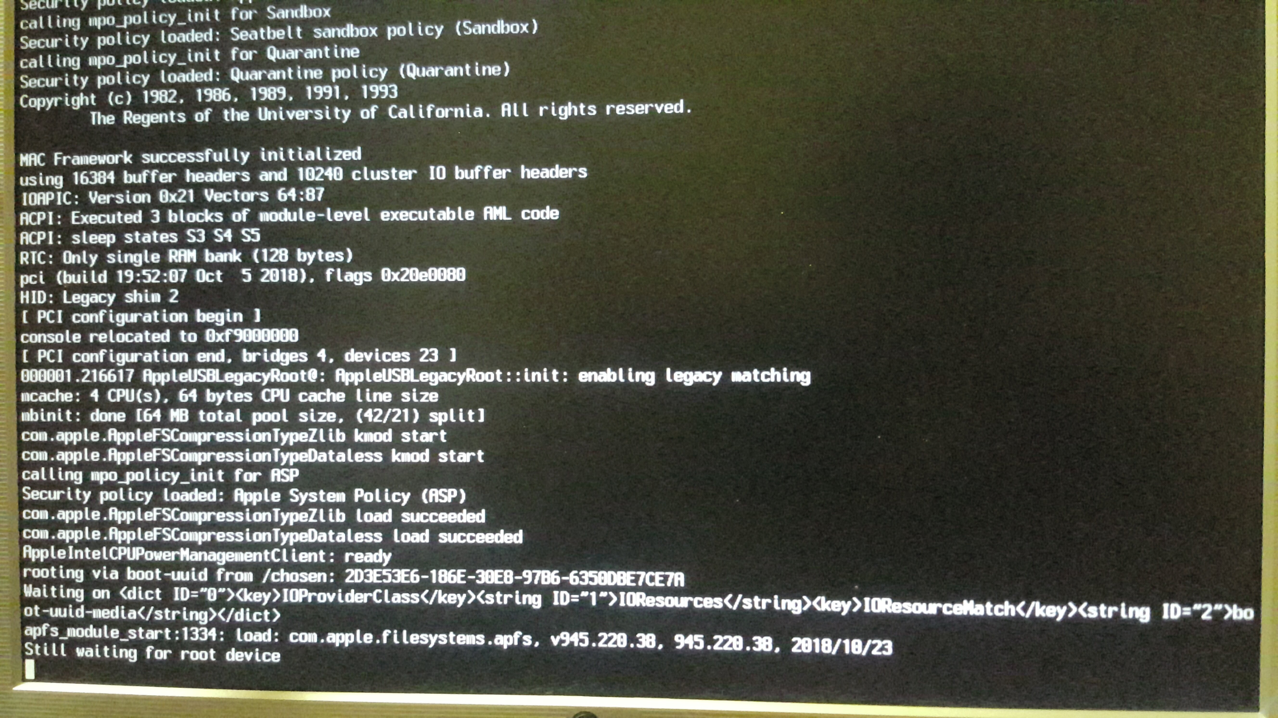

vintr Posted January 8, 2019 Share Posted January 8, 2019 4 hours ago, NMZI said: Try this kernel please !https://www.dropbox.com/s/rads3t1uzh3t4wn/XLNC_v3.zip?dl=0 FX 4300 Doesn't work for me with the install USB. Drops the 'waiting for root device', then gets the panic. Tried to boot with -v npci=0x3000 debug=0x100 slide=176 Link to comment https://www.insanelymac.com/forum/topic/335877-amd-mojave-kernel-development-and-testing/page/7/#findComment-2657819 Share on other sites More sharing options...
Mc Jacej Posted January 8, 2019 Share Posted January 8, 2019 2 hours ago, vintr said: FX 4300 Doesn't work for me with the install USB. Drops the 'waiting for root device', then gets the panic. Tried to boot with -v npci=0x3000 debug=0x100 slide=176 create a mojave installer on your hdd,,apu and fx board had usb 2.0 issue since el capitan Link to comment https://www.insanelymac.com/forum/topic/335877-amd-mojave-kernel-development-and-testing/page/7/#findComment-2657822 Share on other sites More sharing options...

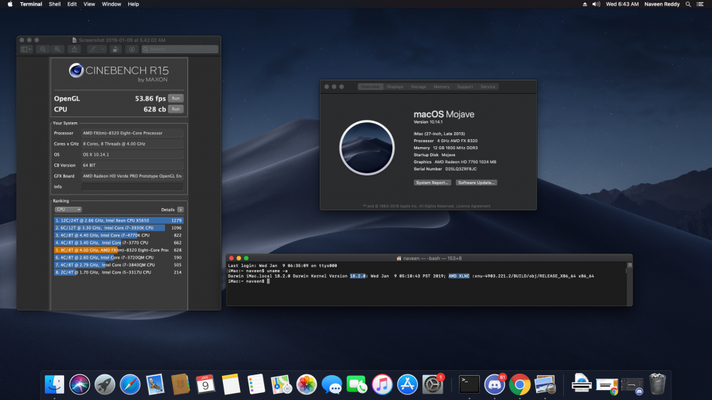

XLNC Posted January 9, 2019 Share Posted January 9, 2019 (edited) On 1/7/2019 at 4:14 AM, XLNC said: Also the mojave always reboots after data and privacy setup screen for some reason. It shows this message while reboot my guess is its due to gpu coz i dont have amd gpu . here is the system.log if anyone want to take a look .system.log UPDATE-1 : For mojave i recently bought a XFX HD 7750 (it doesnt have UEFI support) so i needed to add UEFI GOP support to vbios to boot with this GPU in UEFI mode on my mobo. used the latest lilu + whatevergreen kexts and booted with radpg=15 PROFIT ! : ) UPDATE-2 : As in the above quoted post i said that the macos reboots everytime i press next on Data & Privacy screen and i thought it was caused due to GPU but i was wrong it still reboots even with the AMD GPU . so the issue is in either kernel or in the framework. so for those users who users who has the same issue as me . Reboot the macos in single-user mode ( -s ) and type : /sbin/fsck -fy /sbin/mount -uw / Then create this file to skip the apple setup screen: touch /var/db/.AppleSetupDone Now create a temporary user account "Temp User" with password "password" and home directory "temp" to go through the user account login screen. NOTE : Ignore the missing directory error outputs while typing the commands. launchctl load /System/Library/LaunchDaemons/com.apple.opendirectoryd.plist dscl . -create /Users/temp dscl . -create /Users/temp UserShell /bin/bash dscl . -create /Users/temp RealName "Temp User" dscl . -create /Users/temp UniqueID "510" dscl . -create /Users/temp PrimaryGroupID 20 dscl . -create /Users/temp NFSHomeDirectory /Users/temp dscl . -passwd /Users/temp password dscl . -append /Groups/admin GroupMembership temp dseditgroup -o edit -a temp -t user admin Now reboot : shutdown -r +0 So macos will now directly take you to the login screen . where it will ask you to enter password . type password and hit enter to login. you will reach Data & Privacy screen again so click next to proceed ( dont worry, it wont reboot now ) and so after few clicks you will reach Desktop . Now go to System Prefrences -> User & Groups and create a Administrator account of your choice with your real User name After that logout from this Temp User account and login into your own admin account Finally delete this Temp User account by going into System Prefrences -> User & Groups. - DONE !UPDATE-3 : I have attached the kernel i used below and also the sysctl output. XLNC_10.14.1.zip sysctl.txt Everything is working so far like shutdown / restart , 32 bit apps etc. Sleep doesnt work . it doesnt anyway since high sierra . Now the only issue is safari as it continuosly reloads the page on certain websites like youtube.com / brew.sh ( check below pic ) And i thinks its caused due to the necp client . Spoiler Edited January 12, 2019 by XLNC 1 1 Link to comment https://www.insanelymac.com/forum/topic/335877-amd-mojave-kernel-development-and-testing/page/7/#findComment-2658085 Share on other sites More sharing options...
jsl2000 Posted January 9, 2019 Share Posted January 9, 2019 (edited) 1 hour ago, XLNC said: UPDATE-1 : For mojave i recently bought a XFX HD 7750 (it doesnt have UEFI support) so i needed to add UEFI GOP support to vbios to boot with this GPU in UEFI mode on my mobo. used the latest lilu + whatevergreen kexts and booted with radpg=15 PROFIT ! : ) UPDATE-2 : As in the above quoted post i said that the macos reboots everytime i press next on Data & Privacy screen and i thought it was caused due to GPU but i was wrong it still reboots even with the AMD GPU . so the issue is in either kernel or in the framework. so for those users who users who has the same issue as me . Reboot the macos in single-user mode ( -s ) and type : /sbin/fsck -fy /sbin/mount -uw / Then create this file to skip the apple setup screen: touch /var/db/.AppleSetupDone Now create a temporary user account "Temp User" with password "password" and home directory "temp" to go through the user account login screen. NOTE : Ignore the missing directory error outputs while typing the commands. launchctl load /System/Library/LaunchDaemons/com.apple.opendirectoryd.plist dscl . -create /Users/temp dscl . -create /Users/temp UserShell /bin/bash dscl . -create /Users/temp RealName "Temp User" dscl . -create /Users/temp UniqueID "510" dscl . -create /Users/temp PrimaryGroupID 20 dscl . -create /Users/temp NFSHomeDirectory /Users/temp dscl . -passwd /Users/temp password dscl . -append /Groups/temp GroupMembership temp dseditgroup -o edit -a temp -t user admin Now reboot : shutdown -r +0 So macos will now directly take you to the login screen . where it will ask you to enter password . type password and hit enter to login. you will reach Data & Privacy screen again so click next to proceed ( dont worry, it wont reboot now ) and so after few clicks you will reach Desktop . Now go to System Prefrences -> User & Groups and create a Administrator account of your choice with your real User name After that logout from this Temp User account and login into your own admin account Finally delete this Temp User account by going into System Prefrences -> User & Groups. - DONE !UPDATE-3 : I have attached the kernel i used below and also the sysctl output. XLNC_10.14.1.zip sysctl.txt Everything is working so far like shutdown / restart , 32 bit apps etc. Sleep doesnt work . it doesnt anyway since high sierra . Now the only issue is safari as it continuosly reloads the page on certain websites like youtube.com / brew.sh ( check below pic ) And i thinks its caused due to the necp client . Reveal hidden contents Can you rebuild prelinkedkernel with this kernel without error in FX-8320 hackintosh ? Edited January 9, 2019 by jsl2000 Link to comment https://www.insanelymac.com/forum/topic/335877-amd-mojave-kernel-development-and-testing/page/7/#findComment-2658099 Share on other sites More sharing options...

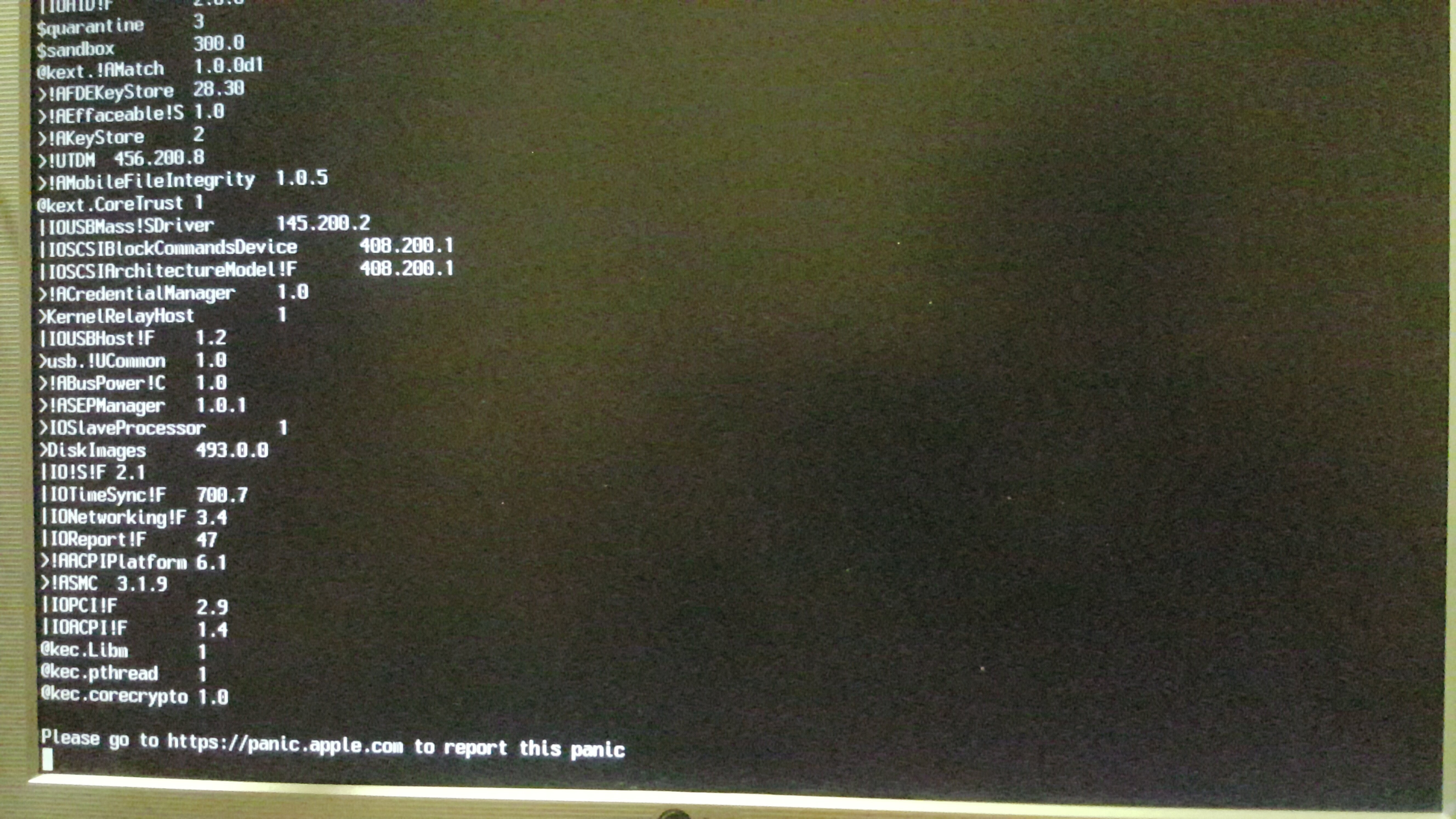

vintr Posted January 9, 2019 Share Posted January 9, 2019 Still can't get through the installer on FX 4300, no matter what PK I'm using. It just drops KP and that's it. HDD instead of USB also didn't help. Link to comment https://www.insanelymac.com/forum/topic/335877-amd-mojave-kernel-development-and-testing/page/7/#findComment-2658119 Share on other sites More sharing options...
Shaneee Posted January 9, 2019 Author Share Posted January 9, 2019 1 hour ago, vintr said: Still can't get through the installer on FX 4300, no matter what PK I'm using. It just drops KP and that's it. HDD instead of USB also didn't help. Sharing an image of the KP would help... Link to comment https://www.insanelymac.com/forum/topic/335877-amd-mojave-kernel-development-and-testing/page/7/#findComment-2658139 Share on other sites More sharing options...
XLNC Posted January 9, 2019 Share Posted January 9, 2019 (edited) 2 hours ago, vintr said: Still can't get through the installer on FX 4300, no matter what PK I'm using. It just drops KP and that's it. HDD instead of USB also didn't help. try this one .https://www.dropbox.com/s/usrhnr4apbagxpj/XLNC_prelinkedkernel.fx4.zip?dl=0 and as shaneee mentioned . also do share the pk screenshot when occured . also add your complete system specs in your signature. Edited January 9, 2019 by XLNC 1 Link to comment https://www.insanelymac.com/forum/topic/335877-amd-mojave-kernel-development-and-testing/page/7/#findComment-2658141 Share on other sites More sharing options...

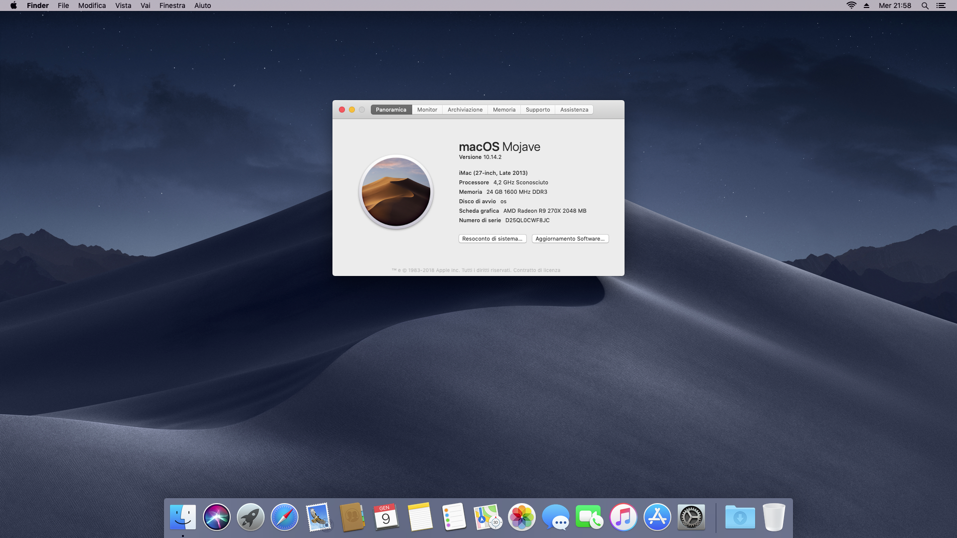

carlo_67 Posted January 9, 2019 Share Posted January 9, 2019 1 hour ago, XLNC said: try this one .https://www.dropbox.com/s/usrhnr4apbagxpj/XLNC_prelinkedkernel.fx4.zip?dl=0 and as shaneee mentioned . also do share the pk screenshot when occured . also add your complete system specs in your signature. excellent, 10.14.2 on fx 8350 Booting XLNC_10.zip I used prelinkedkernel.fx4, I made a folder good job 2 Link to comment https://www.insanelymac.com/forum/topic/335877-amd-mojave-kernel-development-and-testing/page/7/#findComment-2658166 Share on other sites More sharing options...
XLNC Posted January 9, 2019 Share Posted January 9, 2019 5 minutes ago, carlo_67 said: excellent, 10.14.2 on fx 8350 Booting XLNC_10.zip Great ! Can you also change your theme to dark mode and try changing accent color to red or something and tell me does it change ? also share a pic of the window after that here . coz m trying to figure out if its the gpu issue or macos kernel. Link to comment https://www.insanelymac.com/forum/topic/335877-amd-mojave-kernel-development-and-testing/page/7/#findComment-2658171 Share on other sites More sharing options...
Shaneee Posted January 9, 2019 Author Share Posted January 9, 2019 17 minutes ago, XLNC said: Great ! Can you also change your theme to dark mode and try changing accent color to red or something and tell me does it change ? also share a pic of the window after that here . coz m trying to figure out if its the gpu issue or macos kernel. It's either FX or GPU related. Booted with your kernel and can change the colour just fine. 2 Link to comment https://www.insanelymac.com/forum/topic/335877-amd-mojave-kernel-development-and-testing/page/7/#findComment-2658176 Share on other sites More sharing options...
